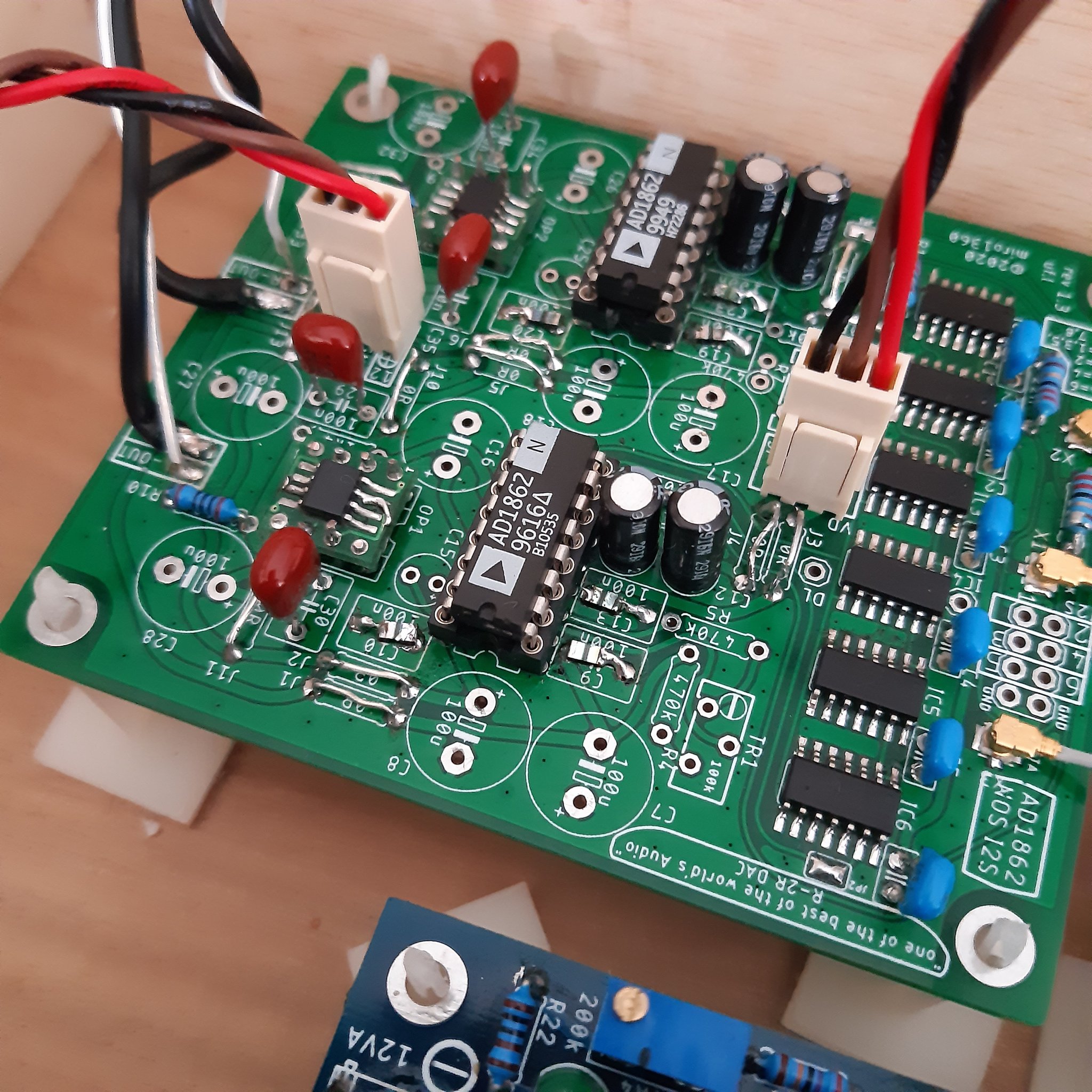

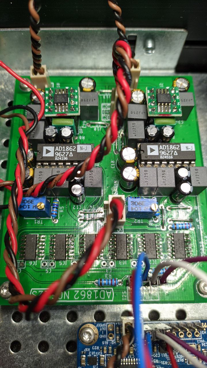

What type of resisfor did you choose as I/V ? What caps on board ? Maybe a picture?
These time I am testing the opa1611 , the sound is keeping this softness but results differ with resistor at iso caps decoupling conf. No surprise, but maybe the not said good wirewound at i/V task sounds a little clearer, more natural than plain normal metal films, though I have several yet to test...the Allen Bradeley has a good tonal but I can hear them distorss with the brass instruments (sort of fqtiguing harshness with trumpets for instance but which perhams is conform with reality ?!)

Nah it is all at the bottom...
Lytics are under the 0,1 uF areas.
47 uF filter cap is a 27 uF Fc with a pitch leads of 1 mm, less than the gap of the two ic adaptator on which it is soldered with 2 mm leads length in order to minimize stray inductance. Pin1 cap filter has the same pitch betwen the two legs and are Vishay SAL orange thinghy cause I had some but hqs to be changed with something more adapted.
The only part really missing in the photograph is the i/v resistor as it is my testing board and also the pots matching circuitry.
Edit: the small one are CDE FCA 0,15 uF/16V, minimal inductance, there is a copper wire betwen the pad qnd the gnd vias..soldering flux is my friend and magnyfing glass... FC caps 3mm pitch just at the bottom...small ground loop, enhanced inductance maybe...

Ok, thanks, yet I would like to have one supporting the boards footprint!! Any chance?
Almost impossible There are many receivers and each has another shape.
Perhaps if you find GP1FAV30RK0F somewhere, I did not find it to buy.

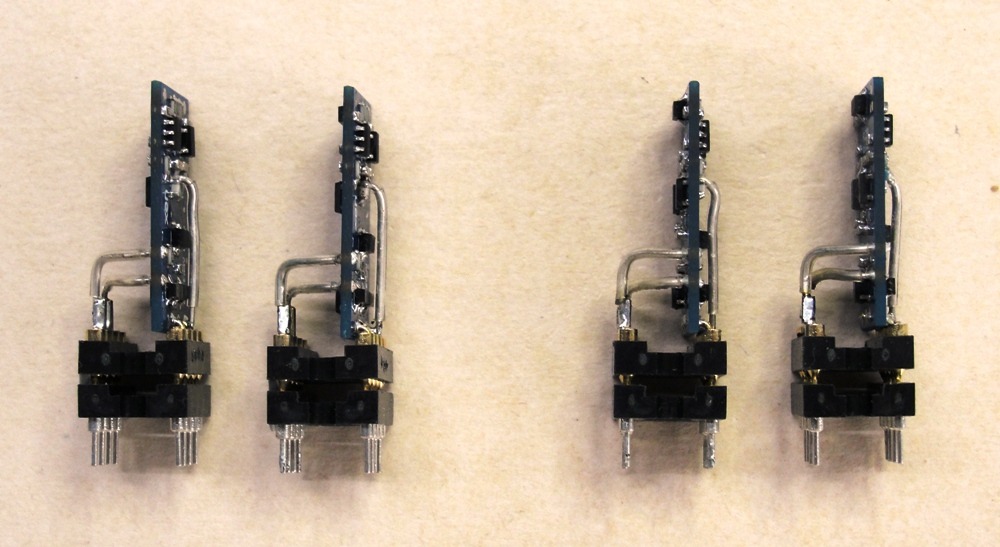

The new JFET-based FC CEN IV that was posted here was sent out for audition :
https://www.diyaudio.com/community/...st-tht-i2s-input-nos-r-2r.354078/post-6989903
After many enjoyable hours of critical listening, so I was told, both IVs were killed by a fancy power supply it was not designed to take.
Complete burn-out of the input stage, including those unobtanium JFET-pairs.
So they came back and now have been fully repaired, and also modified to make them more robust against any future abuse.
Also built another pair for 12V rails for direct plug in.
But Riv and Civ still need to be removed.
Not 100% plug & play.
(The lower DIP IC socket is only there to protect the gold-plated pins of the DIP header.)
Patrick
