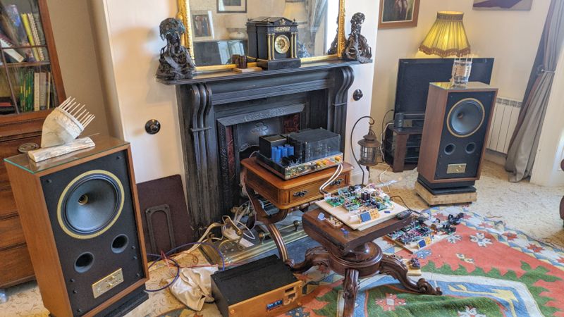

Well, it's a prototype, it's used to test everything, it won't stay there. I primarily tested AK4113 and JLS. It all falls apart and goes to Miro AD1865. The Pavouk AD1865 with one small power supply becomes a Bluetooth only DAC.And dust or if needs to move this box - static can accumulate, no?
if I need an optical and coaxial in together with USB amanero? Can I buy a digital reciever board? How to connect them through switch?
AK4113 board have I2S output, I2S input, two SPDiF inputs and TOSLINK input. JLS is connected to I2S input. I2S output is connected to AD1865.

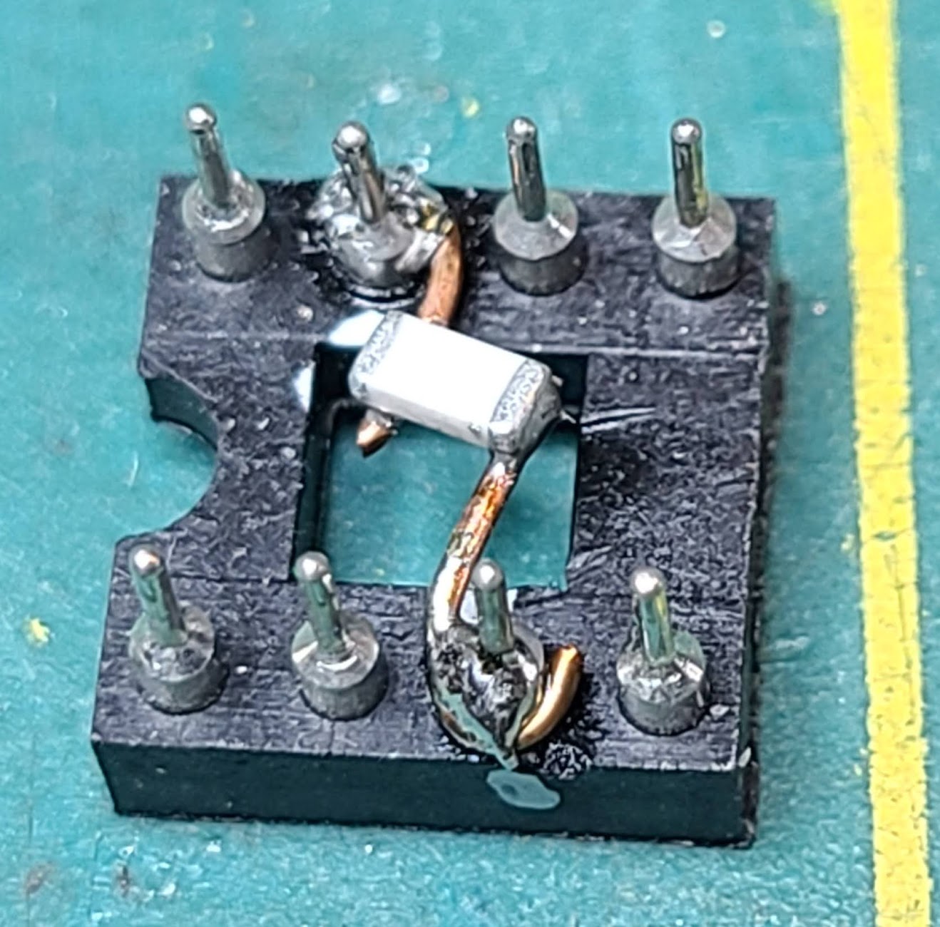

Far be it for me to dissuade someone from building another miro dac, but a few changes can make your current board (or the new one) more flexible. Sockets for Riv (R8, R9) and moving Civ (C31, C36) to a DIP socket lets you experiment with different components or remove them when using an output stage like XEN.
Then you can have fun comparing different output stages with all other variables held constant.

Honestly, I couldn't hear a difference with no filter (other than Civ/Riv) compared to 25kHz and 100kHz S&K filters. But that may be my ears, or my speakers (stacked quad 57s) which probably only go to 18khz anyway. In the end I used the 25kHz filter to limit any high frequency hash running through the system. The power amp I'm using has quite high bandwidth, so I thought it no harm to limit the highs. There is no loss of "sparkle", soundstage or high frequencies to these ears/system at least.
