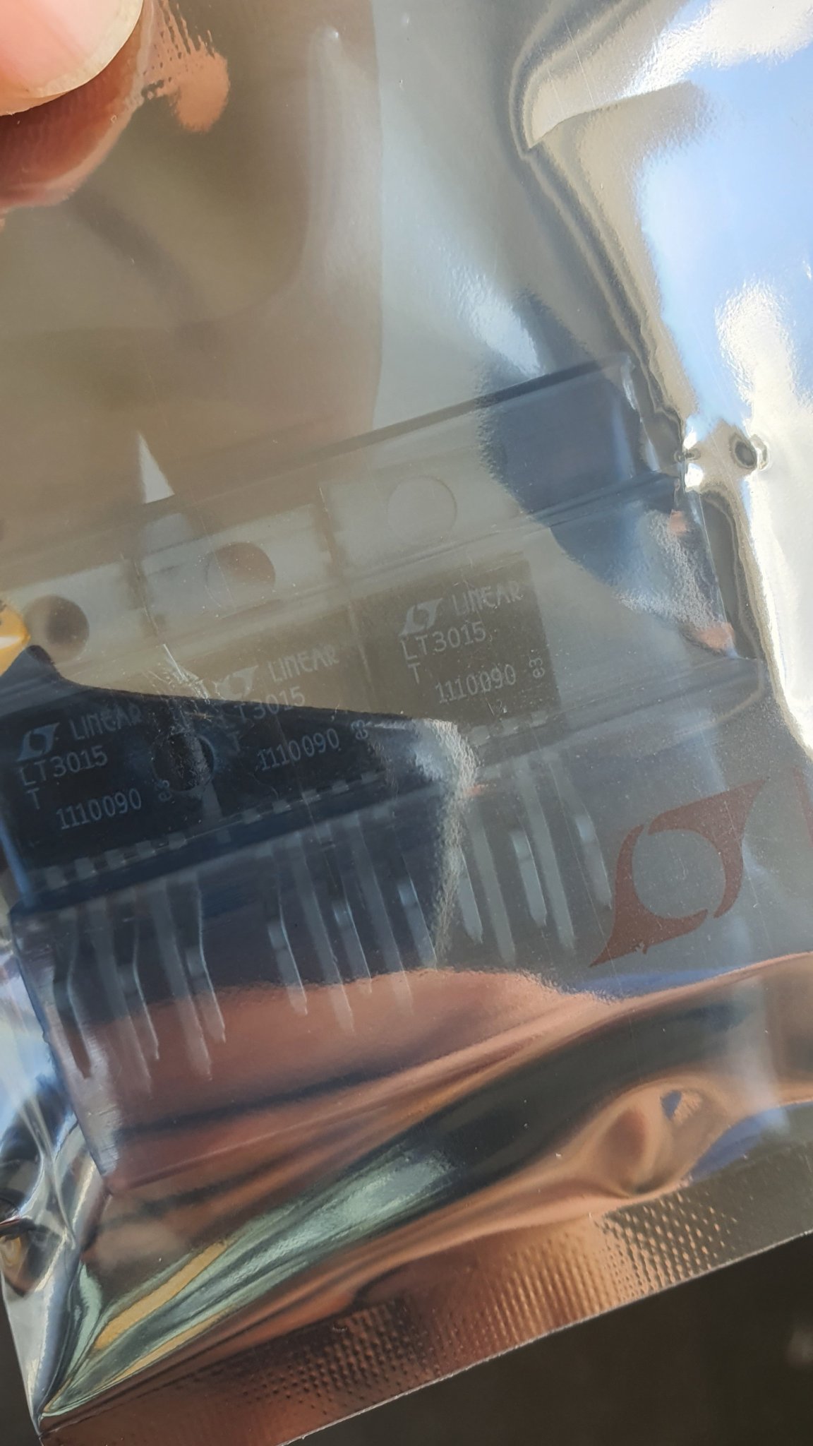

These seem original. I got them from here too.Btw, I became aware today that the bom
for the PSU2 is around 100€. On top of that the LT3015 is not available anywhere, so I'll stick with what I have for now. Still have some BIB Salas Shunts, will save them for the +-15v for Patrick's circuit.

Yes, looking good, but 20€ a pop? Plus shipping and taxes...These seem original. I got them from here too.
https://a.aliexpress.com/_mObJD9W

Three pieces in one order.
I personally would always order from Mouser / DK / Rochester / ..... if they have stock.
Can sleep well, even if slightly more expensive.
And Mouser has both.
Patrick

Nope, noone has it until January. Were my first places to look for. Only managed to get lt1963.I personally would always order from Mouser / DK / Rochester / ..... if they have stock.
Patrick

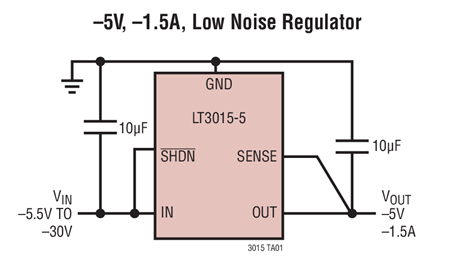

A few of us have ordered fixed LT3015s from Mouser -12V &-5V. I think with a little modification of the PSU2 PCB it can be installed. We have adjustable positive regulators. That's it for PCM63. For AD1865, I ordered regulators from China, SMD with or without heatsink. I tested them at home with load resistors and @skrstic tried them on AD1865 and that works fine.

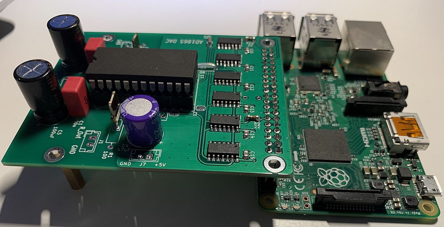

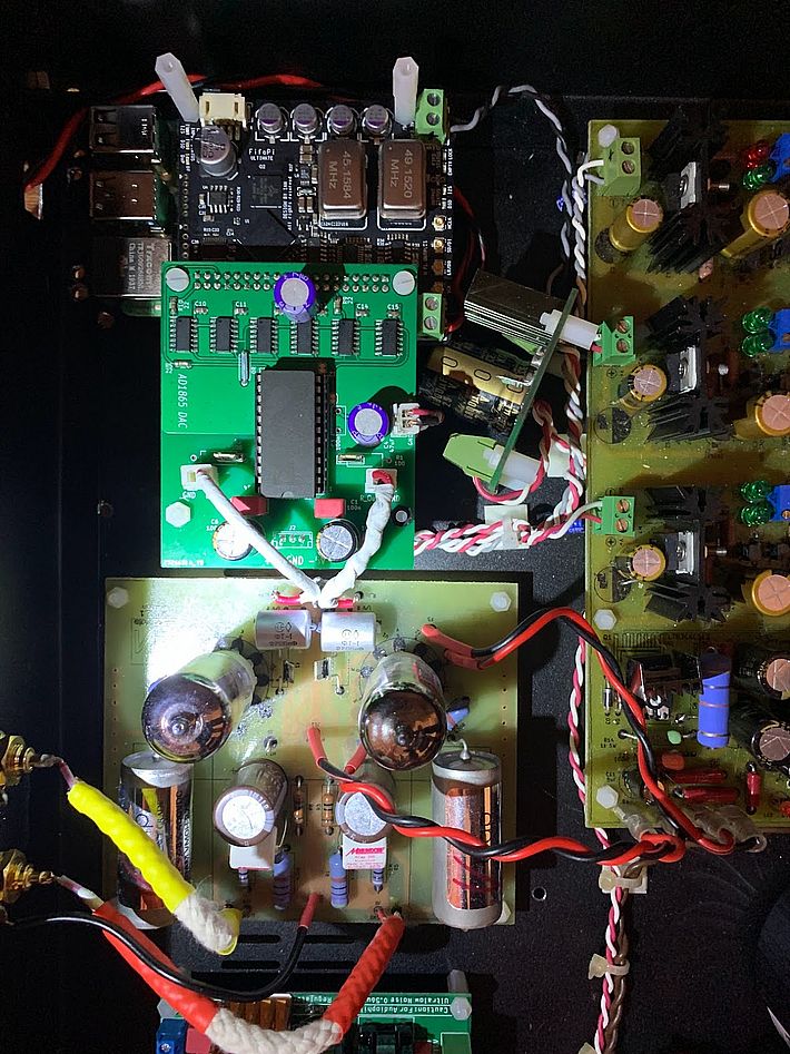

Some photo:
FiFoPi with I2sToPcm card
And the "final version"
View attachment 1030597 View attachment 1030598 View attachment 1030599
Hi Gaszto
Can you tell me the withstand voltage and capacity of the ODAM capacitor in the picture? How does it sound when you switch from a regular film capacitor to an oil capacitor?

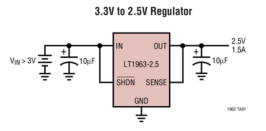

It means that for fixed regulators LT1963/3015, do not install parts used for voltage adjustment (resistors, capacitors, trimmer pot.) and connect the SENSE pin to Vout and SHDN pin to Vin with a jumpers. I think the fixed regulators +-5 and +-12V are still available from Mouser/Digikey in the TO220 case.I think with a little modification of the PSU2 PCB it can be installed.
When choosing a transformer, make sure that the LT1963 does not get more than 20VDC on the Vin pin. It means max. 2x12VAC secondary for 2x12VDC regulated output voltage. The LT3015 can do more, but positive regulators don't.
