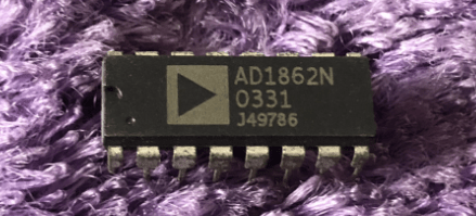

The markings on this chip looks different from those supplied by Rochester. Dubious? Or simply different period made?
@zoom777 Today prices for AD1862 from china are crazy. It is better if you buy it from a group buy and you can get 100% new chip.
Buy AD1862 from china only if you get a good offer (like under 12€ per piece) ... I did not found this price anywhere today :ROFLMAO:
i do have a pair from group buy here. But casually hunting for perhaps some spares and chanced upon the Chinese source. I am just wondering if the markings is of correct standard (yes, i know that does not guarantee it is a real AD1862). Will try out if at least the physical attributes are correct for a start. If AD does not have such markings in the first place, then it is not worth a gamble at all.
and yes, they are around 12 euro or so. from the pins on the pic , they do not look new. Great for testing new build if they are genuine at least.

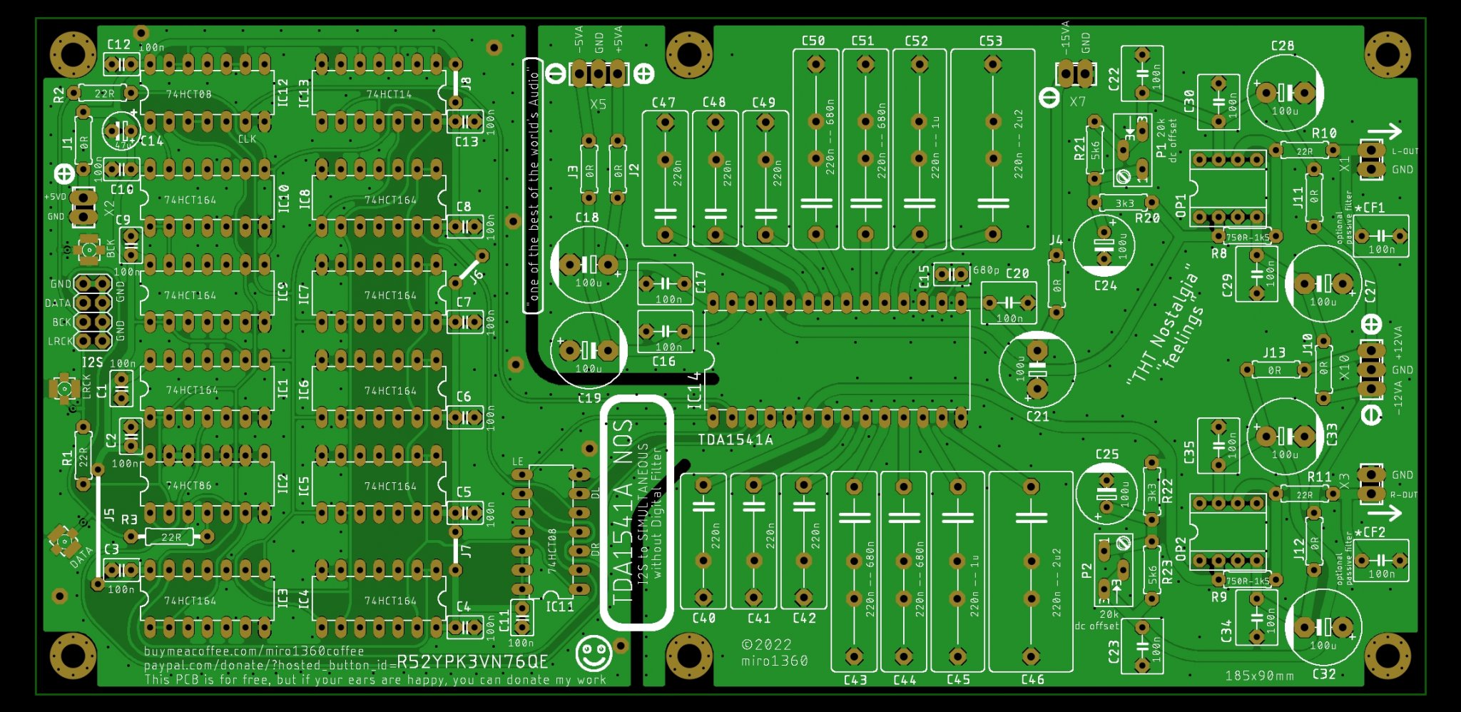

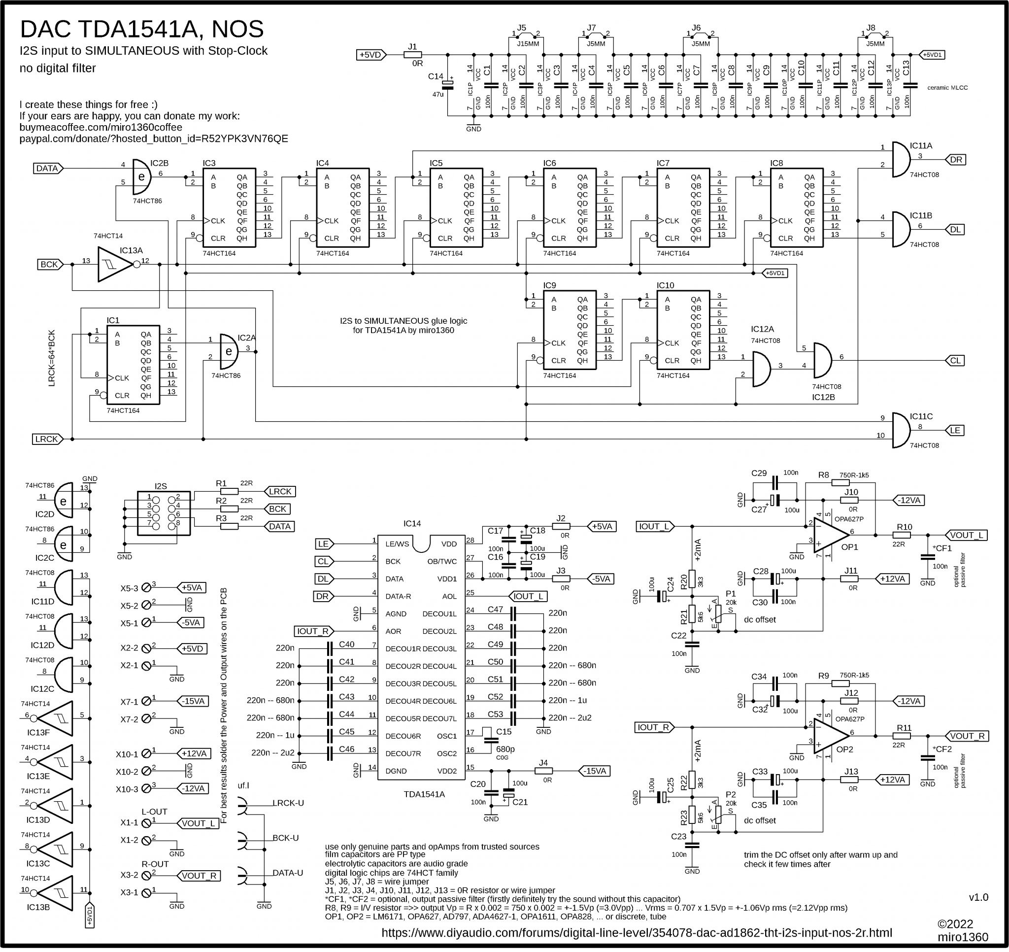

DAC TDA1541A by miro1360 :cool:
  • NOS, without digital filter
  • simultaneous mode (input logic converts data from I2S)
The long-promised DAC. I will put it in this thread because it follows the same topology as my other DACs, so you can objectively compare the sound.
The space around I/V opAmp should has enough space for sparkos and similiar opAmps.
Use only high quality components from trusted sources (especially logic ICs (and use only 74HCTxx family), capacitors and opAmps) ... TDA1541A from a CD player or eBay (this was my source).
CF1, CF2 is PP capacitor which should serve as an output filter (I didn't use it).

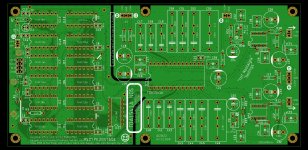

Build hints:
  • start with wire jumpers (let paper thin space between wire jumper and PCB)
  • install all resistors, digital chips, C1-C15 capacitors, sockets, connectors, trimmers, film capacitors and big electrolytes
  • carefully with digital chips, don't mix them up
  • triple check electrolytes for the correct polarity (otherwise they explode)
  • triple check everything (especially solder joints (cold joints, bridges), logic ICs positions)
  • put on safety glasses, connect power supplies and measure supply voltages on the pins in the sockets (IC14: pins 15, 26, 28 ... OP1 and OP2: pins 4, 7)
  • if everything is fine, disconnect power supplies and discharge all capacitors (insert 330R resistor between each power supply pin and GND directly on each power connector)
  • only after that install TDA1541A and opAmps into sockets
  • connect your I2S device (mine works with PCM2706, but you can use any)
  • put on safety glasses, connect power supplies and wait ... now carefully wait for possible problems (smoke, buzzing, explosions)
  • if nothing happens, touch all the electrolytic capacitors with your finger, they should be cold
  • measure DC voltage on the output connectors (L-OUT, R-OUT) and set it with trimmers to 0V (set as much as you can, if it doesn't go to zero, it doesn't matter yet)
  • turn it off
  • insert 100R resistors (or similiar) into output connectors
  • turn it on, play some music into resistors :ROFLMAO: and let it warm up for at least 20 minutes
  • stop the music, disconnect 100R resistors and again measure DC voltage on the output connectors and trim it
  • turn it off and wait for about 10 seconds
  • turn it on and again measure DC voltage on the output and trim it again as best as you can (now it should be at null ... if the null is out of reach (lets say <1V) then it could be achieved by modifying R20/R21 values)
  • try the music on your speakers or headphones
  • when you turn it on next day, measure DC voltage on the output again (after warm up) ... a few mV fluctuation is normal ... it highly depends on the power supply stability (if the voltage moves after warm up, so does this DC offset ... a more precise DC offset solution can be installed instead of resistors on the appropriate pins - but be careful because the sound is affected by this)
Power supply is shared in the next post and PCB has the same dimension (can be stacked).
After many tests, I decided to do it first with 78/79xx regulators from onsemi (I think these have an excellent sound, but you need try).
Of course any other regulator can be used here, but I highly recommend separating not only power supplies, but also their grounds (+5VD/GND1, +5VA/GND2/-5VA, -15VA/GND3, +12VA/GND4/-12VA .... GND1,2,3,4 are not connected together on the power supply, because they are connected on the DAC PCB). Therefore in the best case scenario, each power supply should have its own transformer winding.

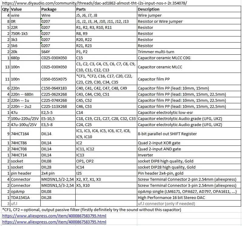

BOM example:
https://www.mouser.com/ProjectManager/ProjectDetail.aspx?AccessID=6c165f3903
https://www.aliexpress.com/item/4000867583795.html (2-Pin)
https://www.aliexpress.com/item/4000867583795.html (3-Pin)
Enjoy the sound fellas :hphones:

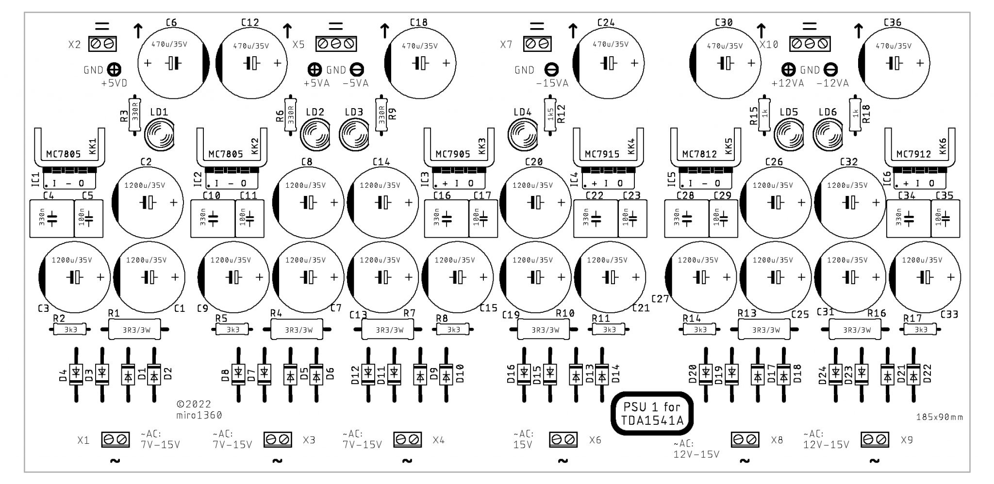

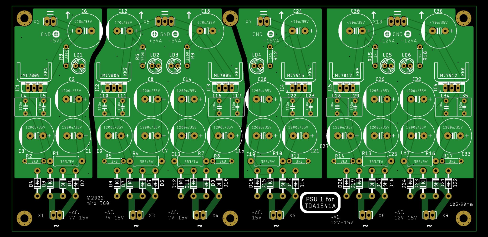

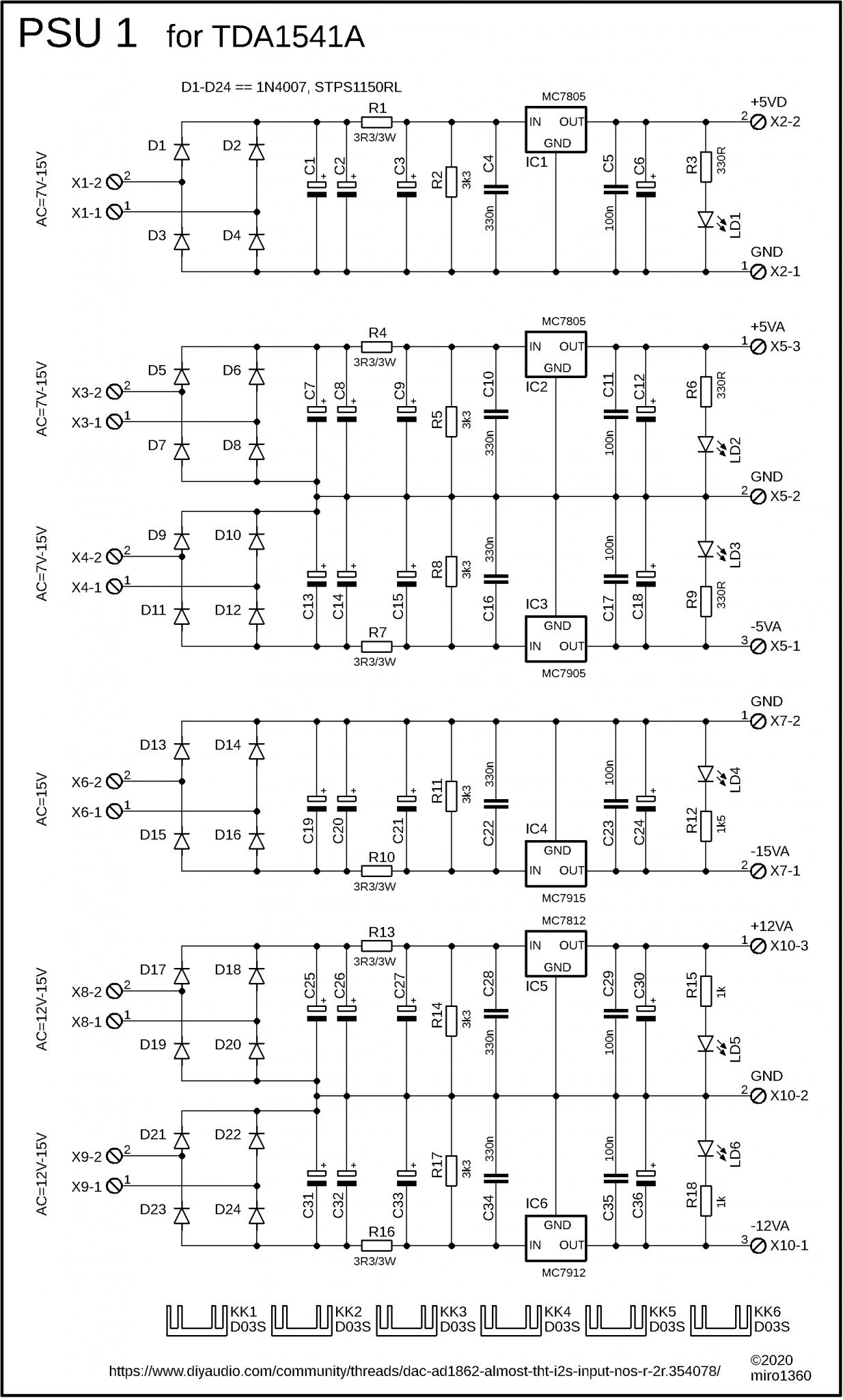

PSU 1 for DAC TDA1541A by miro1360
  • PCB has the same dimensions as DAC, so it can be stacked
  • Grounds are already separated for best results (connected in DAC PCB)
Use only high quality components (low ESR and Audio capacitors).
78/79xx regulators from onsemi (MC78xx/MC79xx, be sure you get these).
You are working with mains voltage, so very careful because it can be deadly and no one is here responsible for your life and health :Pirate:
Build hints:
  • start with diodes, resistors, connectors, LEDs, foil capacitors, big electrolytes
  • install heatsinks on regulators and put them into PCB (let a small space between heatsink and PCB)
  • triple check electrolytic capacitors polarity
  • install AC wires from transformers (you can first try them and measure AC voltages)
  • triple check everything (especially solder joints (cold joints, bridges), regulator ICs positions)
  • put on safety glasses, turn it on and hide for a while (watch for smoke or explosions LOOL :ROFLMAO:)
  • if nothing bad happens, touch electrolytic capacitors if they are cold (touch also heatsink - it should be cold or light warm because there is small current consumption yet)
  • now measure DC output voltages (and also AC input voltages)
  • turn it on and off a few times, everything should work without further settings

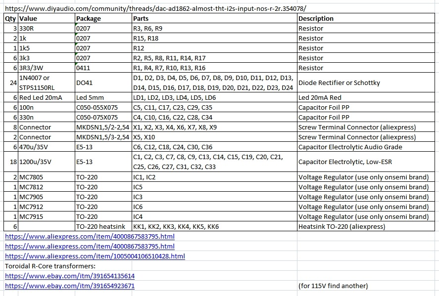

BOM example:
https://www.mouser.com/ProjectManager/ProjectDetail.aspx?AccessID=2e5d5e6ab6
https://www.aliexpress.com/item/1005004106510428.html (15x10x20mm)
https://www.ebay.com/itm/391654135614
https://www.ebay.com/itm/391654923671 (for 115V find another)
https://www.aliexpress.com/item/1005004127890102.html (35mm M3 screw spacer)
https://www.aliexpress.com/item/1005003411992910.html (M3 screws)
maybe a few M3 gaskets ...

Does the TDA1541 have offset output current ? Or similar to AD or PCM ?
If yes to offset current, is it stable over tm ?
How do you compensate for it ?
Patrick
I tried a few ... simple resistor split with smoothing capacitor (the best sound), jfet+resistor (it softened the music a bit, not good), CCS transistor with LED diode (good sound but sometimes problems with DC stability), 2 transistors ccs cage (problems with DC stability) ... so a simple resistor with stable power supply did the job :geek:
There is enough space for another experiments :) So far it is stable (+-2mA after warm-up, a few days testing) ... A DC servo would be nice but this affects the sound as it constantly does something ...
