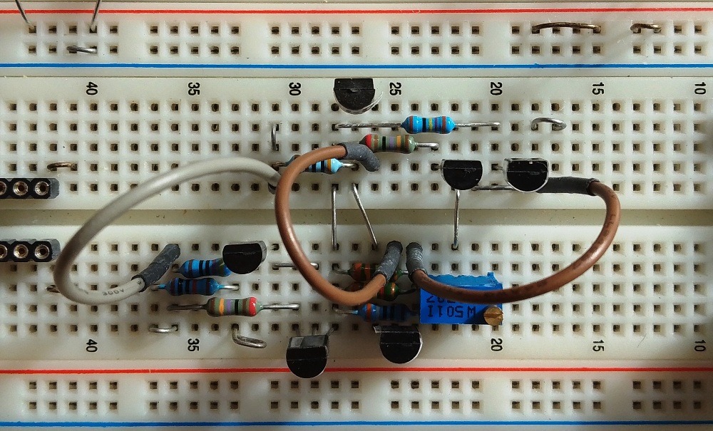

I put together a breadboard mock up on this Sunday morning.
Works first time.

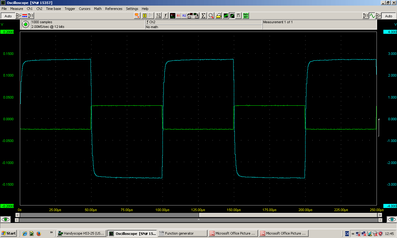

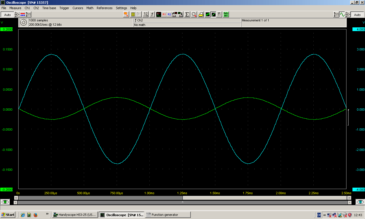

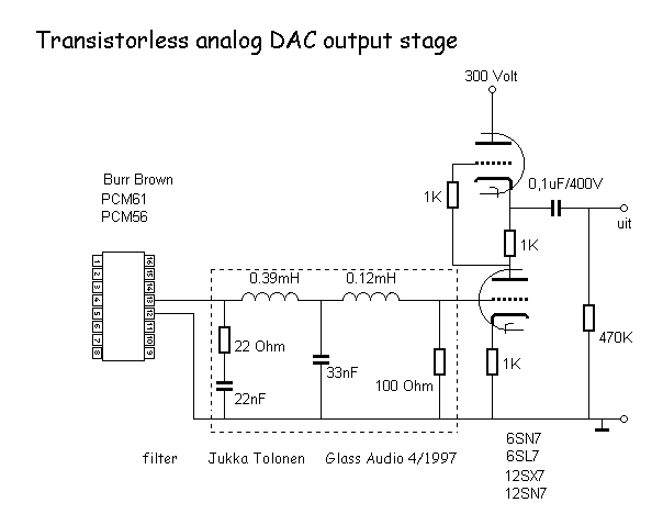

0.1uF 400V at the output is too small (capacity and voltage). 2,2uF/630V as a minimum. The required capacity depends on the resistance of the next stage.
The output resistance of this SRPP stage is not very small, like with OPA for example. The capacity of the interconnect cable can become an important factor depending on the length of the cable.
I would also avoid this LC filter. I doubt it has a positive effect on the sound. And for these Miro DACs it is not even necessary.
Why 400VDC capacitor is 'too small", if the plate power is only 300VDC ?!
In steady state there will be 150VDC on it.
400/150= 2.7 times spare!
P.S. As for me, better to use 5687 or 6N6P.
(and to be clear, much better to use OPA1656 in I/V MFB configuration, but this is another story 🙂)
Safety is the right word. If something unexpected happens, you can get 300V at the output. I know of a case where a 400VDC capacitor with a 250VDC power supply broke in tube preamp. It can destroy a transistor amplifier instantly. Capacitors are not perfect. That's why, to be safe, I always take double the voltage of the capacitor than the voltage of the supply.
As for the 6N6P, that tube has a big flaw. When you turn it on, it takes 2-3 hours to reach maximum sound quality, an eternity. And only those from the 60s of the last century sound really good. I've been building Aikido CF with that tube, and that's how it behaves.
I worked for many years in Power Supply R&D at Philips, and I can say - if 400VDC capacitor broke from 300VDC, it was defective. Normal 400V film capacitor in good condition - will never fail even at 400-420VDC. for a short time, and at 350-380V continuously.
