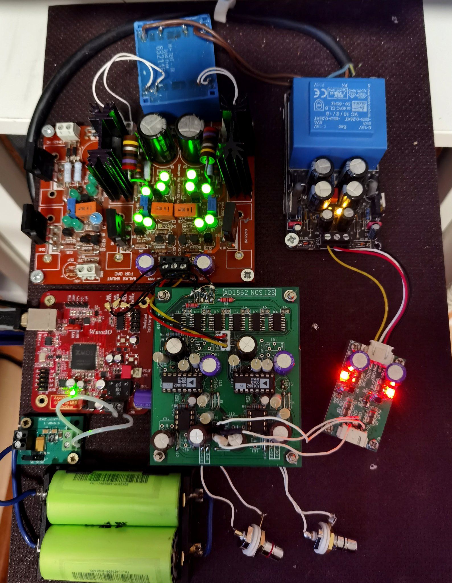

Thanks to the accidental death of my finally good sounding Soekris 1121 I felt the urge to finish the AD1862 dac, which I did successfully some days ago. Power supplies are some leftovers from former projects, nothing fancy, and for opamps I only had to contenders with the Opa177 and LM6171, of which I like the Opa117 more.
I have to say, that I didn't expect this little dac to sound that good.
I had a glimpse of it when Ernst visited me some months ago with his one, and the very good impression I had back then is veryfied by now.
Very organic and life like sound, I can listen to whole albums without skipping a track, which says something.
Out of frustration I bought a smsl D300 before, which I can sell now I guess, although it does sound pretty good for a Delta Sigma dac.
I did like the Soekris a lot as well, compared to the Miro dac it was more spacious and airy, but also less focused and more laid back.
Considering the very simple output stage it sounds absolutely remarkable, so of course I participated in the group by next door for Patrick's boards.
Surprising is the very big sensitivity for parts, it seems to matter a lot which part to put where.
Thanks everybody for making this possible.....

A picture of the usual breadboard...
with an old Quanghao first gen Salas Shunt, not so good actually. Battery powered LT3045 for WaveIo, and a supply for a long gone Curryman dac as preregulator for a China LT3045 12v reg.
I will build a second one, this time with the PSU2 for a neat and tidy build.
Btw, I became aware today that the bom
for the PSU2 is around 100€. On top of that the LT3015 is not available anywhere, so I'll stick with what I have for now. Still have some BIB Salas Shunts, will save them for the +-15v for Patrick's circuit.
This project is really fun...
