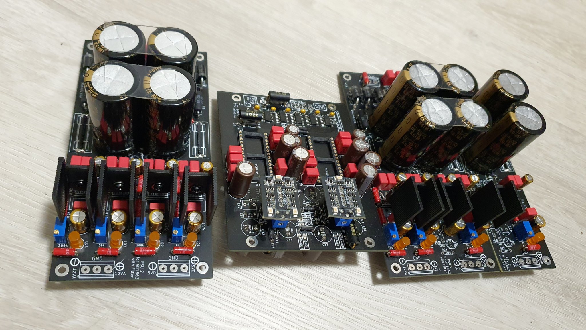

Beauty!All done (except for heatsing for jlsounds xmos +5v ldo, debating if i should go larger). Man i love black pcbs 😁
Jlsounds board and toroid transformers are incoming in a week or two, so i'll put it to work asap 💪🏻
Could you please share why do you need so many PSUs? One more is for jlsounds?
😊Beauty!
Yeah one is for xmos chip for jlsounds (to the far right, it is the most mA). First board from left is +-12v for opamps. +-5v for analog. Next board -+5v for digital. Remaining +5v on it is also for jlsounds board.

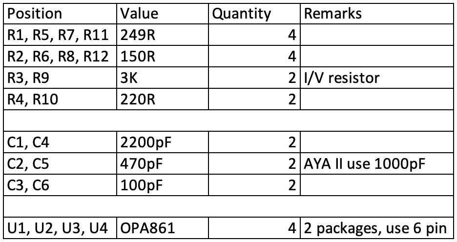

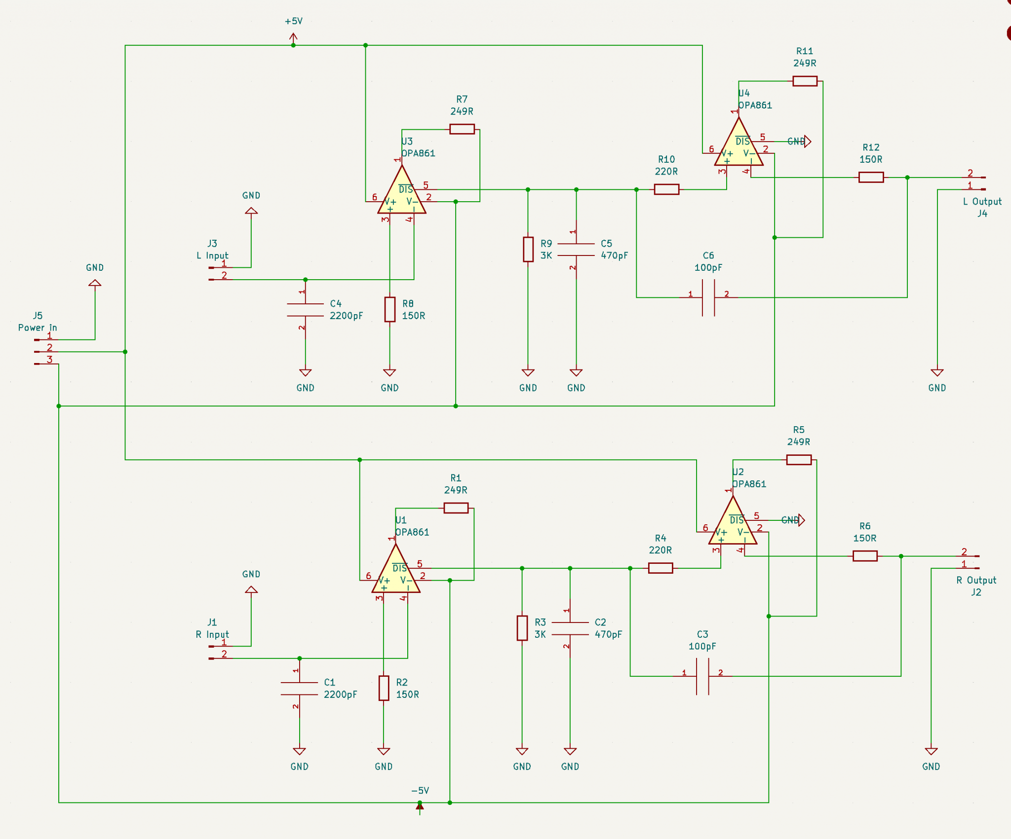

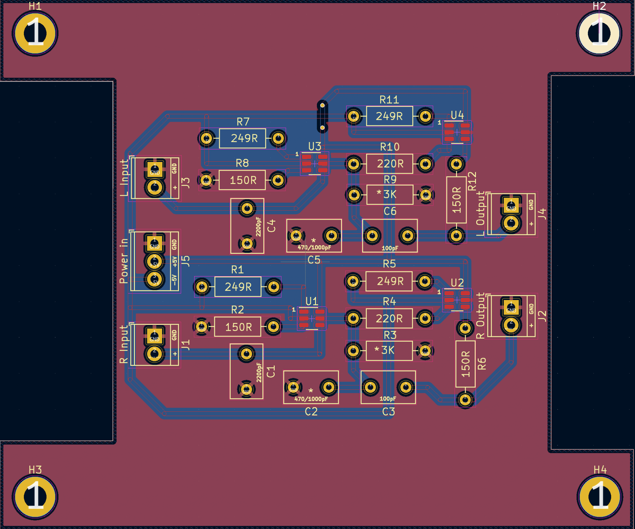

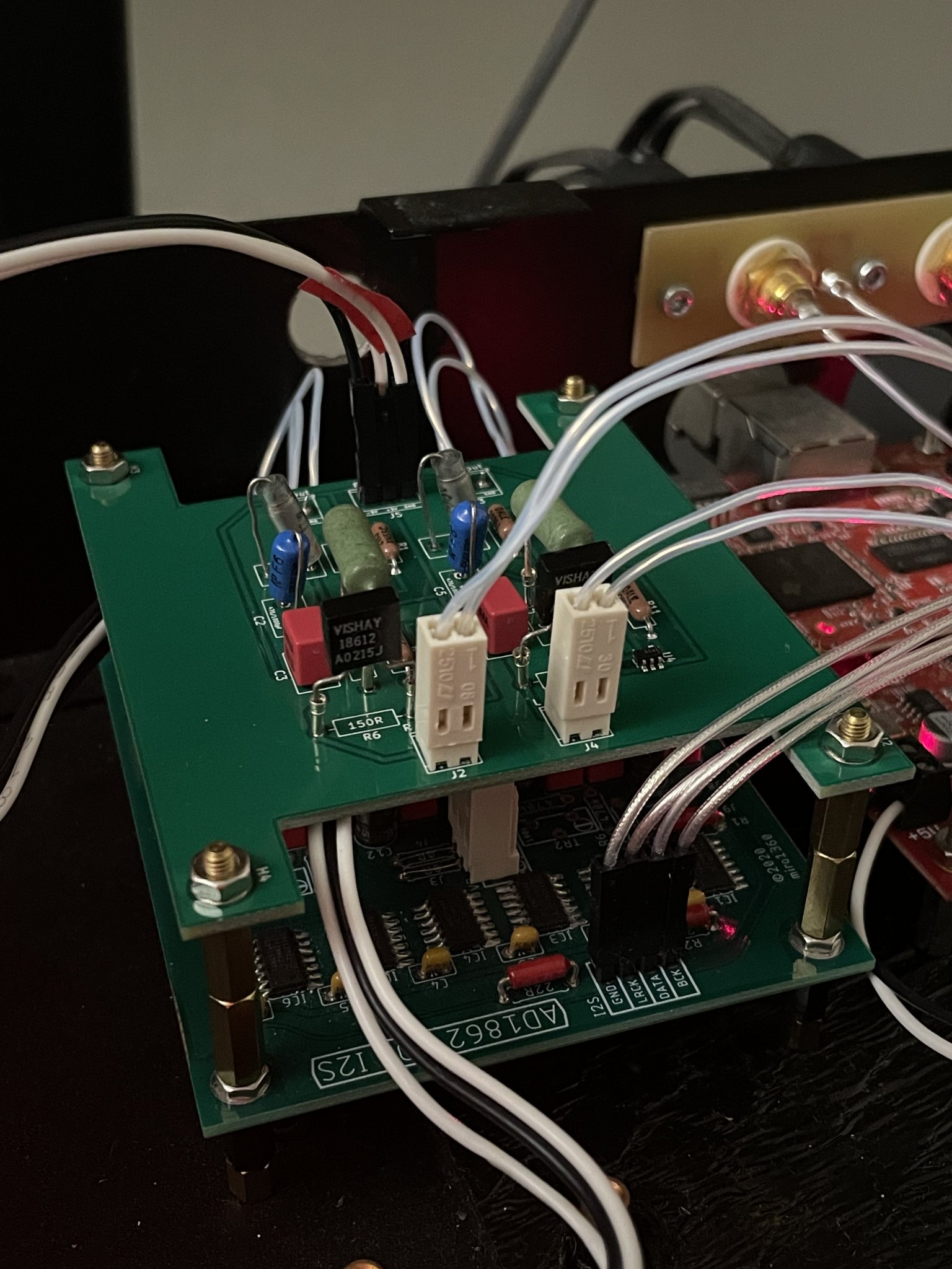

I was playing with different I/V resistors, it was fun. Then, I came across @Vunce's OPA861 I/V build #1417. I want to make a set but realised the SMD soldering of the TPS7A39 is not an easy task. Taking it as an adventure and learning process, I took Vunce's schematic to draw a through hole version board using KiCAD.
