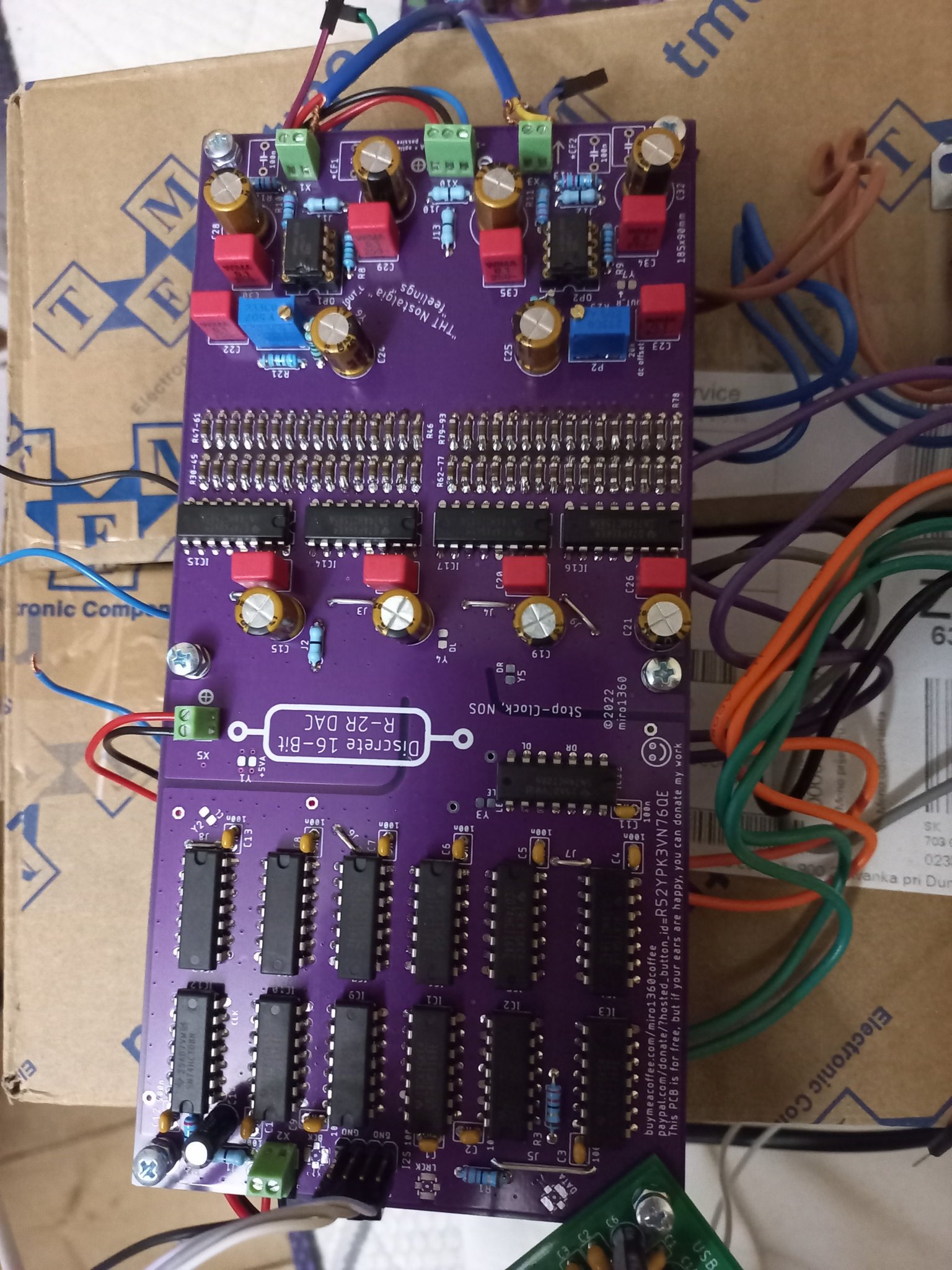

Miro’s board has capacitance options for the 14 DEM capacitors. Is there a method for picking the “ideal” value for these caps?
Use my values Vunce 😉

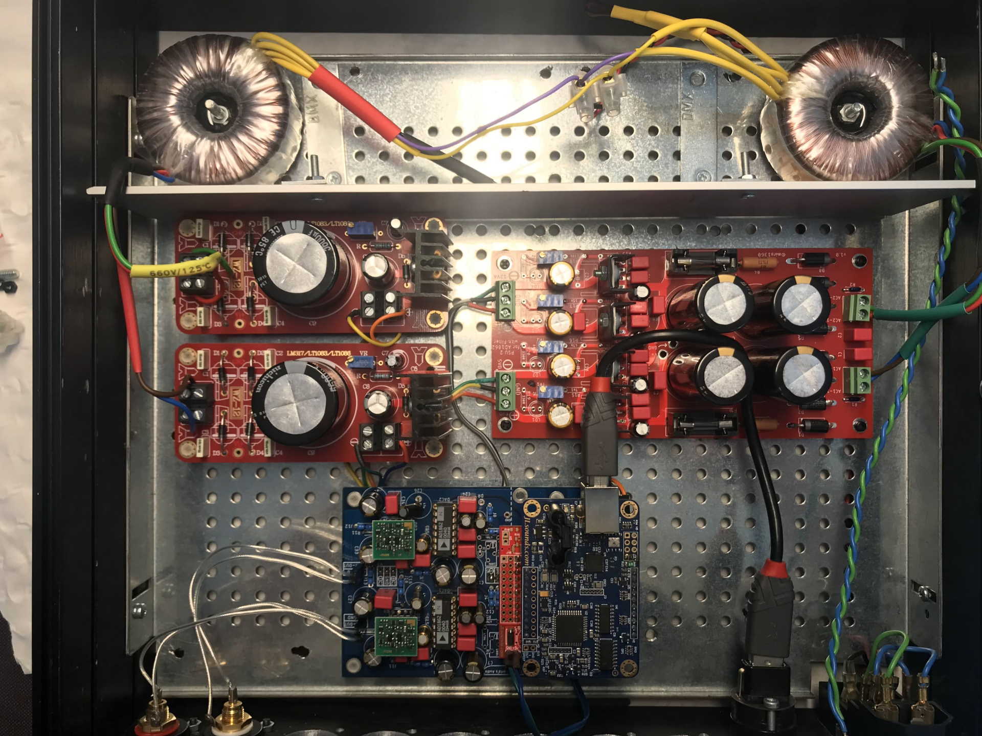

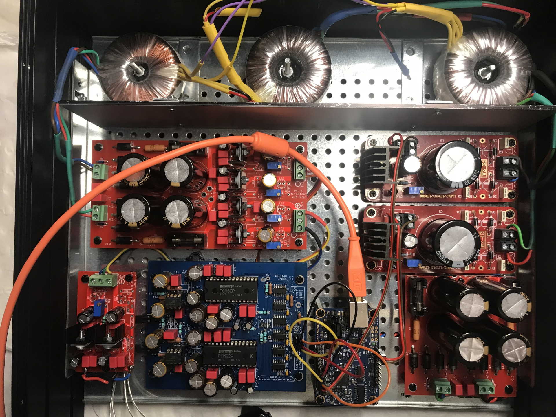

Perfect, congratsAnother PCM63 and AD1862 is working. Thanks @miro1360 .

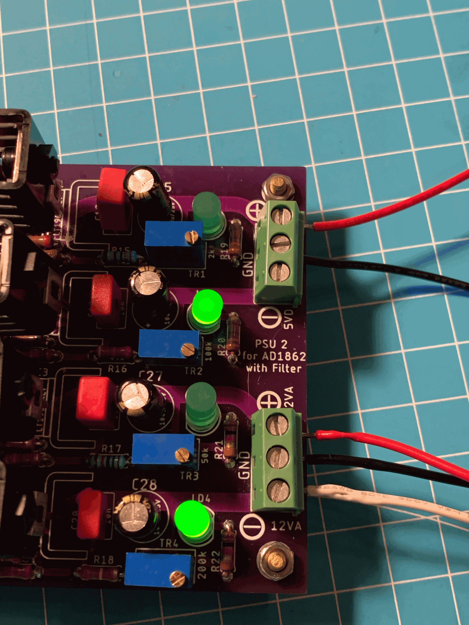

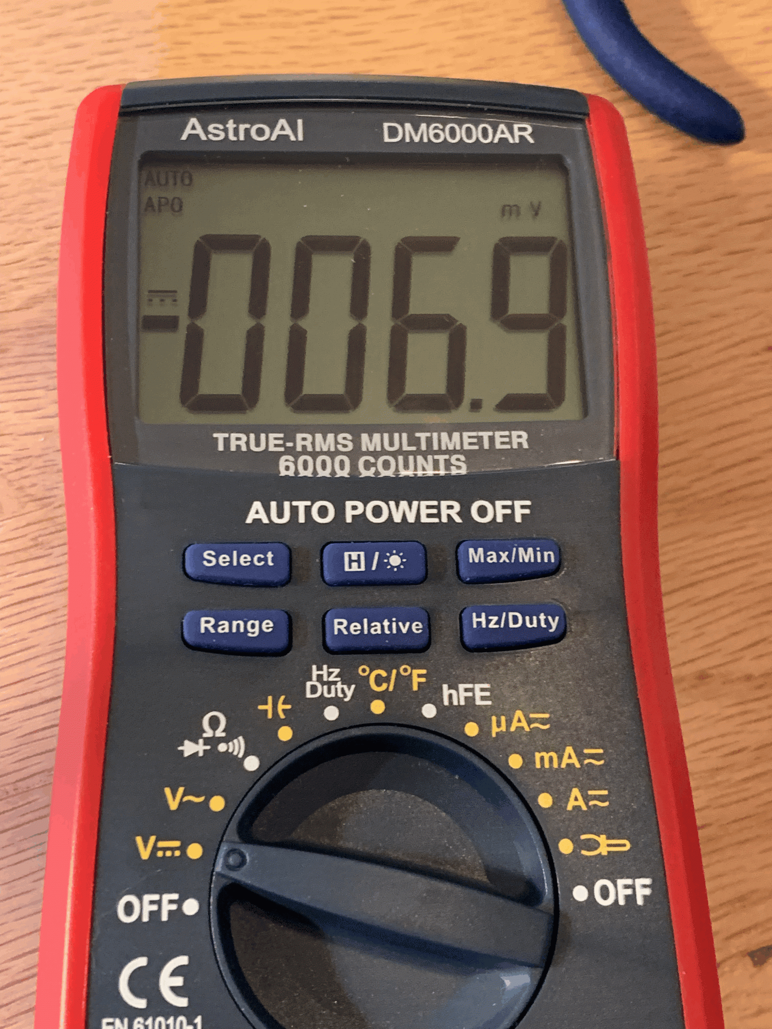

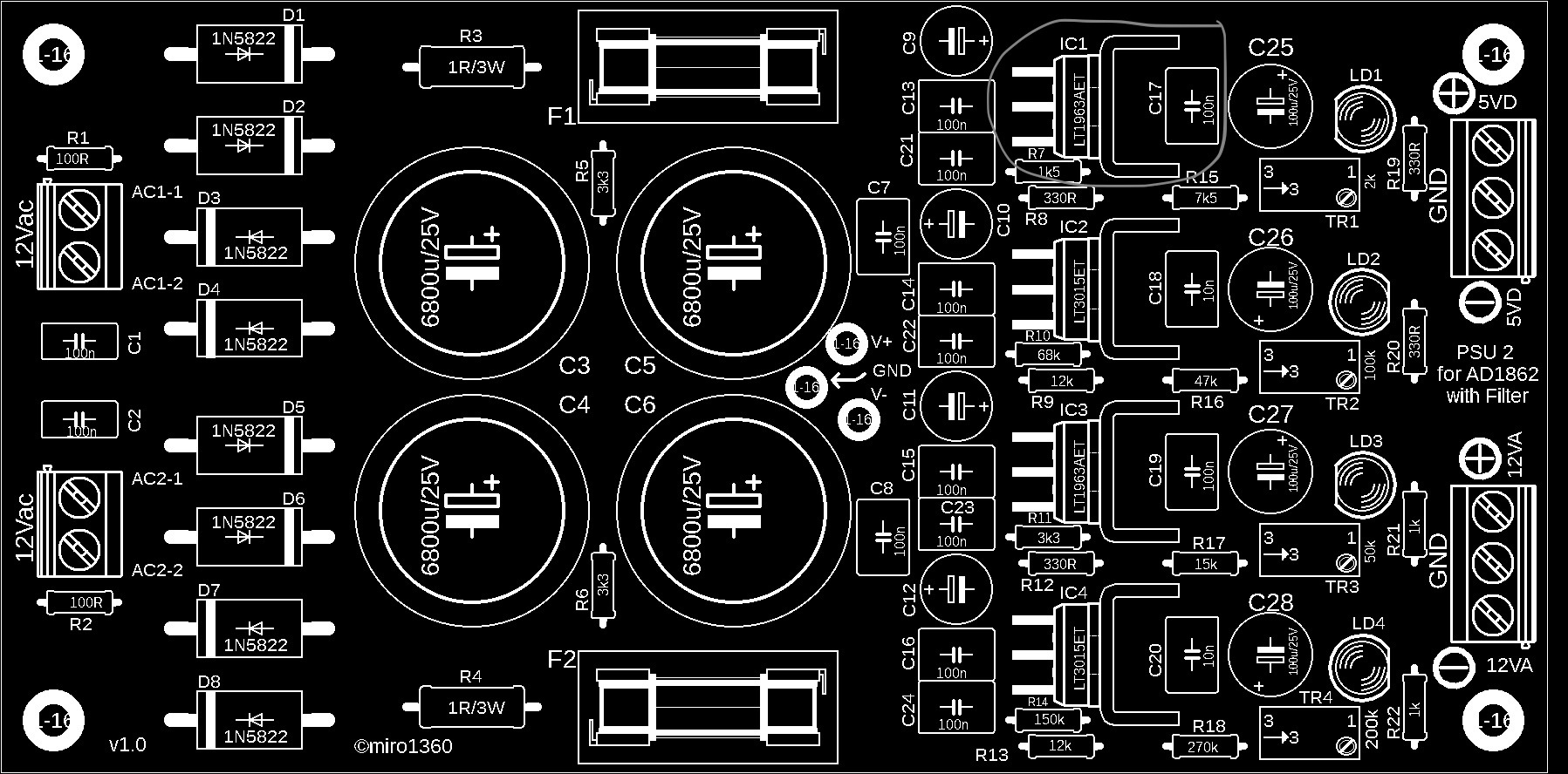

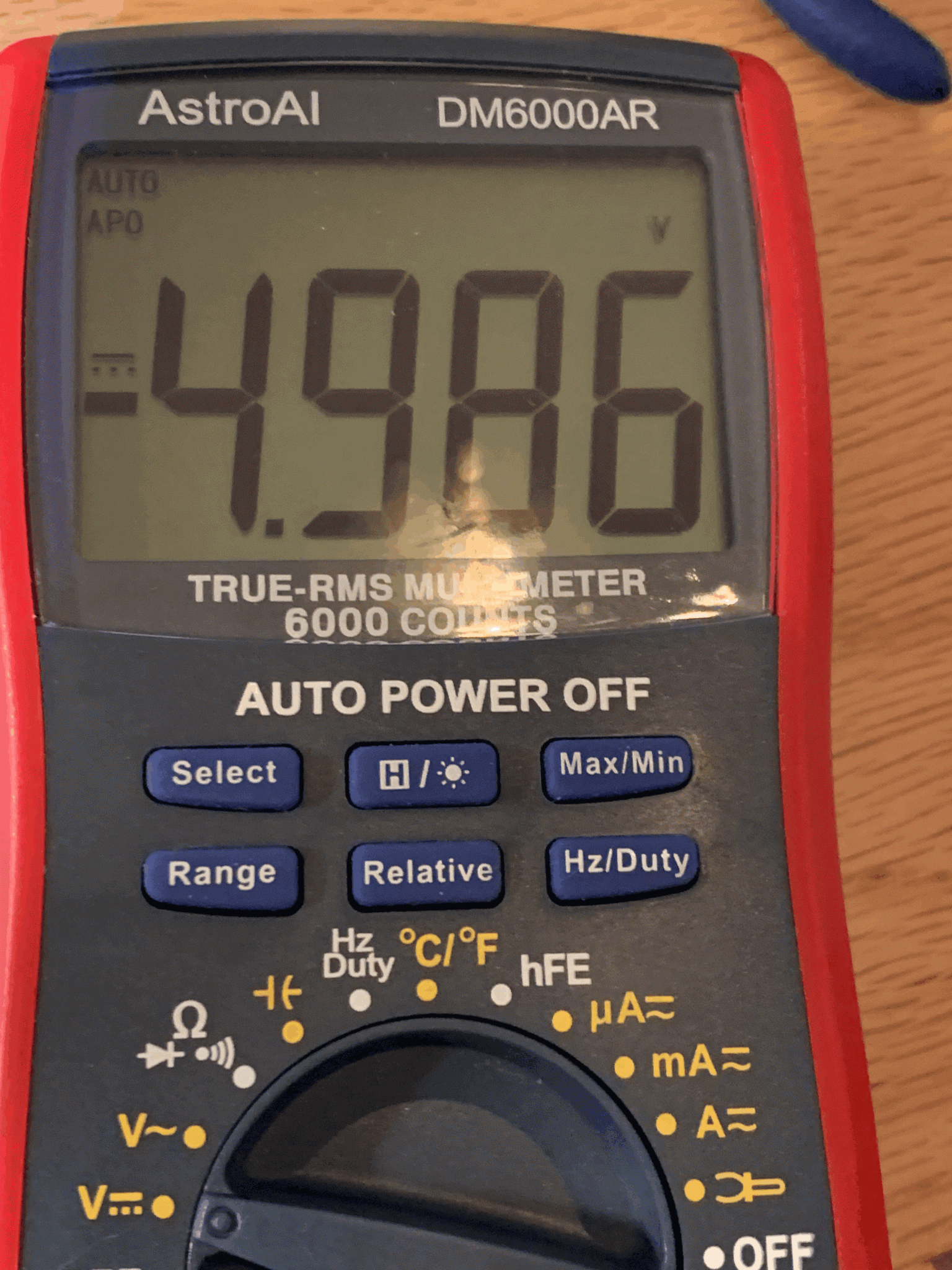

Yeah, the resistance is 0 between +5VD and GND 😢@Vavilen When you measure resistance between +5VD and GND on DAC pcb, is there short or not?
What is the regulator name? Is that adjustable version or fixed?
The regulator is this one: https://nl.mouser.com/ProductDetail/584-LT1963AET#06PBF
Thanks Miro!This regulator has internal protection against overload. Is not the fuse in powersupply broken? Or is the voltage between these 2 pins?
Next task will be to find the short on +5VD on DAC pcb![]()
Phew, it's a fuse!
Where would you go first to trace the shortage on DAC pcb? Or just randomly checking between two points related to the +5VD?
Thanks!

So pulling parts from my stash, I have a combo platter of TH PP film capacitors to use in these values:The value of capacitors in audio is never enough LOOOL
0.1uF C40-42
0.3uF C43, 44
1.0uF C45
2.2uF C46
C15 (Cosc) = FKP2 680pF
The only 220nF caps in my stock are MKS (polyester)

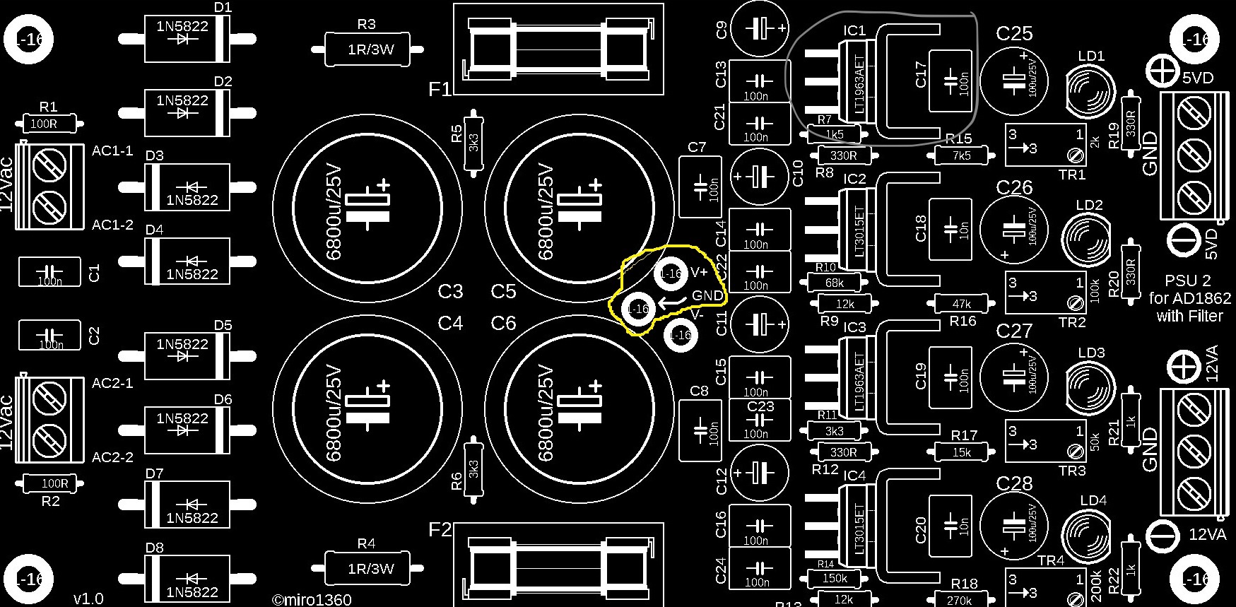

Exactly aj @Brijac told, most probably it is somewhere near a solder joint. (if you check the PCB, GND plane is very close to each solder joint)Thanks Miro!
Phew, it's a fuse!
Thanks!
... if not, than remove J9 jumper and measure ...
