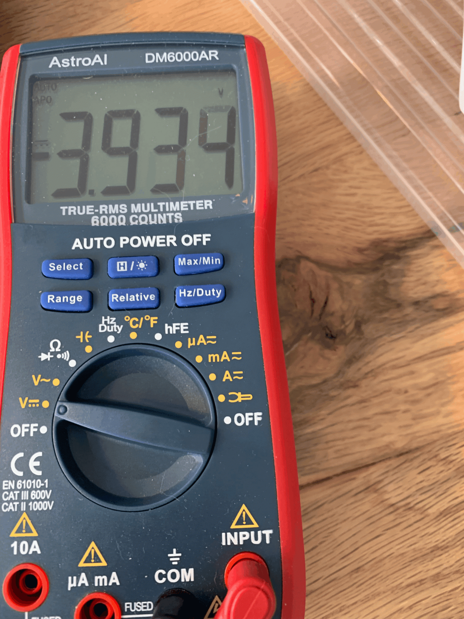

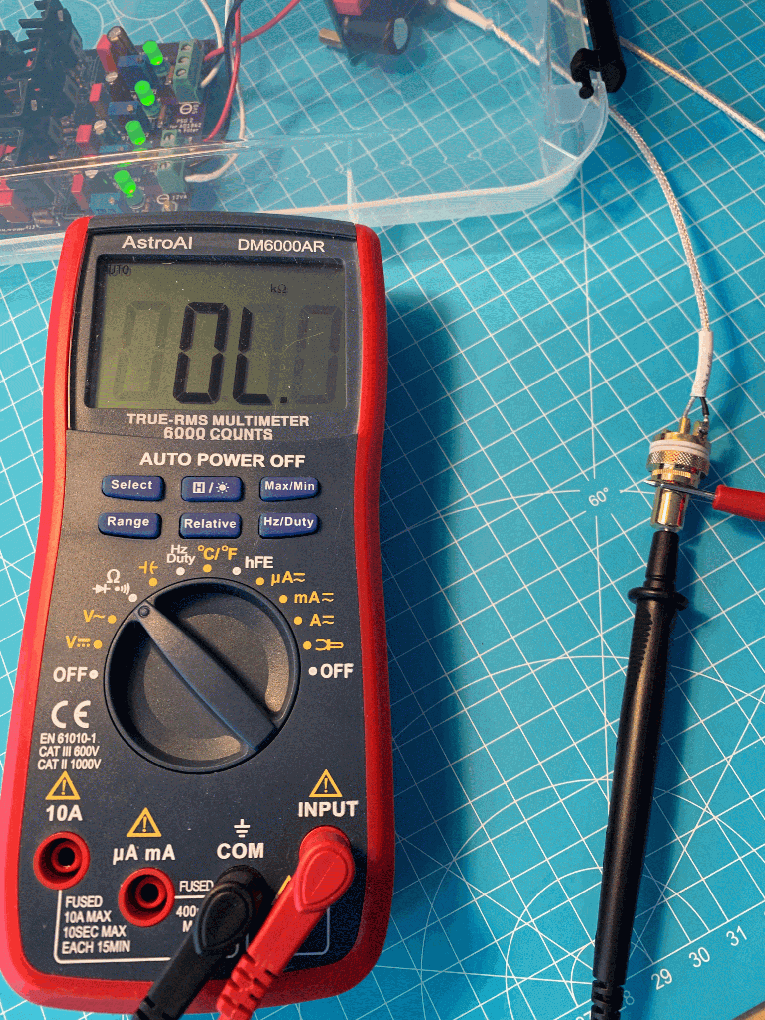

Hey guys,
I made some measurements on the AD1862 DAC's outputs without installed chips and oamps.
- Impedance when it's turned off.
It shows 2MOhm 🤔
Another channel shows 4MOhm
- Impedance when it turned on.
It shows 0L.
Another channel shows 100KOhm
- Voltage when it turned on.
it was showing around 4V and going down slowly.
Another channel shows around 500mV.
This is quite strange, right?
Do you guys have approximate correct values for DAC the outputs?

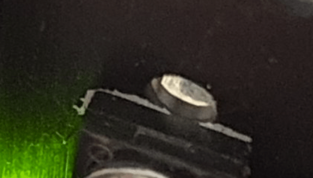

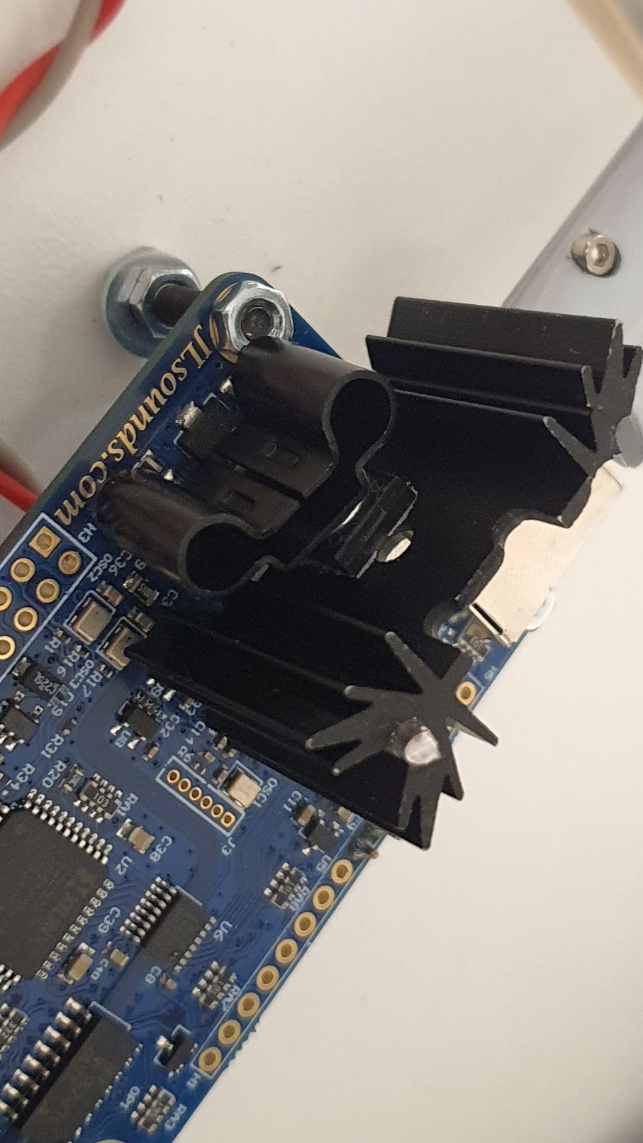

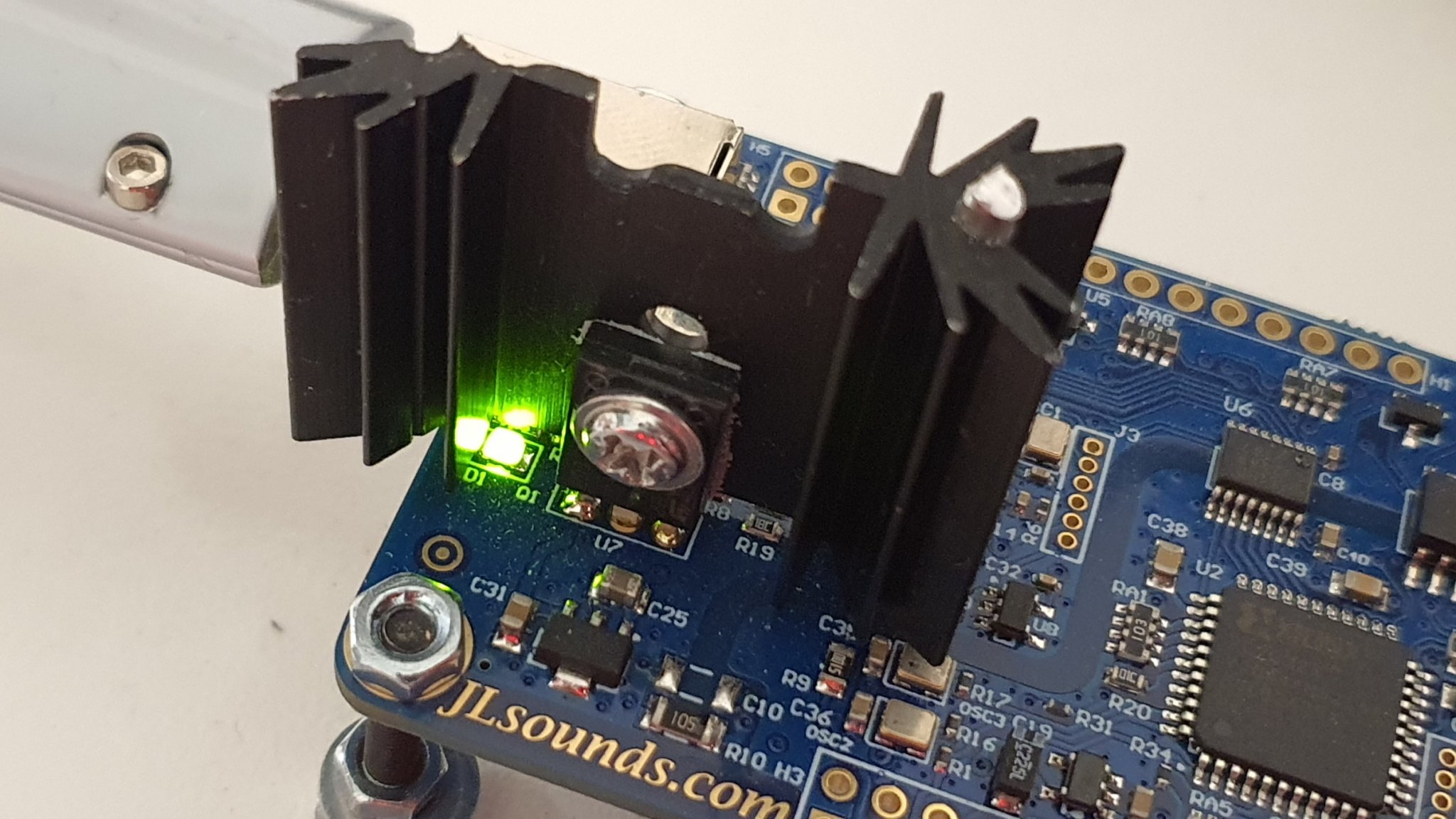

Btw, if you use jlspunds board, my advice is to change the heatsink on the regulator (xmos supply). It is piping hot even with lower supplied voltage (i supply it with 4.6V). It is lukewarm to the touch now, while it was fingerprint erasing hot with default heatsink.

i see. i thought i saw the mounting hole on the heatsink is above the tab of the regulator , hence i assumed is not screwed on. Thanks for the tip. I have this board on the way to me.No, regulator has a hole, so i used bolt and a nut as you can see from the picture. Original is slip on, and it has no paste either. I used thermal paste.
I agree that the regulator does indeed, get hot with the supplied heatsink, but I surely would not use a heatsink of that type on this application. There’s no way to securely mount it to the pcb and could lead to shorts if it was bent and touched surrounding components.
hmmm, maybe i will desolder and mount it under the board, mounted to the chassis base. any info on this transistor?I agree that the regulator does indeed, get hot with the supplied heatsink, but I surely would not use a heatsink of that type on this application. There’s no way to securely mount it to the pcb and could lead to shorts if it was bent and touched surrounding components.
Yeah those bigger heatsinks usually have a couple differently spaced hokes. You can use a bit smaller heatsink though, factory one is really bad.
@Vunce yeah, it needs isolator below. I'll be mounting different one when i pack it in box. Nixie will use a smaller to220 one, and if it does the job, i'll mount the ones i mounted on psu ldo's, 17c/w.

Those are from Mouser. And PSU voltage is correct. Do you think it can drop down because one of the ldo's is damaged?Where did you buy ldo's from?
I'm building the analog part emulation in LTspice to get reference values on outputs to understand which output channel is actually incorrect.

I ordered these from a local shop, I think they are around 20k/W. Before that, I reduced the heating by putting a 1N4001 diode on the output of the +5V regulator, the voltage drop on the diode is almost 1V at 400mA (dissipation is 400mW on that diode). So now the XMOS is powered with about +4V, which is not a problem because that regulator is for 3.3V and there is another one behind it for 1V. Now it is hot but not too hot as before.
