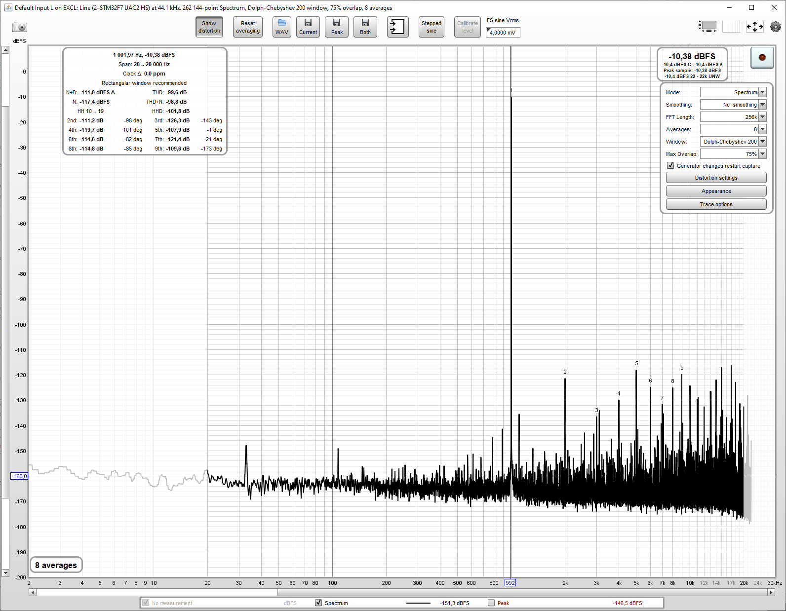

Something for those interested in PCM1702. Denon used a L-grade version of PCM1702 in many of their mid-level CD-players. Datasheet does not mention L-grade and there seems to be confusing information in some web-sites. Some believe L-grade to be a lower grade as in PCM56 while some believe it is higher grade. As I have an old Denon CD player not in use I decided to pull out the PCM1702 L chips and try them out in my PMD100+PCM1702 dac.
Here is a measurement of PCM1702L at 0dBFS (IV+LPF is OPA1612). Both my L grade chips measure about -98dB THD+N which is similar to K grade.
Gradings are basically there to tell you that there was more quality assurance/slower precise manufacturing. You can get J chip that performs better than K if you're lucky. Look at it this way, if you drive faster to your destination, you will reach there faster but there are many more accidents in the process. And if you drive slower, you will reach destination slower but there wont be nearly as much accidents on the way there. Same with manufacturing and grading in these chips. Btw there should have been a batch in pcm1702 series that would be equivalent to Y grade pcm63p for yamaha, and it has been requested by denon but they wouldn't spring for quantity and price.

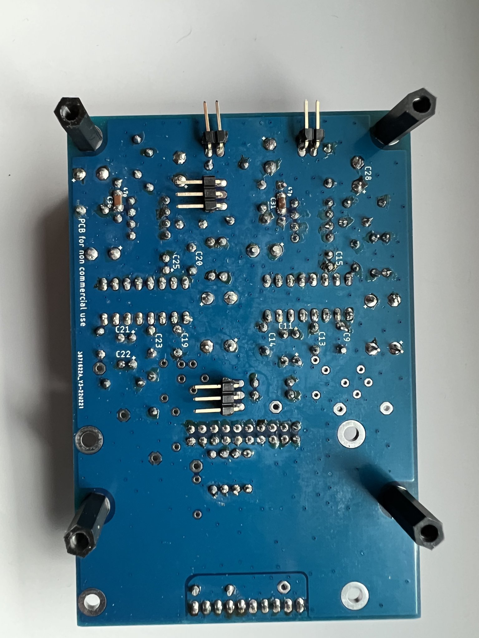

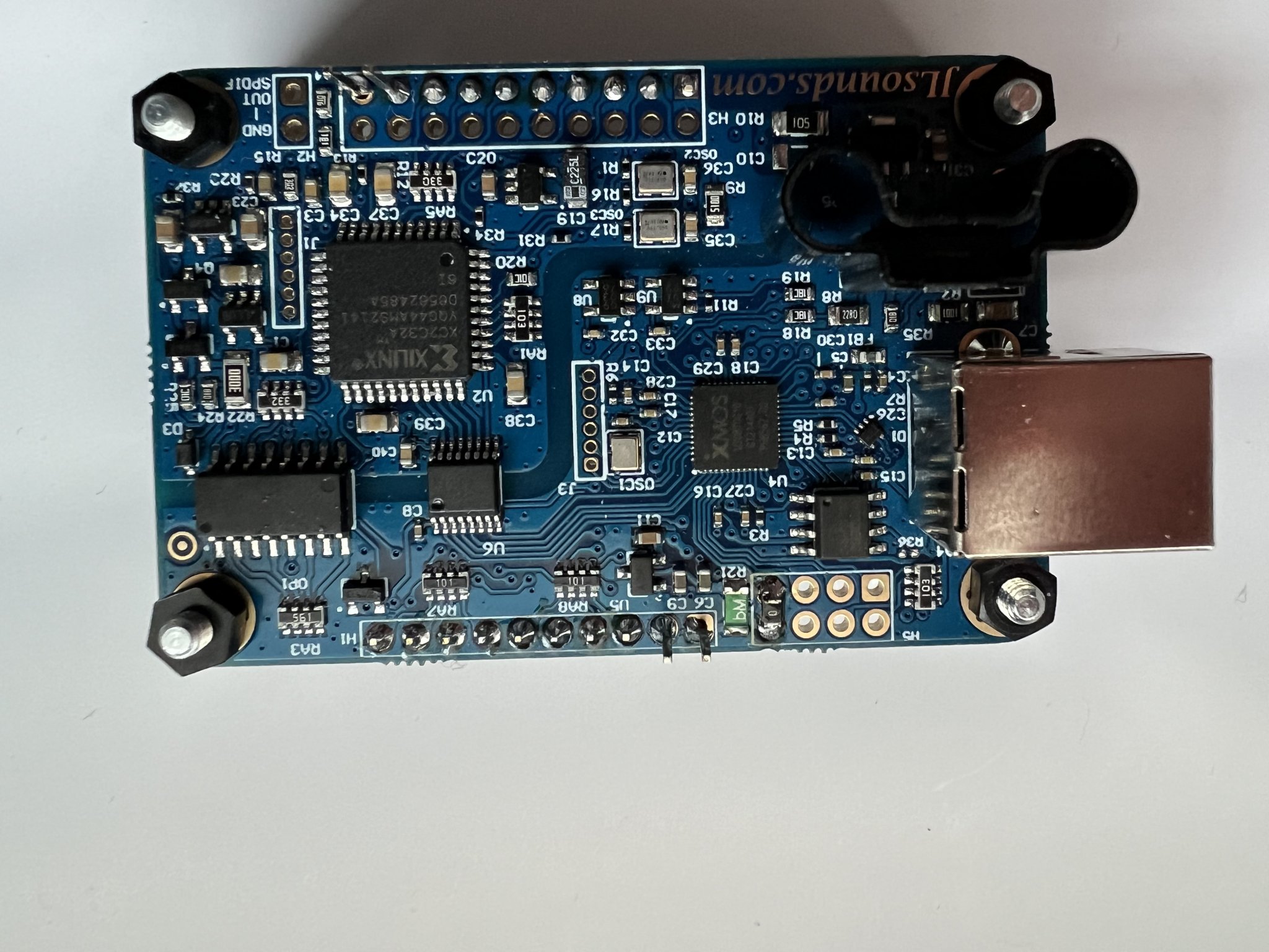

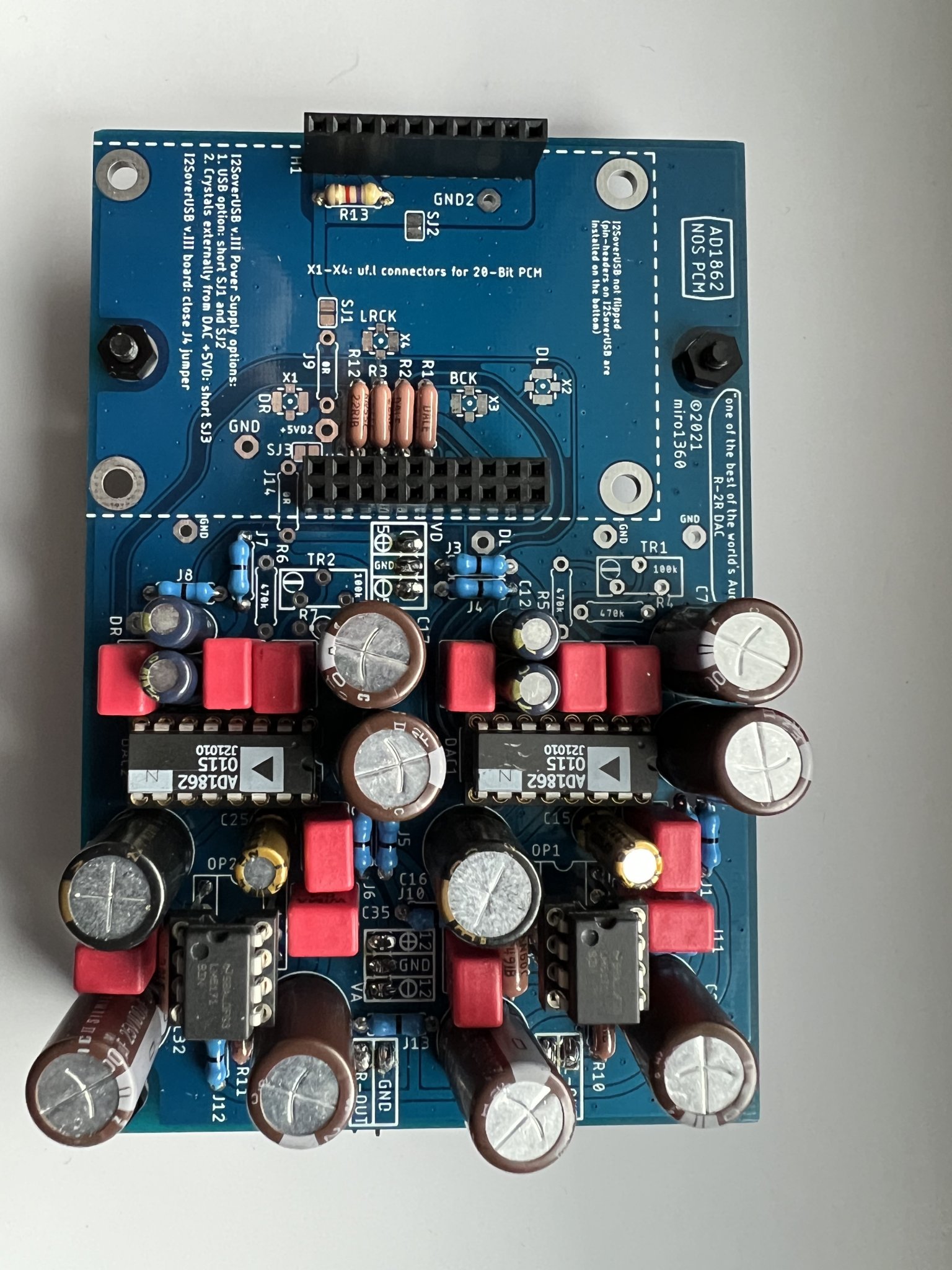

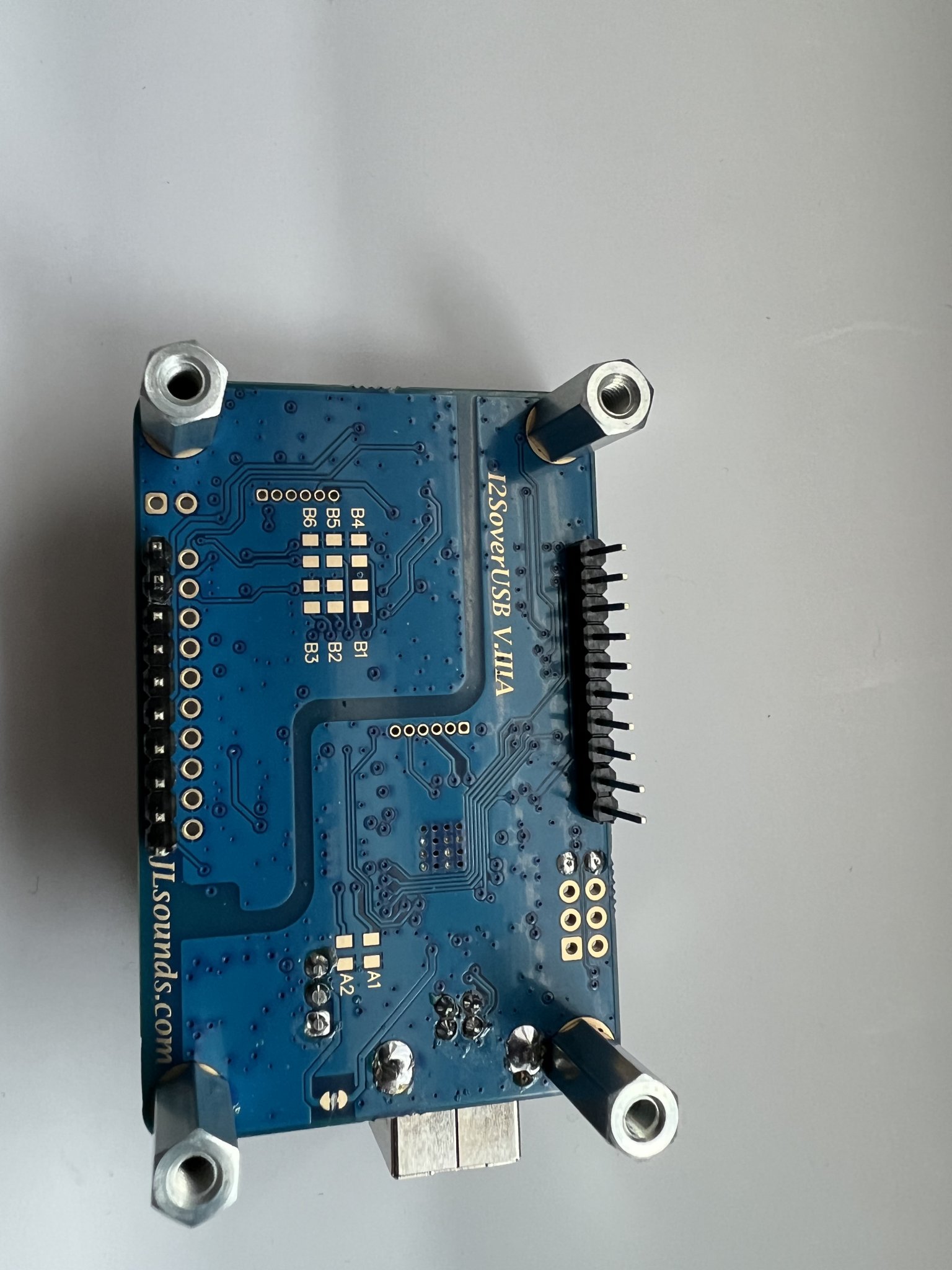

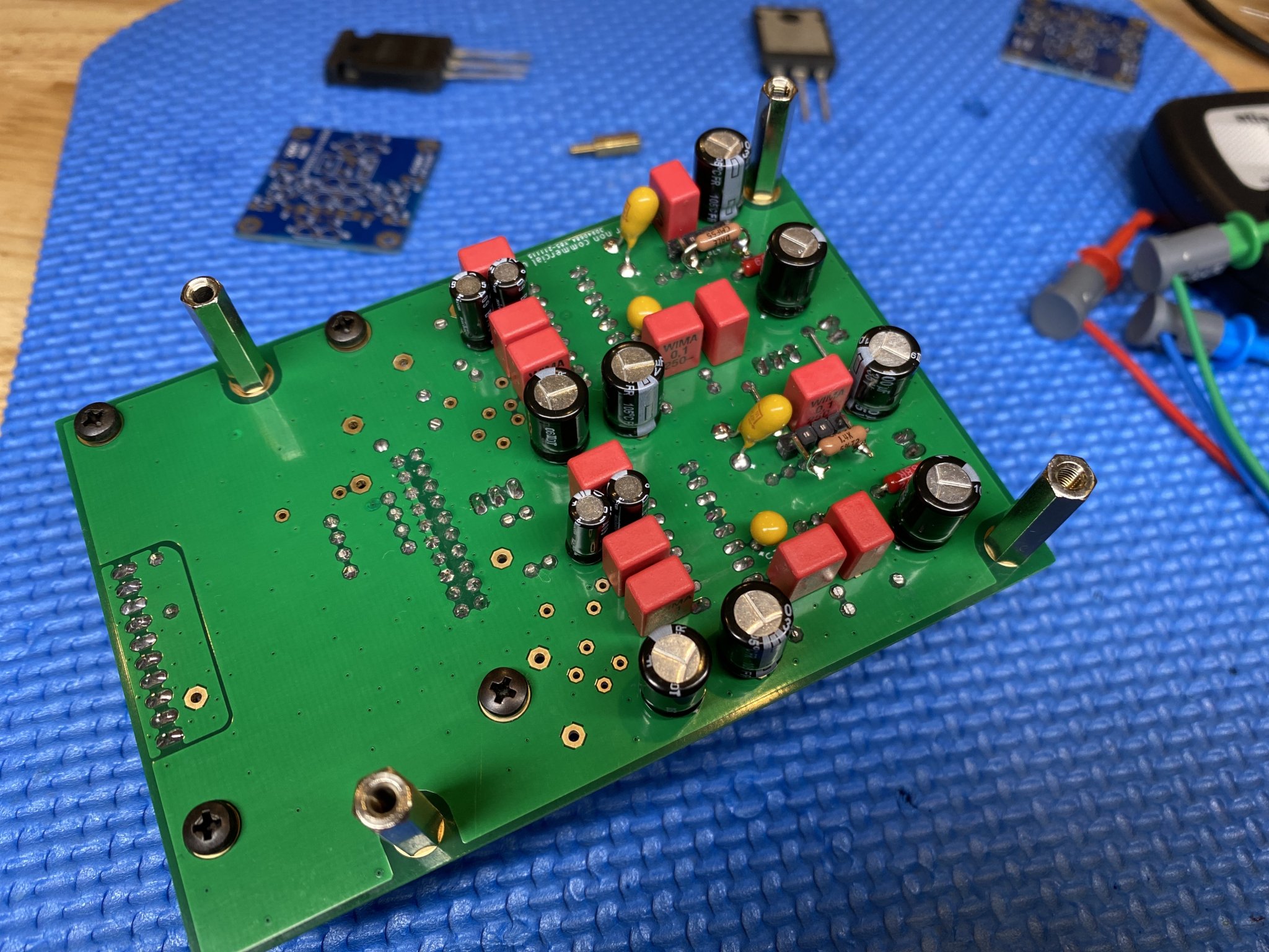

So, my Miro's DAC with AD8162 is almost ready. I use PCB for stacked I2SoverUSB not-flipped. It's now playing, but I've noticed a strange problem and I'm wondering where to look for the cause. There is mixing of the sound between the two channels - if something should only be heard in one channel, it is heard in both. I use I2SoverUSB configured correctly personally by Lyuben. I personally assembled the DAC and I tend to look for the reason there. With another DAC, I'm testing the rest of the system and it's working as expected. I would appreciate any ideas...
Insert jumper at J14 and short SJ3.
Why are the opamp sockets elevated from the board? This could possibly cause oscillation, especially with LM6171. Opamp sockets should mount directly on the pcb. Mount the surrounding components under the pcb to gain access to the opamp sockets.
Thanks Vunce,Insert jumper at J14 and short SJ3.
I have powered the I2SoverUSB board independently with two separate power supplies for the usb and isolated part. Therefore, J14 and SJ3 are open. As it plays normally I will consider moving items down.
@Milen It can be problem with the opAmps position as Vunce said. Put with fingers one filtration capacitor (with shorter legs) between +-12V opAmp pins and another one capacitor on the second opAmp and hear for a difference. Capacitors should be rated at least 35V.
