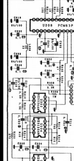

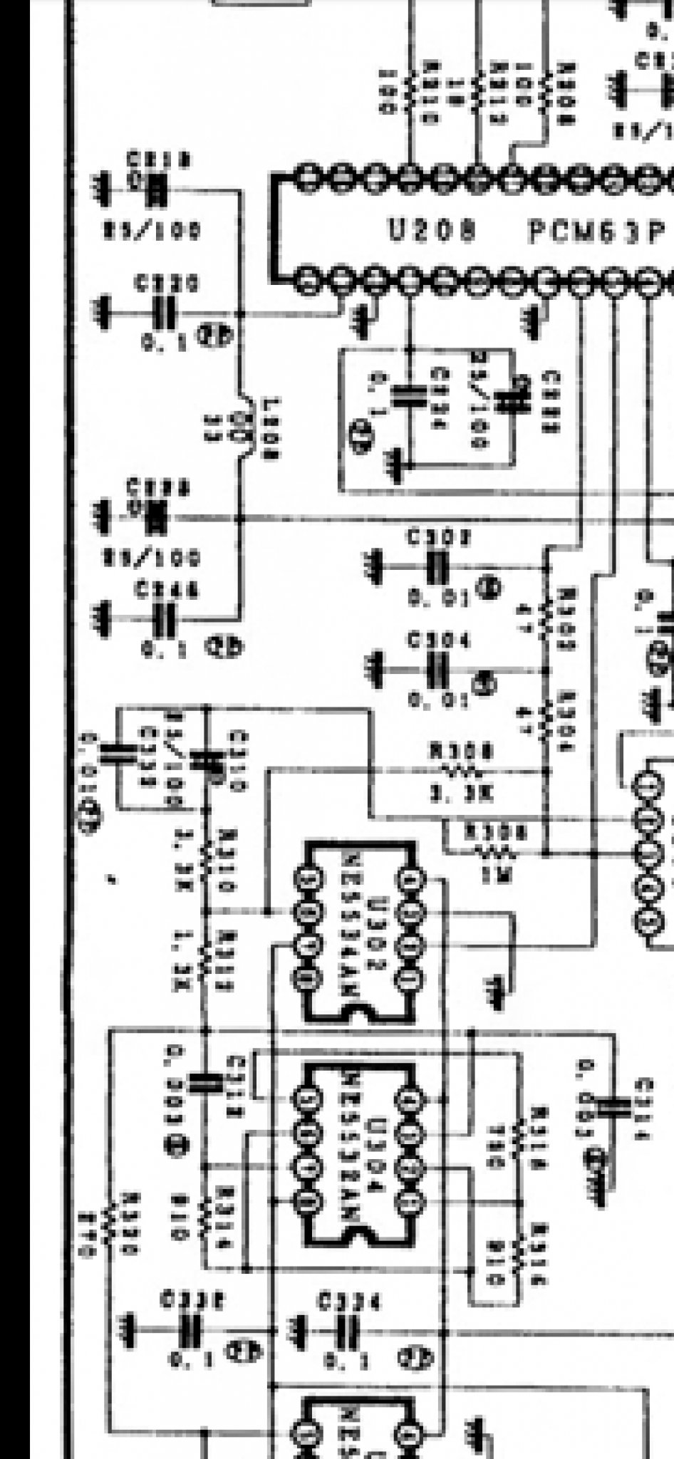

Yours is a good question.
R2R Dac's are supposed to have high output impedance, though at the end, in practice it's not infinite high, smthing like 1kohm for a PCM63. AD 1862 could be higher though.
A typical opamp I/V converter topology could be also called a Trans Impedance Amplifier, because it absorbs the DAC output current in the -IN feedback node, and converts it into a voltage output with it's transimpedance gain, in this case Rf= 1,5kohm.
Because of the high impedance DAC output the gain is closer to 1 than anything else. So an amp with gain >5 stability criterium will be driven to instability.
But there are ways around it. At the price of accepting a loss at high frequencies, a shunt capacitor to ground placed close to the -IN node of the opamp is presenting a low impedance path at high frequencies in the 'gain' leg of the circuit, which now with the 1,5kohm Rf will give an actual >5 gain factor at high frequencies at re-stabilizing the phase margin.
This is called a 'noise gain compensation' technique for an opamp not unity gain stable.
Here I attached an extract from the SM of a Rotel RCD990, with PCM63 + NE5534 as I/V converter.
+ little help with reading the critical path
That’s a very good explination. I could not find the impedance of the chip. ThanksArnold,

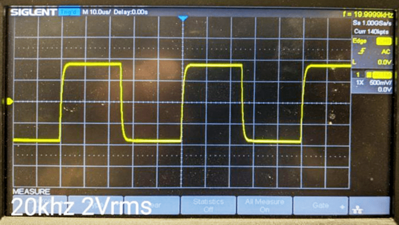

This is quite and dirty functional test, using components on hand (and not by me ).
Final version will have better components.
And nice & clean 20kHz square wave output, using a functions generator and a resistor to generate input signal current.
No Civ used, just 27R Riv.
Patrick
Patrick

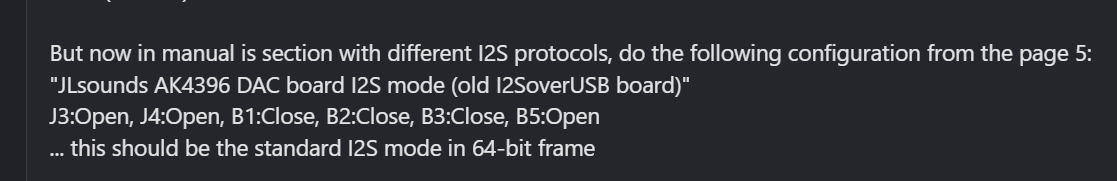

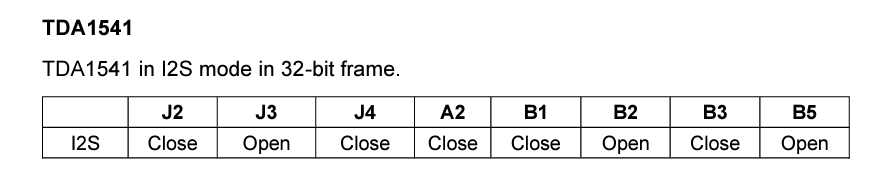

Hello @Vunce , you used the following i2s protocols on the JLSounds i2sOverUSB as in post #617?Pulled the DAC board and did another visual inspection, no shorts or solder bridges. I decided to swap out the Singxer C1 USB to I2S converter for JLS I2SoverUSB board configured as in post#617.
Or the i2s protocols as stated in the user manual page 5 under I2S Like Protocols On Board Oscillators for TDA1541?
