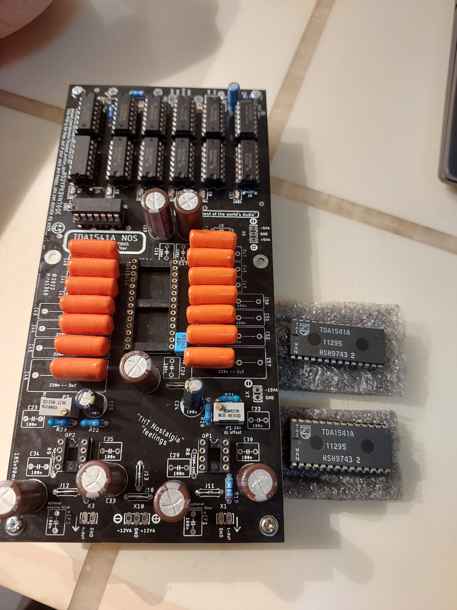

Just wondering what's the lowest dc offset possible for your tda1541.
I have completed two boards, one board can be trimmed to 0.6v and another 0.455v
and i can see that the tuning the variable pot does not make much difference for both boards.
i believe the dc offset should be able to get down to the mV range? Both tda1541 chips work properly in my another day which has the opa2604 as output but without dc offset adjustment since the output is cap coupled.

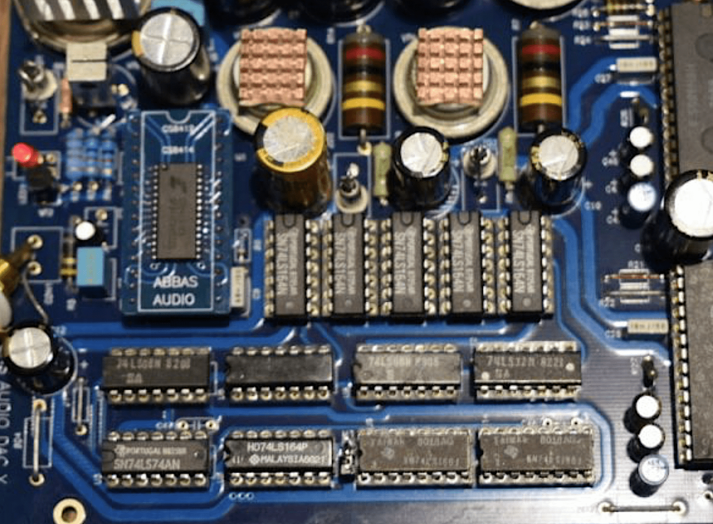

@Zoran I know him under nickname "Nemo" from another forum. You can recall our old conversation about that design:
https://www.diyaudio.com/community/...et-binary-no-cpld-no-fpga.341478/post-5885606
... He send me his altera files, I tried his design as glue logic from SMD components and it did not work for me (I assume timing problems). In CPLD it can work but I have not tried it.
That is why I created different design, more glue-logic friendly approach. I tested and debugged it for a long time until it started working.
Creating the working glue-logic is pretty hard, because of timing issues. Altera simulation sometimes does not match the real glue-logic.
A lot of not-working prototypes are in my altera folder 🤣

With Current injection of 2mA. I trimmed the offset with numerous TDA1541A to 0mV. And it remained constant stabile.
These values are huge (045V-0.60V)... Take a look at the data sheets abs of 0.025V is recommended as max offset.
