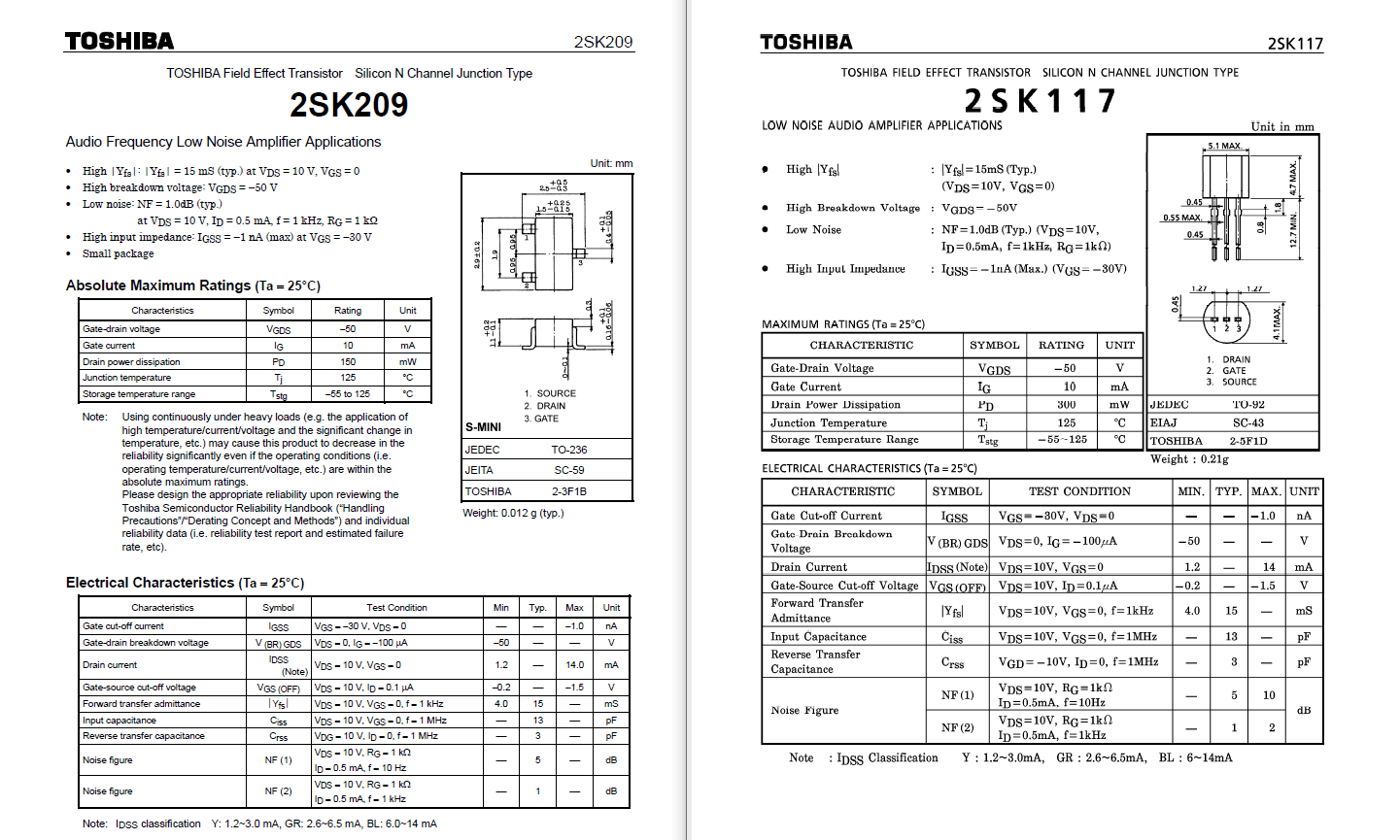

2sk209 is the SMD derivative of 2sk170, so you can still do a fully through hole version of the same. But I wanted to design with parts that are readily and cheaply available. Possibility to use other n-channel jfets including Linear Audio ones with minimal changes.

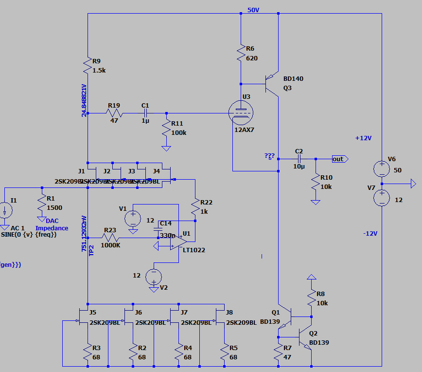

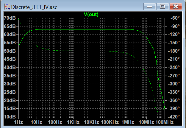

As a continuation of the Idea to keep the DAC simple. Here is an idea for a discrete I/V converter running on the same rails as the DAC.
JFET based IV converter with no GNFB, minimal part count, Low pass and highpass are built in.
Very Low THD and Noisefloor in Simulation.
Did you simulate the PSRR of this circuit, especially to the positive rail ?
Patrick
If I compare the datasheet, I think it is more like the SMD version of 2SK117, with much reduced dissipation.

Hello PatrickDid you simulate the PSRR of this circuit, especially to the positive rail ?
Patrick
The PSRR is very low. But the initial idea was to power it off the same low noise high psrr Rails as the DAC. +/-12v.
Later on I realized it only looks good on simple simulation. But when simulated with DAC output impedance of 1500ohm (worst case of AD182, based on spec sheet), it did not hold the scrutiny, Needs multiple parallel 2sk209BL in parallel and a higher positive Rail voltage to reduce the input impedance to meaningfully low level that it is not affected by DAC output impedance.
After multiple direction Changes, This is what I ended up with (18 ohm input impedance). Planning to prototype this.
Mallik .

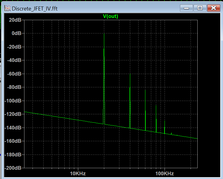

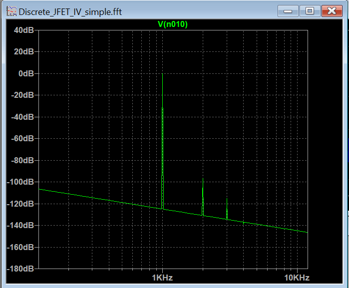

Hello patrick,
Here are the PSRR results, it is non existent . Exactly the reason why it has to be run on the same high PSRR rails as the DAC. (walt jung PSU or a CRC followed by 7812/7912)

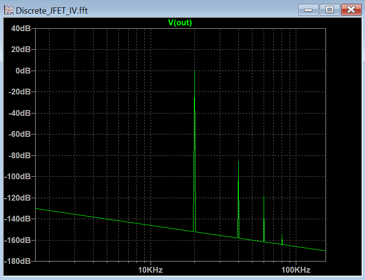

Here is the THD sim with single pair of JFETs.
Wanted a THD of -80db or lower, so aborted the single pair version.
Mallik
