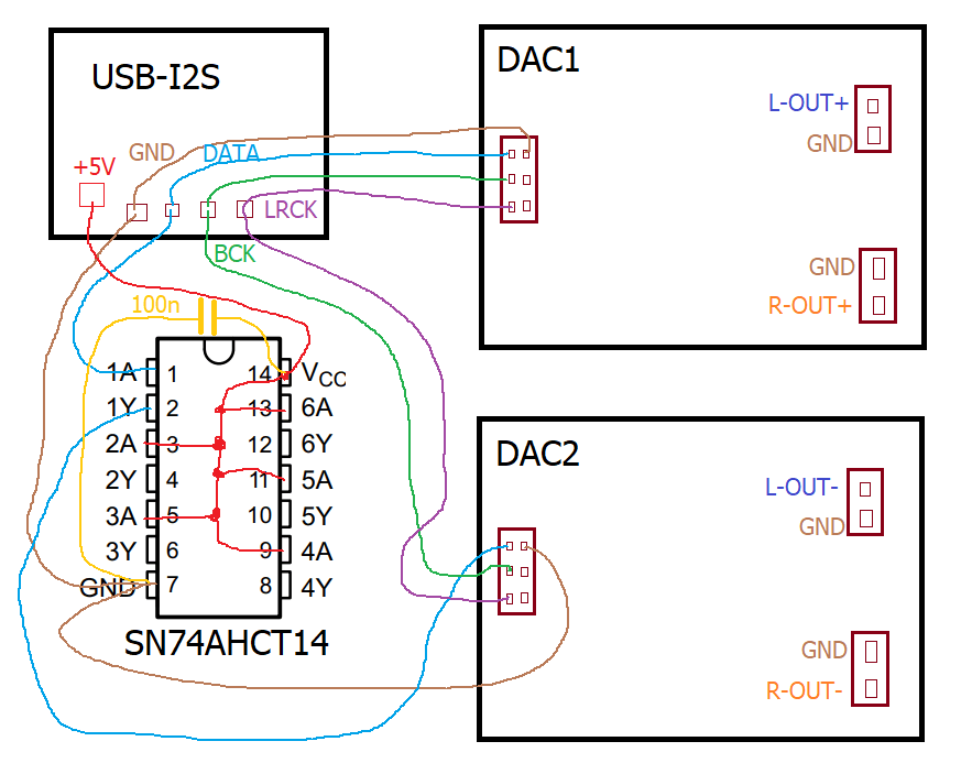

... I wanted to ask, maybe in your plans there is a desire to design at least one multi-channel DAC, for 8 channels? With this trouble at present, there are practically no good multi-channel DACs available on the R2R for self-assembly. It would be great for cars and cinemas. At least on AD1865 (several channels are possible in dual mode, one chip per channel for better quality))). ...
You can make the multichannel DAC even now from the available PCBs. The PCBs can be stacked to save some space ;) See the attached picture how to connect one stereo balanced DAC.
I didn't find a good way to route it all on one PCB in order to save space or gain other advantages. The only saved place would be possible with all in SMD, including PSU. In addition, such a large device is more difficult to repair and more difficult to modify ...).

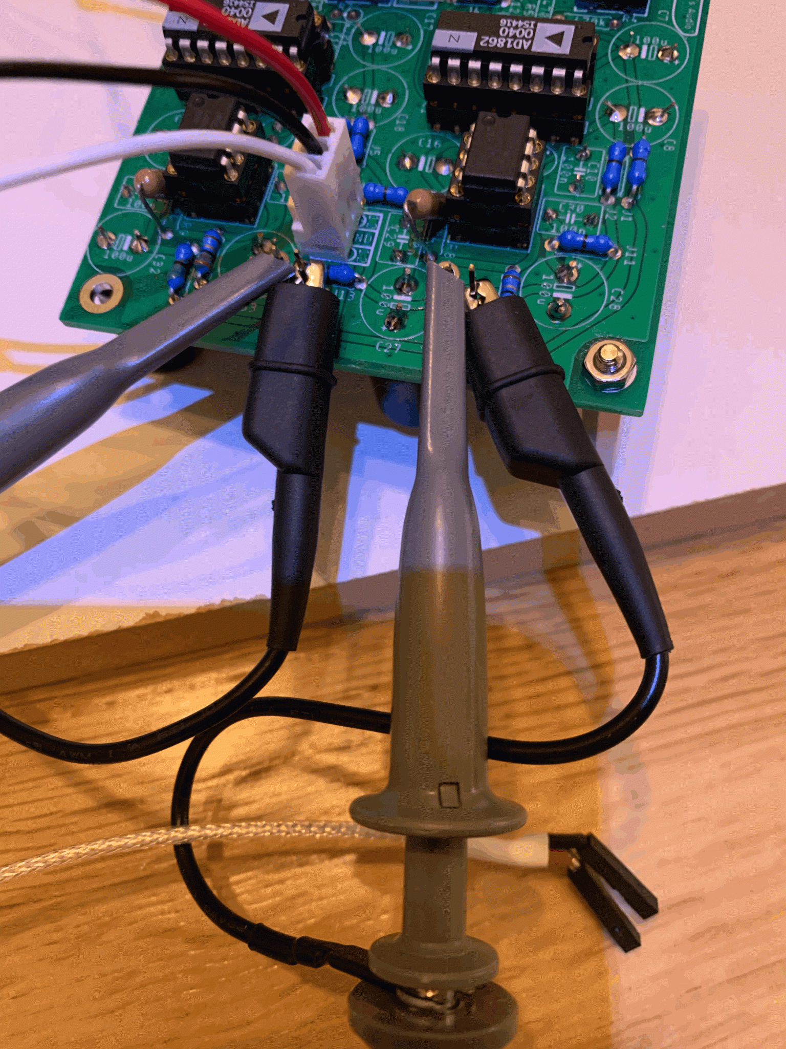

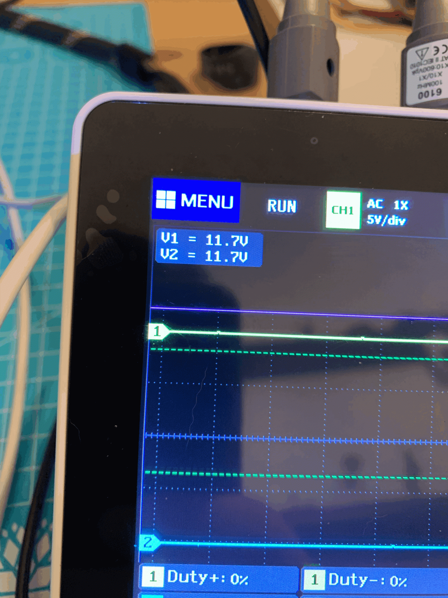

I'm wondering if anyone can help me out with a question about using a scope. Currently, my scope is showing 11.7V and a flat line on both outputs. I'm not sure if this is expected or if I might be measuring something incorrectly. I apologize for the newbie question, but any insights or guidance would be much appreciated.
Thank you!

Hi Vavilen,
I'm sure one of the more knowledgeable will jump in here, but as Nixie said it looks like a problem but you didn't give much information.
Since you don't know your scope well, I would start simple and use your volt meter to test DC output at the DAC outputs. Measure both the left and the right and report back. If you volt meter is reading close to 0v, it should be in the mV range, then you are okay, if not your circuit has a problem that we need to figure out, not your scope settings.
We can give you more hints on how to set up your scope once you have a verified circuit to test.
Let us know,
G
Thank you!
The main question is, are you measuring a working DAC or not working?
V1 and V2 (yellow and blue lines) are probably only triggers and not the signal wave :unsure:

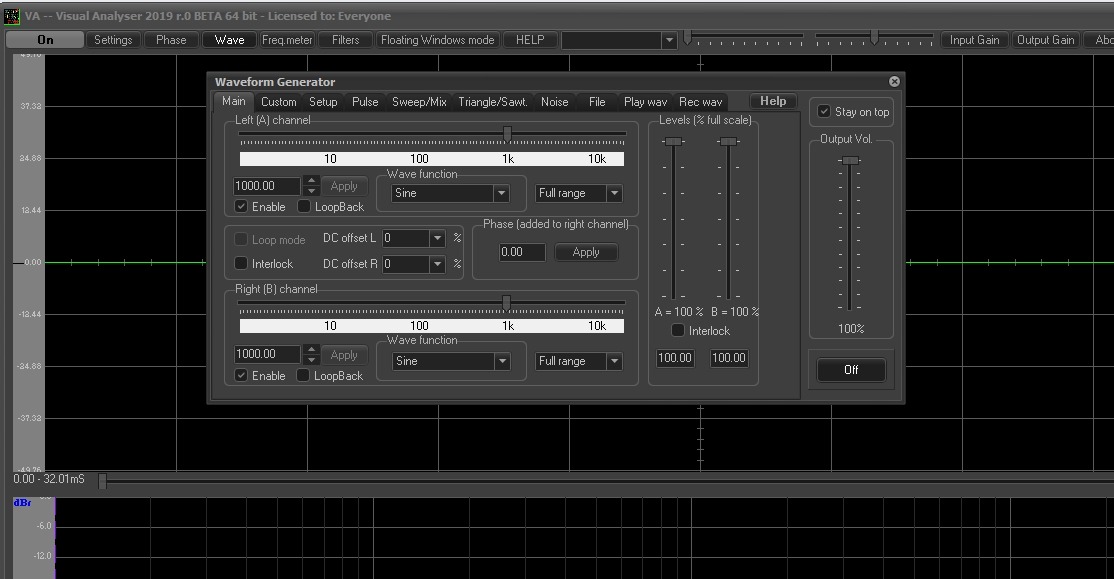

Some signal should play through that DAC during the measurement ... program Visual Analyzer is very good freeware, it has the Waveform generator, so you can conveniently run frequencies through the DAC and measure it with an oscilloscope.
It is best to watch some oscilloscope tutorials on youtube:
