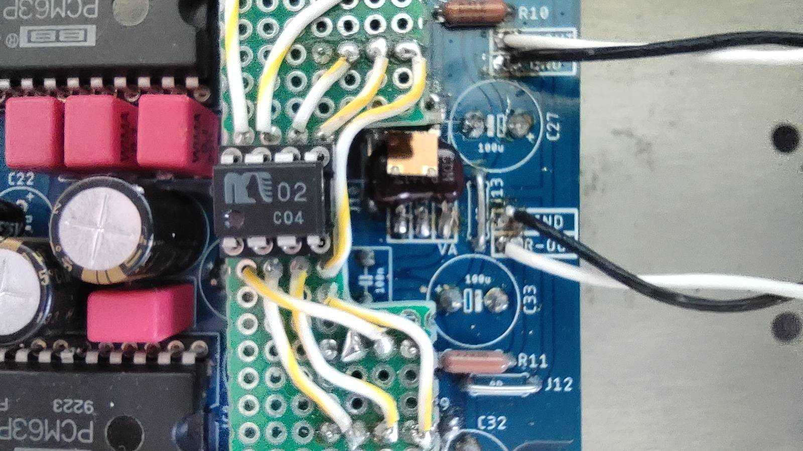

2. Opamps. For AD1865 the Burson V5 single OPA performed well, the current model is the Burson V6 Vivid. It is more expensive than this wire. OPA1611 is a cheaper variant, slightly better than OPA604. It has a more open sound, more detail. The OPA1611 requires a SOIC8 to DIP8 adapter. From my experience so far, the AD1865 requires a brighter sounding OPA, the PCM63 vice versa.

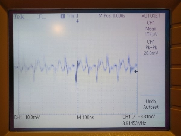

156MHz is a lot for a DAC, it is certainly not the noise of the PCM63 itself, but enters somewhere from the side and spreads through the DAC itself(digital input, power supply, sound source).Here are two pictures of PCM63 DAC measurements. The first is noise at the DAC output and the second is noise at the power supplies. Power supply noise exists on all lines, the same everywhere, on all power lines. The same noise is present on RAW DC as after the regulator. I think it's interference from the environment or from the laptop's power supply, and the box is plastic, so I don't have any protection. I didn't notice the oscillations of the regulator or I can't notice them.![]()
It is too high a frequency to come from a socket in the wall or the radiation of some device. For comparison, this is noise on the PCM1702, and the culprit for this 3.615MHz is the PMD100 itself. I measured this a long time ago, now with improved regulators the situation is certainly better.

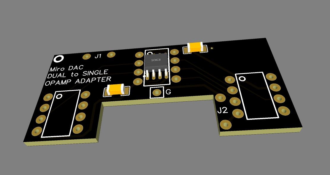

Anywho, due to pressure from mikorist and nixie, i made this little bugger especially tailored for @miro1360 dacs and his signature missaligned opamp sockets 😅
Jumpers are there because nixie wants to use both power lanes from both sockets, traces are wider either way, so one can pick their poison. After testing, i'll post gerbers.
Here's the gerber for dual opamp to 2 x mono, i checked the dimensions twice, connections twice, it should work as intended.
Adapter takes both dip8 and soic8 chips.
J1, J2 are jumpers for using both left and right power supply dual lanes. If you need that much copper by nixie request.
SMD pads are for ceramic 1206 capacitors (value that you feel like (0.1uf and up)), for opamp decouple in case it gets unstable due to nature of the adapter and longer lanes. The size was chosen due to ease of hand soldering, so it wont be a problem for anyone.
G is for using ground link to it via cable, in case you use capacitors on adapter. It is above gnd pad on the dac, so it is convenient.
Enjoy.
Enjoy.

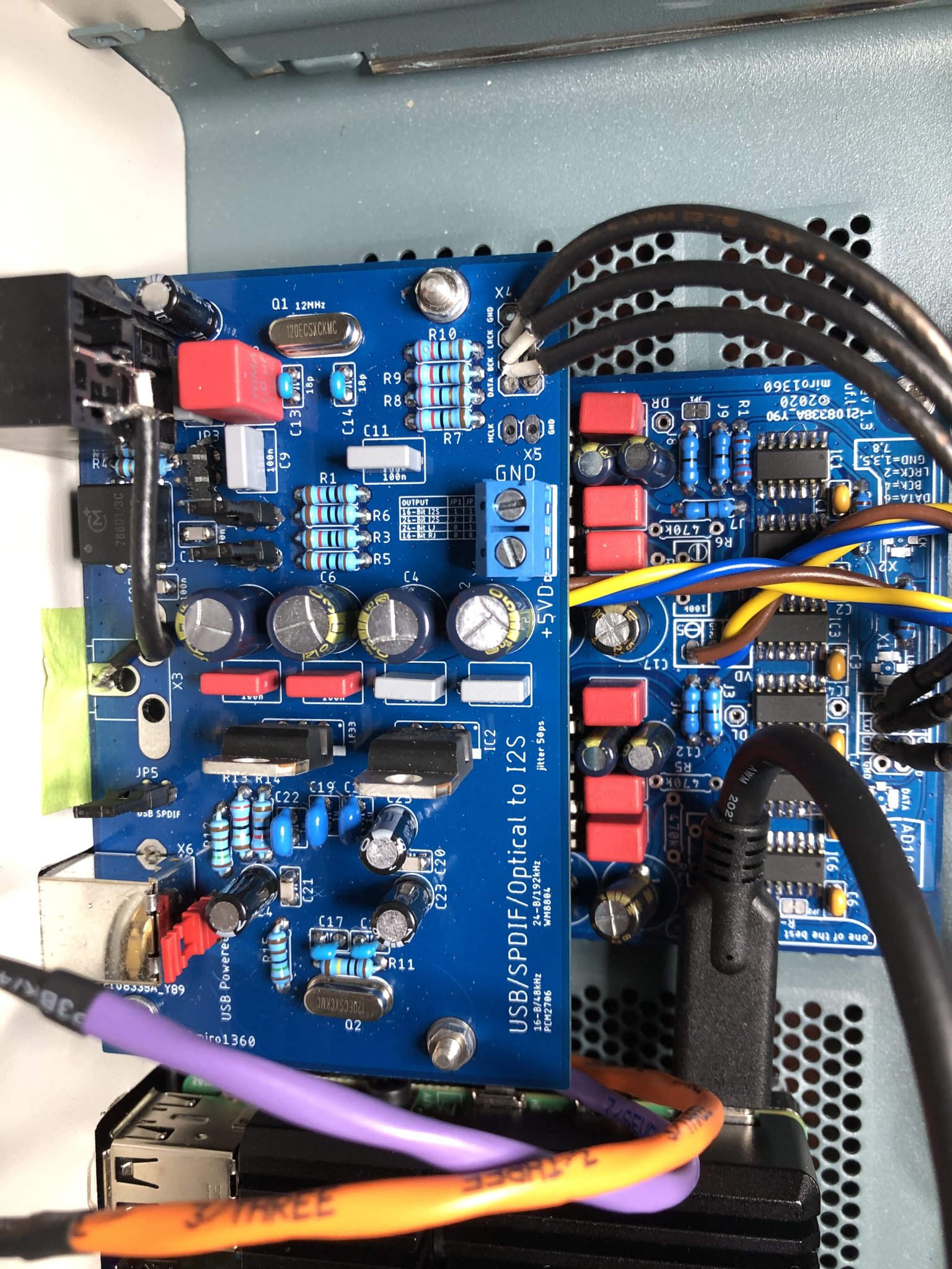

Hi. I'm building USB DAC using your USB to I2S and AD1862 NOS I2S, but I can't hear anything from the output. My system is Raspberry Pi4(Volumio) USB output > USB to I2s > AD1862 NOS I2S . I changed JP1 & JP2 jumper setting, but there was no luck. In this case, is there any specific jumper settings needed?
