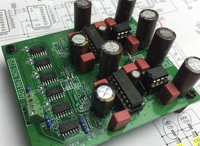

Another DIYer here going for this Dac.
I am done populating my AD1862 PCB.
I have both Opa134 and Muse03 op amps in my toolbox so I will compare them.

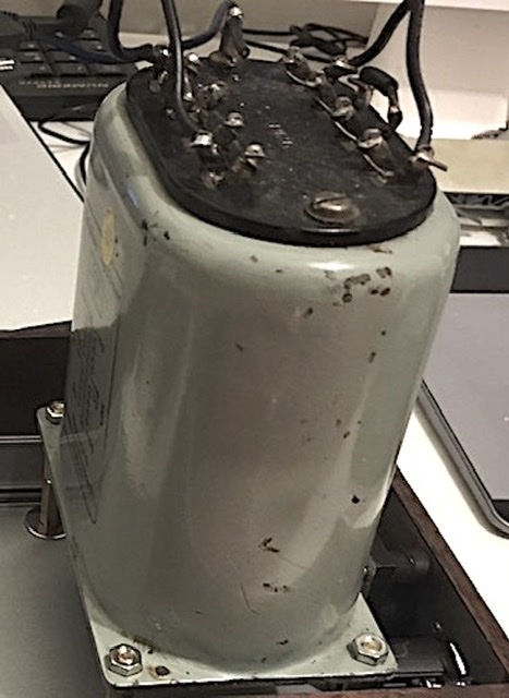

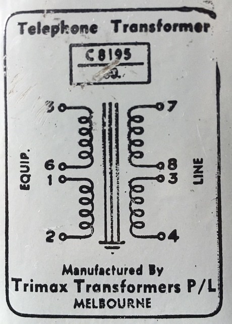

I have a pair of Vintage 600:600 transformers; they are as big as WE111C. HUGE!
I wonder if they will work as passive I/V?
Need any resistors across the wiring?

output impedance is 600R? if so, try add a 1k resistor parallel on the output, ... it is not very good transformer for the I/V ...
better look for transformer ratio 1:10 or 1:20 with low input impedance and higher output impedance (like input impedance 10R and output impedance 400R)

Thanks Miro.
I will test it with op amp first.
