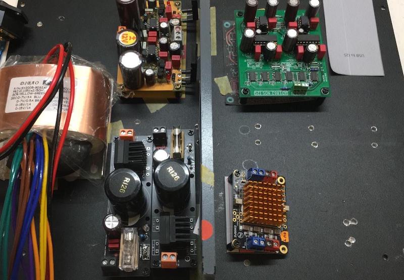

My original plan is to connect AD1862 from RPI+FIFOPi but
my case is quite full with 3 sets of LPS for both RPI and FIFOPI.
There is not enough room for the extra 2 sets of dual LPS and an extra transformer.
So I will build the AD1862 in a new case using Singxer F1.
Photo shows part arrangement and ready to drill holes.
I am a slow DIYer
RPI and how you must work wirh it -vertical stack- is bad or audio and needs expensive hat to get better and even so it's not perfect.
The ad1862 is a PCM board and many good usbtoI2S board will give good results. If you have already an Rpi and a Fifo, don't get crazy but if you haven't and need just an USB input, well a good enough USB to I2S card already advised here will be as good IF not better - but if feeded from a laptop or little computer you will still need an USB isolator between it and the usb board; cost 20 to 30 euros. of course don't take an USBto I2S to feed it from the usb outputt of an Rpi : it will be the worst solution !
