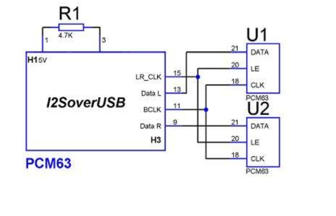

Connect this board's i2s outputs to the i2s inputs of the Miro PCM63 dac board. Skip the op amp IV on the dac board. Wire out the Iout to the output stage of your desire. Isn't this what you want to do?
Alternatively, skip the shifters on the Miro PCM63 dac board. JL Sounds board has the capability and can be connected directly to the PCM63 inputs. The Miro PCM63 dac board provisioned for direct connection from an external inputs by cutting some traces.
@NikNet
Here is a connection diagram of the JL Sounds usb board to the PCM63P dac.
The usb to i2s board that you are using need to have this capability for direct interface to the PCM63P inputs if you intend to skip the glue logic on the DAC board. Otherwise just build the board as it is, use any usb i2s boards you have, skip the IV op amp, wire out to your favourite output stage.
