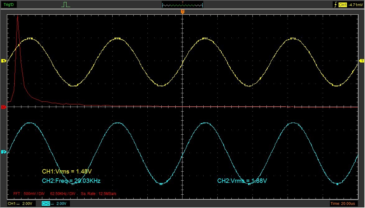

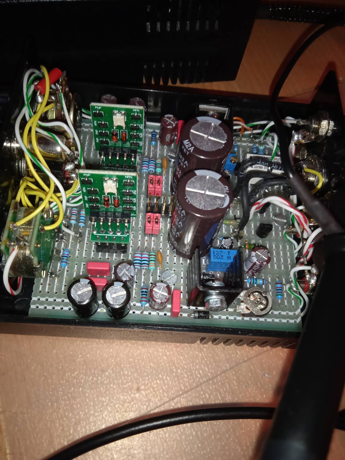

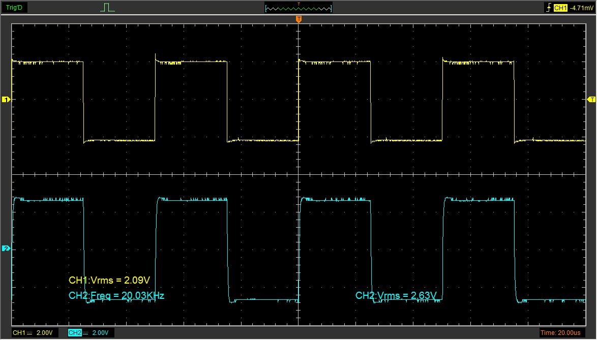

Chinese single channel discrete OPAs. Bought just to try. The measurement is satisfactory, now I'm going to hear how they play. DC offset below 2mV in Line preamp. Frequency range in Line preamp 700kHz -3dB on load 20k+360pF. I don't see THD on the FFT. They consume some current, I can see that they heat up and quickly empty the electrolytes in the power supply when it turns off. Prices around $18 for a pair of single OPAs.

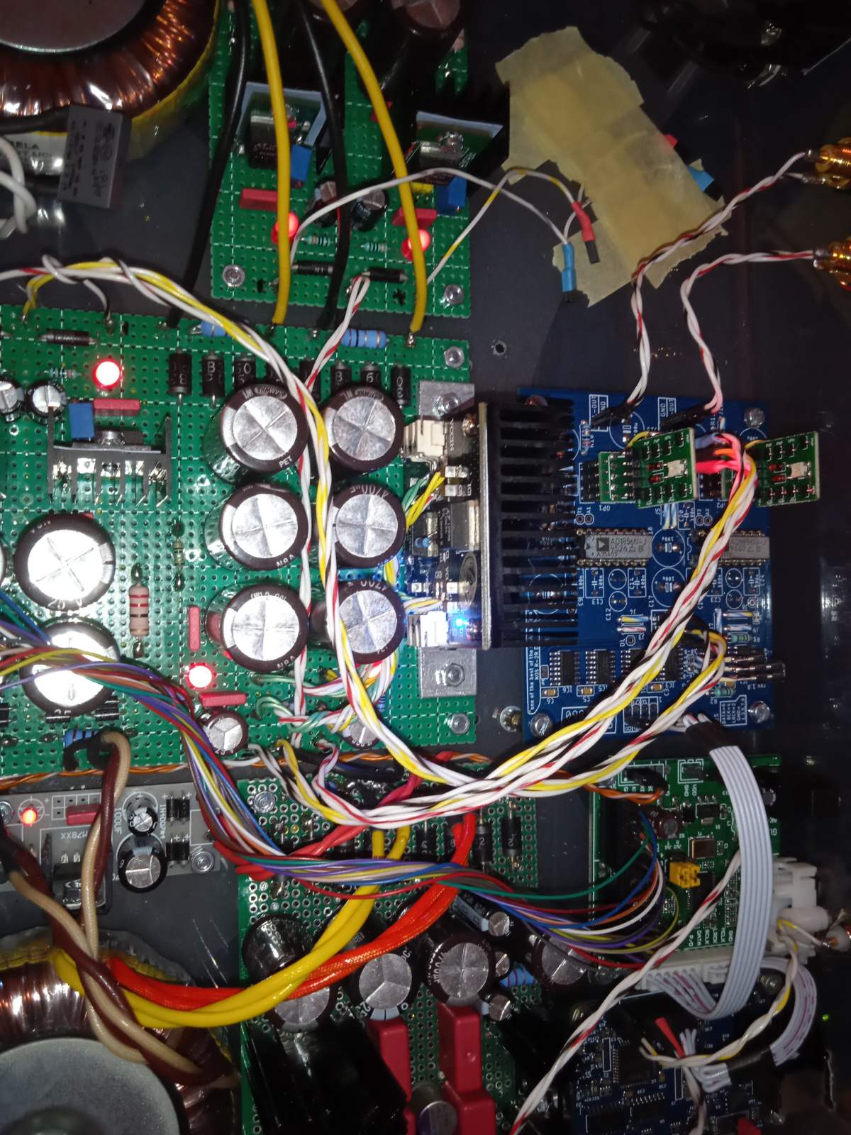

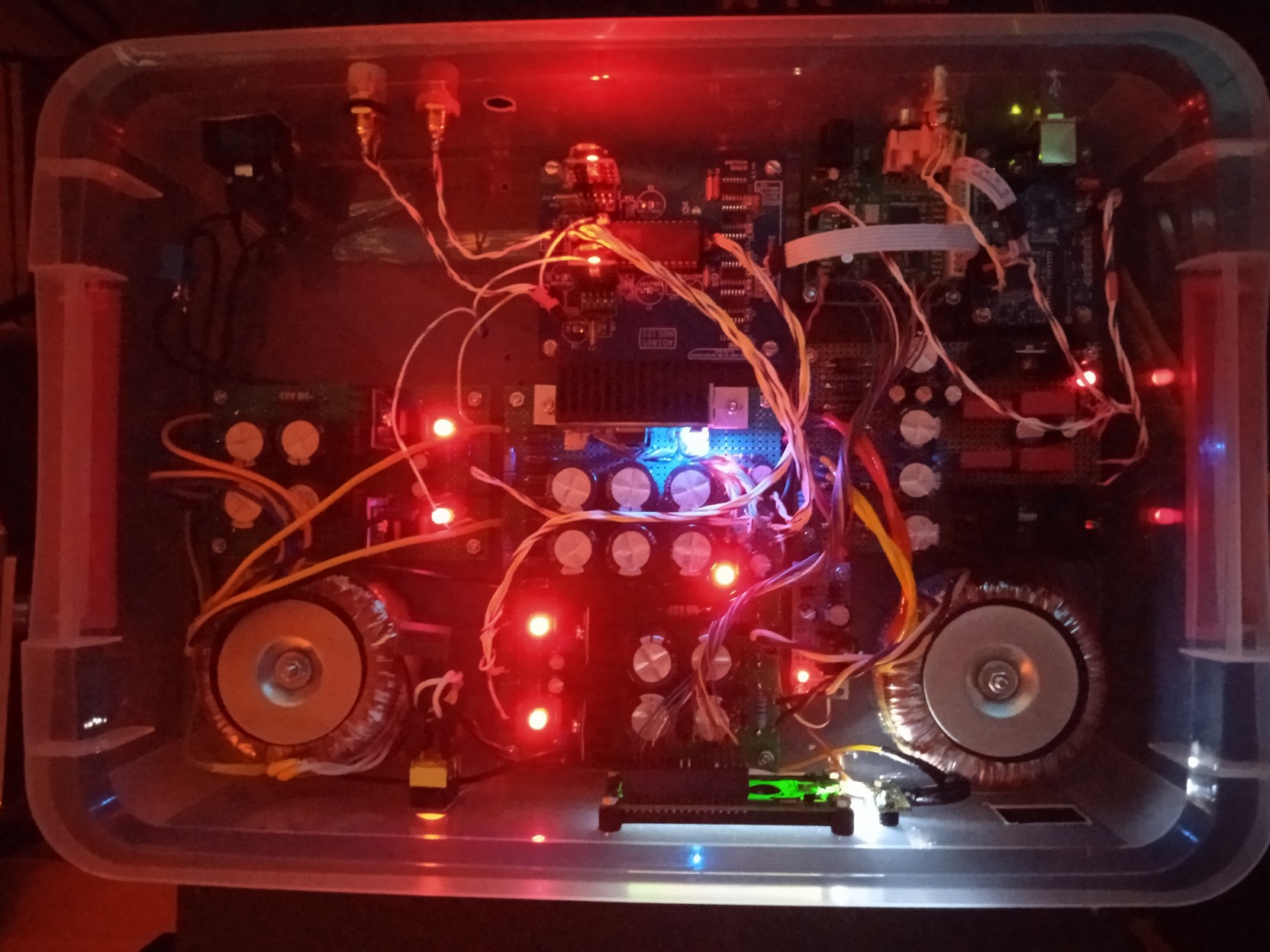

I put them into the Miro AD1856 DAC, listening and comparing follows. To begin with, they are not Sparkos SS3601, but their sound changes gradually, they are not bad in general. They obviously need some brake-in time for full potential.

I started listening a little earlier tonight, I found time. Burson V5 is better than Nvarcher. OPA1641A is better in this DAC (AD1856) than both Burson and Nwarcher. Why the 1641A stands out so much in this dak, I really have no idea. Something suits it. Nvarcher has a slightly softer and more fluid sound, it is not excluded that it fits better in some other system. The OPA1641A has a tighter sound, everything is better defined with that OPA than with the others. I'm going to continue harassing this Nwarcher a little longer, to see if anything changes.

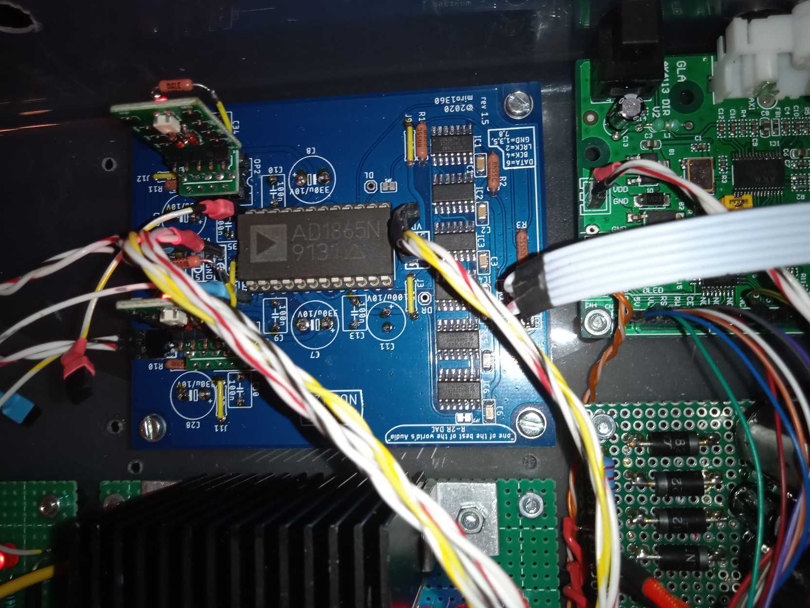

I recently bought on ebay this AD1865N used, produced in 1991 in Phillipines. Price $25 + $6. So I said give it a quick try while I can still claim a refund. The testing was interesting. I couldn't believe it right away, but the OPA1641A in this DAC gave a somewhat artificial sound, dry and uninteresting. In contrast, the Nvarcher Chinese discrete OPA simply flourished in this combination with the AD1865N. I find it extremely intriguing why it was completely different with the AD1856, where the OPA1641A dominated? I haven't had time to test the other OPAs, will do so later. The AD1865 is a much better DAC than the AD1856. It also works well at 384kHz sampling rate.

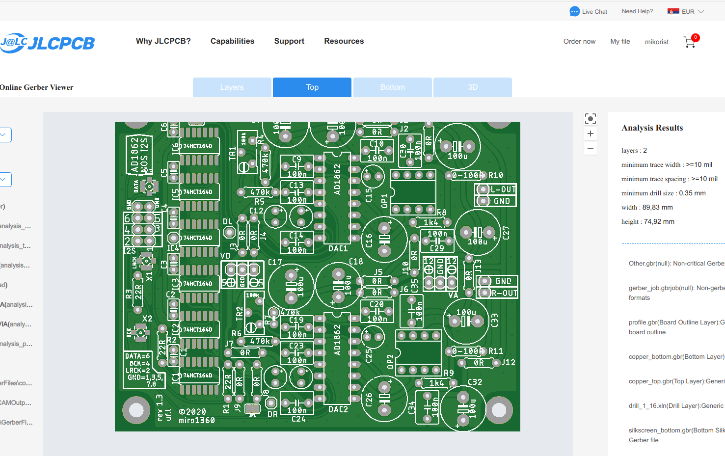

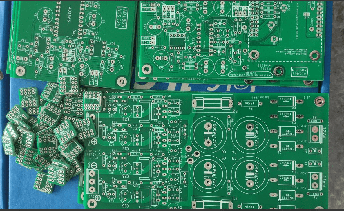

It's ordered - don't worry.Miro, sorry to bother you, where is the latest version of the gerbers for AD1862 with shift registers, I need that one (and schematic too).
Saving the best for last! 🤣Miro, sorry to bother you, where is the latest version of the gerbers for AD1862 with shift registers, I need that one (and schematic too).
But, is there ever an end to the “last one”? 😁

- DAC AD1862: Almost THT, I2S input, NOS, R-2R
