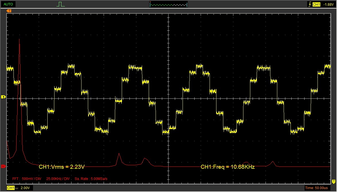

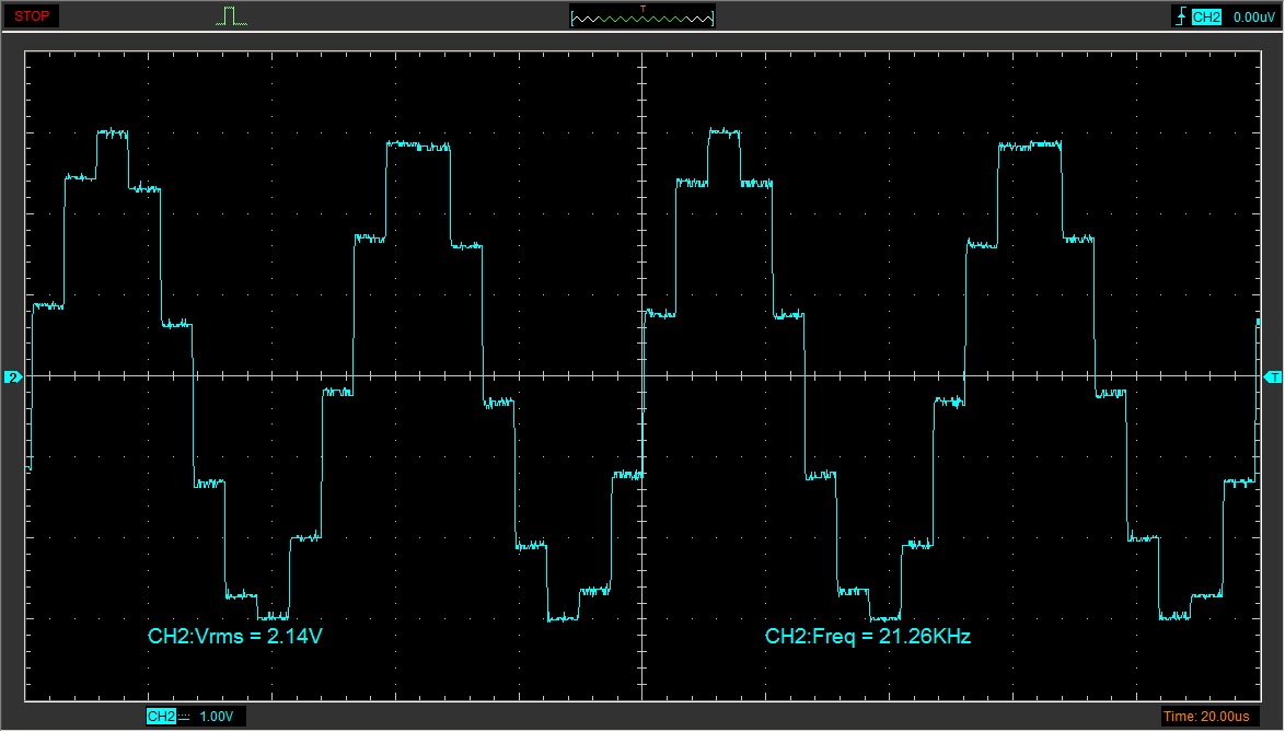

I just don't understand the statement that the step signal does not exist at any stage of the process. Here are attached two recordings of the output from NOS DACs, AD1865 and PCM63. To get a pure sine signal from this, a sharp filter is needed to remove all harmonics.
You listened to my Mobo vs Pcm63P. The three of us were sitting and couldn't tell the difference. But there is no ΔΣ on the motherboard. ALC works differently.a sharp filter is needed to remove all harmonics.
