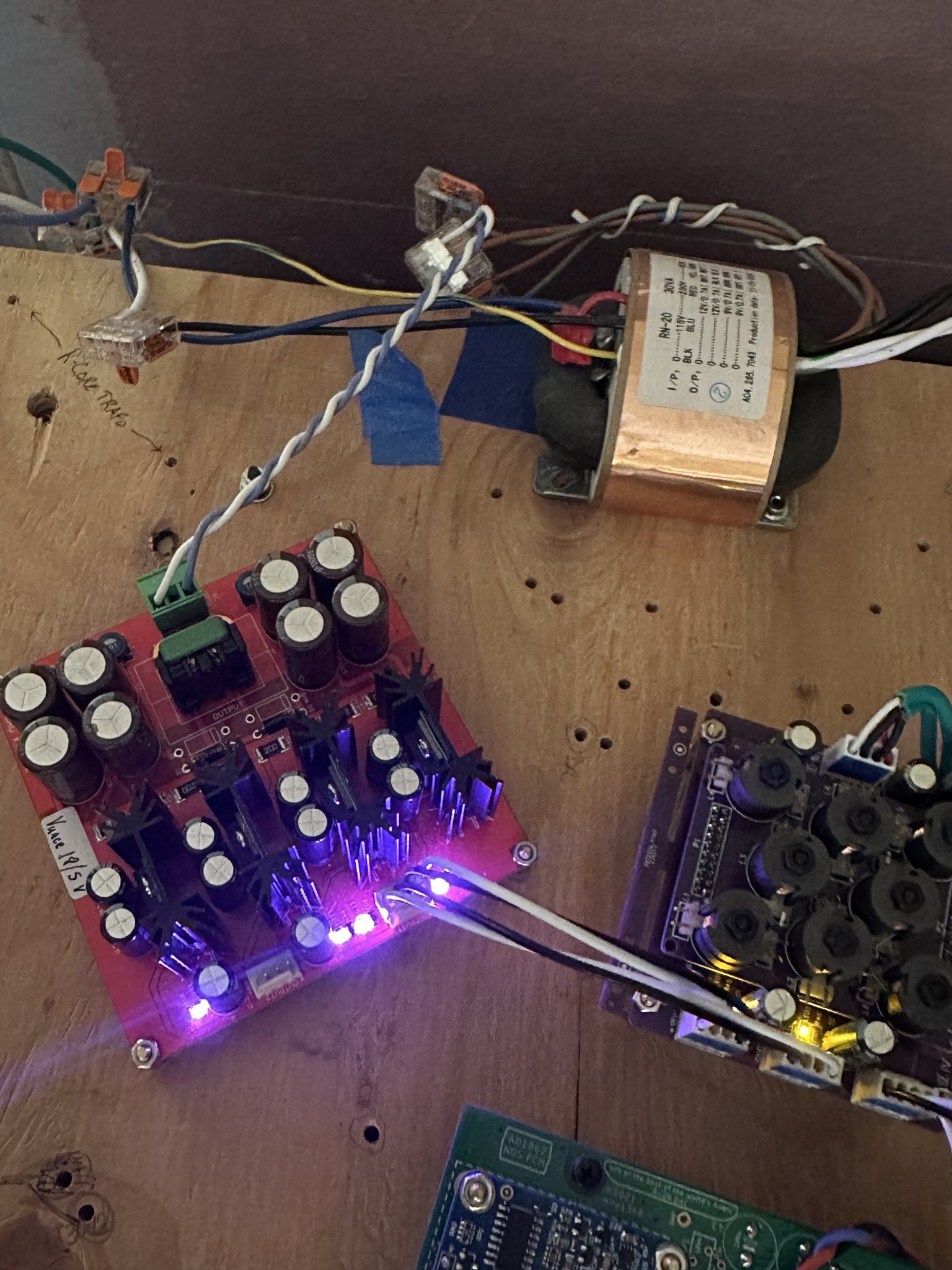

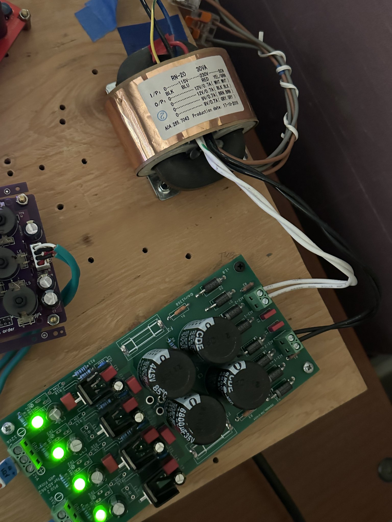

Great! EUVL discrete I/V is what i am building too !You will like this combo. I used the PSU2 with +-5 and +- 12V for AD1862 and Super Reg +-15 for EUVL discrete I/V
What transformer did you use with PSU2?You will like this combo. I used the PSU2 with +-5 and +- 12V for AD1862 and Super Reg +-15 for EUVL discrete I/V
I used an R-core with 12V & 15V secondaries. Got it on Ebay. Looks the same as Vunce's above, just different windings.What transformer did you use with PSU2?
