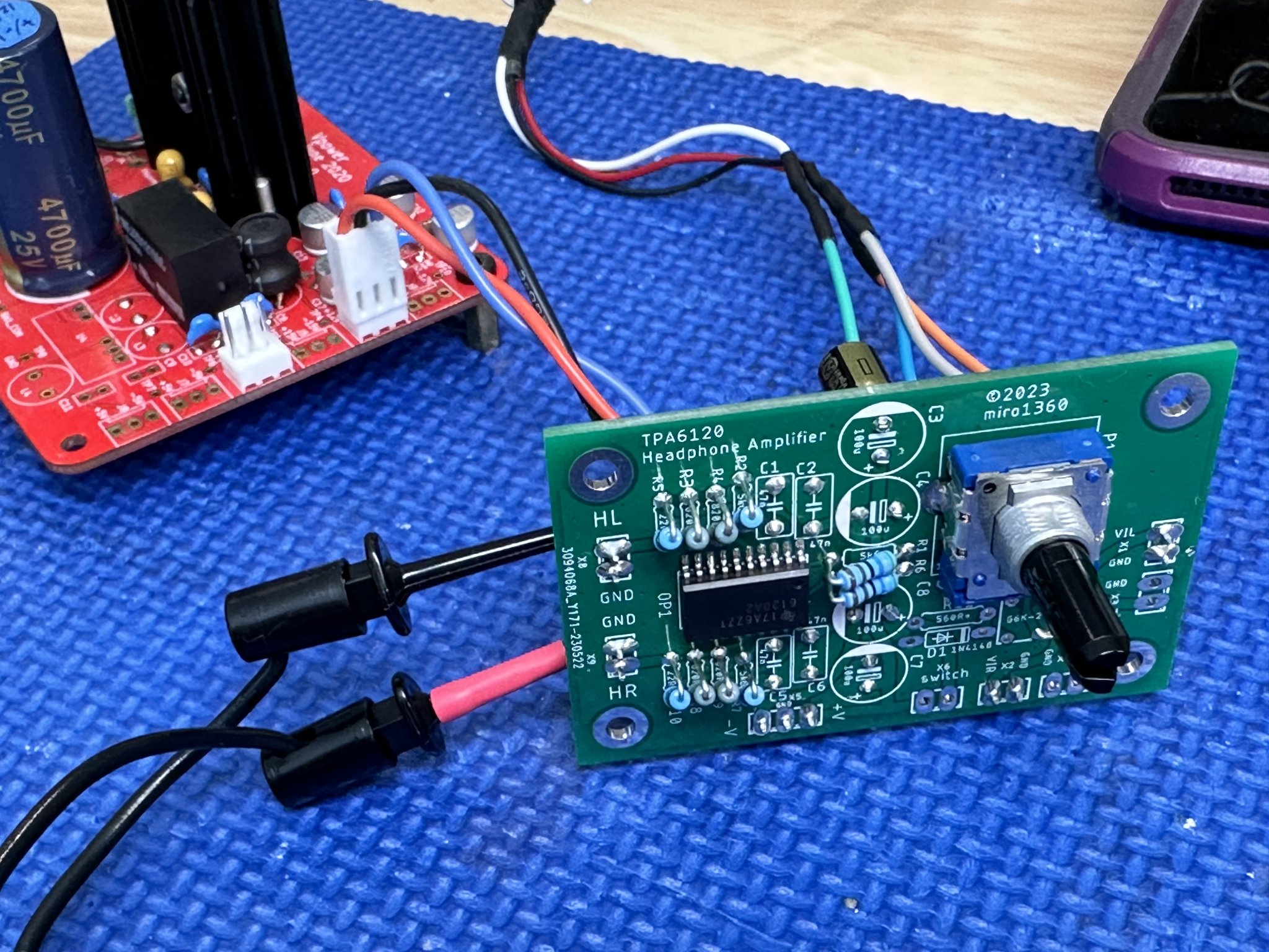

@miro1360,
Powered up preamp board, +/-14.4V
Input source connected is an iPhone, but haven’t connected to power amplifier yet. I’m a bit concerned about the output DC offset, a little higher than I’d like to see.
Did you experience the same? Do we need to add an offset trimming circuit?
- HL Output: is 30mV and increases to 40mV as volume pot is increased to 2/3, then drops back to 30mV at max volume.
- HR Output: same behavior but 10mV higher, 40mV to 50mV back to 40mV.

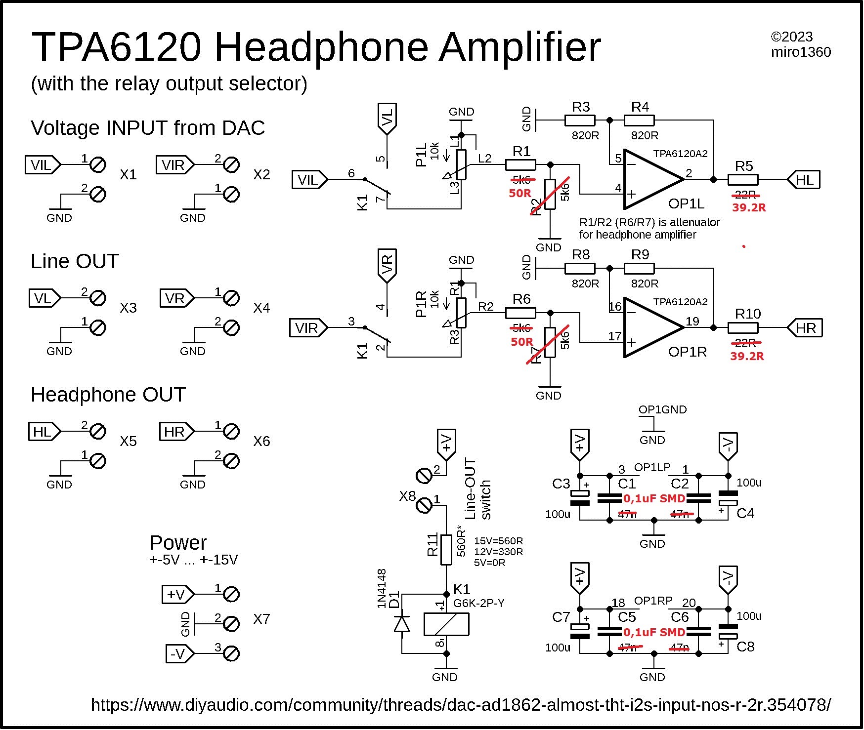

@Vunce Hm, I did not checked it and you are right, we have offset, ****
... It is caused by that potentiometer, TPA just does not like it (it should be a buffer in the signal path between TPA and potentiometer, or DC servo can solve it) ... I will look for some DC servo solution and will be back ...

There can be several reasons for such a large offset, the TPA6120 is a CFA amplifier and therefore requires a little more attention regarding the decoupling as well as the PCB itself.@miro1360,

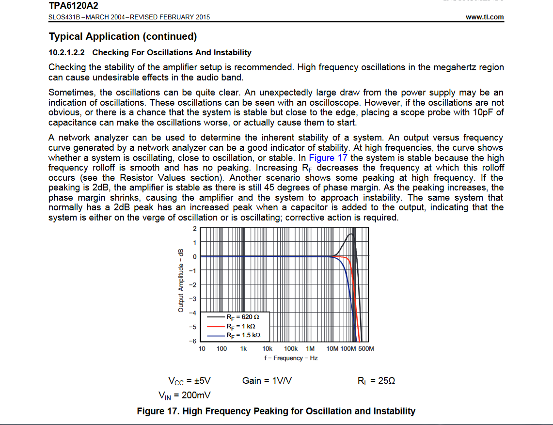

I would first check if the TPA6120 oscillates and then change some components including the red Wima which are not good for CFA, if even after that the offset is large I would insert an op-amp between volume pot and the TPA6120.
@grunf The offset is caused by the R2 and R7 value and also the 10k potentiometer. Removing R2 and R7 decrease this offset, but 10k potentiometer will still hold DC offset around 15mV, which is probably too much for a preamp
Adding opamp into the signal way means changing the sound
so probably only servo can do the job and hold the offset under 1mV ...
