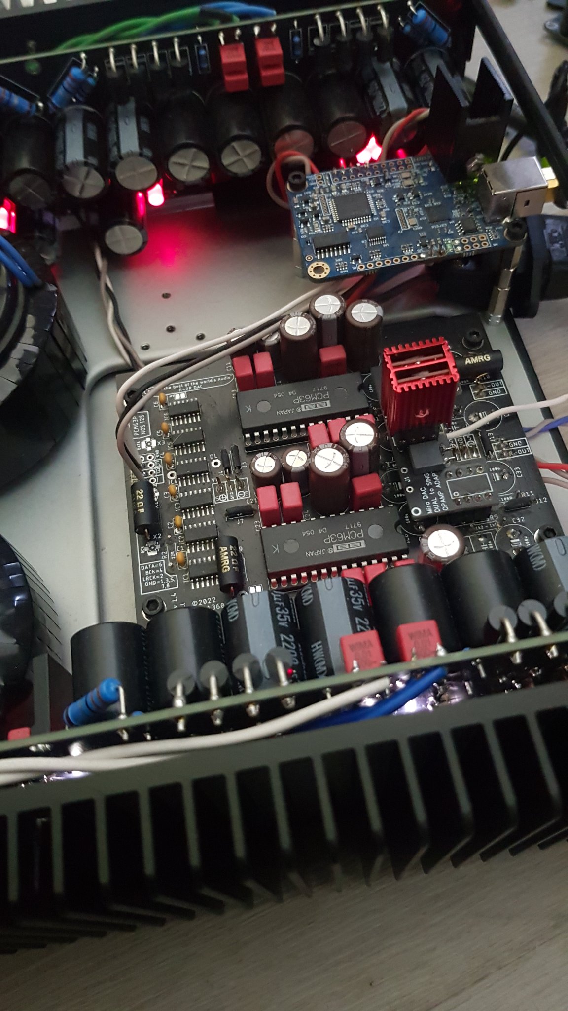

Don't get me wrong. My pcm63 dac is fully discrete shunt based regulated. It's a beefy mofo. But that thing costs a pretty penny. Not anyone can afford such a device, and i can tell you that it has diminishing returns to what it could cost for several percent lower performance. Heck, my tda1541a will cost a lot more, and new pcm63 board with fully discrete is on the way. Diy device costing several hundred bucks, that beats A LOT of commercial products costing many, many times as much is where the sweet spot is for most of the people.It seems that everyone has their own criteria for what is DIY, for me DIY is that regulator and not a solution that I could have copied from any commercial device. Why shouldn't our DIY be above that commercial device, that's exactly why I see it as a challenge and it constantly pushes me forward.
You can see a part of the beefy supply. Not saying you are wrong, but saying you are not right either. Power supply is important (to me as much, if not more than anything else in chain), and if budget is a constraint, modern ultra low ldo are a really good solution (and those are hella not used frequently in commercial devices due to cost cutting, where you will see decades old stuff in top shelf stuff too).
I think carbon R is really cool for the job as per the picture. I wonder if real carbon comp are not even better due to some cool no bouncing behavior, though not sure as it is very low power and drift here. But we do not care about the noise with so low Z value (aka, let the carbon comp alive, they became NLA)
