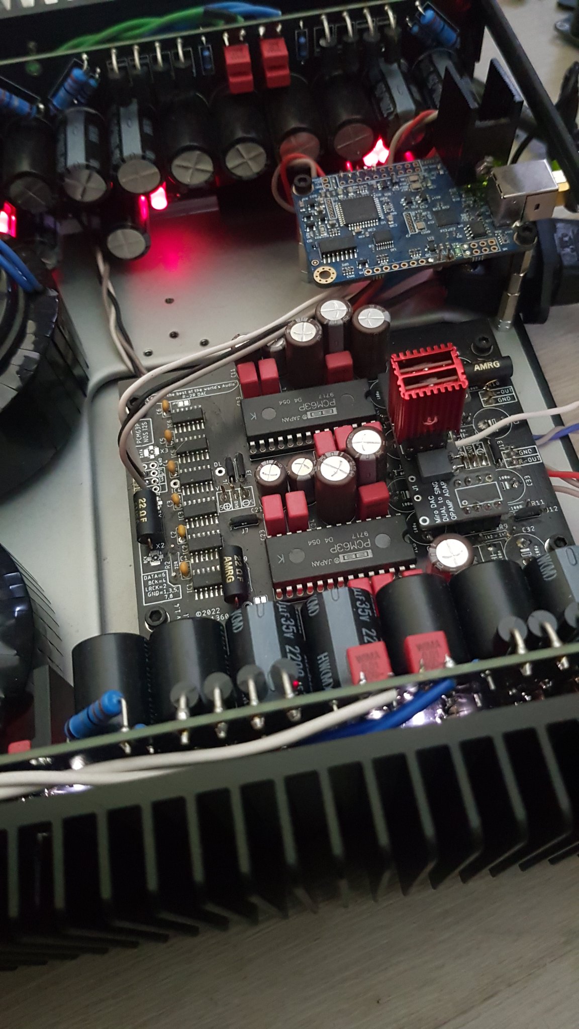

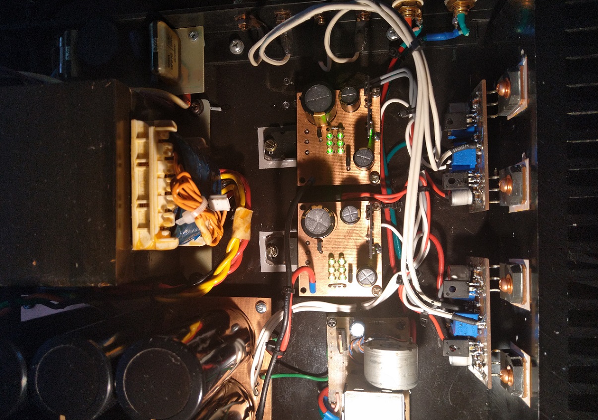

Congratulations on the shunt regulators. I think I know what the scheme is because I received it for review. But you are one of the few who got into it, I don't know what kind of results that reg has, but it is certainly better than most commercial regs.Don't get me wrong. My pcm63 dac is fully discrete shunt based regulated. It's a beefy mofo. But that thing costs a pretty penny. Not anyone can afford such a device, and i can tell you that it has diminishing returns to what it could cost for several percent lower performance. Heck, my tda1541a will cost a lot more, and new pcm63 board with fully discrete is on the way. Diy device costing several hundred bucks, that beats A LOT of commercial products costing many, many times as much is where the sweet spot is for most of the people.
You can see a part of the beefy supply. Not saying you are wrong, but saying you are not right either. Power supply is important (to me as much, if not more than anything else in chain), and if budget is a constraint, modern ultra low ldo are a really good solution (and those are hella not used frequently in commercial devices due to cost cutting, where you will see decades old stuff in top shelf stuff too).
It bothered me that top performances were mentioned along with say 'cheap' regulators and power supplies. I know it's not like that because I've been making my own DACs for the last 15 years or so and I've learned all the power supply tricks very well. I'm not an electrical engineer, but I learned by trial and error. It wasn't a cheap way, but now I know what works and what doesn't. However, a Walt Jung or Salas shunt reg can be made very cheaply, so it's not a problem about money, but whoever wants can make more expensive versions like me, but I still think that $50 is not a lot for two regs with top performance.
And as for your shunt regs, I think they are grossly oversized, two PCM63 and op amps are not big consumers like my eight PCM1702, so the dissipation should not be higher than 4W max and that can be done very nicely in SMD technique, which is on the contrary and desirable because we work with HF noise in power supplies. Likewise, if I have to use 'cheap' regs, I would make sure that they have good characteristics in the MHz range, such as the ADP71.. series.
A new DAC is also on my mind, but I am still in doubt whether I will get the same result as with this one, and the financial expenditure will be much higher, just the op amps in the regulators would cost over $100, but what is more important, I would implement all the knowledge I have so far on just one PCB which would certainly help. Now, we can only find out if it makes sense if we try it

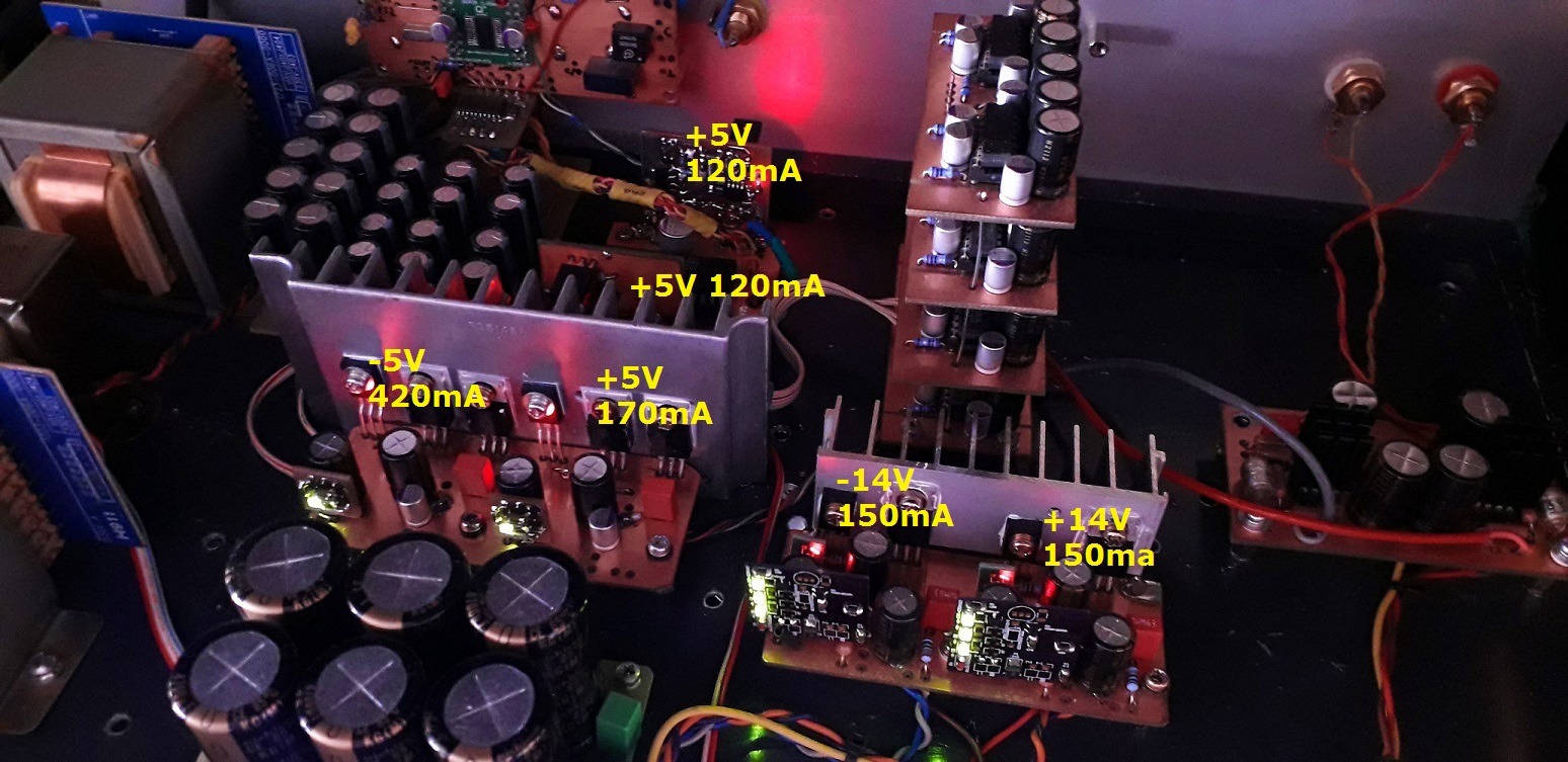

btw. I find this picture in my documents that show currents trough my shunts in my DAC

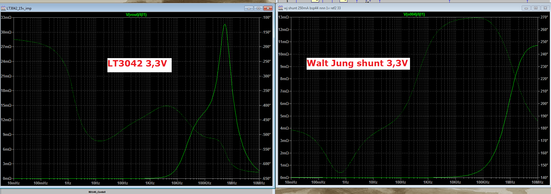

I believe that uBib is even better, but we still can't call it a real regulator, it lacks a feedback loop which limits it.
I fail to see how a high nfb regulator could be beneficial for powering digital circuits. Low noise is definitely important, but speed? Even the fastest feedback loop stands no chances when faced with MCK transitions.
The one thing i have learned about regulators is that no solution is universally good. In digital, physically large regulators appear to cause more problems than they solve. Those tiny, sub 1uV integrated regulators are just perfect.
@analog_sa , I compared the ADM7151 with the shunt reg, the PCBs were similar in size located right next to the load, the scope clearly shows that the shunt reduces the peaks and smooths them out in the MHz area. My friend did similar tests with the same results.

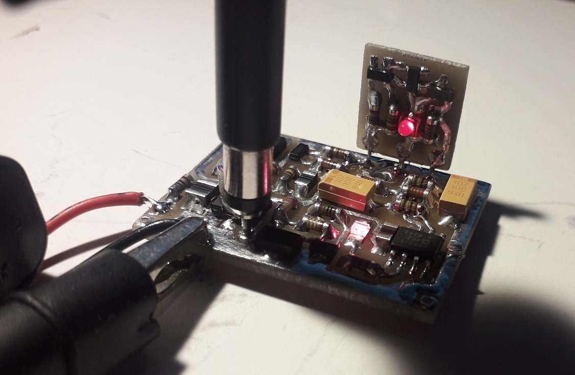

The biggest surprise for me were the shunt reg (pictured) for DIR9001, where I initially used two ADP7118 which were placed right next to the DIR itself, and they were worse than the shunt. Unfortunately, I only have basic instruments at home, so I did not go into further analysis, but if the simulator shows better results, why wouldn't it be the same in practice. I agree that each reg should be optimized for a certain load and that there is no universal solution, but I would always opt for a discrete reg that can be made in SMD technology today precisely because of HF noise.
