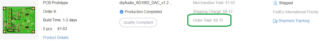

PCBs are often ordered from jlcpcb (during checkout select europacket, it is best shipping/price for the EU, or fedex). Alternatively, you can use some local service, but the price will be hardly competitive. See the price for 5pcs including good shipping in the EU.

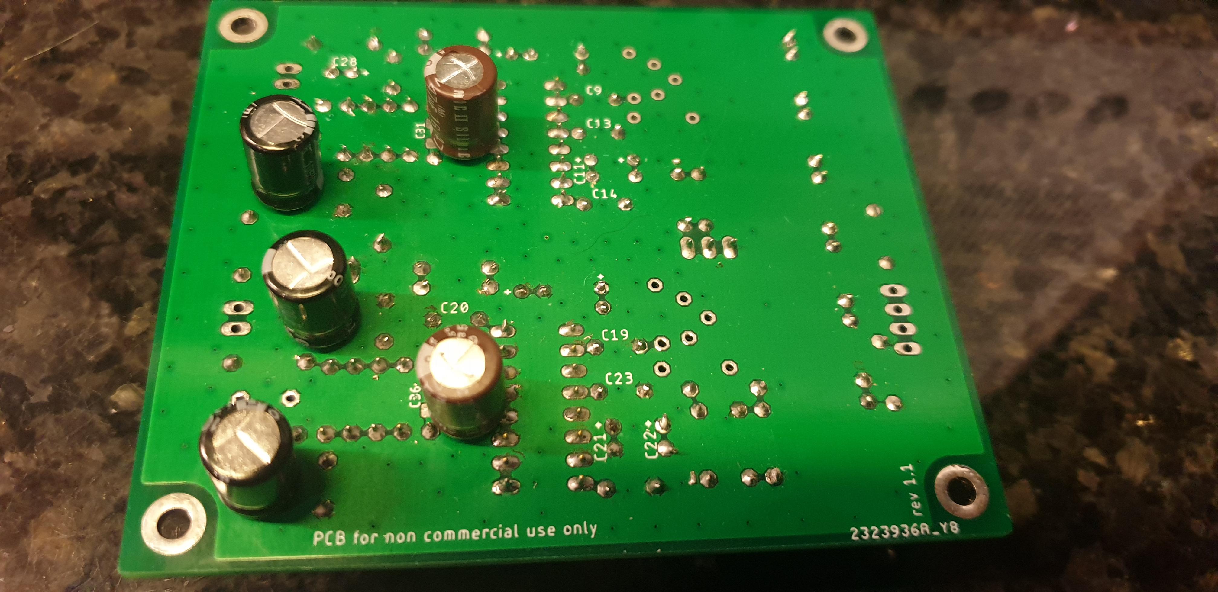

... check capacitor packages because in the first PCB version the bigger capacitors are mounted from the bottom (as @Vunce suggested), next PCB versions have more space for bigger capacitors, that is cost of the progress

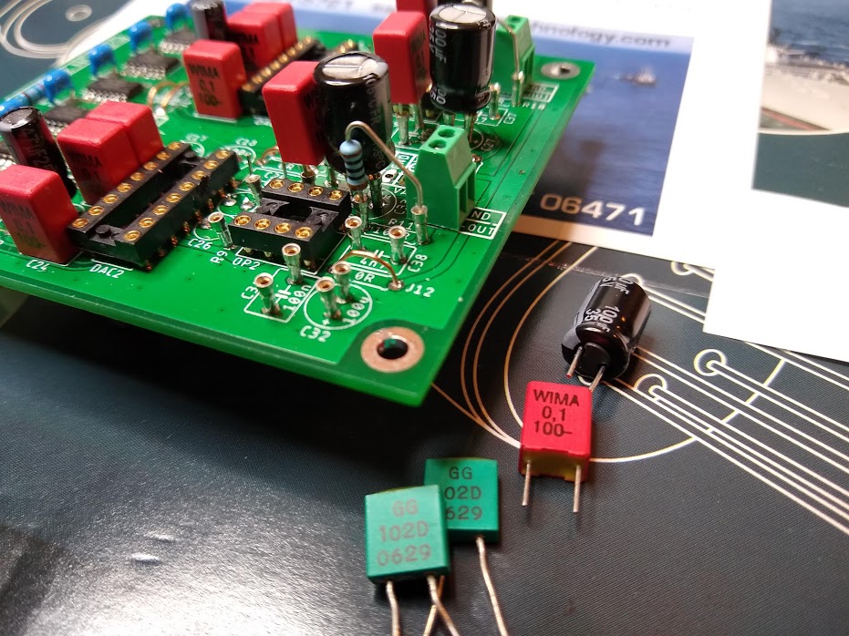

Indeed so! Some people didn't come into this whole thing thinking that, but it seems to happen anyway. First with the op amps, now I've built a socketed board to test with and managed to get a set of rather esoteric resistors to try in the I/V stage. Just need to put together a new power supply and I can A/B against the first board. Then I can try some of the op amps in the TPA3255 amplifier. Then... then... then...

Nice socketing there Paddy. Nice idea.

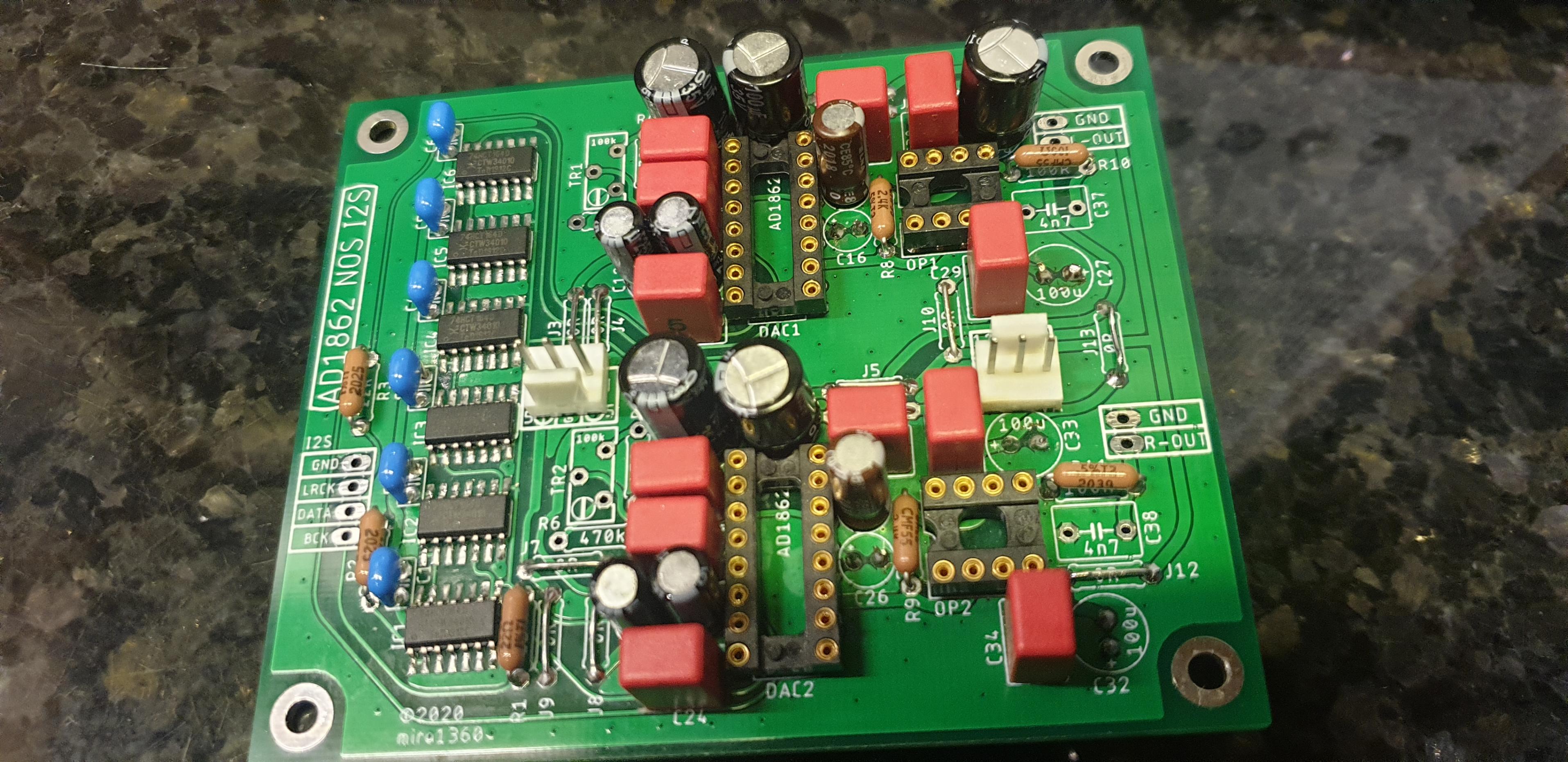

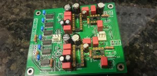

So mine is coming on slowly but the board is soldered now. Moved a few caps to the underside to help clearances.
I have a 'studer900' type psu kicking about that i shall try for the analogue rails. Will sort something cheap and cheerful for the 5v for now. I have some Mark VRDN Denoiser boards to try out aswell as the Salas regs I mentioned earlier but maybe they are overkill here.
And I need to decide on a spdif to i2s board. I will mainly be using a Chromecast Audio. I seem to have lost my enthusiasm for Rpi.

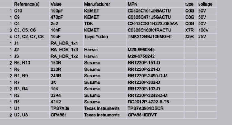

Also, looking back at the thread, I never posted the manufacturing files for the OPA861 I/V output stage boards (inspired by P. Rogic’s Aya II DAC). These boards are 100% SMT with a few parts being tricky to solder for a first time smd project. Here they are with the supporting documentation:
