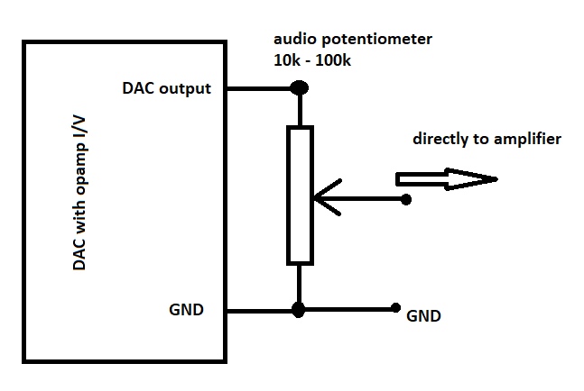

>>are there any downsides of using op-amp (output) in this DAC and than going straight to op-amp (input) in my_ref amplifier
You can connect it straight with no worries
Is it this schematic? link
C13 input capacitors in the amplifier can have significant impact on the amplifier sound (should be high quality audio capacitors, like PP type). This DAC with a good opamp in the I/V has normally zero offest on the output (or a few mV) and therefore you can try to short C13 capacitors and listen to a difference in the sound quality.
C9 use also a high quality audio capacitor (nichicon UFG or UKZ serie).
You can also connect a high quality audio potentiomter directly after DAC with no worries (with opamp I/V).

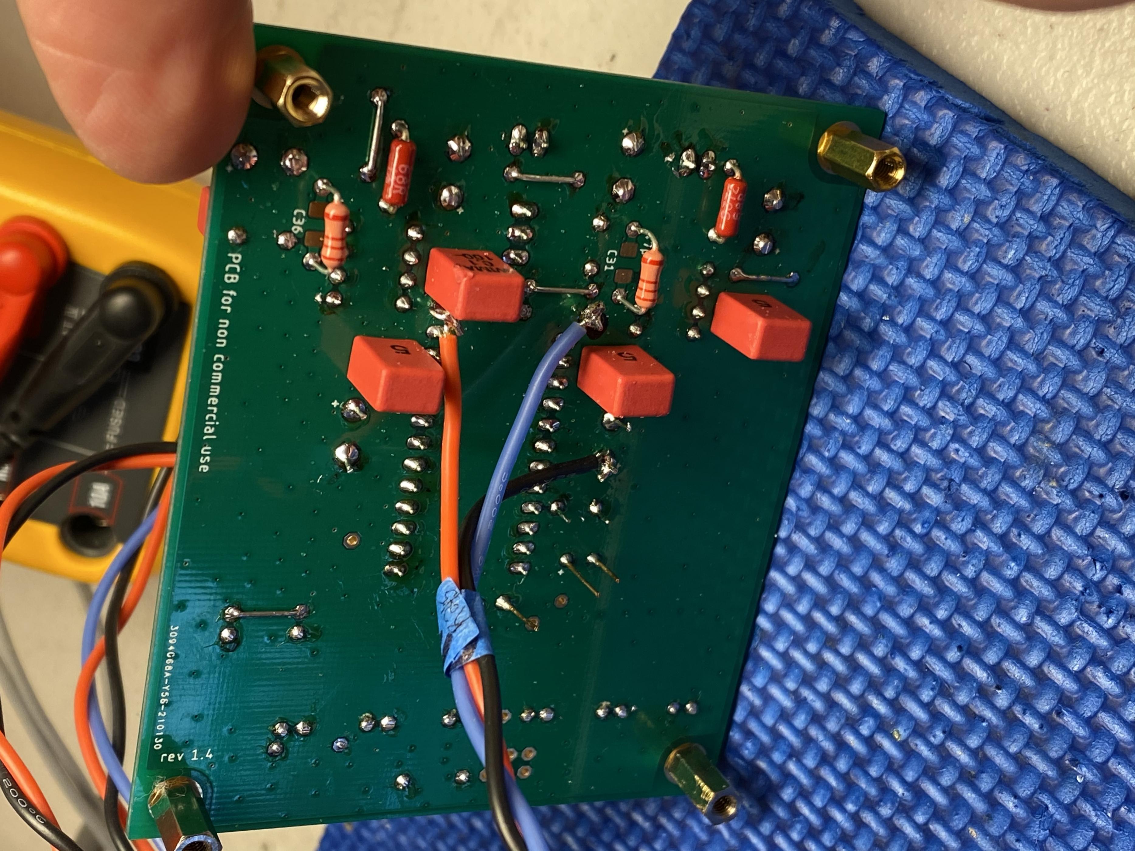

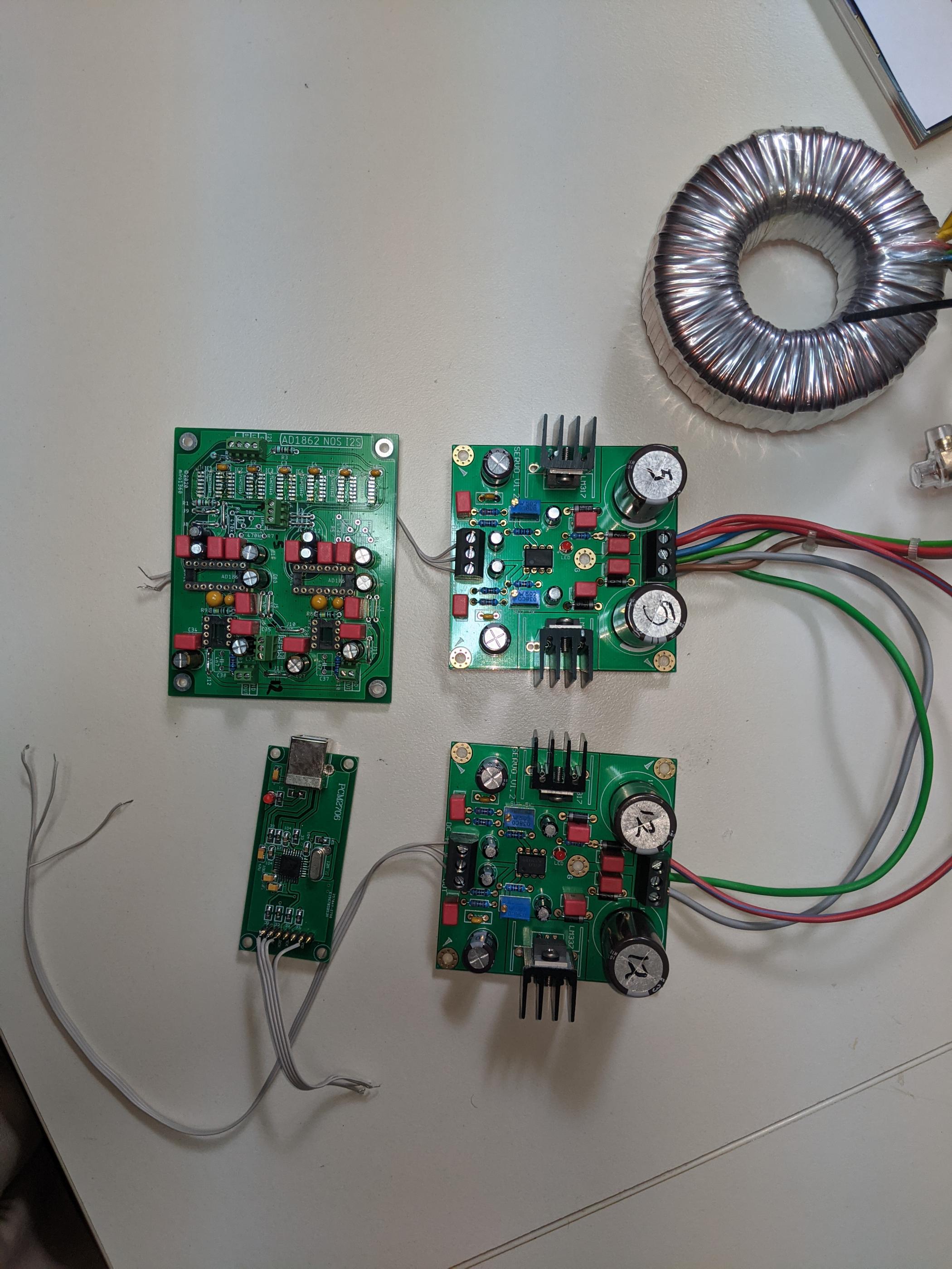

Hi guys, long time lurker here.
I have been following this thread since the start and have now assembled 2 boards resulting in the same "problem" on both, and asking here for any thoughts on the issue I am seeing.
After assembly, all voltages measure correct with all boards connected, that is the p.s. boards and also the I2s board. However, it seems as soon as I put in a USB cable connected to a PC, the +5v rail loads up and measures less than 5. When the USB is removed the issue is remains. I have tracked it down to the "buffer" area of the board, by removing J9, I reckon the 74HCT164D chips are damaged when connecting the USB. When I remove these chips, the +5v is correct again. Just by soldering in the first chip IC1, exactly the same happens after plugging in a USB.
Could it be the way I have my p.s. wired, that is both 12v & 5v pcb's sharing the one transformer secondary, or could I have a bad USB to Is2 board.
Any thought appreciated.

Hi @speakes1
Measure AC voltages on secondaries here:
AC voltages ... voltmeter should indicate 2x AC voltage. If it is less (around zero), switch 2 wires between on one secondary (green with brown).
We will solve the issue
Transformer secondaries can be shared.Could it be the way I have my p.s. wired, that is both 12v & 5v pcb's sharing the one transformer secondary, or could I have a bad USB to Is2 board.
Do you mean the +5V rail from the LM317 power supply? Let J9 connected and measure the current consumption on the +5V rail (without and then with I2S board connected)....
... as soon as I put in a USB cable connected to a PC, the +5v rail loads up and measures less than 5. When the USB is removed the issue is remains. I have tracked it down to the "buffer" area of the board, by removing J9, I reckon the 74HCT164D chips are damaged when connecting the USB.

Hey I have a question for more knowledgeable people around here... I will start building new amplifier (My_ref) now that the GB is over and I received PCBs and I have a question regarding op-amps since my_ref uses op-amp on input stage. So I was just wondering and have no clue where to start looking for answers, first one that pops in my mind is are there any downsides of using op-amp (output) in this DAC and than going straight to op-amp (input) in my_ref amplifier. I know if this two were a commercial product you would just connect the two and listen. But since this is DIY forum I am just interested if there would be any other (better) way of doing this or some other things to look for, like same or diferent op-amps, or maybe no op-amp in DAC or It will be just fine as is. Thanks
Hi @speakes1
All this tested as should
[/QUOTE]Do you mean the +5V rail from the LM317 power supply? Let J9 connected and measure the current consumption on the +5V rail (without and then with I2S board connected).[/QUOTE]
Yes, +5v rail from LM317 power supply
1 x in board 74HC164D and measured 0.001mA pre Is2 board and 0.105mA with Is2 board
2 x in board 74HC164D and measured 0.001mA pre Is2 baord and 0.210mA with Is2 board
Also was measuring 5v from the LM317 p.s.
Things were going well, I even thought about inserting the DAC and Op-amp to have a listen to the RHS, but prior, I power cycled several times to see if I could replicate the earlier fault, and the inevitable happened - smoke escaped out of both registers, and I know that the smoke is what makes it work (I must re-stock on the smoke in a can) lol..
Seems like I have quite a bit of trouble shooting to do now..
Anyway miro1360 thanks for your time and I'll let you know how I go.

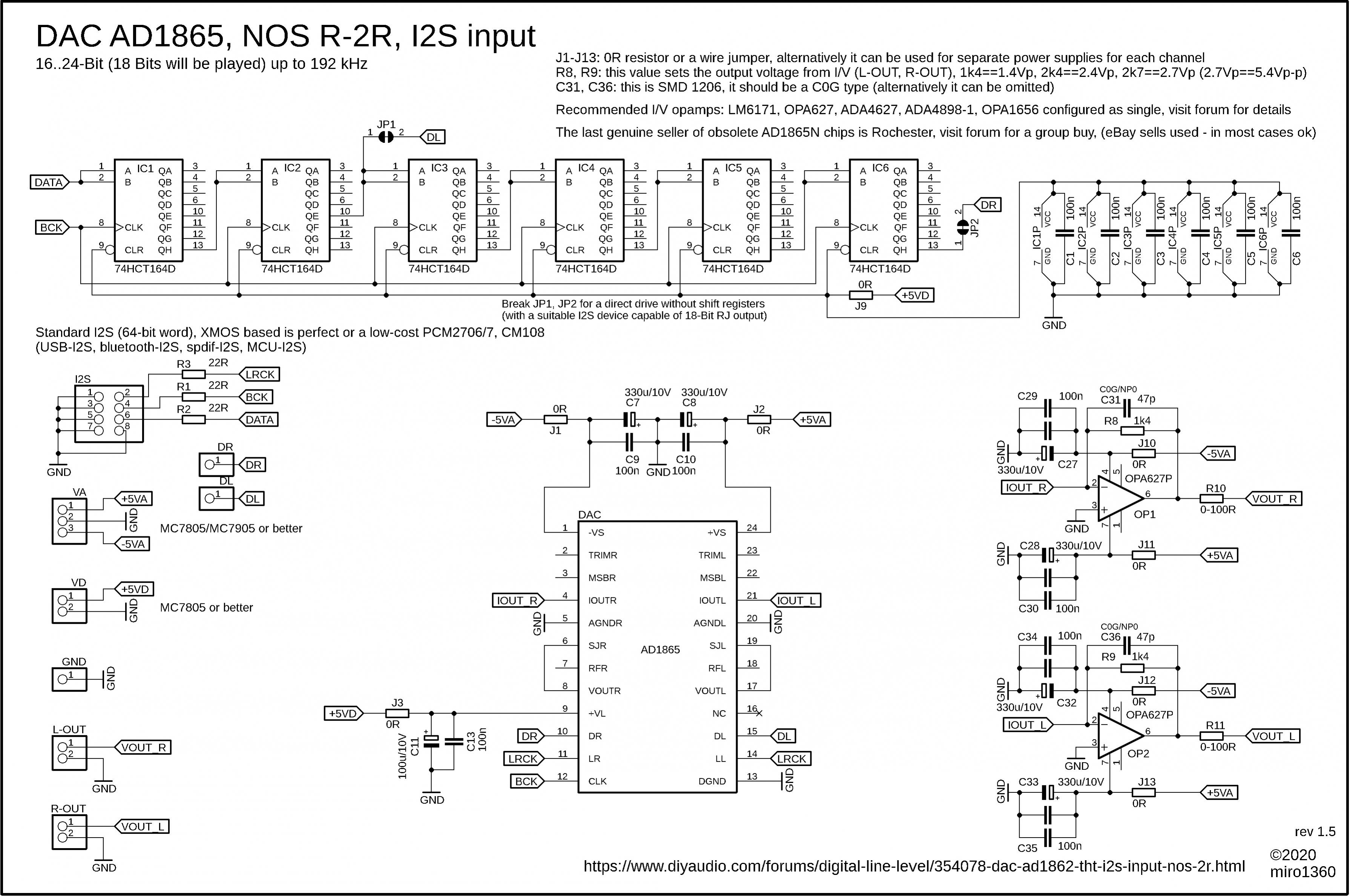

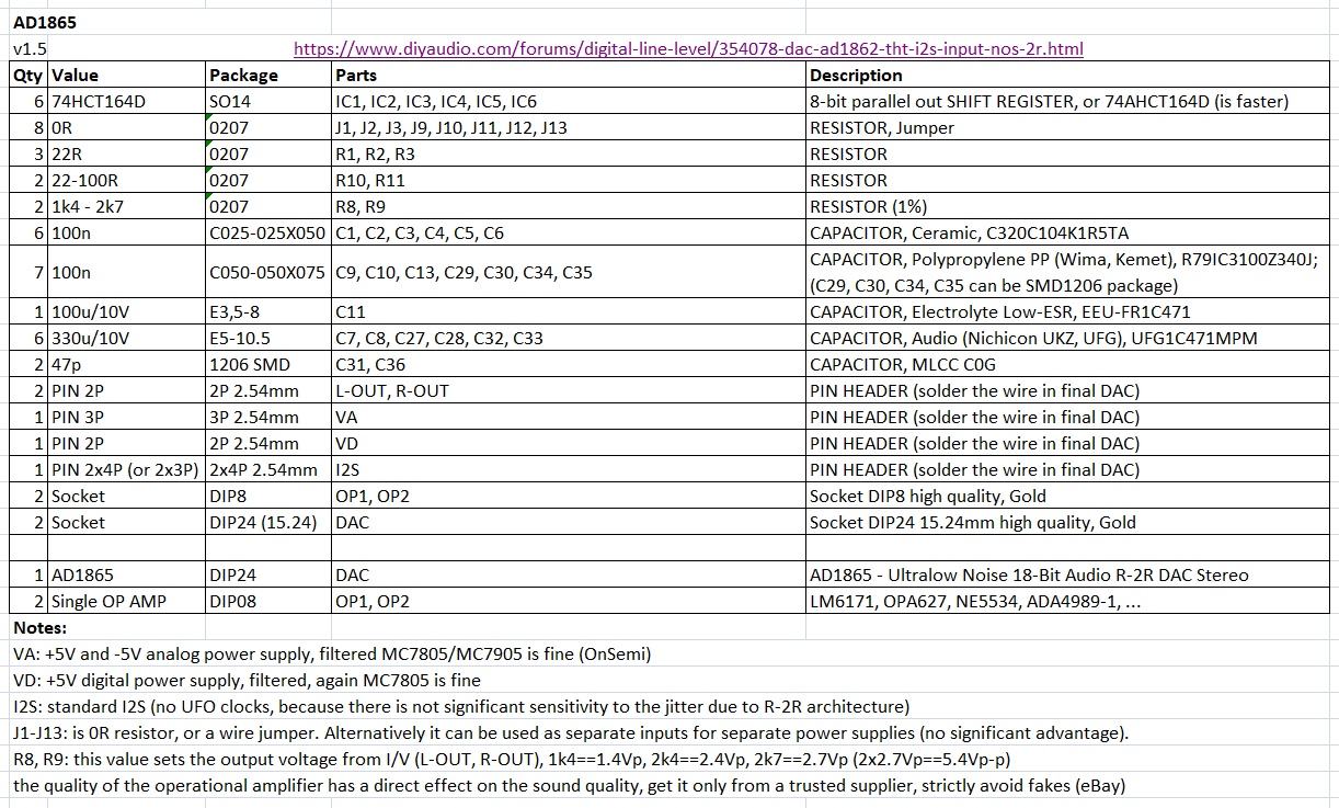

AD1865 ... the same principle
Not having AD1865 DAC in the collection?
Here is one ... the same PCB changed for AD1865 DAC.
It is tested by @Vunce.
Power supplies are slightly different!
analog part: +5VA, -5VA
digital part: +5VD
Have DIY fun

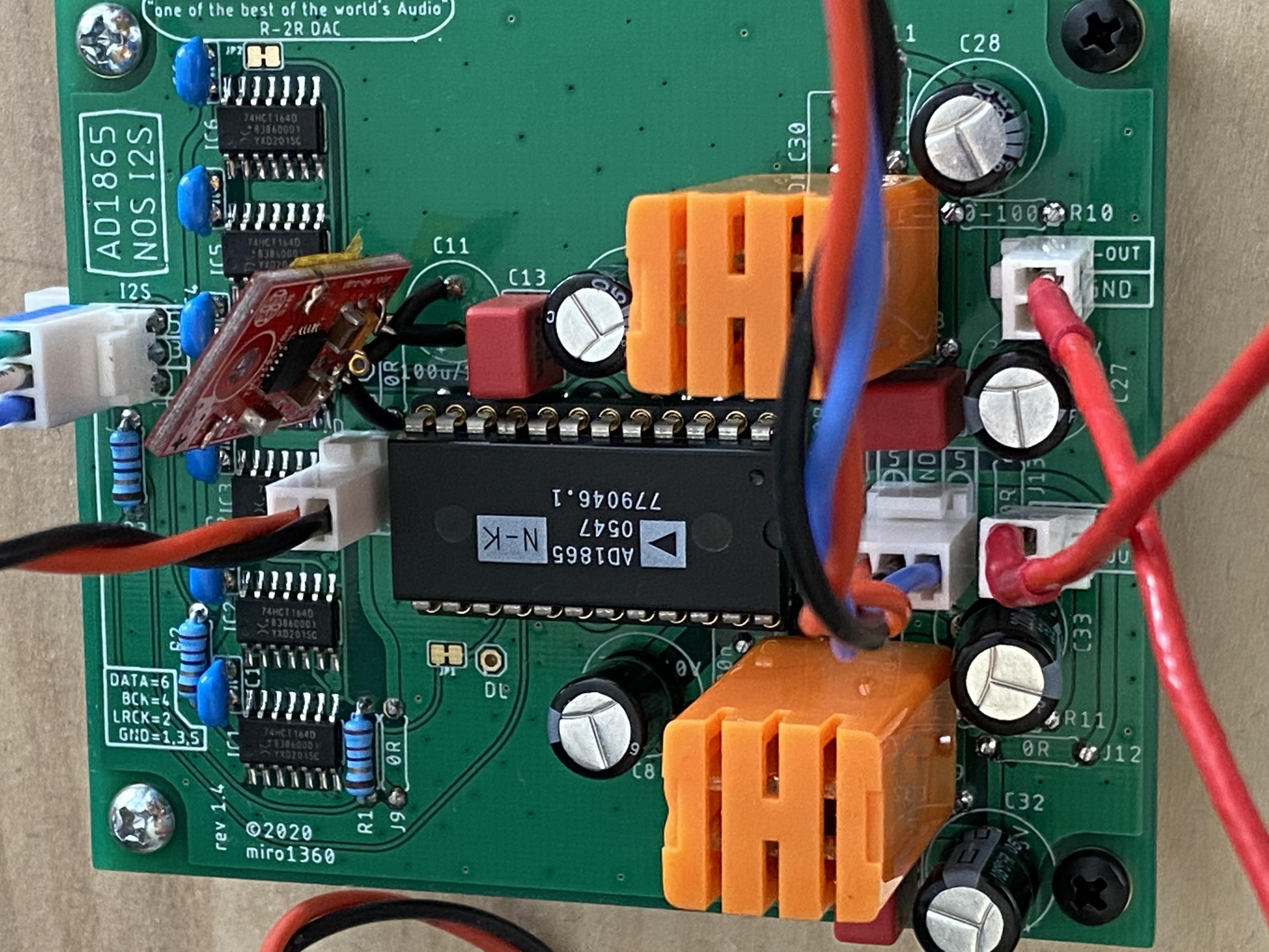

Thanks for another “Toy” to fiddle with, Miro
This new board works perfectly, I loaded it with Panasonic FR and Wima MKP2 caps. Takman carbon 2K2 at R8,9 and PRP 68R at R10,12. Components are place on both side of board again to clear room for opamp and I/V tweaking. Listening now with Burson opamps.
The double row 6 position header is awkward to work with, glad you modified it so the GND pad is inline. Now a single row, 4 position Molex KK type header will work. Also the addition of SMD pads for the bypass film caps around the opamps is a nice feature
For the first tweak, I added a TPS7A4700 +5v regulator right at the AD1865 digital supply pin.
My AD1865 chip comes from a past Rochester GB, they are the only place I know of that still has genuine goods.....Maybe Paddy G. will start a new GB if there is enough interest

Thanks Vunce for your detailed description. The adjustments are added on your tips
No worries, DIY things increase over time
Did you compare the onboard V-out option?
Hmm... not yet NB.
But, I assumed (probably bad to do), Iout is the way to get best sound from these Dac chips.
