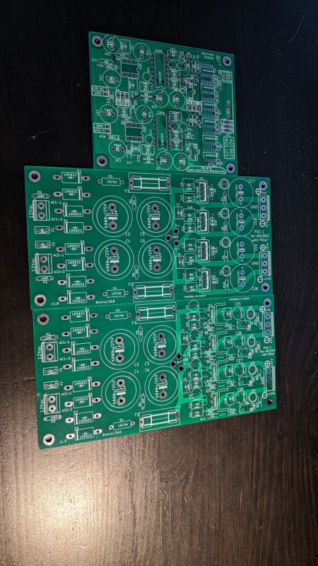

As I have got a pair of the rochester ad1862 dacs and I have got a pcb from diy Iggy last year, l will start building this nice little dac somehow soon within the next two month, or so.
I think about a CEN i/v from Patrick or a transformer from Ivan.
I don't need a balanced output, but an appropriate transformer allowes balanced out as well which can be followed by a nice buffer or anything else.

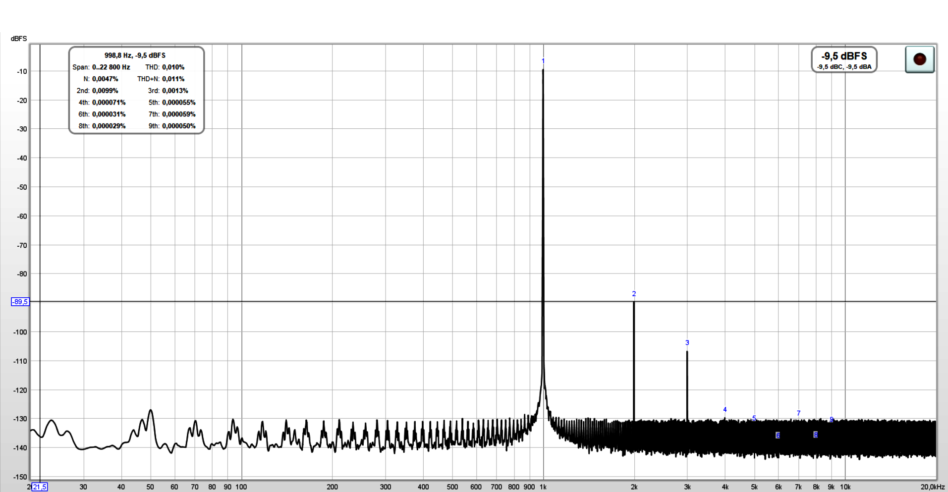

And just to demonstrate the purpose of using balanced circuitry.
This is the distortion spectrum of our discrete AD844 IV (see attached).
https://www.diyaudio.com/forums/dig...mirror-iv-converter-la-ad844.html#post6341451
The Pedja Rogic discrete IV has a similar distortion spectrum.
https://www.diyaudio.com/archive/bl...-out-production-pedja-rogic-ddnf-iv-stage.pdf
You can see that H2 is ~10x of H3.
But with good matching, you can cancel H2 in balanced mode by 20~30dB.
And then we are getting close to -100dB THD at full swing.
Opamp will give you better measurements.
Patrick
