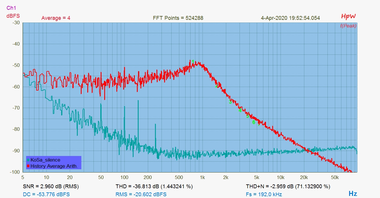

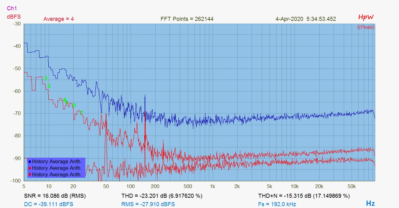

In the last summer I had no better things to do than stay at home amd test regulators.. 😁😄
First pic is a noise comparison between a small, 3 terminal shaped TPS7A4700, and an LT3042. The lowest curve is the noise of a 60ohm resistor, that is 1nV/sqrtHz. It's visible that the LT3042 is 6dB higher - 2nV/sqrtHz, as declared.. The TPS is like 10nV/sqrtHz, not that bad at all..

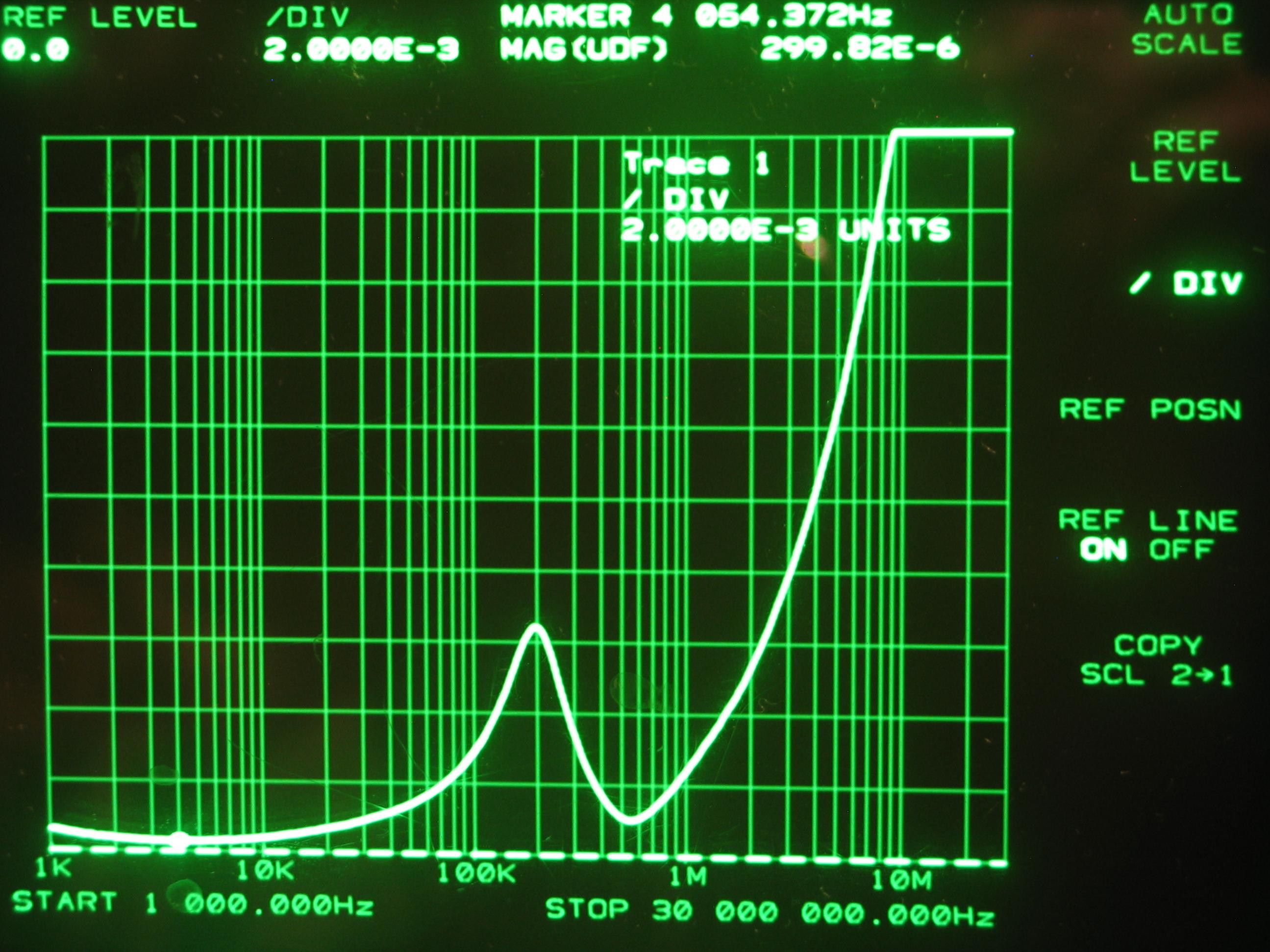

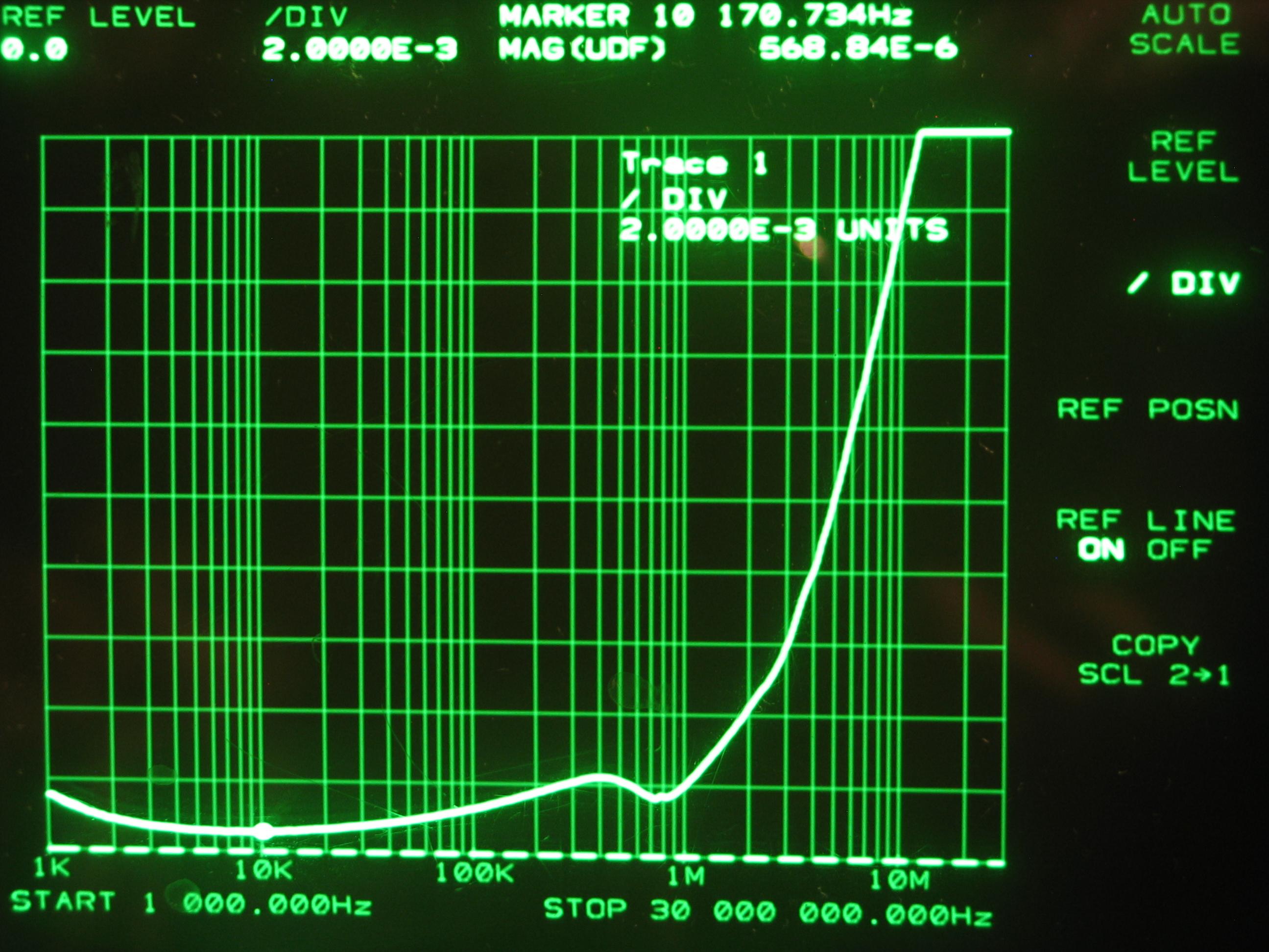

Then, the output imp. curves as taken by my faithful 3577A. Linear vertical scale, not so usual, so don't get surprised about the steeply rising parts. That is normal..
But look, ma, thry're starting above 1MHz..
The first is the TPS curve, below 100kHz goes deeper than the next curve, the LT3042. But look how less resonant is this second one, and extends above 1MHz.
The value is like measured 2/3mohm for TPS, cca 5mohm for LT3042.

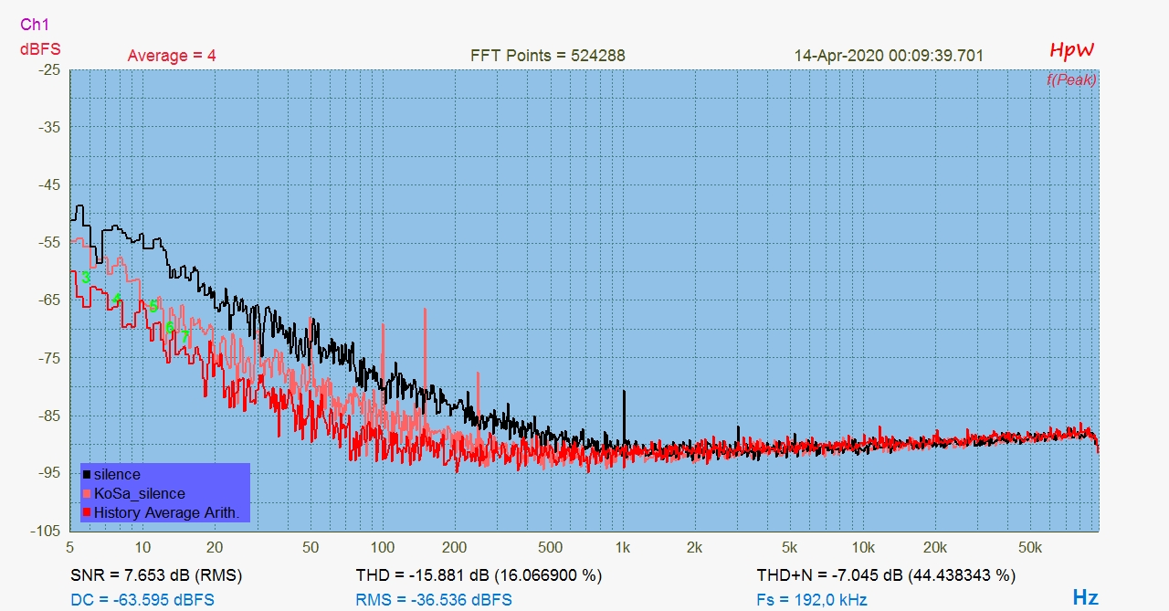

And finally some test on a LT3042, with different (increasing) noise filter caps - lowest noise curve is a cca 20uF MLCC... (bleacch)

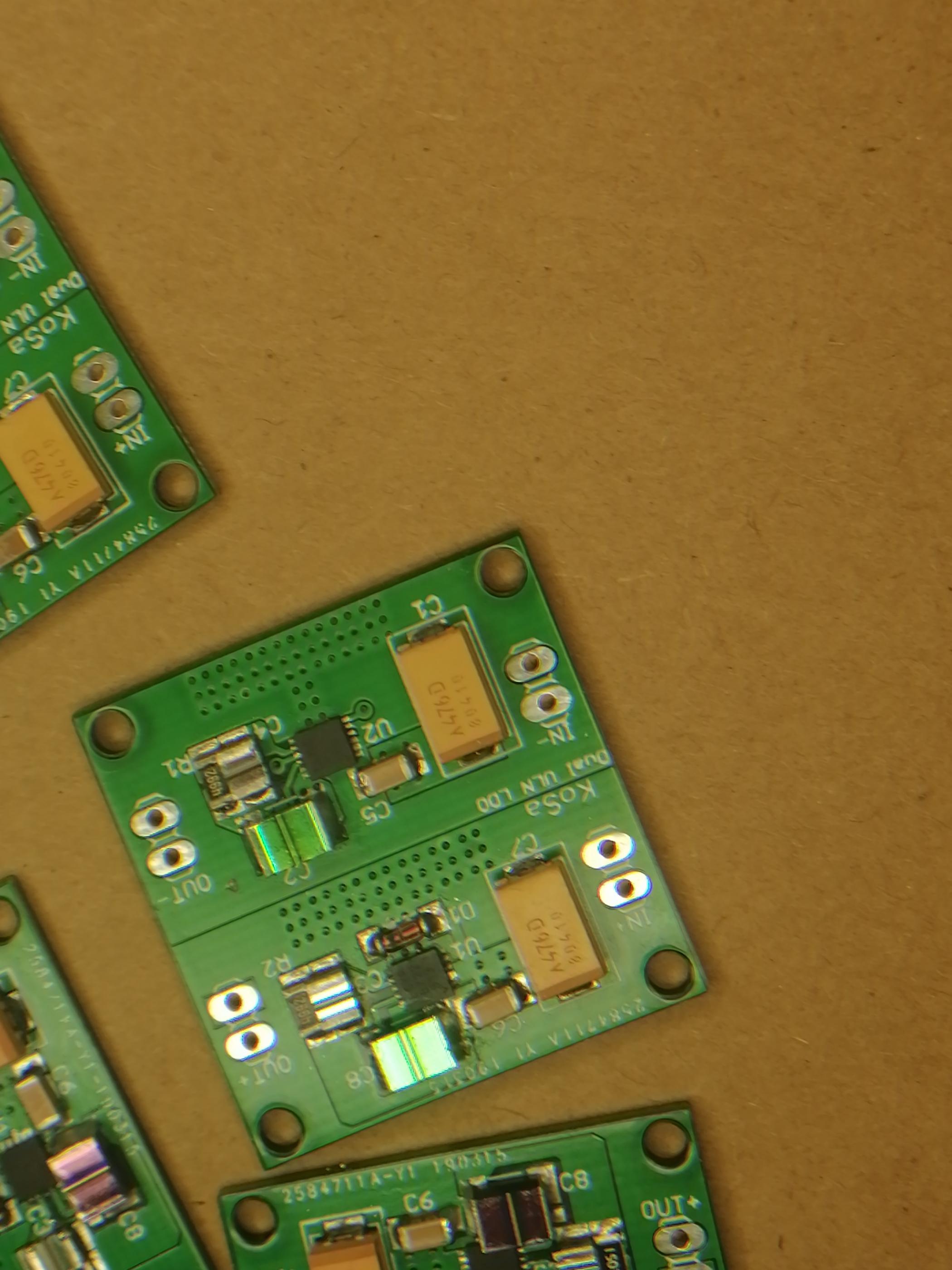

Finally, You don't need to be forced to use only MLCC capacitors for an LT3042 reg..
Here they are PMLCAP & PPS films, in the critical positions.. (that'a dual, +_regulator board)

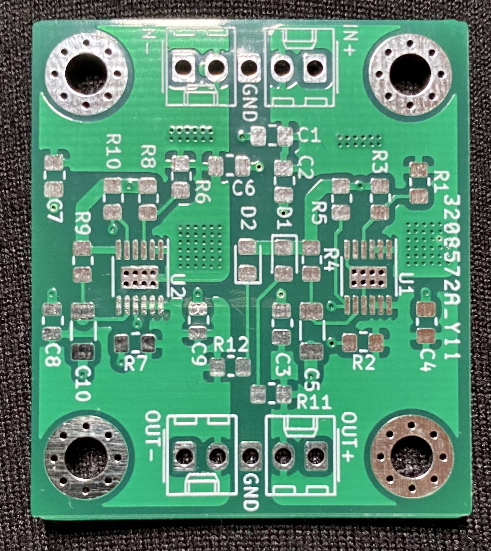

Hello Joseph
Do you have created these boards
I like when inputs and outputs are on the opposite side
Serge
This is exactly my plan.
And the third revision of the PCBs arrived yesterday.
Very good
Do you have an idea about the PCB price
Serge
Very good
Serge
The price is something like $5 for 5 pcbs plus $14 shipping from CN.
Takes about 12 days to get to the US.
If you guys like it, I can share the kicad project so someone with better engineering skills/experience can verify the PCB layout and improve it, before ordering multiples.
