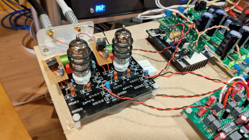

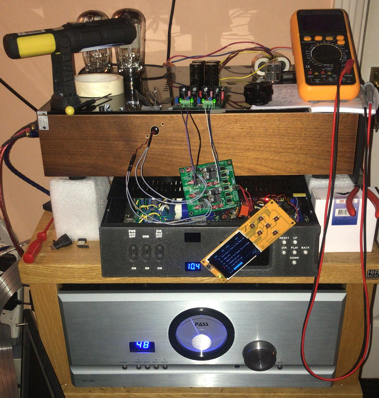

Just to say I think I have reached the end of the line for this little 3a5 stage from AliExpress with Miro's DAC. It's taken a bit of work to get it here, but it sounds wonderful, and I'm very happy with it - it should be a great complement to a solid state stage.
I've received a lot of help with this, so much thanks to the fellas over in the tube forum and Rod Coleman who not only supplied the kits for the filaments but also advice along the way.
So, it's a 3a5 kit from AliExpress, choke input B+, CCS on the plates, Coleman filament supplies. Yet to be added is a time delay relay to allow muting on power up and down. Very happy with how this sounds, it's really very very good.
.... Very happy with how this sounds, it's really very very good.

Good result Fran. I have to say that I didn't clock that the 3a5 is a DHT - no wonder you had a lot of hum and I can see how the Coleman regs fixed that.

@samoloko - Comparison between SEN and 3a5 stage - well, they are different in lots of ways. The SEN is more precise, and I'd think its probably more "correct". Its very sweet, very stable, and there is no start up shut down issues like there are with the valves (as the output caps charge etc). The other thing that can't be overlooked is that SEN is much much simpler, other than the floating supply. But if you use 2 x rechargeable 20V drill batteries that issue is largely put away. I think ultimately that both sound excellent, and it is a matter of personal preference.
@nautiboy - Ales website is the bible on this valve (and all things DHT)- everyone refers to it! I have some 01A valves on the way to try out at some stage, but that's a longer term project as I gather the bits over time. I have some delay relay boards on the way, so I should be Ok. I could just wire them up on a bit of perf board but I'm lazy like that, and much prefer working off a PCB in general (more laziness!). Rod was really great to deal with and would 100% recommend his work.
Do you know when you build something, and you just kinda know its rock solid. Nothing is varying, or needs to be tweaked, or that you need to be careful about? Well, its like that with this build, its one you'd have high confidence in. The last thing is to add the delay relays and its good. Its a question then of a box to put it in to protect fingers from the B+
