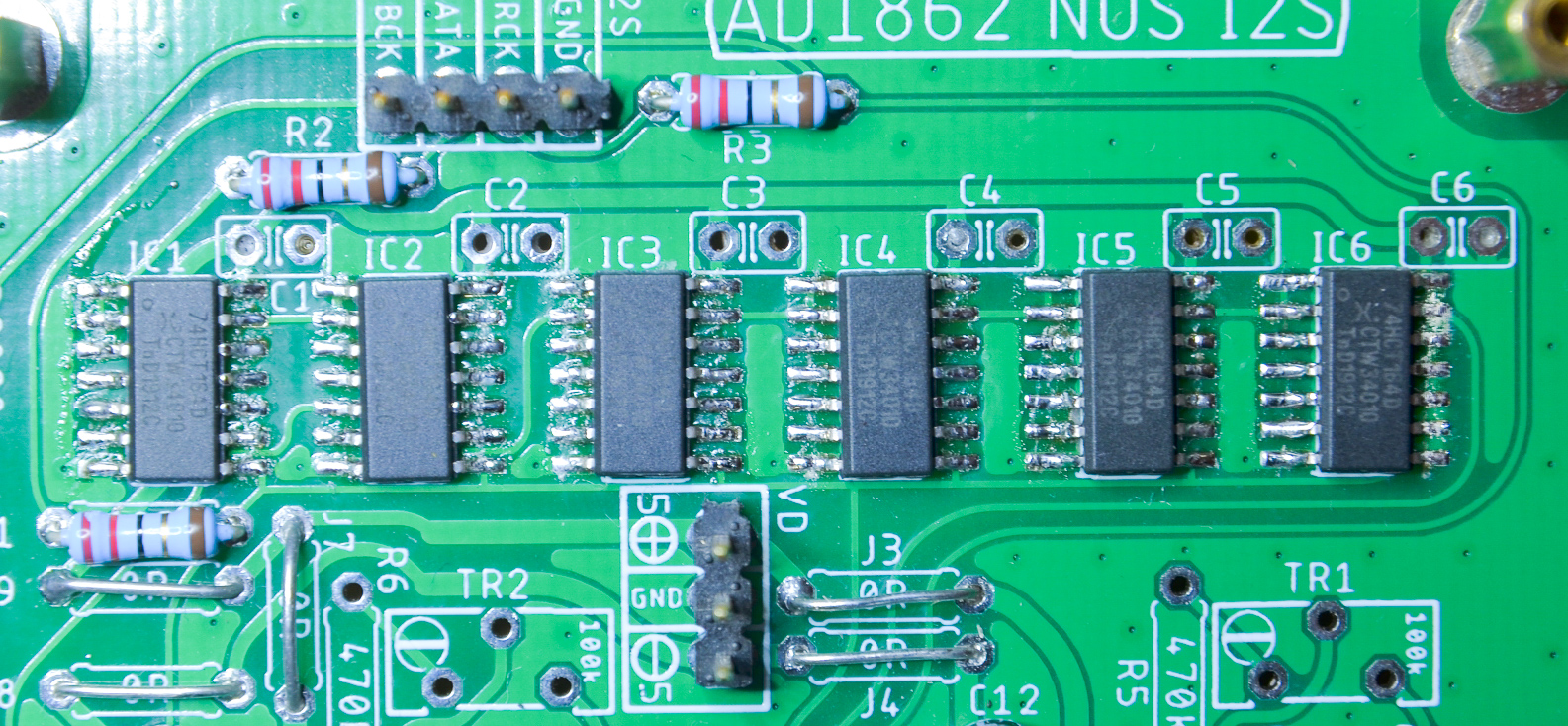

Just a quick update on the progress of the AD1862 dac board designed by miro Just finished building it, but without use of the opamp i/v.....
Very nice setup Mllum!
I was also curious about the D1 circuit, glad it’s working out for you
To save you the process of finding the right pin, the LRCLK the top left pin in this pic
Lasercut - do you mean the top left pin of the stm32 chip there? The ISSI chip is just ram I think?
