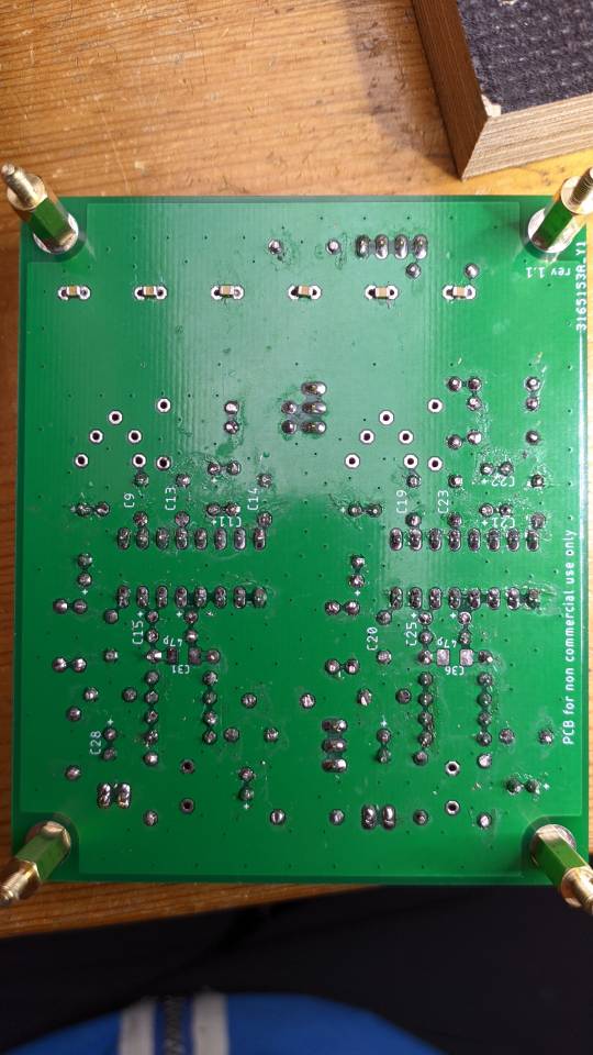

I would put some more flux on all pins and just go across all pins with soldering iron... Some pins on ic1 and ic2 you can still see pads...
exactly what I was going to write to Ernst at seing the picture... and a little more heat maybe.

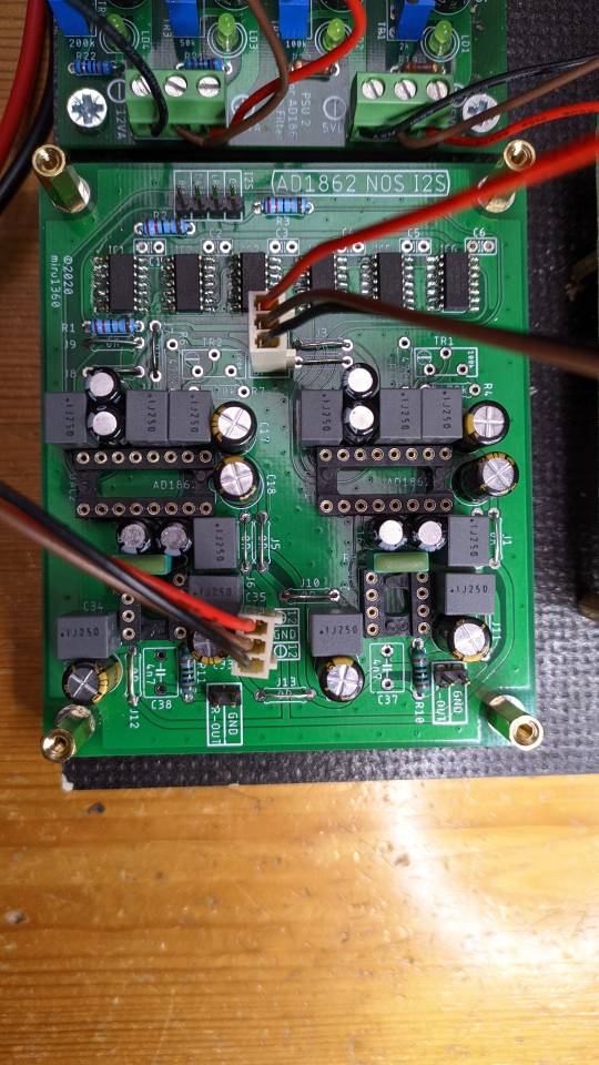

Good afternoon, thanks for your proposals. I'll do, even I have checked all the solders. They are all OK. Maybe not enough?
The strange thing for me is, that I have the same signal on both channels. Is there a theory for that?

Can you a couple of pictures of your full board?

Fran, strange thing is, that they come from the appropriate location,
and as I see this, the board does not let me make any mistake here. There is a direct connection from pin 7 (data) to the appropriate shift register. Continuity check was done.
Iggy, I had tried some different ones, yet the generic i2s should be ok. I also checked, if volumio, which I used, was switched to the left channel only, even this never happened before. Yet I did not find a swith for that within.
I used Miros "original" BOM (in this case from EASY DAC) for that. TME delivers just 100 of them, so there were plenty. Maybe I find some others in my drawer.....
Tubee, I had done all the check for shorts and I did it again. No short between grd and lrck.

the dac choice in the playback renderer perhaps?
If your smd caps are not ceramic class II, better to go for ceramic class I, or sorted out PPMS if you have some in your tool box from another project anf id its width fits the vias gap.

Good idea to use c0g caps on underside near shift registers.
Maybe there is a fault on underside, wrong connection to GND from latch enable signal i would check that fitst

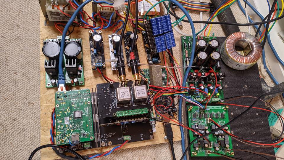

Ja, my IAN DAC is a cable grave. Yet a pretty good sounding one with dcdc less pi, old Andrea clocks, fifopi3, receiverPi, which accepts USB board and spdif. And I like the transformer i/v. So it is a full blown network DAC which deserves a chassis and of course cleaner cable work. One of the next projects. After the easy DAC.
