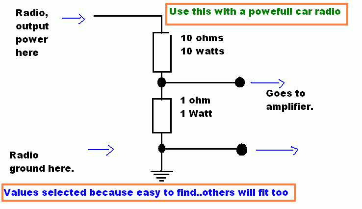

Good Inex..some check is necessary for the amplifier.
Increase heatsinks or include a fan blower if the output is too much hot...to avoid loose your output transistors or worst, the speaker.
The amplifier was adjusted to receive only 750 milivolts of audio... this is a very low power....70 miliwatts over 8 ohms speaker.... very easy, from your car radio to overdrive your amplifier..as it can reach 3 watts easy and some of them can go to 25 watts rms.
No problems with you computer audio...but even better, despite some low frequency noise, is to use the computer speakers headphone output...those small speaker we use over the computer table.
The audio swing that may enter the amplifier is from 1 to 750 milivolts...more than 750 milivolts will saturate the output power, as it will reach the maximum possible output signal.
It is hard to adjust so small voltage into a Car radio....as every audio peak will be many times the maximum allowable to the amplifier.
To use your radio.... a 10 to 1 attenuator may be a good idea, because music is dinamic... voltage are always moving and peaks goes easily over the limits.... different than a continuous test signal, music is a little bit more complicated to adjust volume into a reasonable level....we have to pray not to increase above the limits.
Using the attenuator, your problems, related input signal, will be smaller...do not forget to use your radio into flat position...no loudness, no trebles.... the most flat possible.
Yeah..enormous impedance mismatch using a 8 ohms impedance auto radio output into an standard audio amplifier...but low impedance can drive a higher impedance without problems....the opposite is what do not works fine.
This way..watch the sketch..sorry if i am beeing too much obvious.
