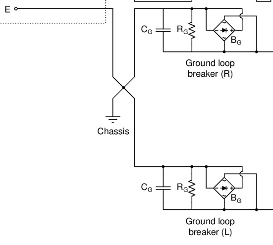

Take a look a the rod elliott sound products site. There's lots of great information available there on power supplies and ground lift circuitsGroundlift / groundloop breakers,
Helo Gents,...i'm trying to understand the groundlift scheme. The main idea is clear to me however I see various implementations. I'm using the powersupply example which comnes with the wolverine documentation but I also see different ones where the ground coming from the PSU/amp is connected to 1 AC side of a fullwave bridge and the other to the chassis ground with + and - shorted whereas the powersupply example is connected different.

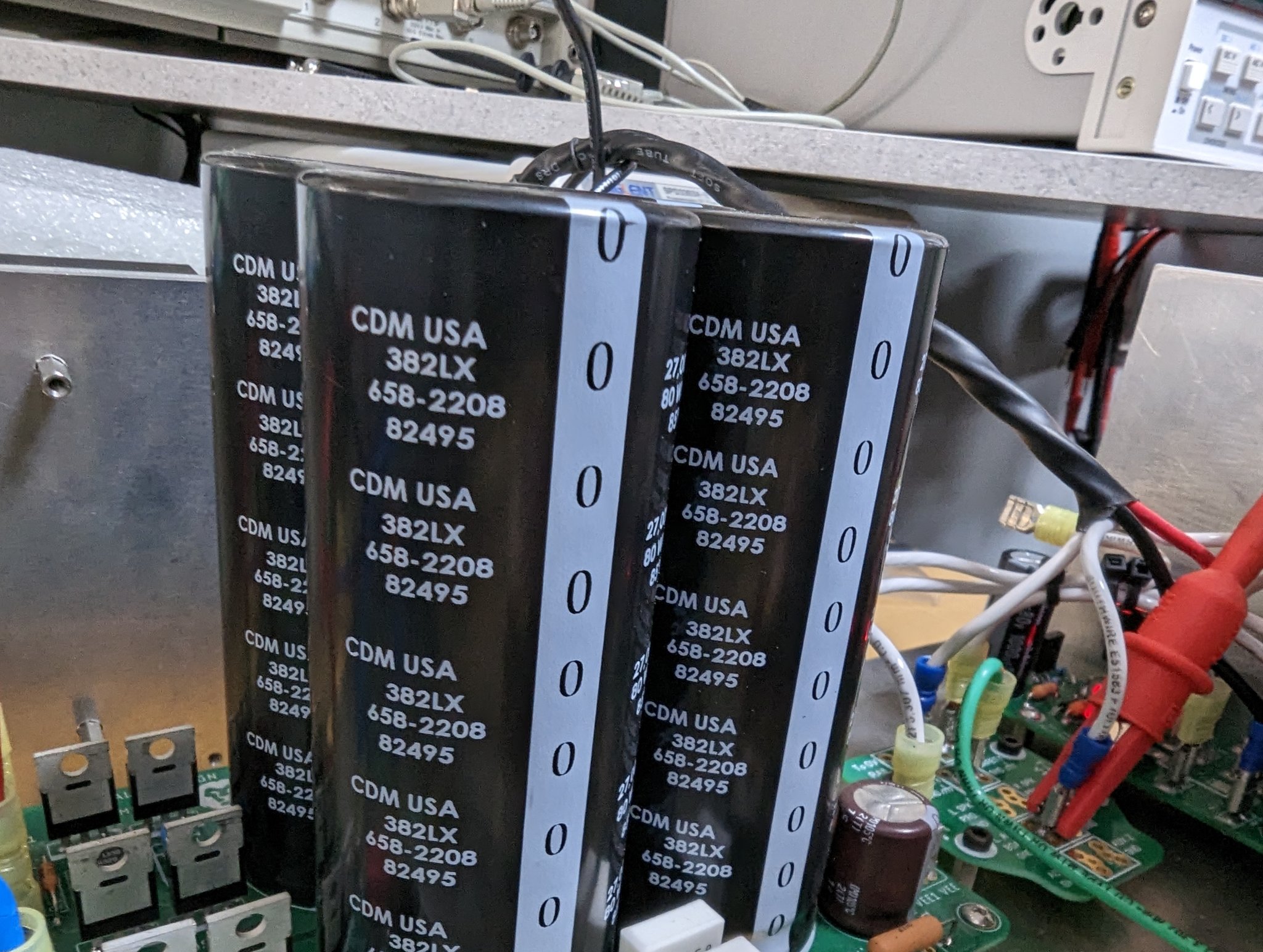

Hi Andy, what caps are those?

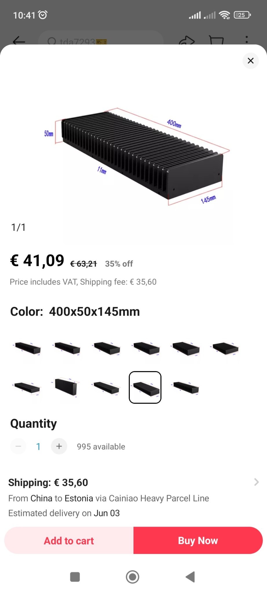

Message them and ask them what the thermal resistance is.Is this heatsink oversized for 4 pair version
A thermal resistance of between 0.18 & 0.20 C/Watt for 80 °C rise is a starting point.
See what they come back with.
Sorry my temper.That's a bit harsh.
Those are decent heatsinks. Not those awful split ones from modushop.
There is a reason if we don't have 400mm long heatsinks but we split them into two 200mm ones. Our supplier would be able to make them but they would be a lot more expensive and in the end we think it was not worth it for our customers. Furthermore, we would need to have them create a special "mold" to produce them which is quite expensive too and in my opinion it's not going to be worth it if the final price is too high for the normal DIY user.
I have had no issues with the split heatsinks or the performance for the wolverine with the outputs balanced between them on the EF3-4be a lot more expensive
Same, these heatsinks work well.I have had no issues with the split heatsinks or the performance for the wolverine with the outputs balanced between them on the EF3-4
Also Modushop/DiyAudio.com shop definitely support their customers. (And the diy community)
And also because they their job is pretty nice!That's a bit harsh.

Here you goHi Andy, what caps are those?
Gaetano.
Hello AndyHi Andy, what caps are those?
Gaetano.

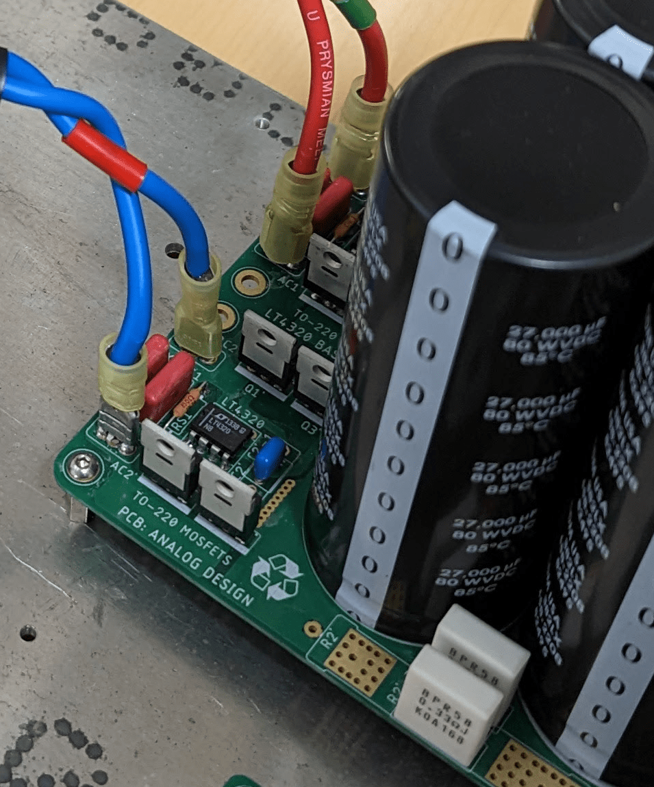

Can I add, what board is that?
Carlos

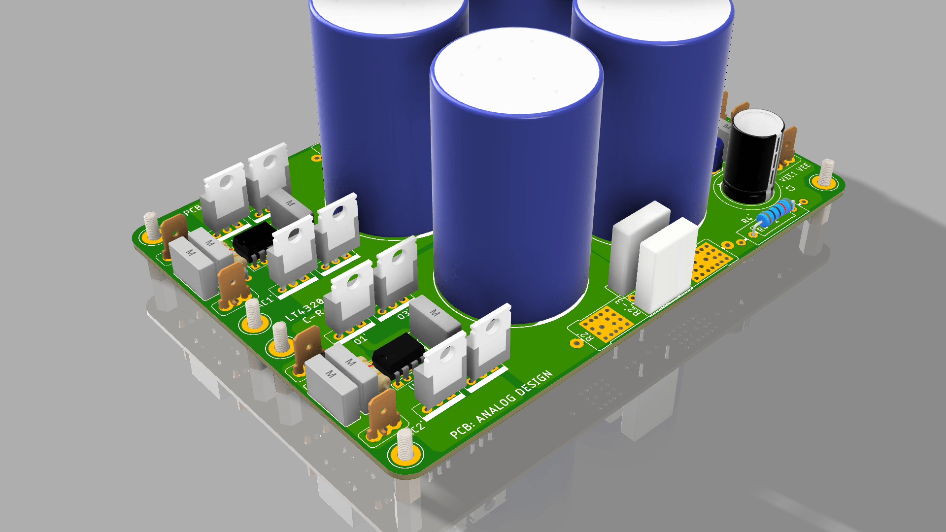

https://www.diyaudio.com/community/threads/lt4320-based-active-rectifier.336572/Can I add, what board is that?
LT4320 active rectifier, designed by fellow DIYaudio member. I purchased the gerbers from him and have boards on hand if you are interested.
Andy
The only statement above I agree with is an active rectifier costs more than conventional bridge rectifiers, the rest I couldn’t disagree more.
You can easily build your own rectifiers for approximately $20 per piece, in the grand scheme of a build this is not a lot of money. They are more beneficial for class A amps, no heat generate from rectifiers, if using a capacitance multiplier psu you gain back approximately 1.5V that the pass transistor drops, no need for snubber components. Definitely not a Snake Oil marketing scam, they work as they should. Also, a soft start module should be used no matter what type of rectification is used. The last point is purely subjective, just listen. Compare silicon rectifier vs active in the same amp with same psu then decided for yourself if it’s worth. I do and use AR for all my builds.
