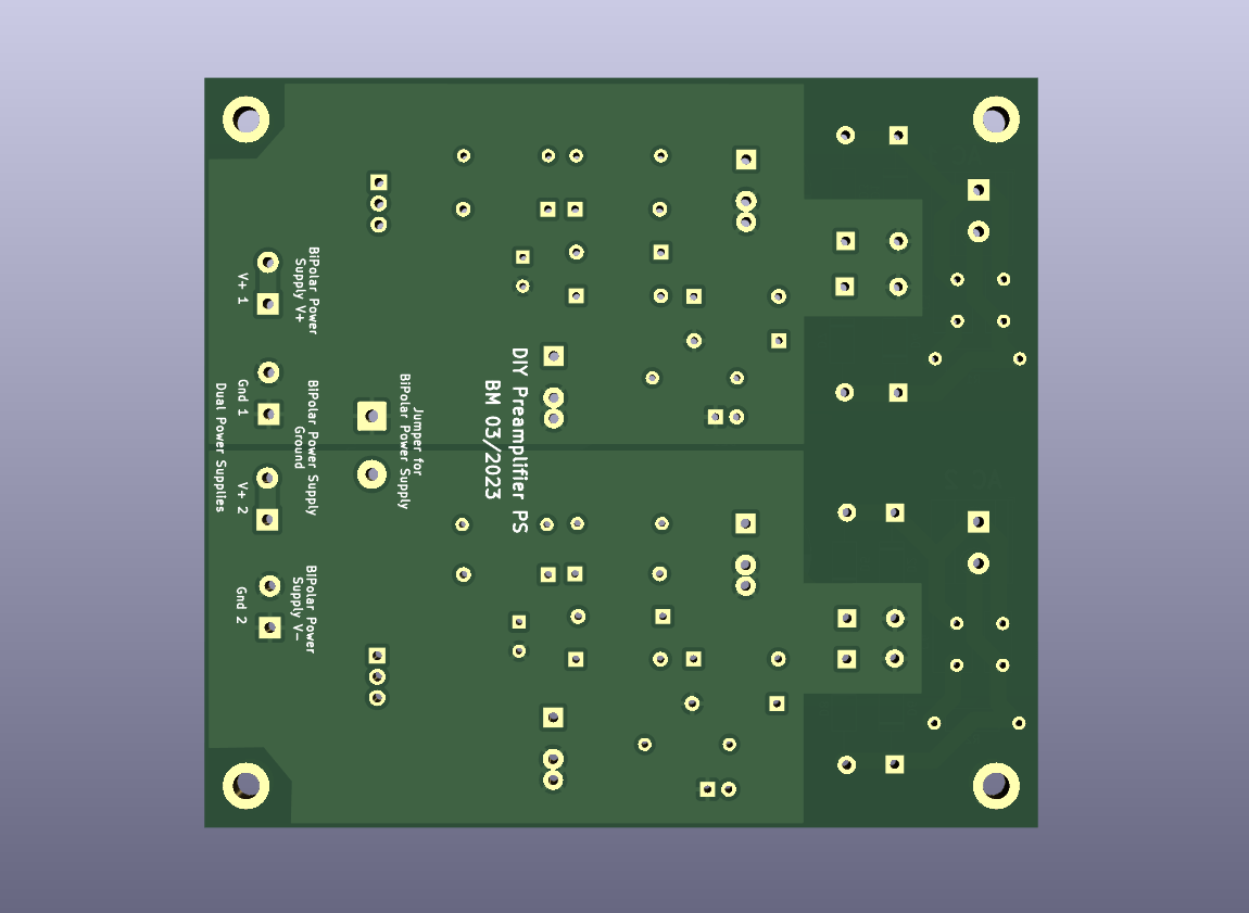

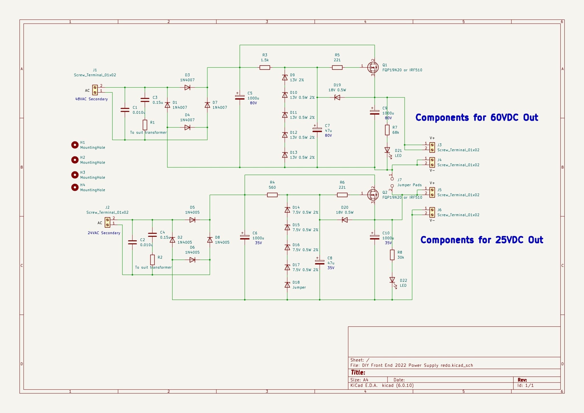

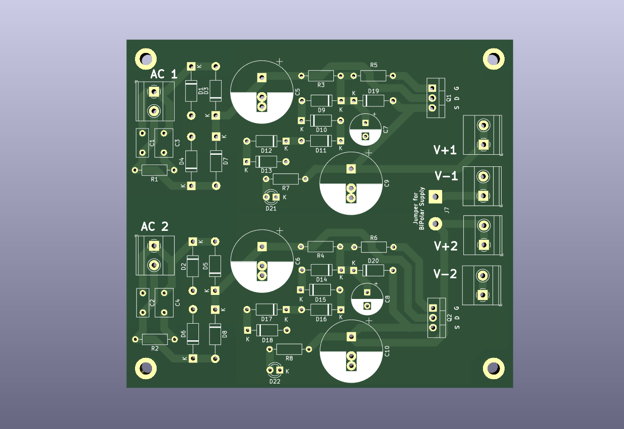

It looks like there is interest in my power supply board so here are the board top and bottom views, and schematic. Note that some component values may need to be tweaked in order to get the exact voltages shown on the schematic. So the indicated output voltages are approximate. This is diy, so tweaking should be expected.
The board is 100mm x 100mm. The board can be used for two single voltage supplies or for one bipolar (V+ and V-) supply.
I ordered my boards from JLCPCB.

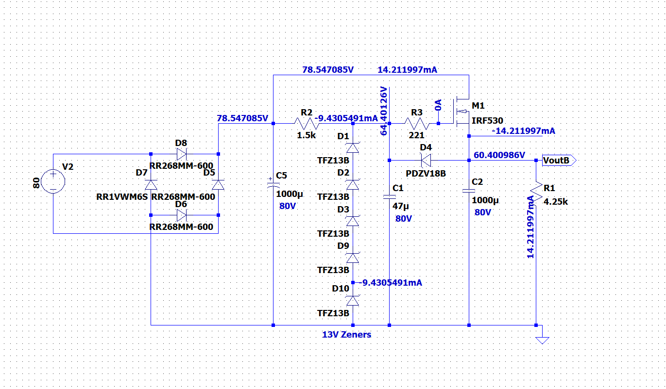

The output voltage is set by the sum of the zener diode voltages (D9 to D13 and D14 to D18) minus Vgs of the mosfet. R3 and R4 drop the input VDC to the voltage set by the zener strings. Choose a resistance based on about 5mA to 10mA current through the resistor to create the required voltage drop. The same current continues onward through the zener string and then to ground. Use this current to calculate the resistor and zener diode power dissipation.
For those who are not familiar with this type of voltage regulation, I have included a screen shot of a LTSpice simulation. Included are voltages and currents at various location to show what happens in the circuit. Note that this is a simulation and the numbers in real life may vary from those in the simulation. I also chose components that were readily available in LTSpice. However the simulation does show how the regulator works electrically.
For those that would like copies of the Gerber files, please message me. I do not want to clutter this thread with requests.

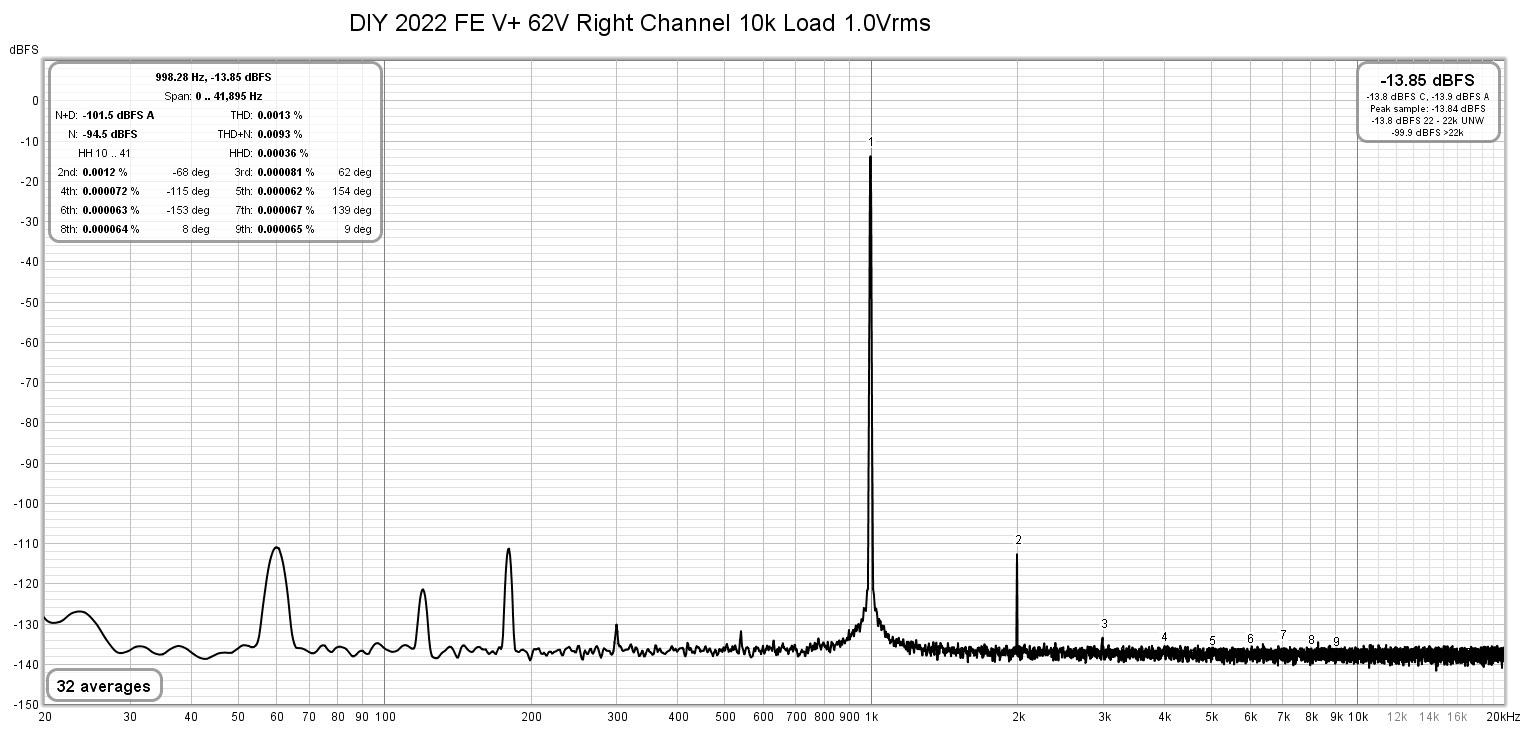

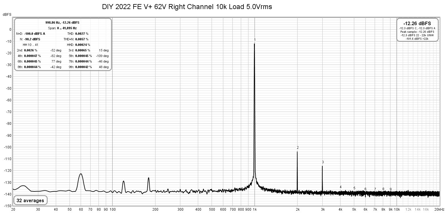

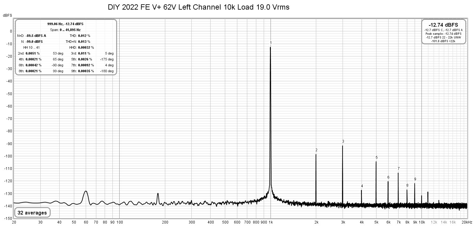

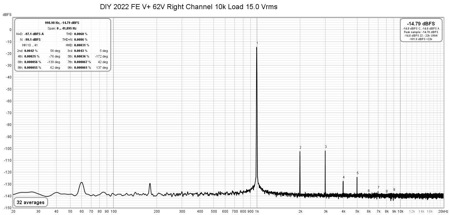

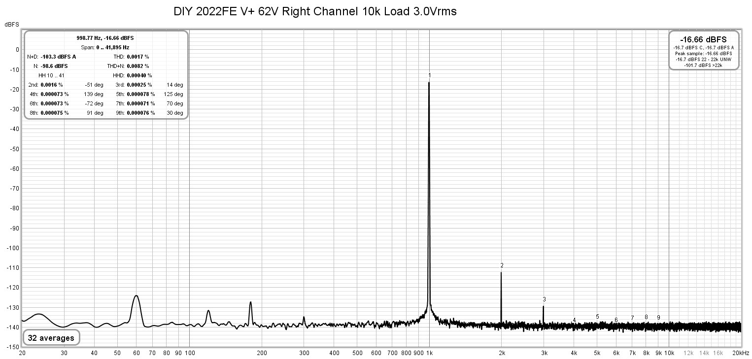

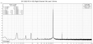

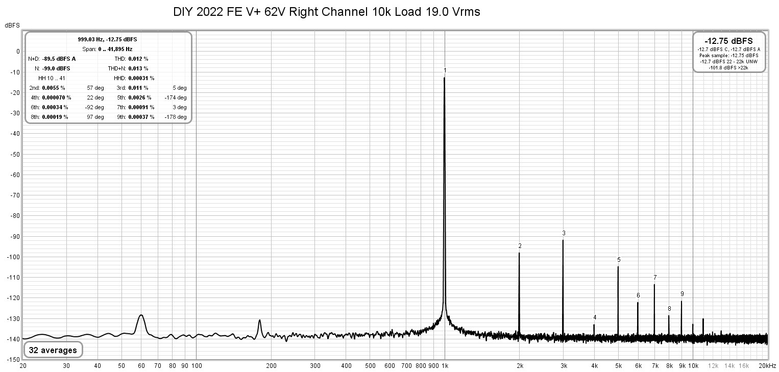

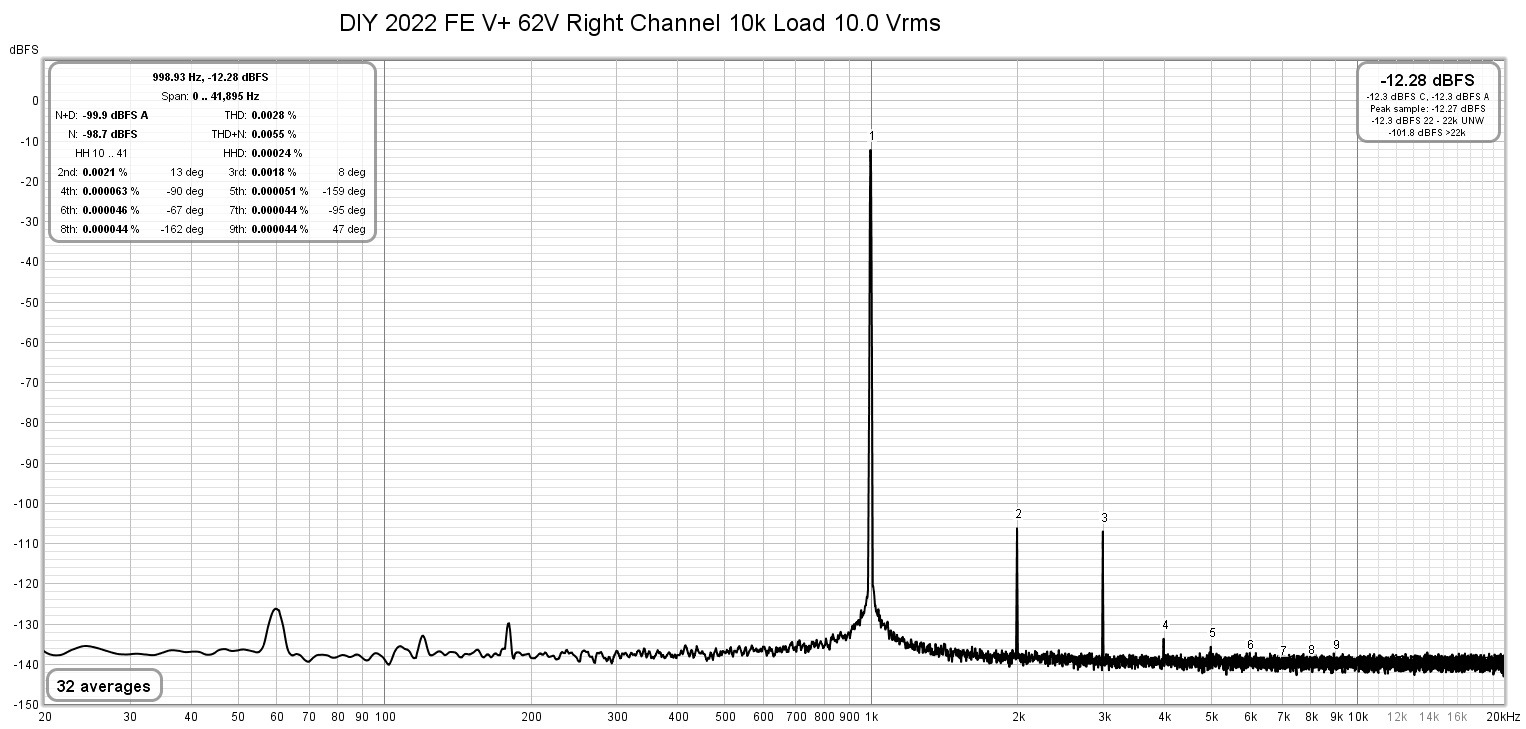

I did some distortion measurements today. Just to recap, the DIY 2022 FE supply voltage was +62V, and I loaded the output with a 10k resistor for these measurements. The highest output that I measured was 19.0 Vrms, and that was limited by my 1kHz oscillator's maximum output.
The right channel was measured over a range of output voltages. I only made one measurement of the left channel, just to confirm that it was similar to the right channel.
The noise is 94.5dB below the 1Vrms signal so I am happy with the power supply.
