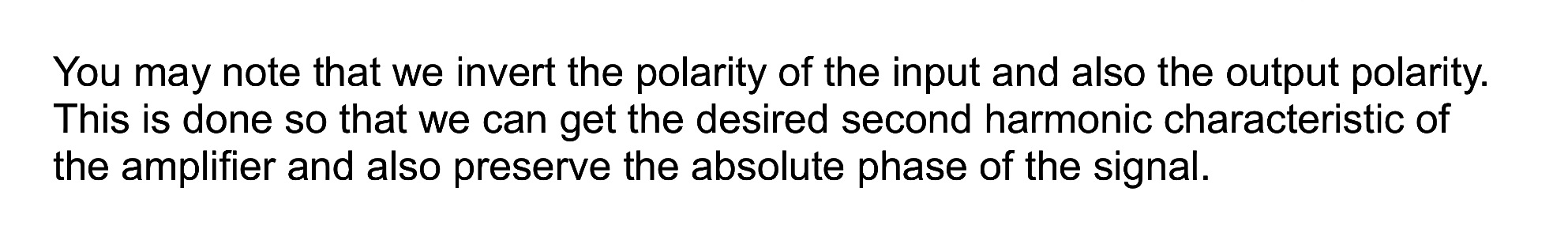

I haven’t tried that yet, but will soon. I’ve swapped AJSS into system so I could do some back to back comparisons
I know with ACA amp sound and is make difference
SE Vfet is reverse phase at the input as well
![piano :Piano: :Piano:](https://files.diyaudio.com/forums/images/smilies/piano.gif)
extract from original Mr. Pass article
