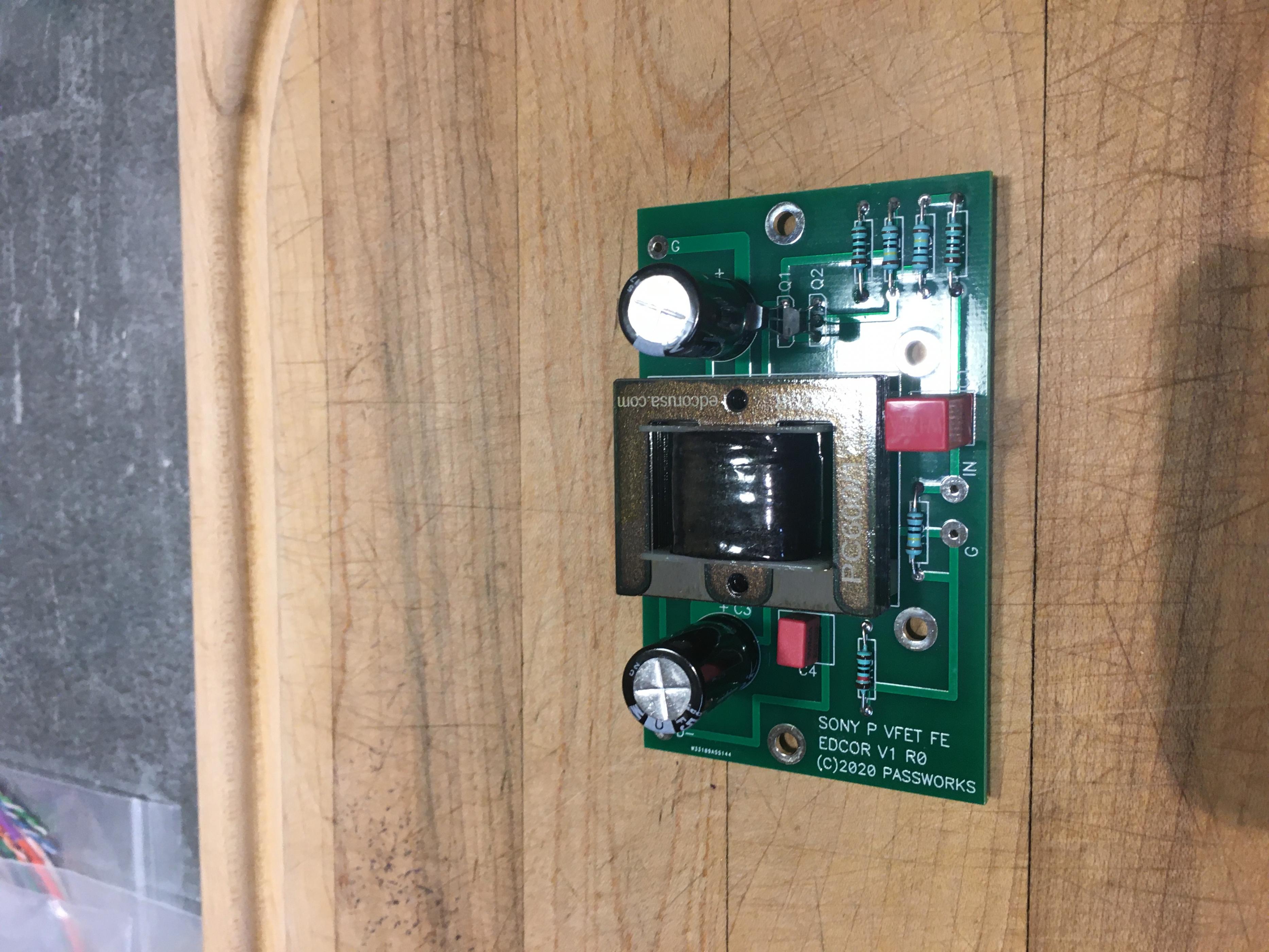

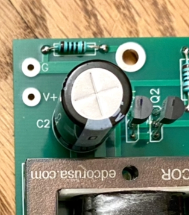

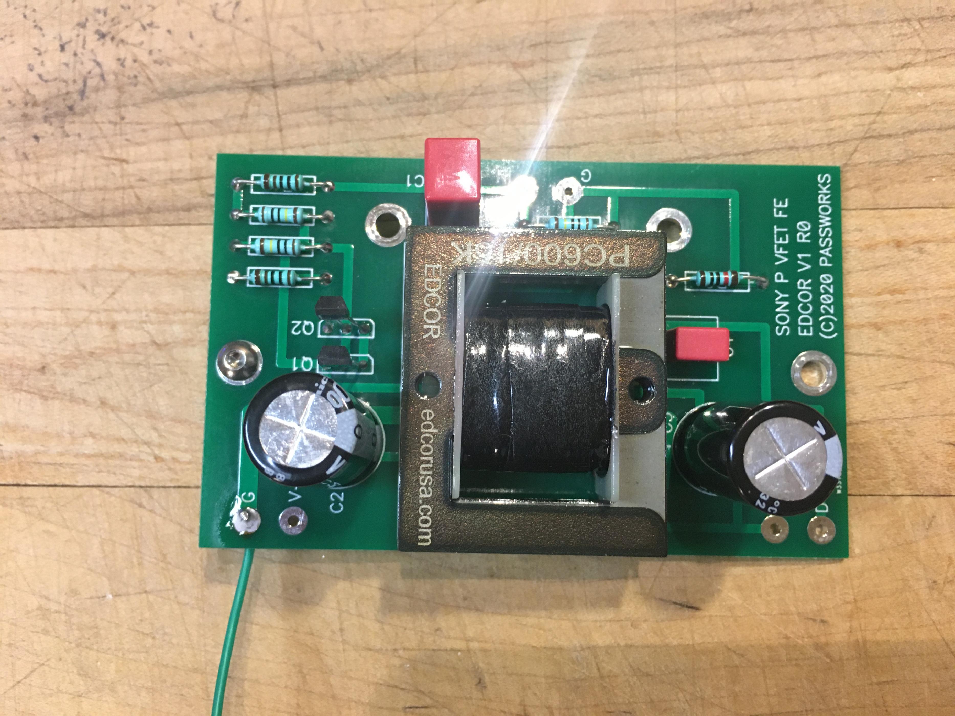

My boards don't have that footprint.
Joined 2019
Woah! Good catch. Maybe Nelson can chime in to determine if it’s necessary. It appears your boards aren’t making a connection to the chassis via the mounting hole either.
*edit* looks like the output is labeled differently too.

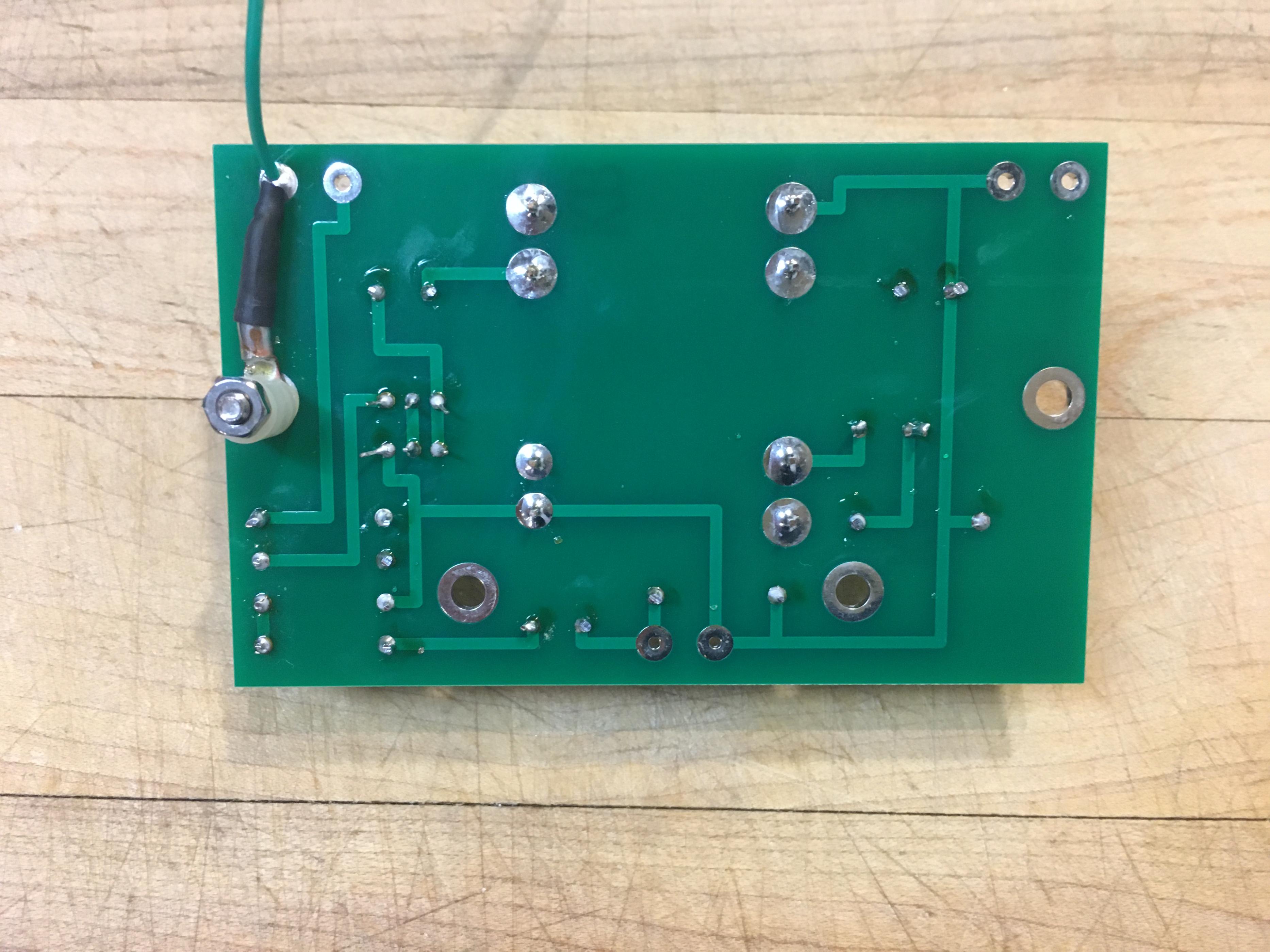

Reference pix I got have + & - wires from the PSU through the connector. But no ground.
Wiring diagram shows 2 wires to a lug and down the the screw on the power PCB for chassis ground connection.
Am I right in assuming wiring diagram is correct?

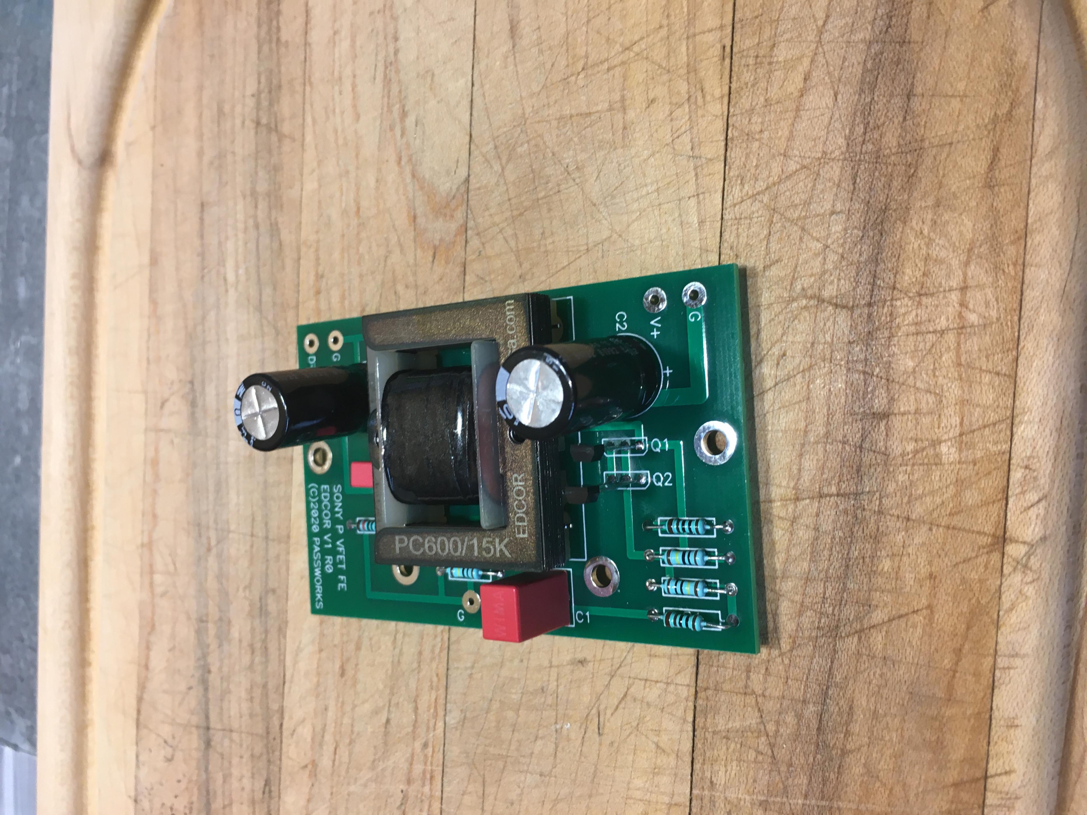

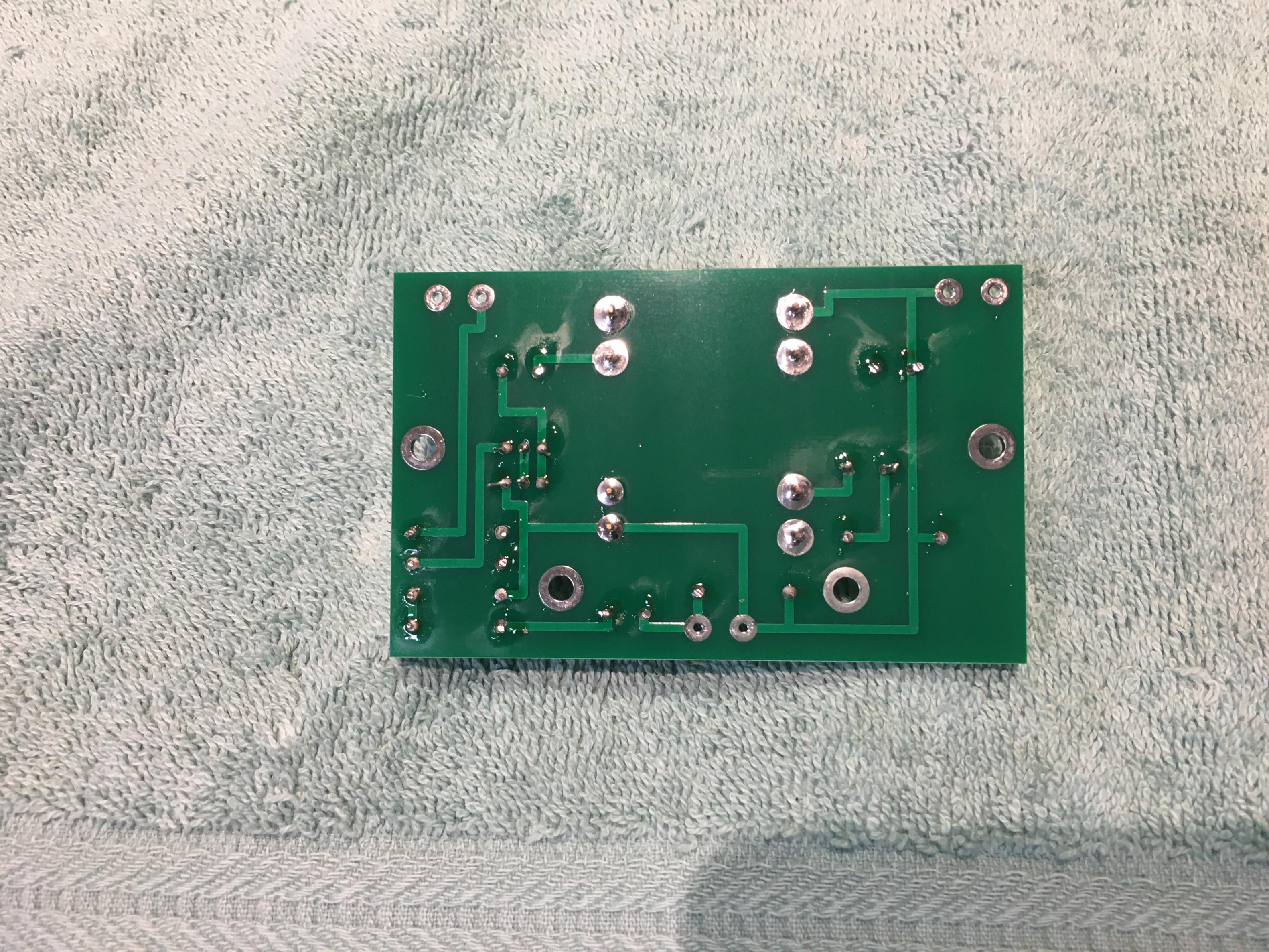

What do I know?... (not being sarcastic [emoji3]) but looking at Elwood’s board. His are missing the R7 and his mounts don’t have traces creating chassis ground.
Pic below shows R7 and trace to mounting hole. 6L6’s finished amp also has the R7 and the trace to the mount hole for chassis ground.
The one and only
Joined 2001
Once again, a couple of older boards slipped into production.
In the future I am going to throw away all older versions of boards...
Not to worry, R7 is just a "pro forma" redundancy on my part. The real
connection to the chassis is on the power supply board through the 5 ohm
power thermistor. Not having R7 makes no difference
Also note that output D+ on the output board became G on the later,
same connection.
Also, sharp eyed DIYer noted incorrect Digikey part # for the 10,000 uF
caps - it should be 1189-2739-ND
If there's any other confusion, let me know.

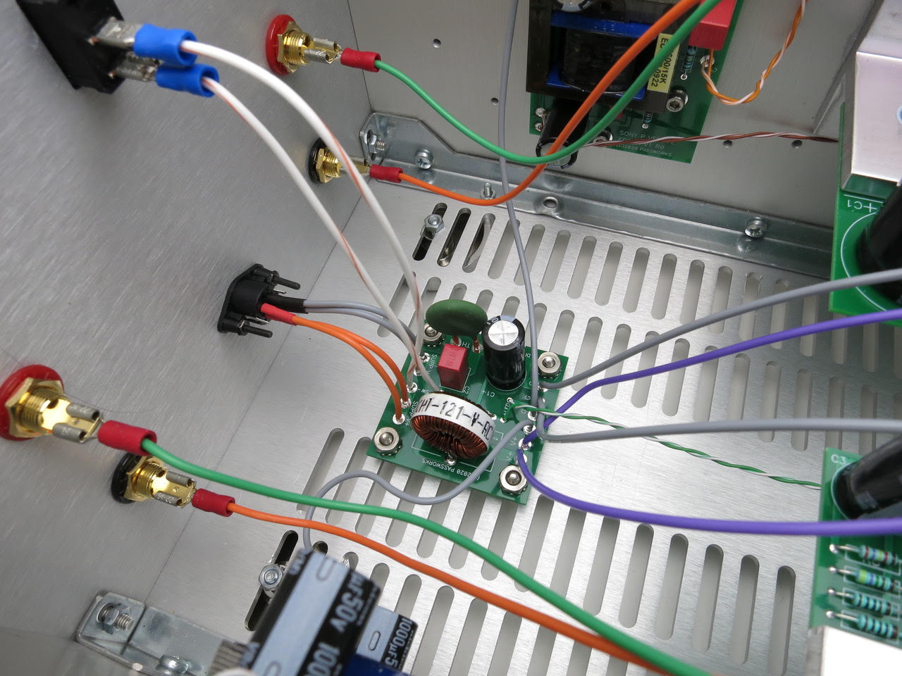

Those spade connectors (blue and red) are they "crimp quality grade"?
I assume you pulled of the isolation and then soldered the wire and put on the isolation again? .....they don't looks as crimped.....
I didn't take that pic, so I can't say if they're crimped or soldered. They don't look crimped in the pic.
@Cody - did you use those disconnects? The 2 I used last night for the switch were some crimps that I have on my bench that I reached for out of habit...
Can you share the part number on that light blue LED in case someone installs it backwards and lets out the magic smoke?
Yeah, I did the same – just use the same ole Panduit 'Discogrips' I always use.
