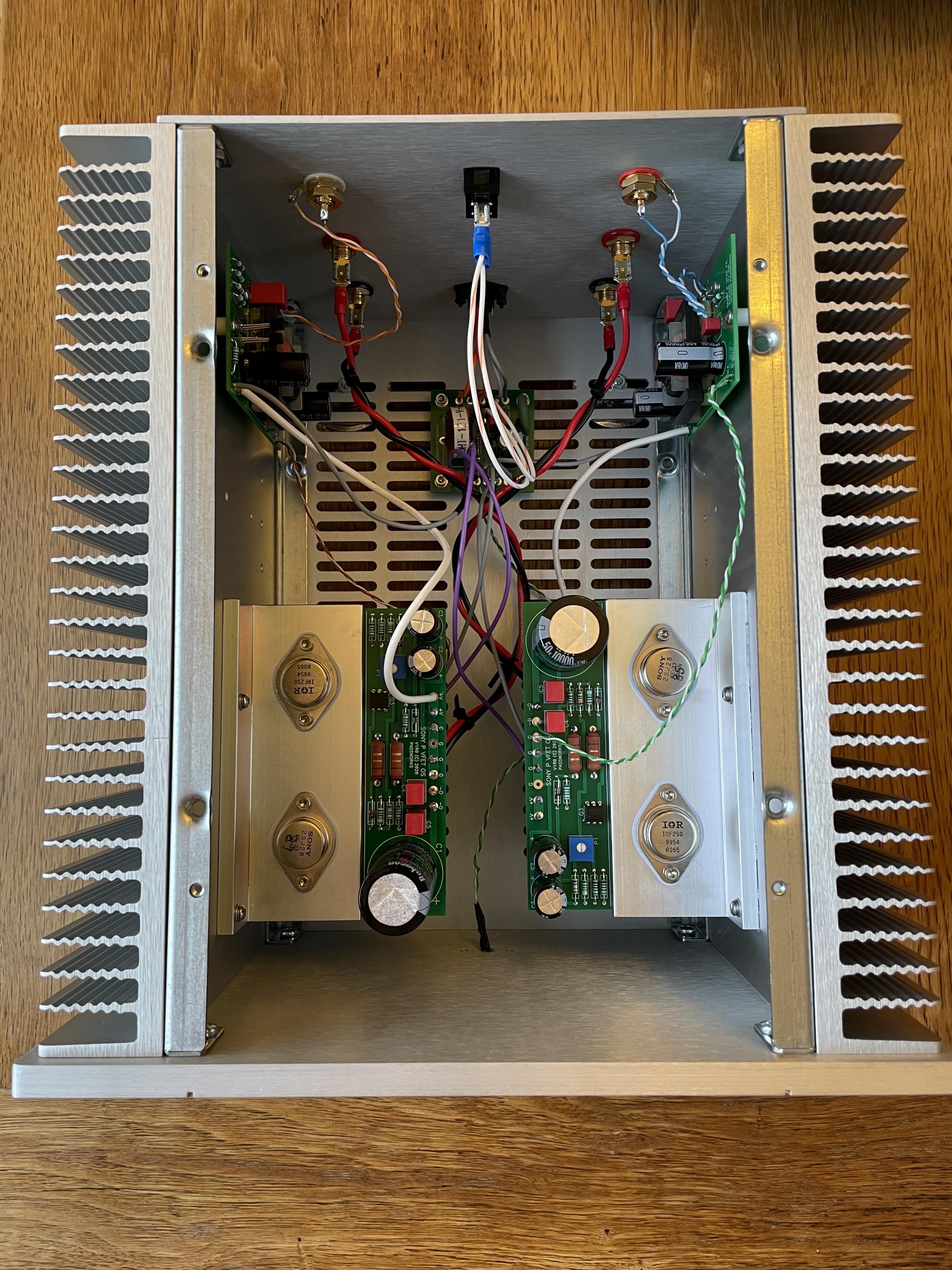

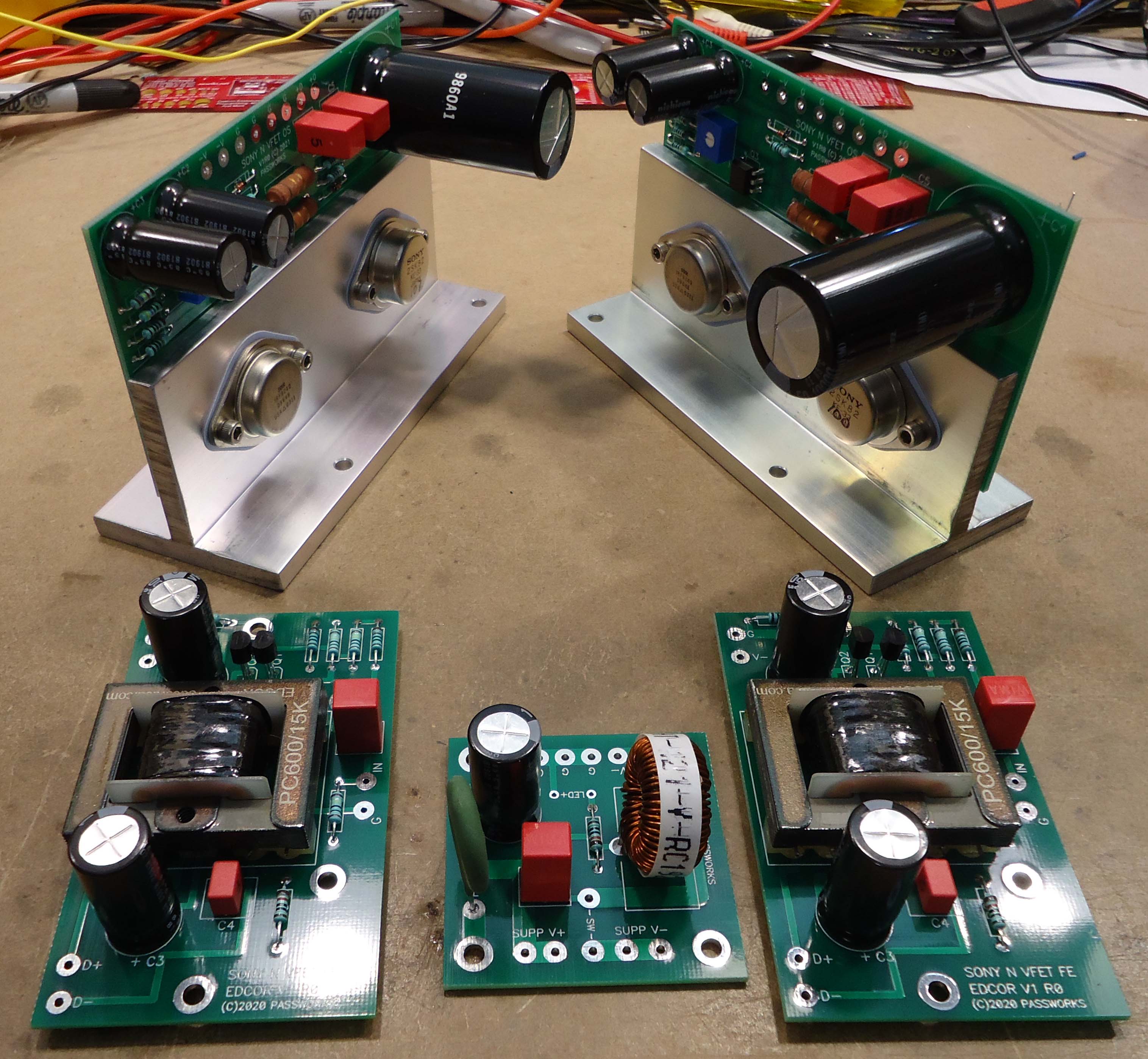

Installation of the FE and OS boards onto the heatsinks is not something that can be rushed.
While the OS PCBs are identical, the aluminum mounting brackets that house the output transistors are not identical. The correct mounting position is the one that places the PCB closer to the front plate of the chassis. The correct mounting position also results in PCB orientation that agrees with the color wiring diagram.
The M3 mounting holes that are used for the OS brackets need to be cleaned up with a M3 bottom tap. This will make sure the screws are properly snug against the bracket. Alternately, one can file off a couple threads worth of the M3 screws, or add another washer or two, if available. Since I'm used to needing to clean up mounting holes, I have an M3 bottom tap available. One can convert a M3 plug tap into a bottom tap by grinding off the pointed end of the tap until it is nearly square. I like to do this on a bench grinder.
It is best to clean the mounting holes before applying the thermal grease. Yes, I did this backwards, and realized that the screws were bottoming out too early as they became tight before the heads were snug against the OS mounting bracket. The screws for the FE boards will be fine as there is a nylon spacer between the PCB and the heatsink.
There is only one way to orient the FE PCBs so that all four mounting holes line up with corresponding holes in the heatsink.
Attaching the baseplate onto first one, then both heatsinks will establish the distances between the channel boards and the small power filter board. There is one correct way to attach the base plate (and top plate). This is with a small overlap to the rear of the chassis, not the front. The big front plate covers the entire front of the chassis, so the heatsinks, base plate and top plate all need to be flush with one another for the front plate to mount correctly.

Just reading thru all the posts while I wait for my parts to arrive I'm curious regarding the RB7 power plug on the Meanwell.I was looking at the online info and it says the -ve terminals are attached to the AC FG which stands for AC Frame Ground which i'm assuming is the metal outer barrel of the plug.I don't know what the chassis receptacle for this plug is like but does it have a metal sleeve that attaches to the mounting screws of the receptacle? Reason I ask because if that's the case then the thermistor would be shorted out. A quick ohmeter check between the -ve terminal(s) and the chassis with the Meanwell plugged in would verify this.I just found this on the Meanwell info sheet "A type: Class I (with FG), IEC320-C14;" which is the 160W model we have,so it looks at face value that plug has the FG barrel attached to the -ve pins.
Looks like a red herring,on further investigation it looks like the shielded receptacles have a metal plate and the non shielded ones are black plastic which from the pictures here are the ones we have.Sorry for the rant,its what happens when you're retired and locked down.
Follow the color wiring diagram. The DC power conn has six pins, and two of those are connected to the chassis and cable shield. The connection to the chassis is made on the small power filter PCB.Looks like a red herring,on further investigation it looks like the shielded receptacles have a metal plate and the non shielded ones are black plastic which from the pictures here are the ones we have.Sorry for the rant,its what happens when you're retired and locked down.

In the wiring diagram, it is showing the outer tabs of the power connector (continuity to -Vo and mains Earth) connected directly to the chassis.
Is this similar to the safety GND for a mains voltage supply? Chassis is connected directly to mains earth, and "Audio GND" or all the "G's" on the boards are lifted through the thermistor....?
Did some quick DMM readings, and that seems to be the case, but wanted to confirm.
