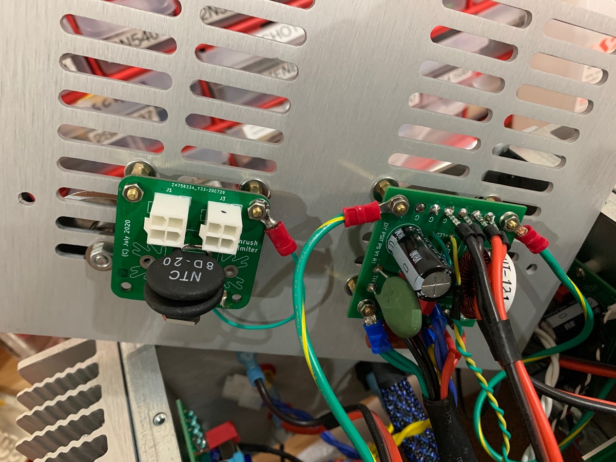

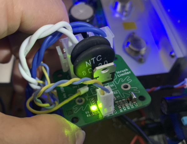

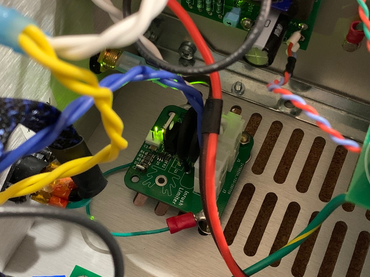

I just installed the Jhofland designed inrush limiter in my VFET amp. It resides between the power switch and CLC filter board. It’s powered by the 36v from the switch. Ground is referenced from the CLC filter board. It has about a 6 second period of flowing current through two 8D-20 NTCs in series. The cold resistance is about 20ohms. Upon turn on, they heat up to about 65C in 6 seconds. They cool down to about 32C in normal operation when the low RDson (6.5mOhm) MOSFET kicks in (the green LED glows to show that the MOSFET is conducting). The voltage drop across the inrush limiter is about 50mV or so. The inrush limiter allowed me install a 4700uF 63v Nichicon cap right on the +V and GND pins of the power rails. The caps work just fine with no hiccup. There is no turn on or turn off thump anymore. I would imagine that the addition of the larger rail caps will have to reduce the level of crosstalk. It might have some other benefits too - perhaps more bass authority?

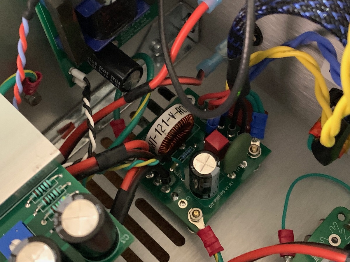

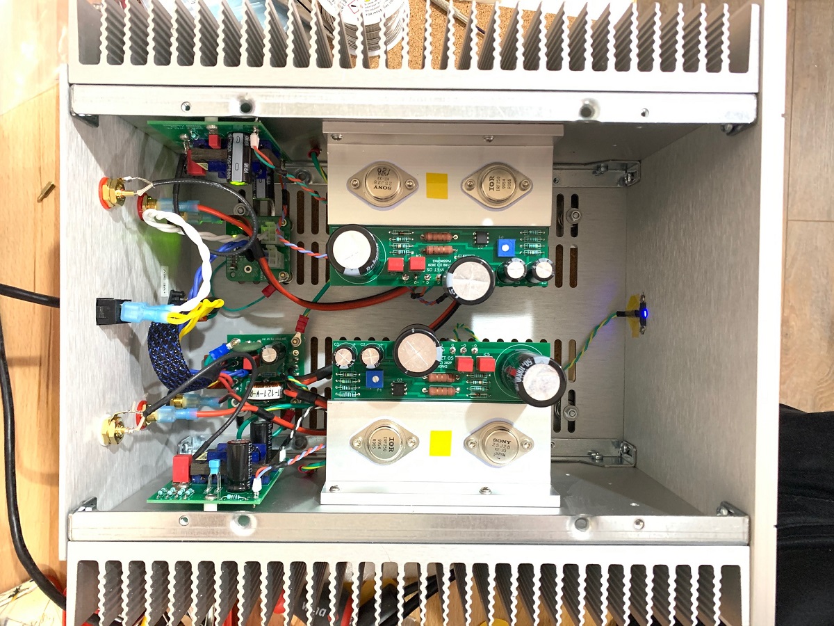

Installation of the CLC filter and Inrush Limiter on the floor panel prior to final assembly:

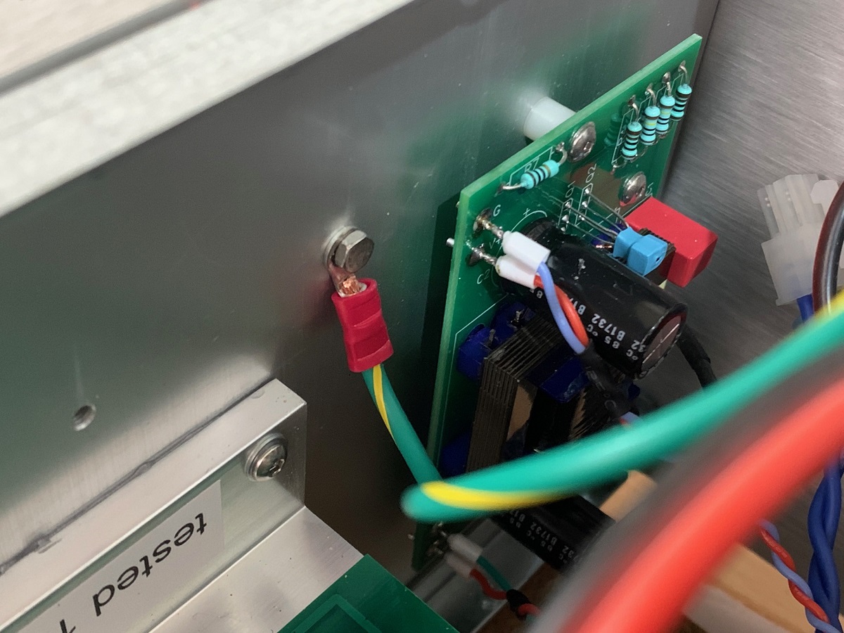

Detail of grounding wires for the indivusal heatsinks to the floor panel:
Detail of Inrush Limiter, I got rid of the extra activation connector by jumpering the input voltage to the activation pin and tyingthe ground to a standoff bolt:

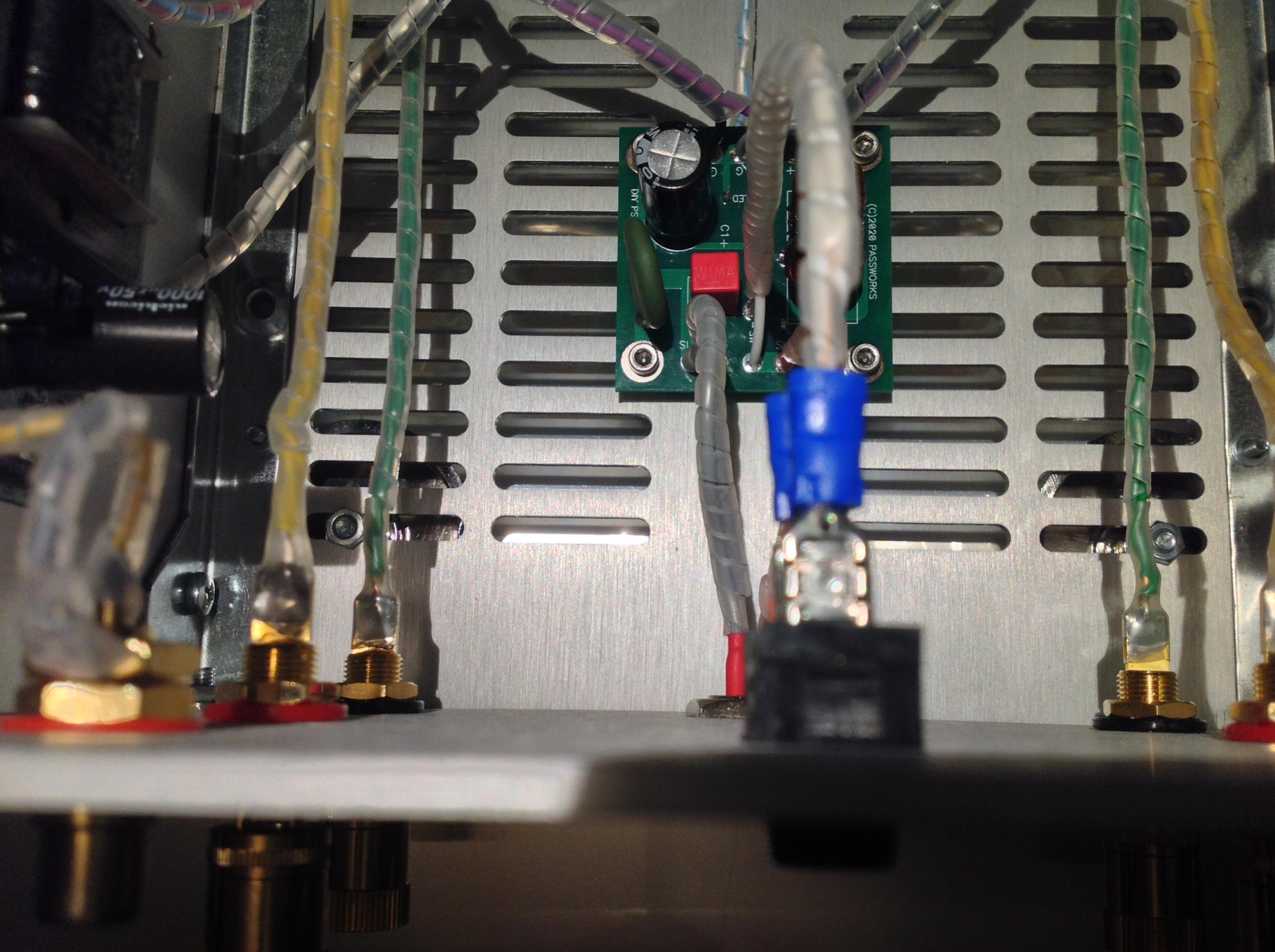

Detail of CLC filter with the heatsink grounding attached to the standoff nuts. I am using brass M3 standoffs with washers rather than the stock M4 bolts and nuts. It was too difficult to install the CLC while it was soldered to the amps, and to keep the screws, standoffs collars, and nuts all aligned without falling off:

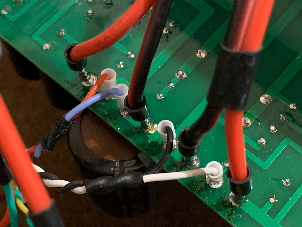

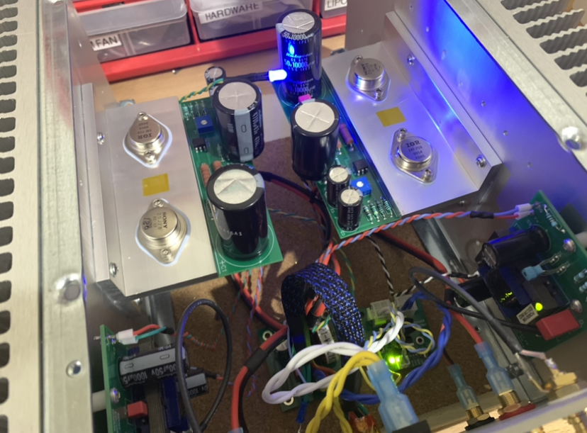

Detail of pin crimped connectors on underside of amp PCBs, showing how strain is reduced on the wires as the wires are silicone insulated soft wire and the crimp pins prevent solder from wicking up:

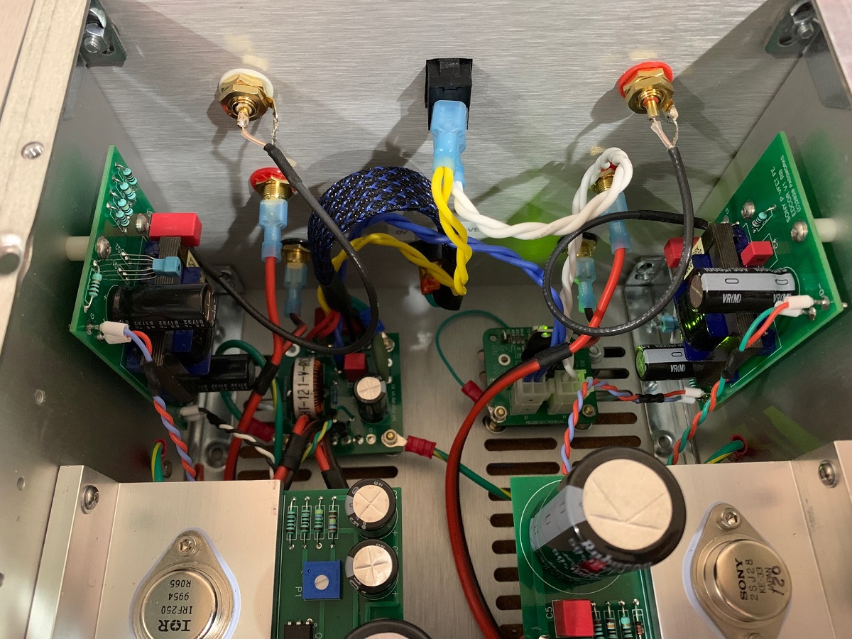

Interior closeup showing wiring assemblies:
Deatail of top view of the amp:

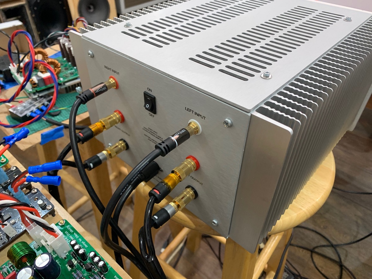

Detail of rear panel with all connections while sitting at main amp postion:

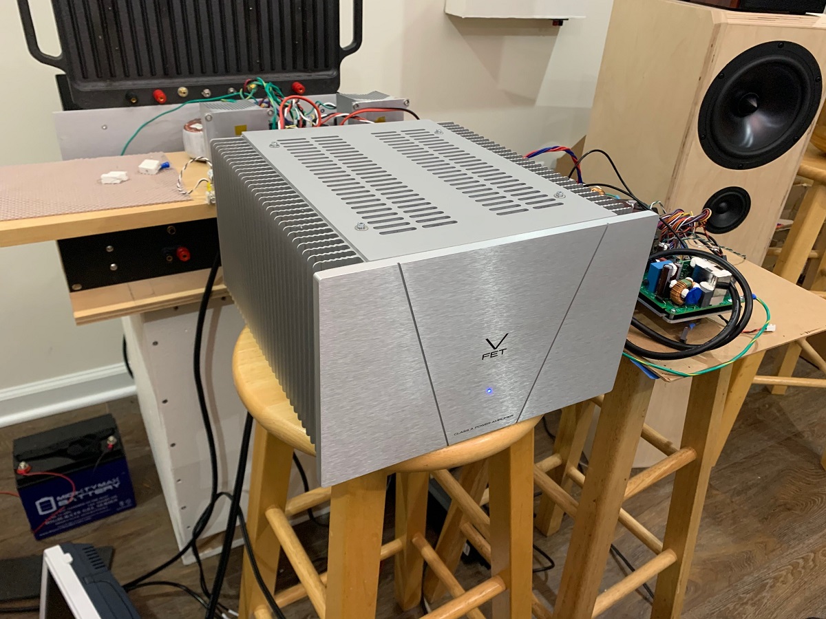

Buttoned up amp sitting in main position ready for listening:
