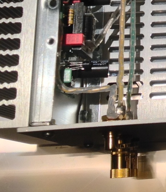

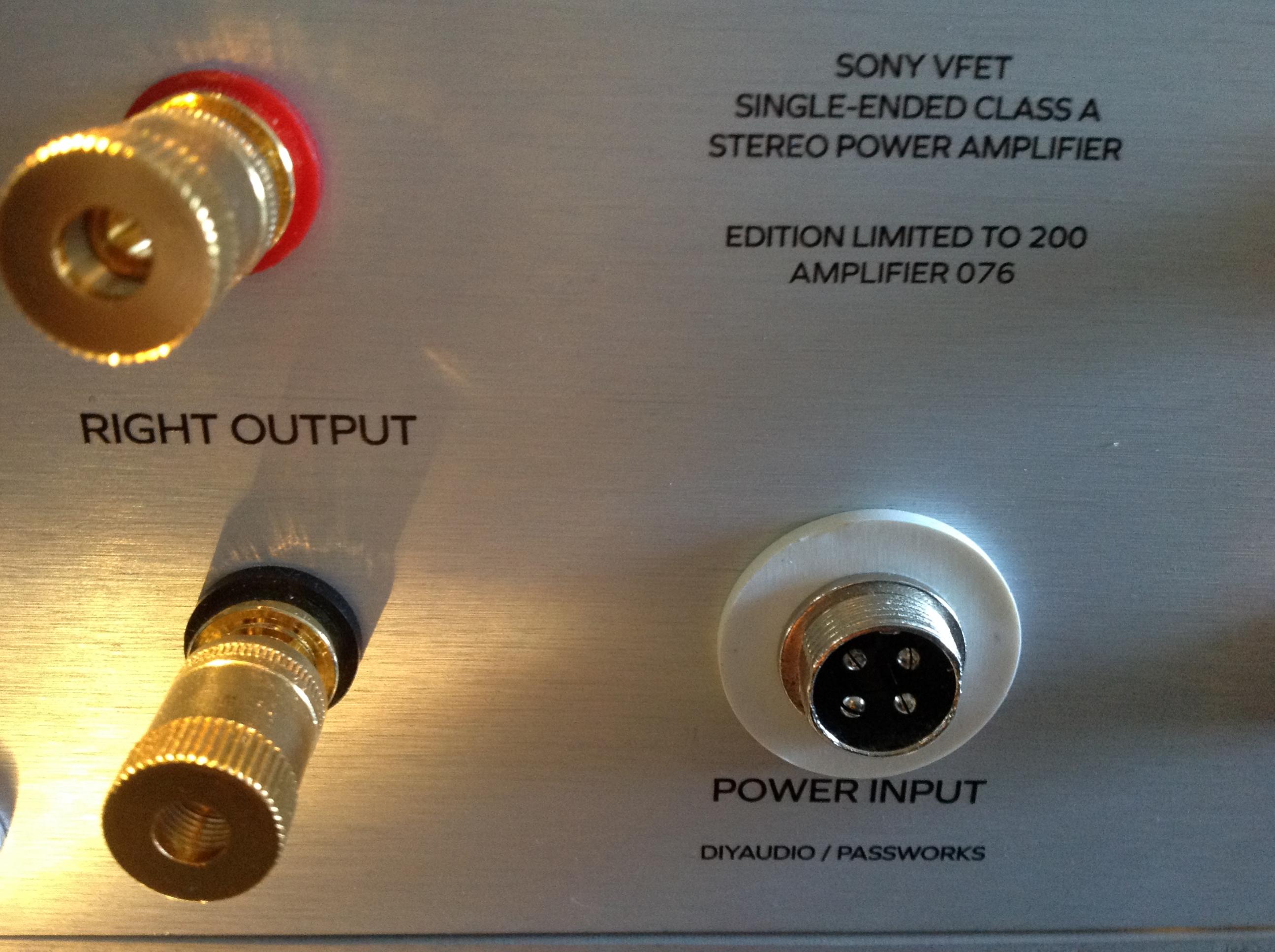

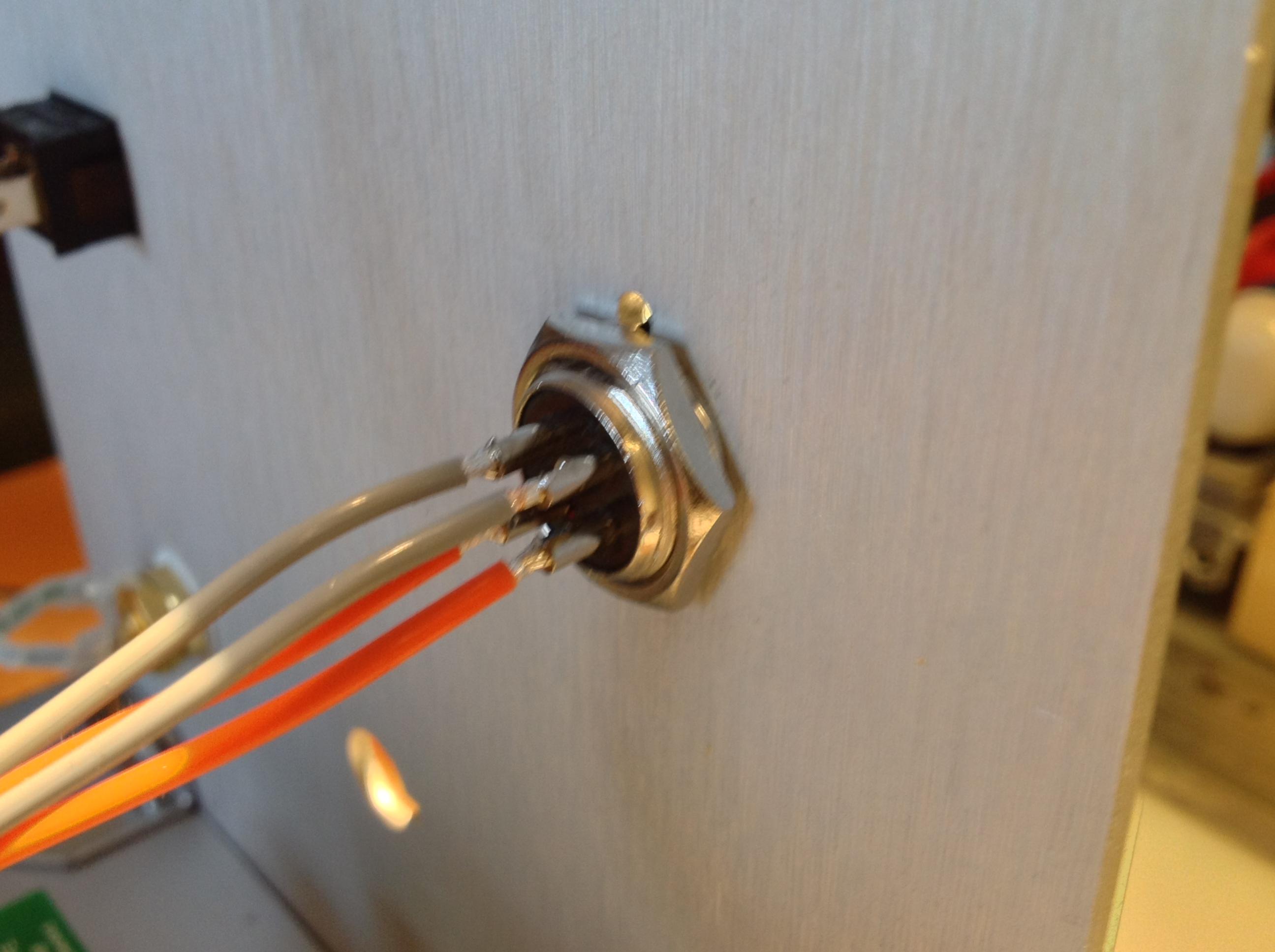

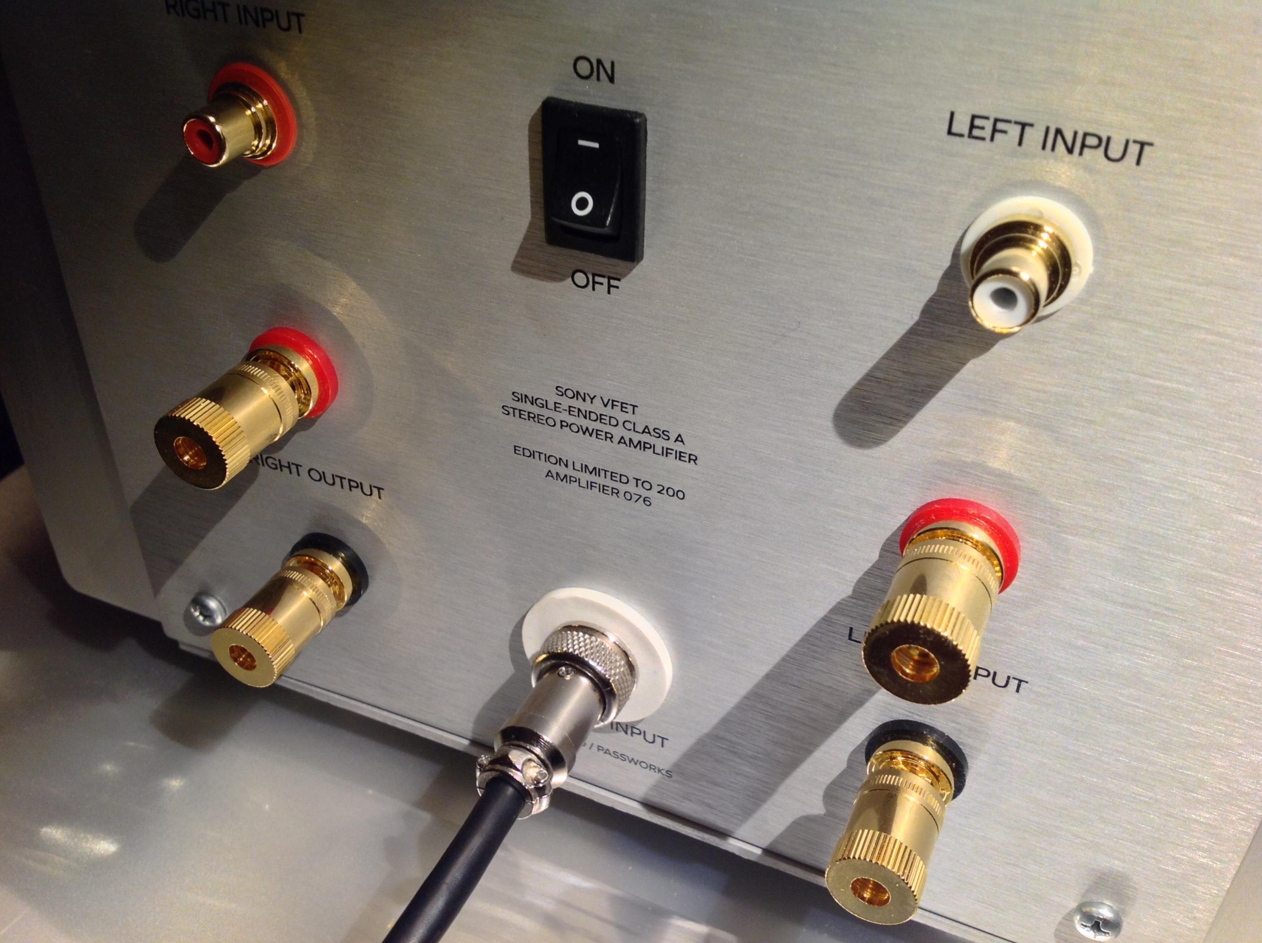

Small modification was made.
First was PSU jack change to another metal stif model.
At the end of all work RCA inputs to FE card wire was cut short and resoldered.
And four Philips screws on back panel changed to torque version.
Et voila..ah with kit resistor yellow led is not bright but easy visible glow

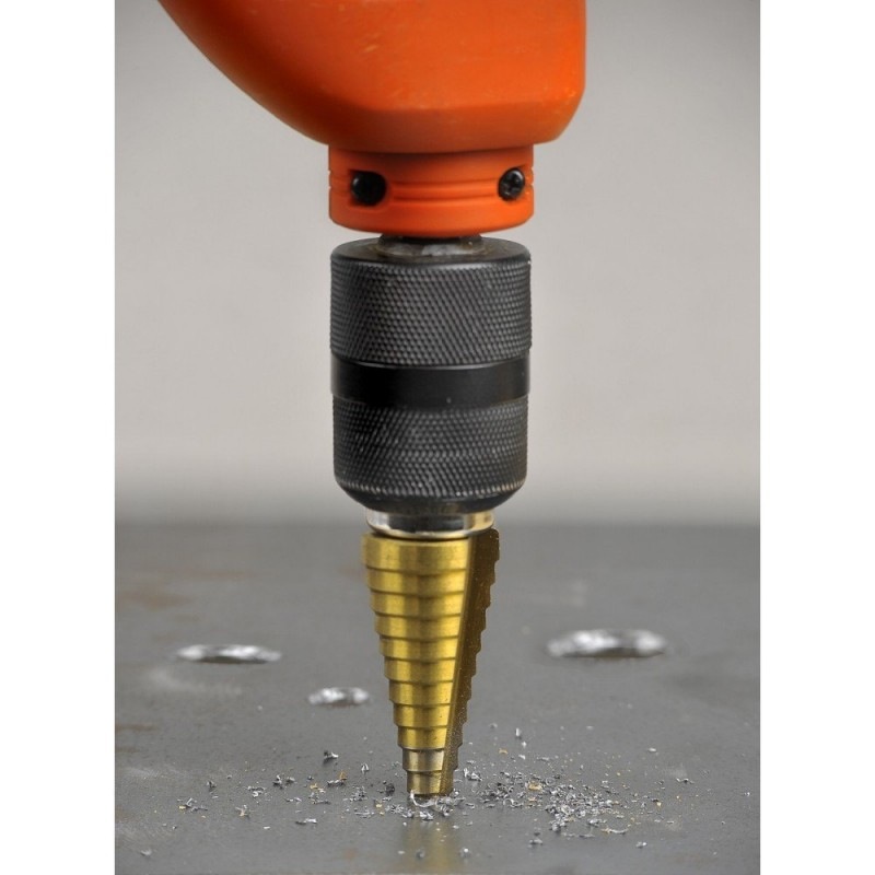

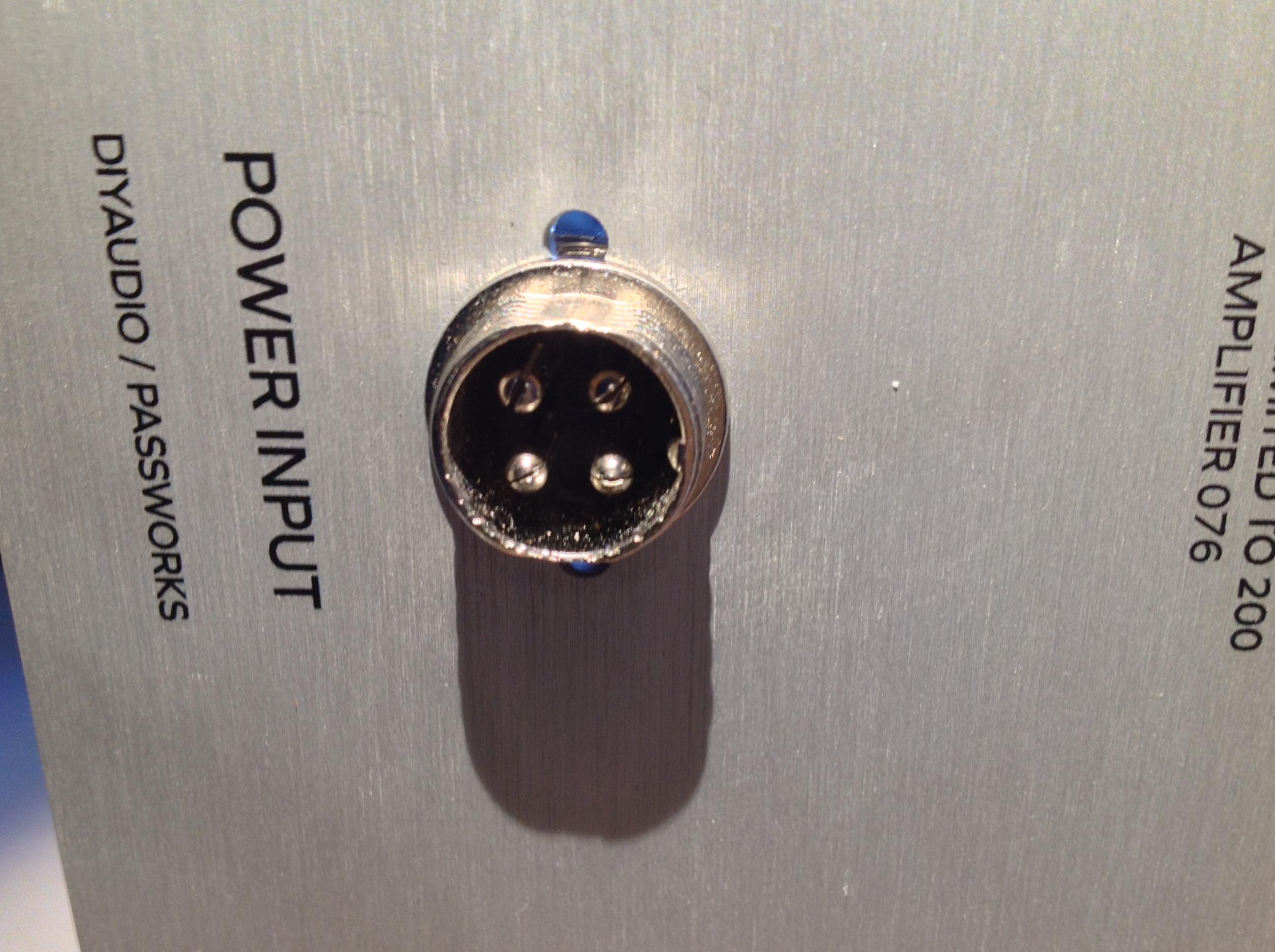

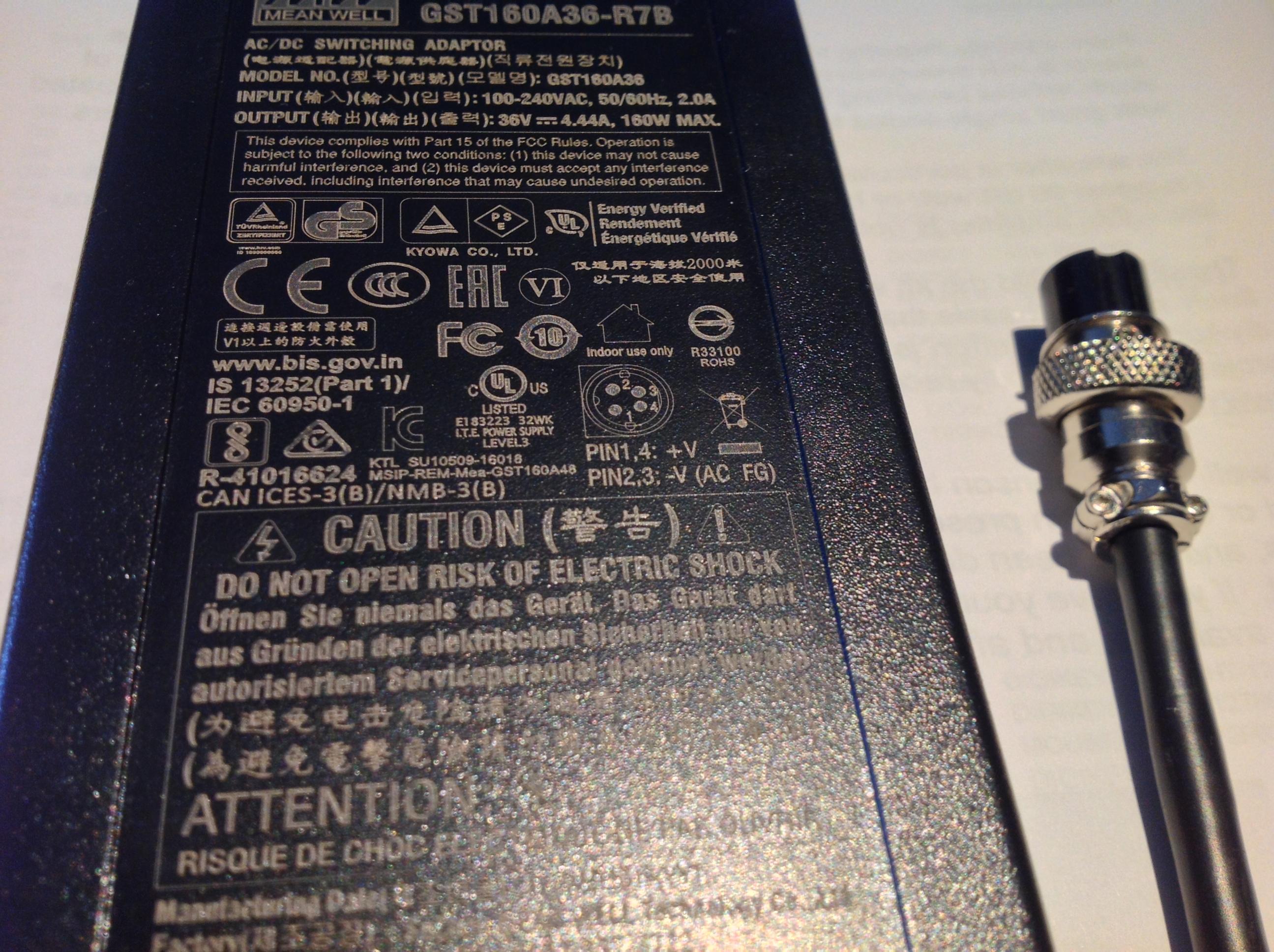

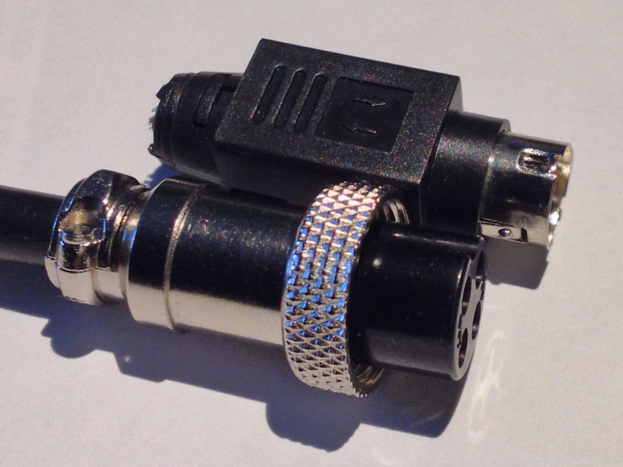

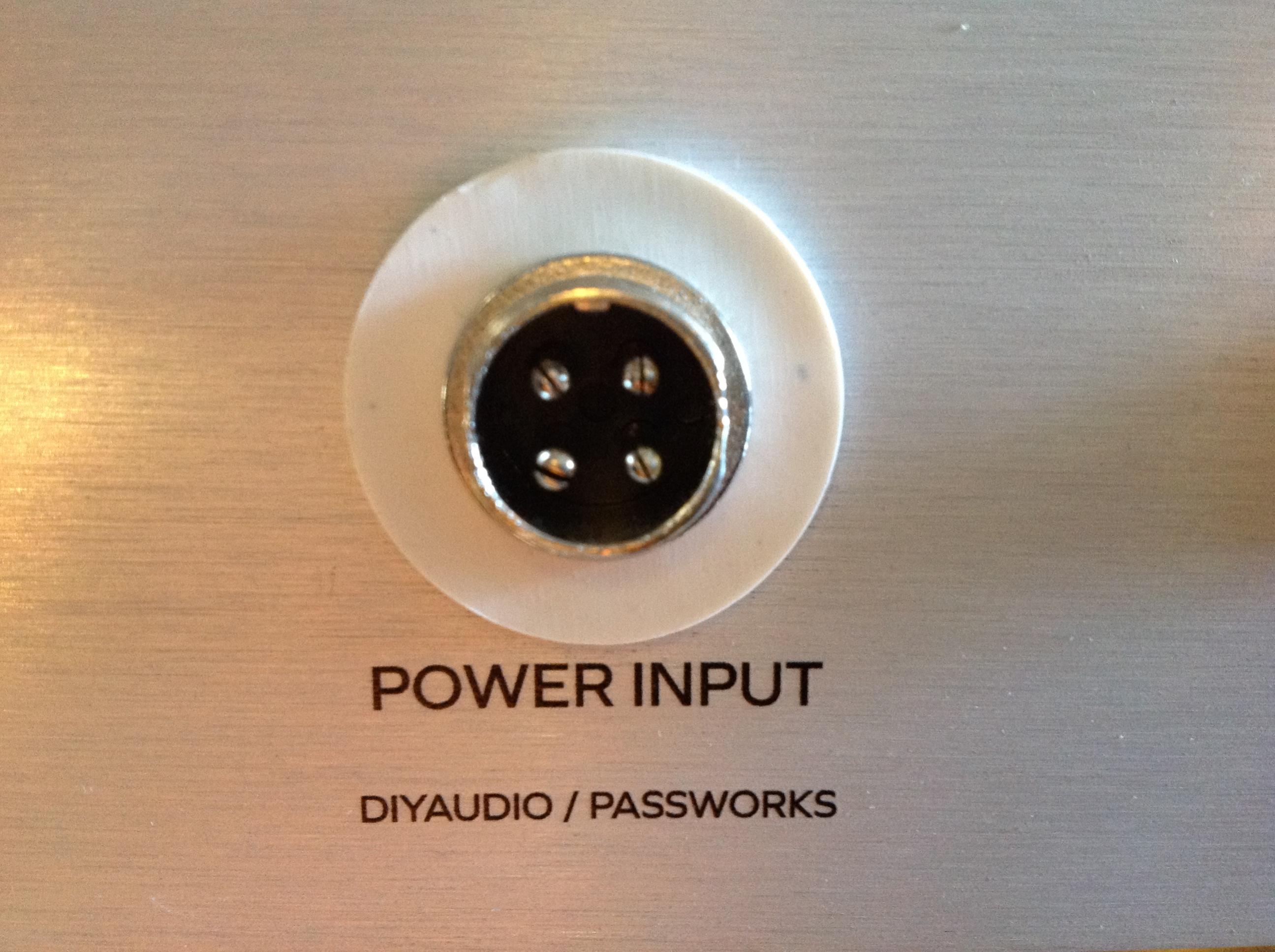

I use GX16 so is need be drilled for adequate diameter.
GX16/GX20/GX12 Aviation Plug Male&Female Wire Panel Metal Connector 2/3/4/5/6Pin | eBay

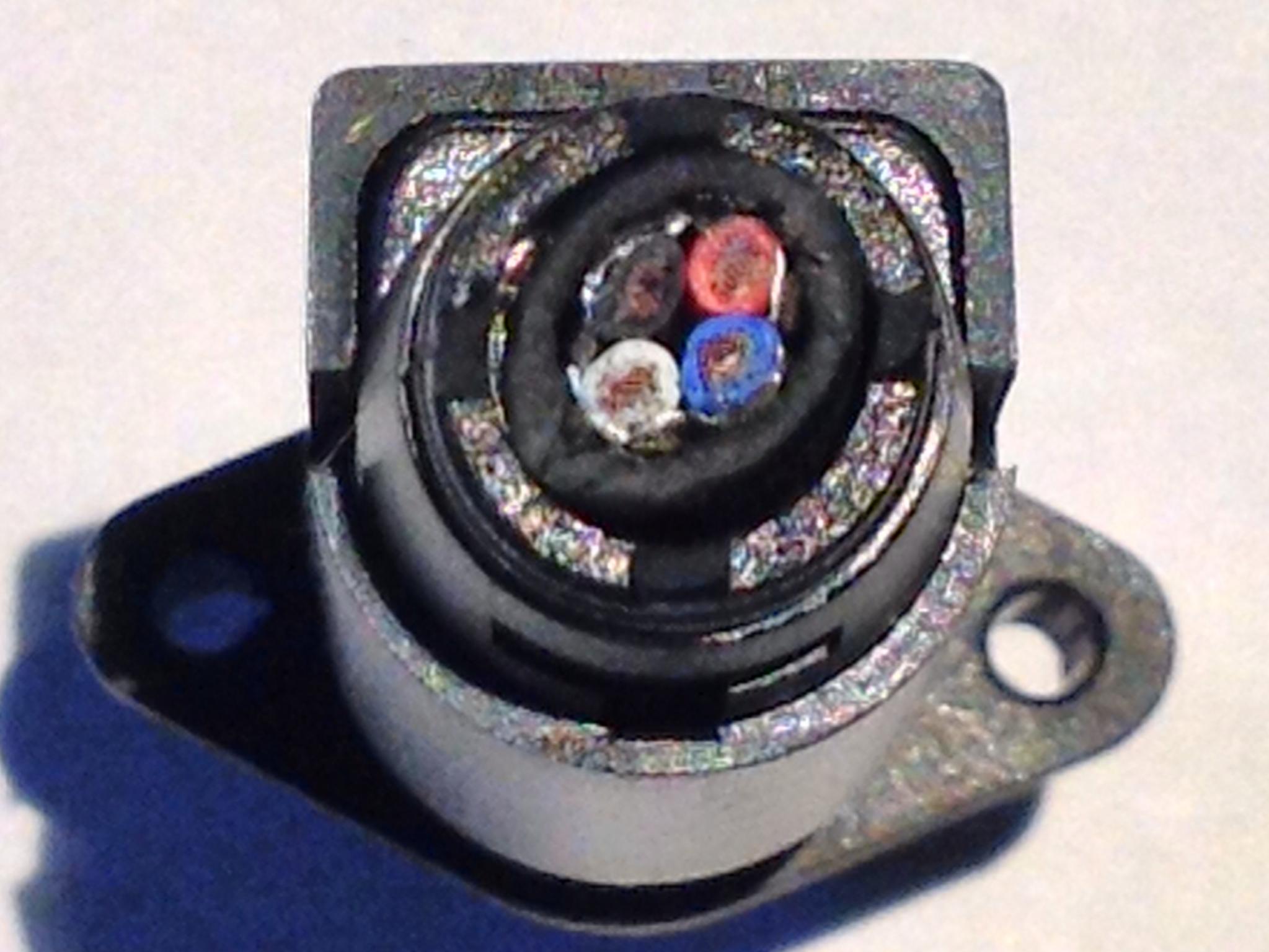

Red and blue wires are V+ pair.
Warning : make this modification at your own responsability
Yes 4 pins are isolated. Work great high quality connection.
Soldering wires is easy , the plastic material inside is hard like stone
and don't melt with high temperature.
Yes no more warranty on the PSU
