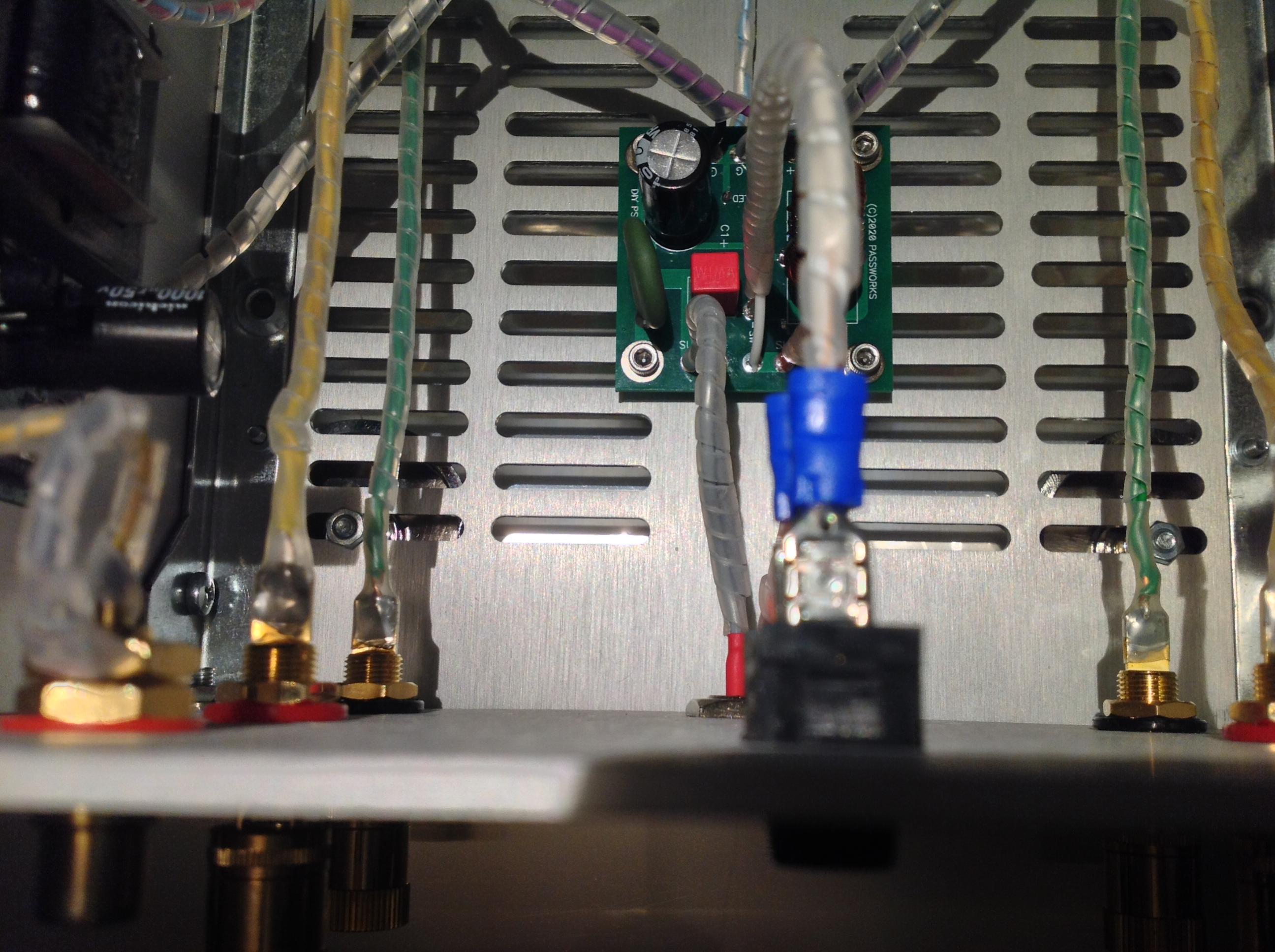

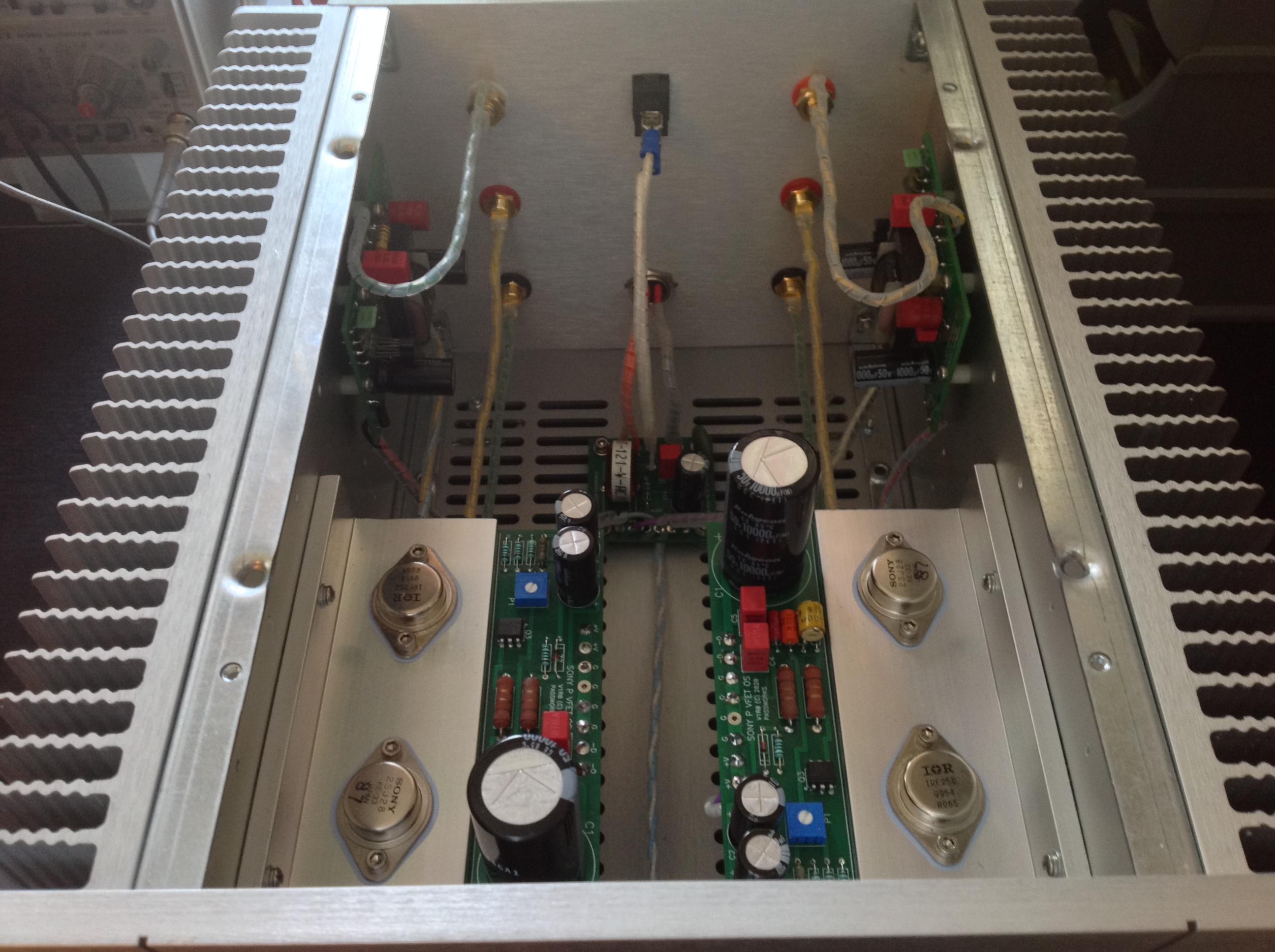

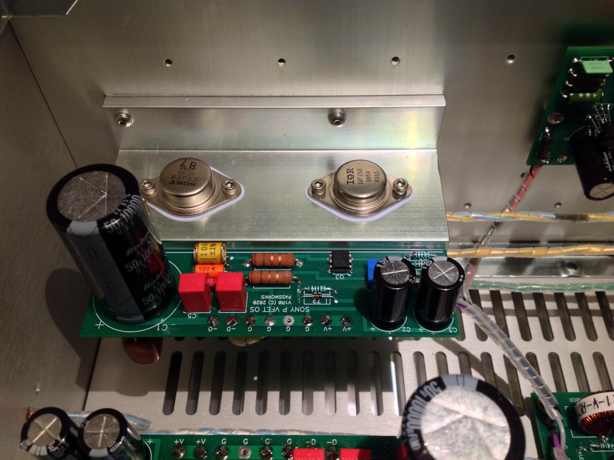

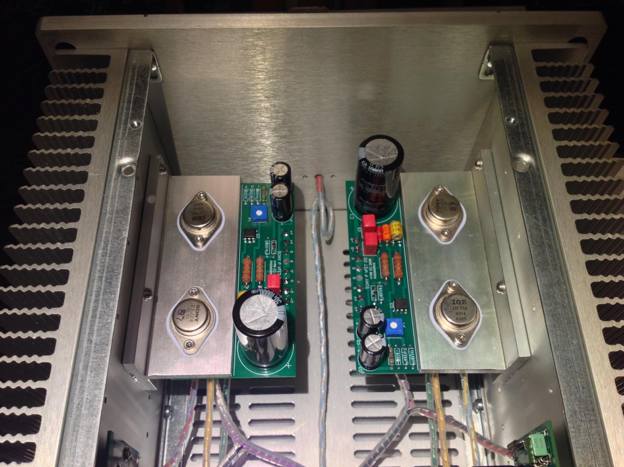

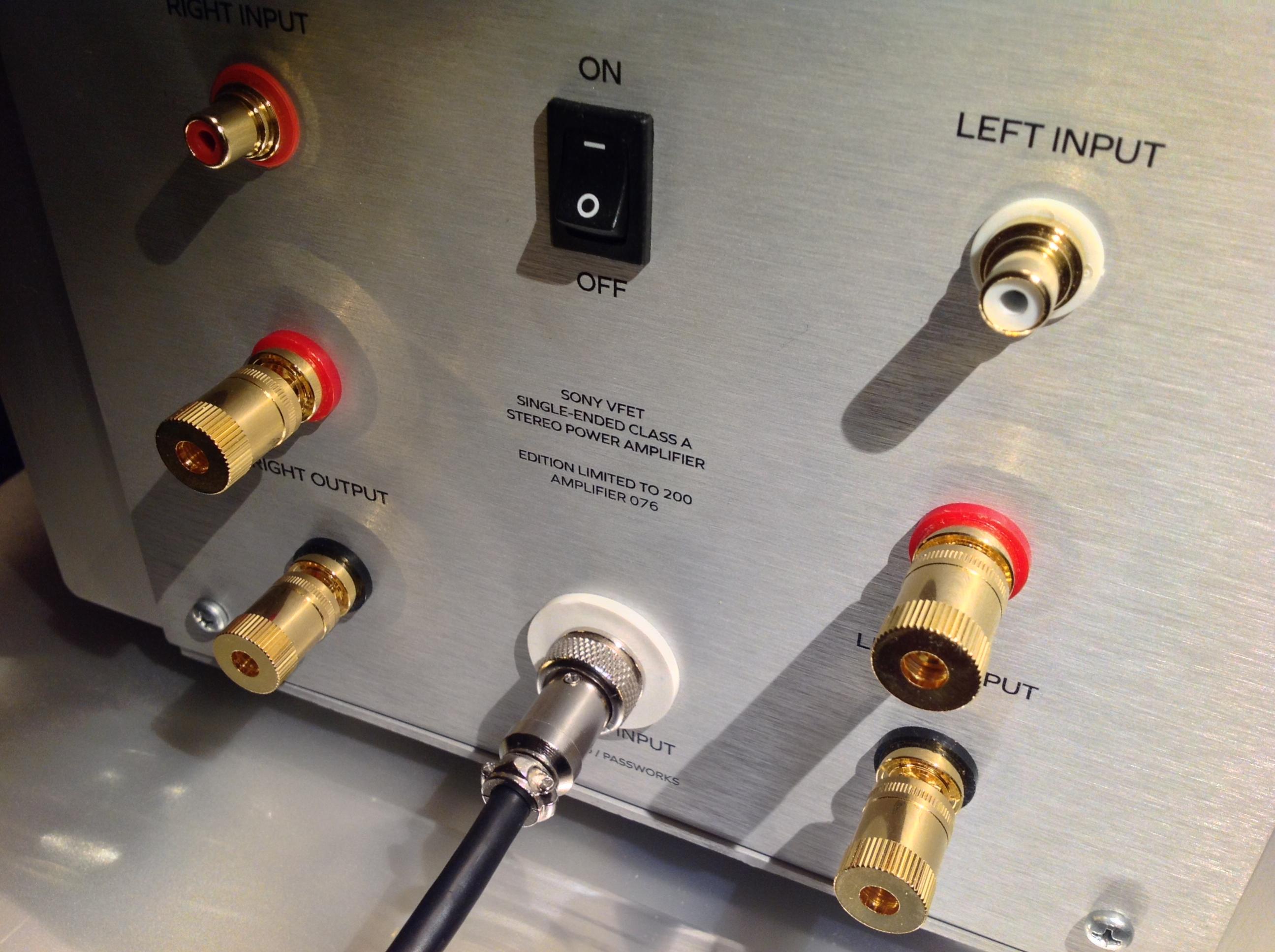

More photos..Today at the evening with friend we organized music session

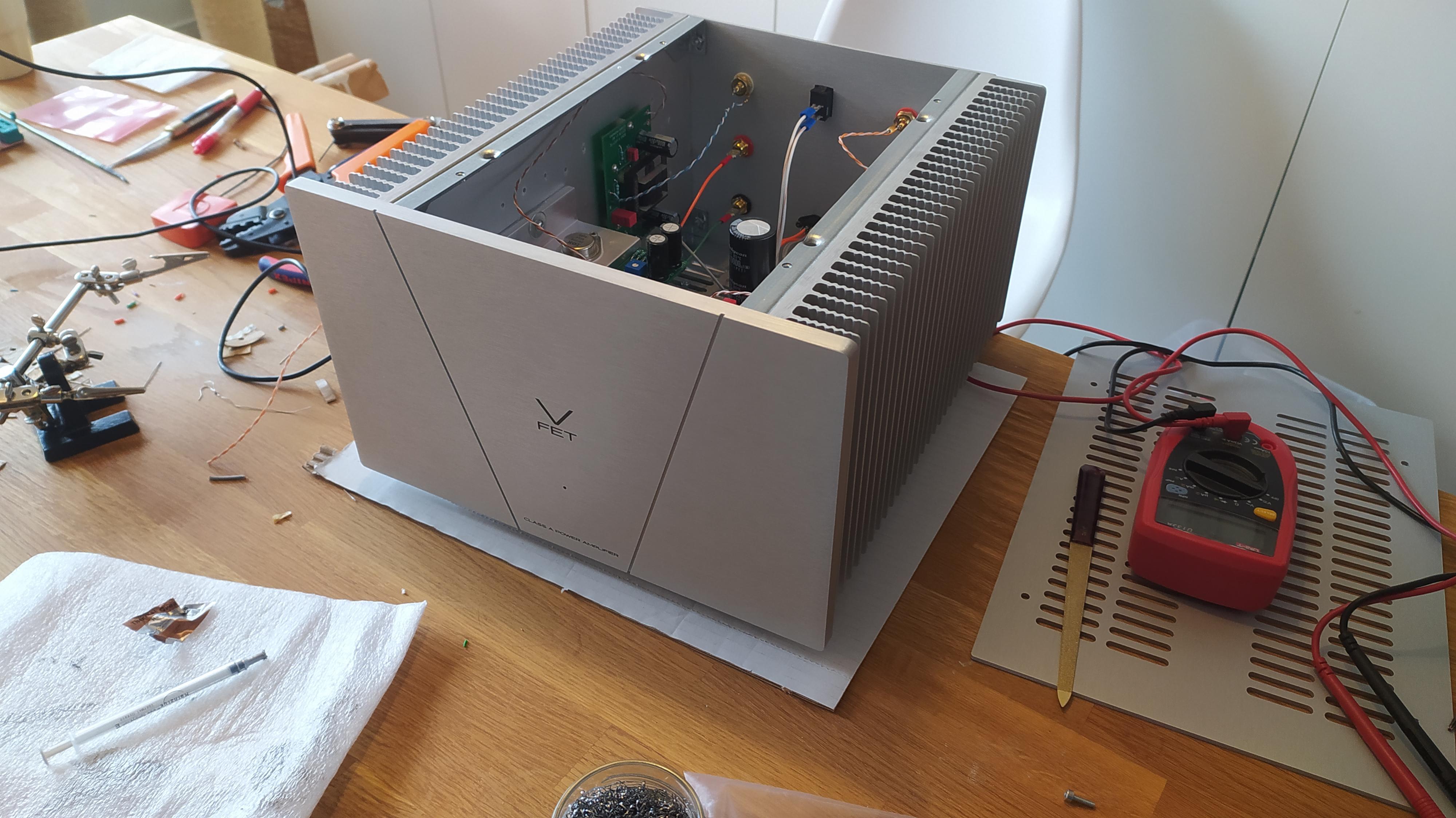

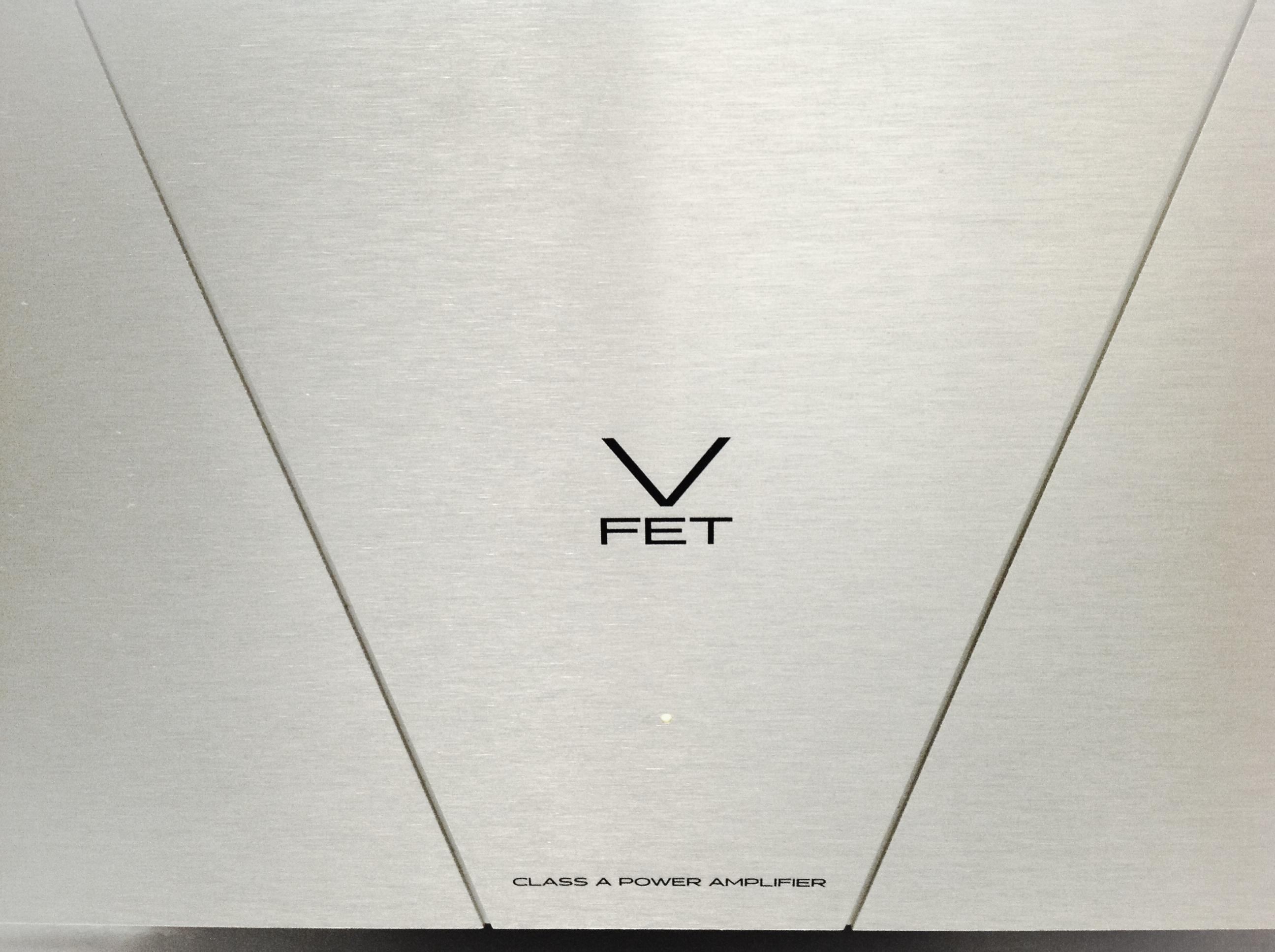

More photos..Today at the evening with friend we organized music session![]()
Very nice, and probably the cleanest build I've seen so far. I am still building, but don't think I will come this clean.. It is surely inspiring 🙂
Tell more about how it sounds, it is so nice to read while I am in the process.

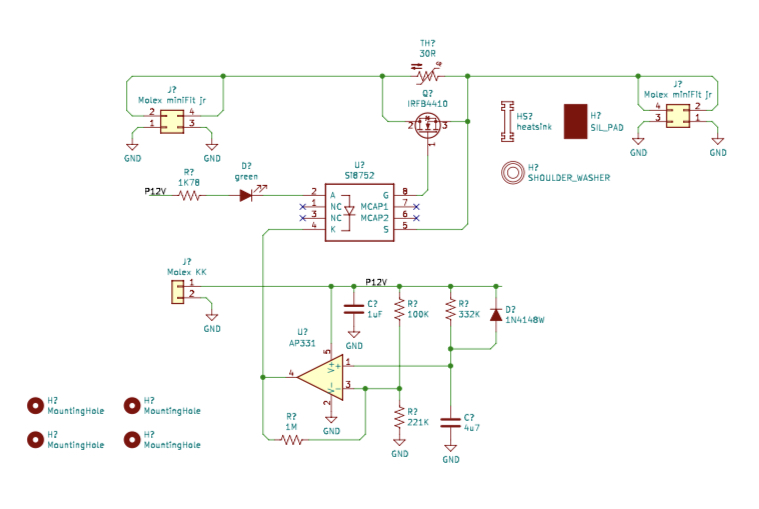

Here is the soft start circuit that Jhofland developed to overcome the SMPS hiccup blues. It’s fairly simple and parts don’t cost much. I am going to modify it to be able to run from 36v. A low current 36v from the Mean Well supply can be switched as the remote enable. This will basically eliminate any arcing across the rocker switch which now controls maybe 10mA vs 3.2A. The current from the SMPS is initially passed through a 30ohm NTC. This slows the current enough to avoid tripping the hiccup behavior. The caps get slowly charged over say 2-5 seconds. After a set time (adjustable via RC constant), the low RDson mosfet conducts and bypasses the NTC, thereby fully switching the amp on. This slow charge will also hopefully, eliminate the speaker turn on thump. I think the size of the caps after the SMPS can be made much larger if desired.
Here is the board:
If it works I’ll post the Gerbers and BOM freely.
Here is the board:
Might want to use the low profile, flush with PCB, heatsinks that are deployed on the ACP+. There isn't a lot of maneuvering room inside a VFET chassis.
{second paragraph removed, this is not an output muting circuit! oops}
I don’t think a heatsink is needed here. RDson is 7mOhm x 3.4A is 24mW on a TO220 is nothing. It could be mounted on the floor next to the filter or on the back wall.
Finally the components was delivered yesterday!
Really horrible lack of information from both DHL and PostNord (Swedish local delivery) delivery was stuck at two places and when I finally got information to go pick it up it wasn't there and I had to come back the next day. But that's all forgotten now. 😀
The build was super nice. I love the thick cables included. Super easy to work with using a really sharp knife. The only complaint is that some of them was too short and I had to rotate and move one of the input boards closer to the back, and the cable for connecting the speaker jack's was just long enough. Yeah, and the chassis are always tricky to put together when everything is in the chassis. Using Philips screws are also a really bad choice but I guess I could buy other screws, but yeah.
I'm trying the amplifier in my main room ,70 m2, using modified JBL L19 (low efficiency) with a B1 for preamp. I might have to use most of the potentiometer but it has no problem with the listening volumes I listen to. And it sounds really nice too (suprised? No 🙂 )
Thanks all who made this happened!
@ Diyers
This amp was built with a friend who is the final owner.
I help with soldering, continuity tests and made all internal wiring and bias adjustment.
Some observations about work organization.
First step:maybe chassis is less perfect, so better try first assembling all
and eventually drill or make aluminium more flat.
With the pcbs and wires inside, they are tricky or very difficult to do.. and avoid scream is too late now..
Next step: internal wiring need to be planify in advance as well
if not quickly you will find this good quality thick orange green wire is too short.
Keep wires at the distance from the audio inputs signal transformers.
Spades connections for on-off switch are less large smaller ones
attention
Screws work ask for patience..
All other build steps are easy , bias test etc.
Was good time " Vfet amp camp " Thanks again :^ ) Cheers
Its sound extraordinary specialy on the music with acoustic instruments, voices are beautiful as well
Tested with RME Fireface high quality audio card, this one have a lots of gain so music was plenty loud at 25% of the volume.
Feeling of acoustic space around the musicians, subtile sound nuances little vibratos are there, narrative music flow
can surprise even experienced audiophiles 😀 Have a nice day
