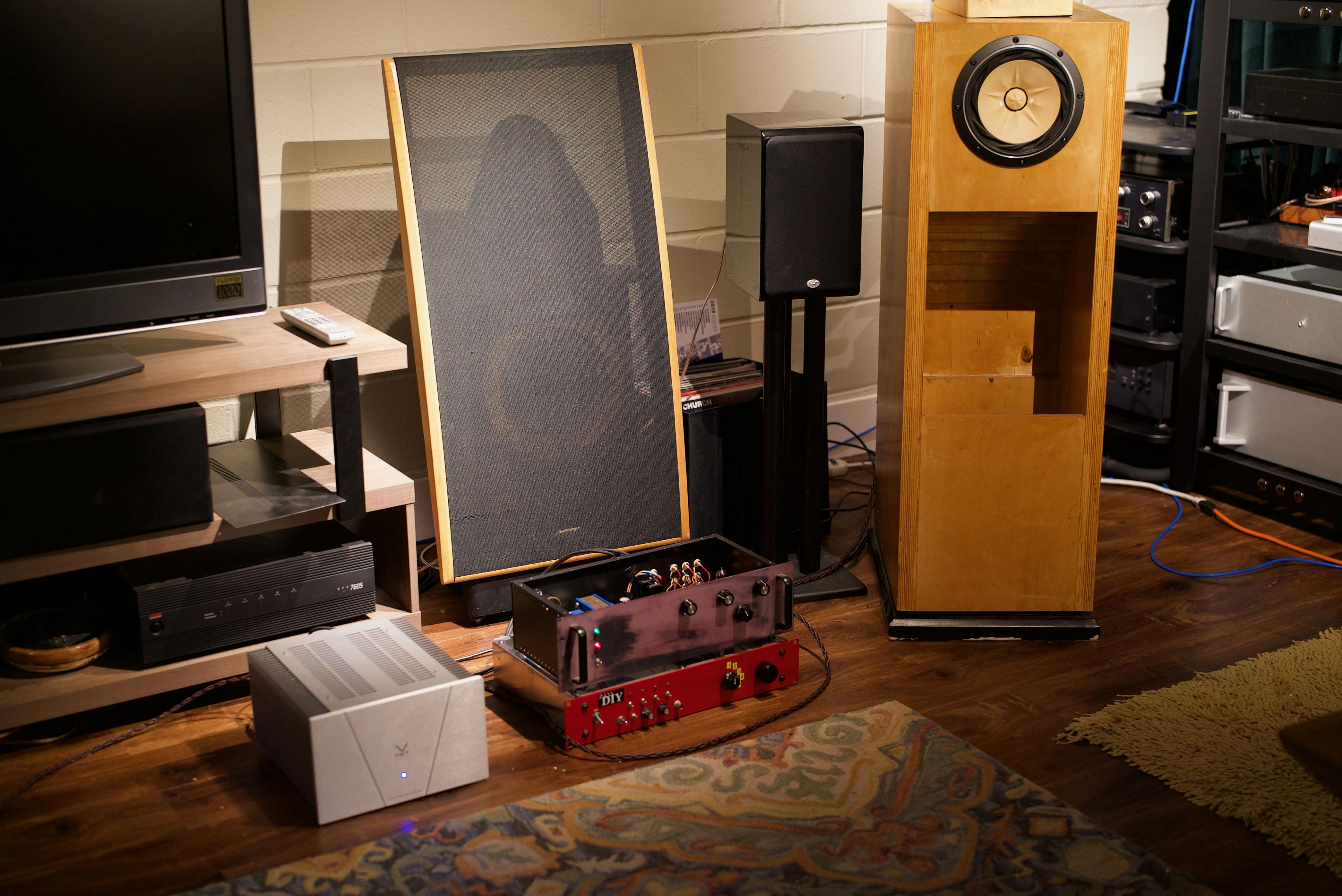

#079 up and running
I just wanted to post an in situ photo of "the 079" working its magic. Currently, switching between the B1 and Aikido preamps and amplifying into FE208 E Sigma backloaded horns.
All I can say is, it's all very good, very, very good. Feeling fortunate is an understatement.
Thanks once again to the team for this opportunity and their hardwork!
Ryan
Ryan

nothing fancy , too big for a silver mica , it is just a 30uf russian 160V Paper in oil that i use usually for cathode bypass in my tube amps. tons of them on ebay and cheap to try..
FE208eSjgma? Is that a tweeter on top… that driver could really benefit from a better box, but i bet it sounds quite stunning in the midrange.
dave
Dave,
Not a tweeter, rather a Bottlehead Quickie pre-amp that I tried for fun. Yes I realize that driver could use some 'support'. And, yes, the midrange is stunning and very textured. I have a RadioShack super tweeter waiting for me to finish Nelson's DIY biamp 6-24 crossover. Soooo many projects in the queue. I have entire folder on my computer with Full-range box designs from your website and others, that some day, I will get to...accepting advice/opinions on the next box build if you don't mind...
Ryan
