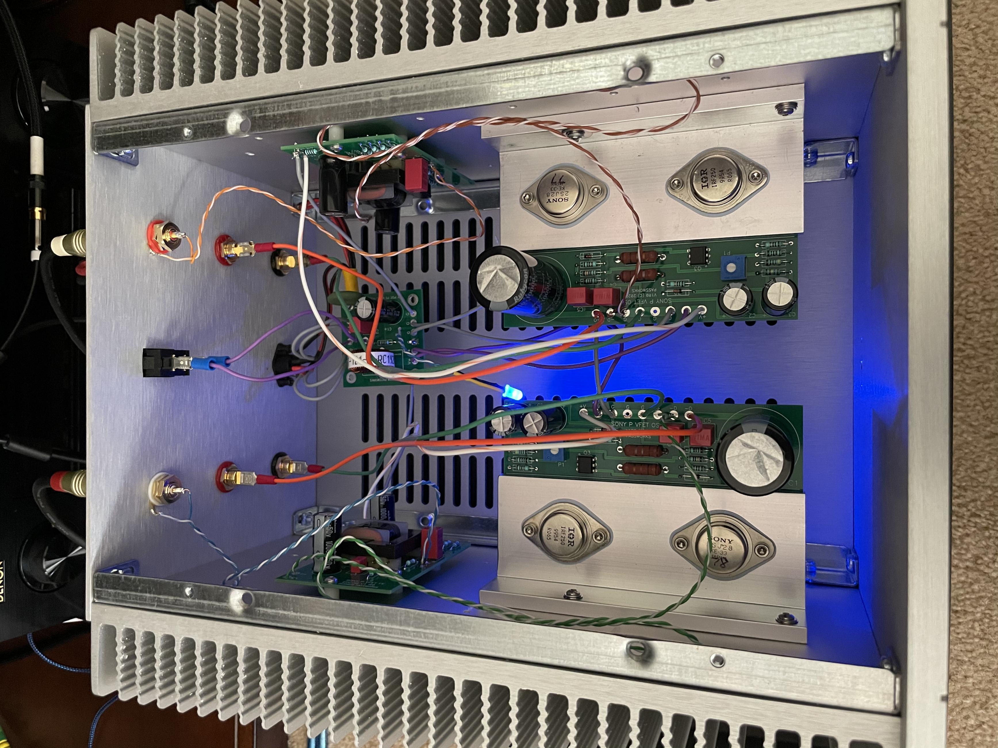

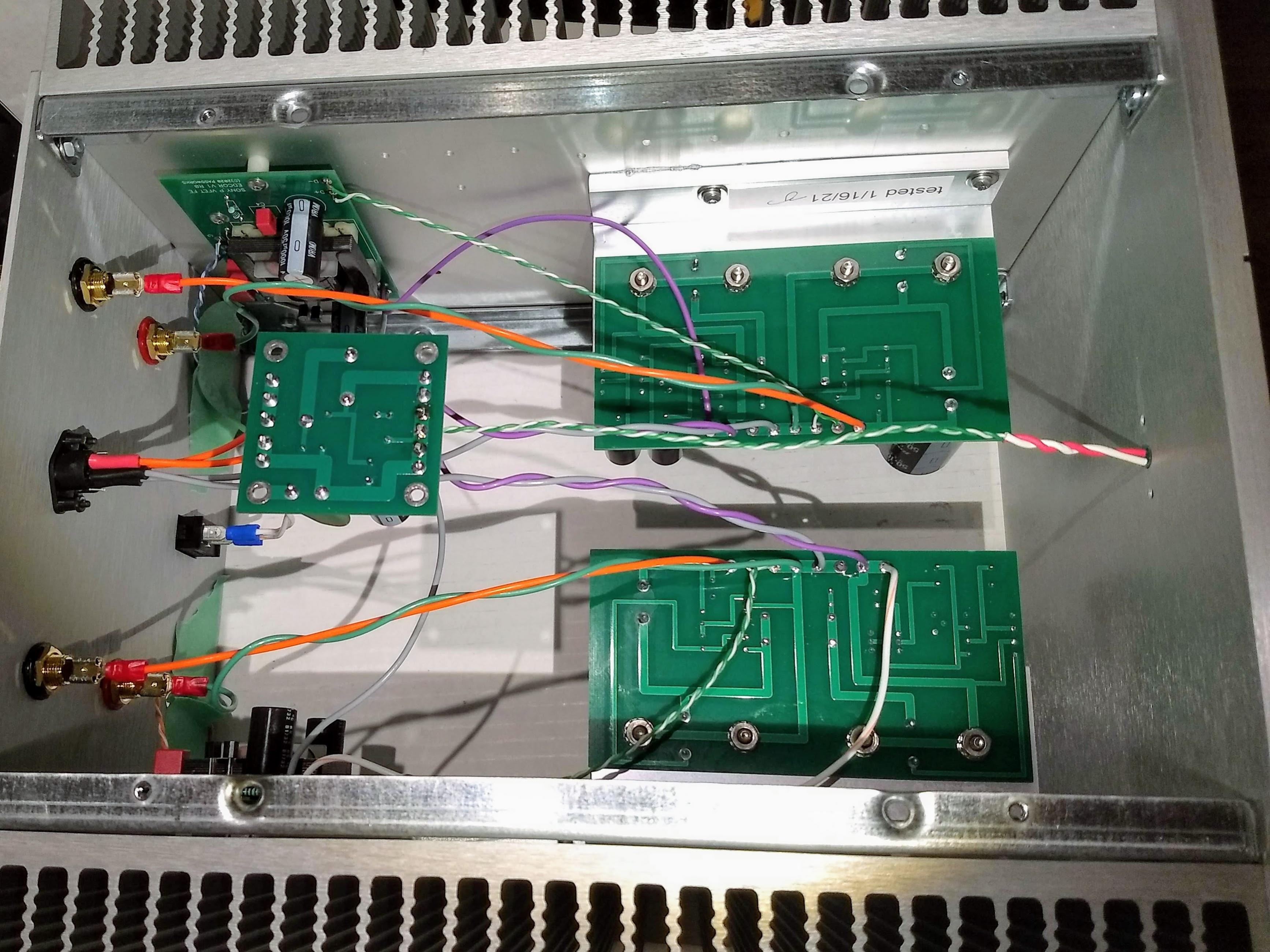

#45 build update - I just finished cleaning up my wiring... not as pretty as some, but much cleaner than before...
- on the main VFET boards, I rewired all the lines to come in from the bottom so they won’t be cooked as much by floating above the board components so much.
- then, I rotated the FE boards so that the signal lines don’t cross the power lines so much
- also, I moved the V+ lines of the FE boards to tie into the PSU filter board instead of routing through the main VFET boards... I trust that this shouldn’t change the original design at all?
It still sounds great, so I don’t think did too much damage de-soldering/re-soldering all the lines, lol. Here are the before and after photos.

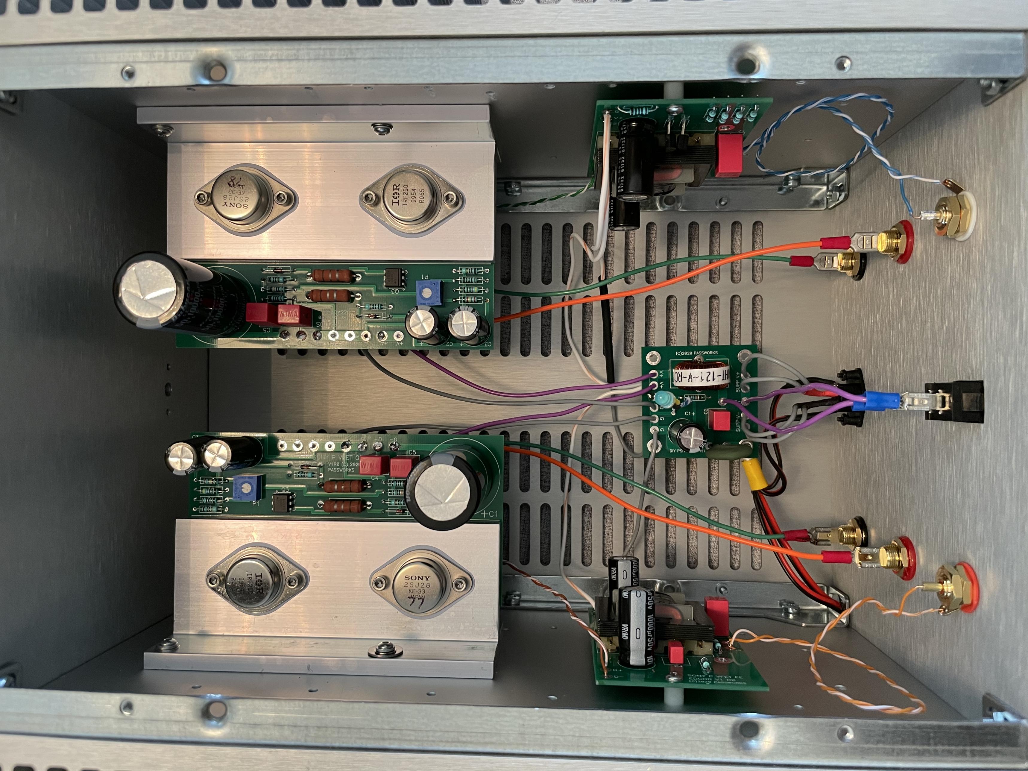

Progress to date...
The quality of this kit is magnificent and so is the quality of Jim’s assembly guide. My build is stock and uses all and only the provided components, except for some very minor additions: (a) heat shrink for LED, (b) lock washers for mounting T-Bars to heatsinks, (c) washers for mounting back panel and for shimming between bracket and back panel (see Post #845), and (d) locktite / thread locker for chassis screws. That’s it.
On the heat sink, I chose to locate the output stage as per Jim’s guide, that is close to the edge of the front panel. I chose to flip the front-end PCB 180 degrees so the input pads are closest to the RCA connectors on the rear panel.
Noting that for this very specific design connecting the chassis to earth is unnecessary, I elected to leave chassis referenced to ground only as per Jim’s guide.
Remaining: connect the input RCAs, adjust the supply voltage, close the chassis and listen.

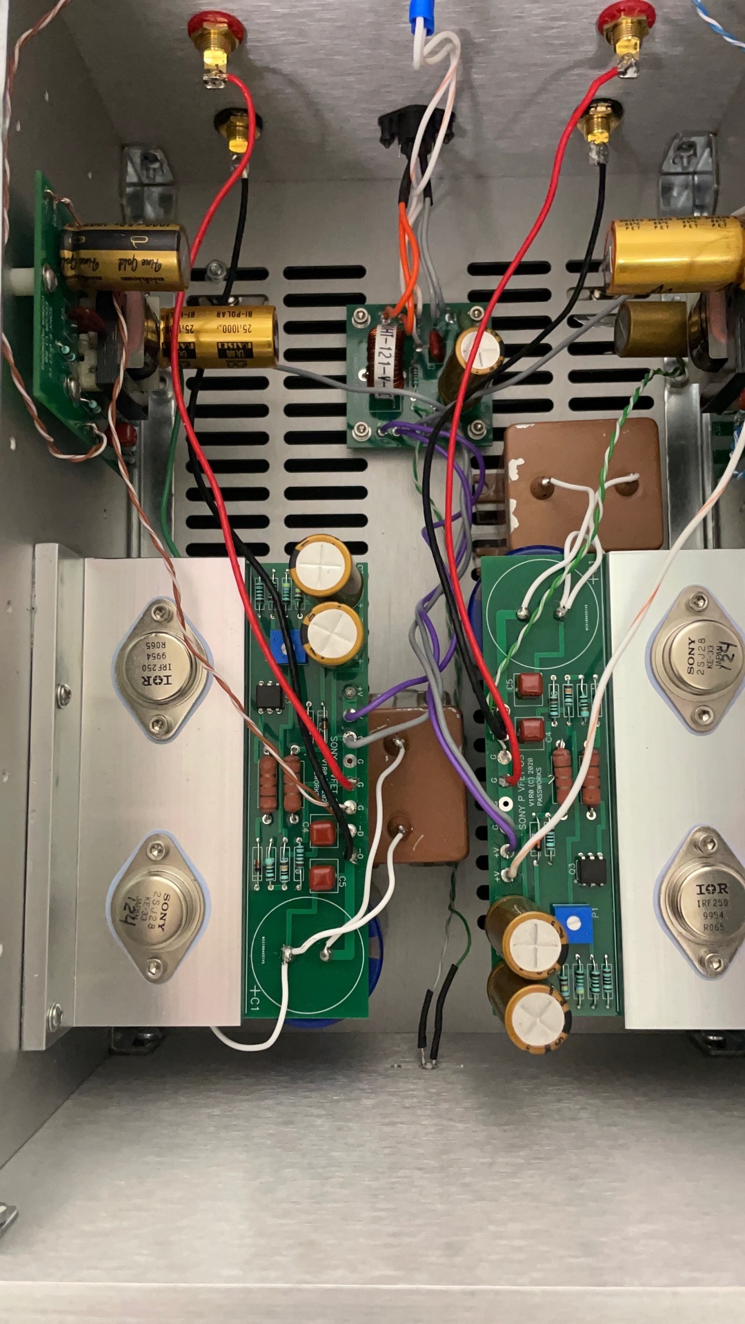

What kind of caps are those red box?
