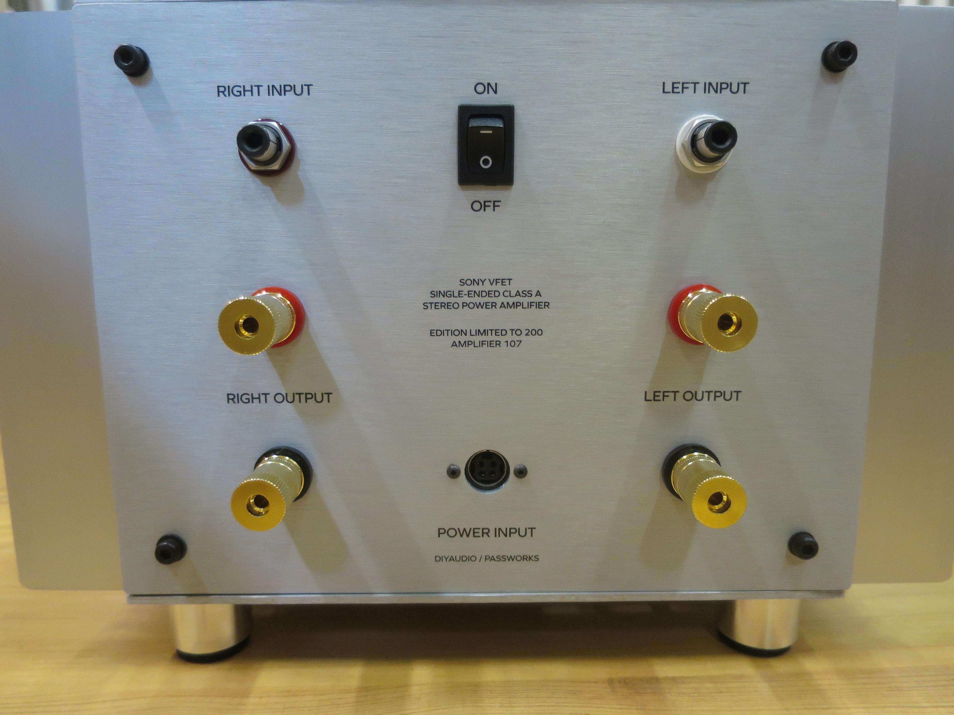

Like soundhappy I gave my unit to my friend andreasw, who had no luck with the lottery.
He will comment here the next days his progress, I am allowed to announce that unit 107 is mounted and will cry these days.....
