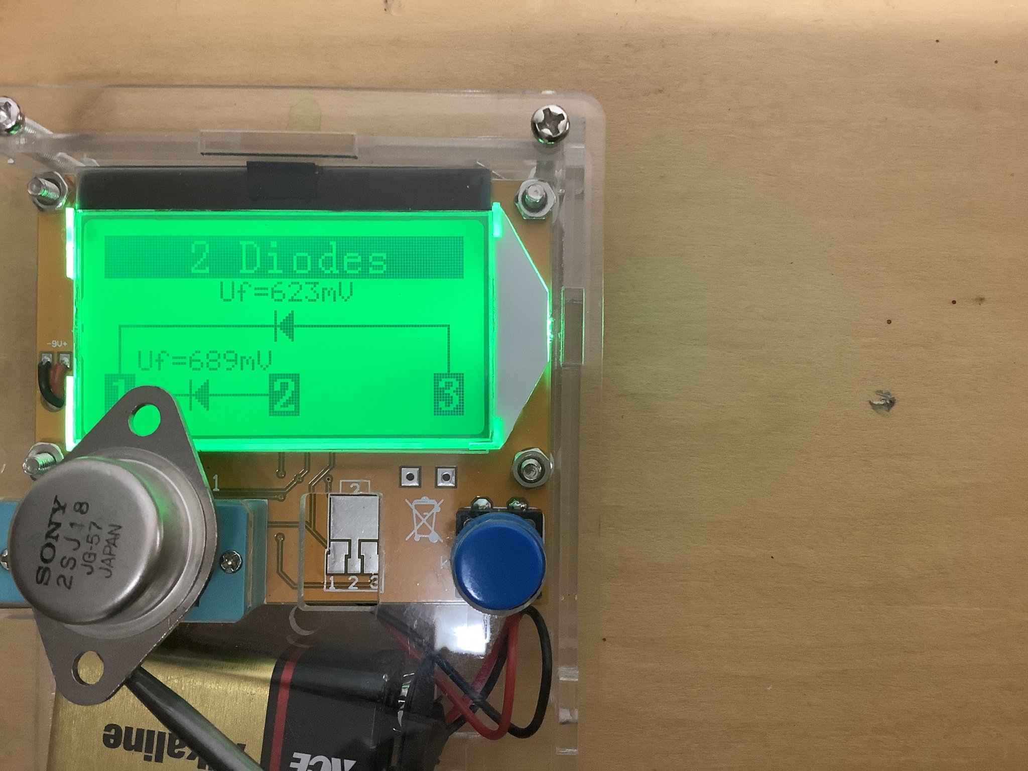

if everything is OK, they'll be functional in amp
or you can test them in test jig for JFets ......... all you need is laptop supply and 15-20R resistor of 50W or so
for P Channel JDet Drain goes to GND, Gate to +19V, Source to one end of resistor, other end of resistor to +19V; measure D-S voltage when power applied

Using Ben Mah’ posting of the Sony Service Bulletin, I measure 1.4 volts and 1.7 volts across the source pin and the case, (D), of each respective VFET, and on each VFET, S to G and D to G register as diodes.
So I am going to go with that test and declare these two VFET’s good to go.
This also id’s the Source pin for me.
Thanks to you both for the assistance.

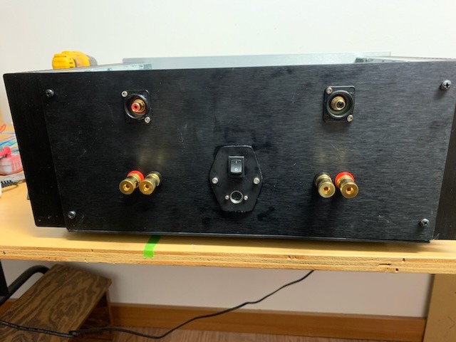

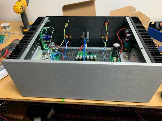

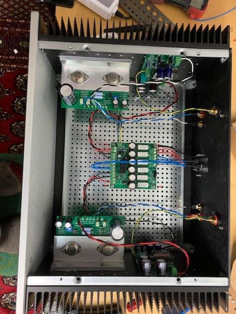

OK….I Finished assembling my Sony VFET amp this afternoon. It’s been a long time in production, but I got it all wired and the chassis assembled. Now for the testing and setting the bias. Taking a beer break here for a bit. Might wait till tomorrow to actually warm it up etc.
So what I have is a stock, as designed by NP, Sony VFET 2SJ18 Output board, a Scourge front end, a Ship of Theusus PS filter, installed in the DIY Alum 4U universal chassis. I missed on the purchase of the Lottery chassis, so I used the 4U. Looks good to me. I will put a on off button on the front in the future.
I want to express my gratitude for all of the support and help from this community and from NPass for making this amp possible. Without your assistance, advice and designs I could never have gotten this far. Thanks.

Great work KMF! ![cheers :cheers: :cheers:](https://files.diyaudio.com/forums/images/smilies/cheers.gif)
May your sound test go smoothly and well into the evening. Let us know what you think of the sound.
If another chance to buy the VFET chassis comes up (if there are enough buyers to justify another run), you can always repurpose this 4U/300 for a future project.

I ran it a couple of hours yesterday, while setting up the bias. Sounds OK, but to be fair. I need to give it a few days to get used to it. at this point I think my two ACA’s running XLR mono-block sounds better, expecially after I put PO89ZB filter in the mix. But I need to give it some time. To me the Sony VFET sounded a bit softer, lots of detail, but the ACA’s had better attack and dynamics. But memory is unreliable and I will AB the two amps in a couple of days when I get around to installing the PO89ZB filters in the ACA chassis’s and set them up so I can easily switch between the two. I also have the Missouri front end card to swap into the VFET, and it is an XLR card. Supposed to be nasty weather wise here in the next few days so I will have some inside time to fiddle with amps.

LOL! Got a HP 6266b variable linear power supply (40v@5A) for half a C note. The amps both operate together at about 2.8 amps or so. Thing looks bullet proof in spite of age. I'll hook that up to the amp in lieu of the wall wart and see how it goes. It is about the same vintage as the Sony TA 4650, so it will complete the vintage circle.
