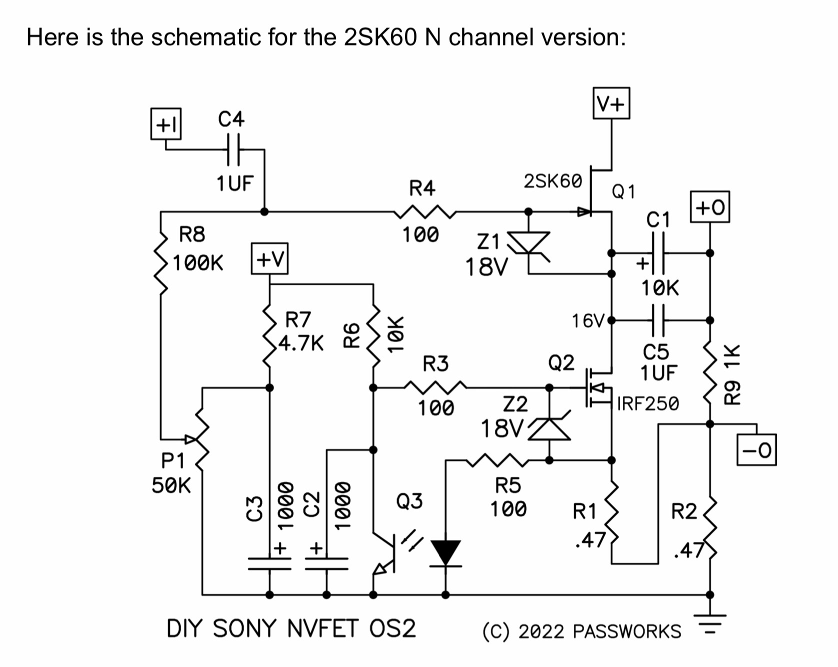

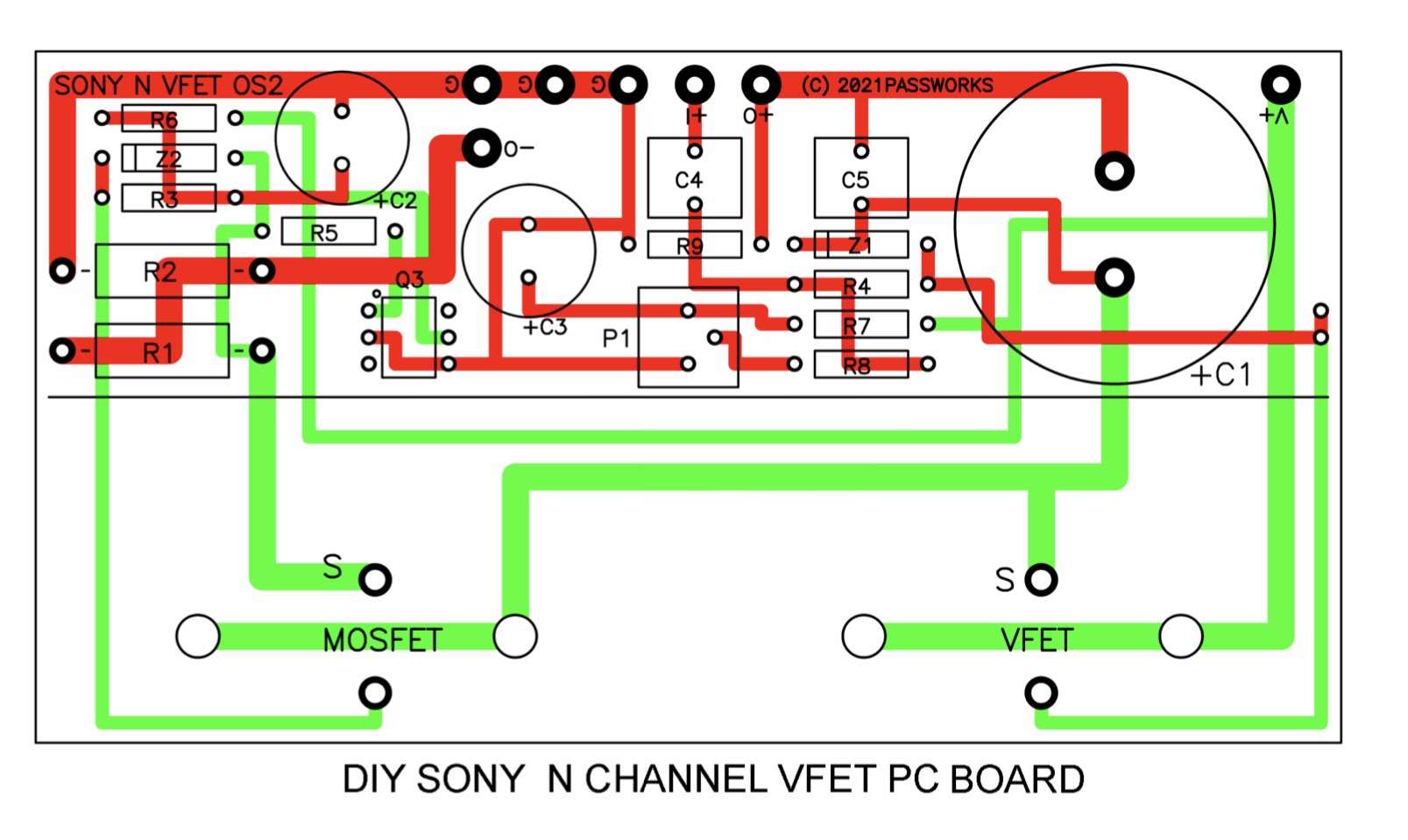

Okay, I'm confused:
From Pops, for N Channel OS2
"You can use the diagrams from the original articles for the wiring connections, noting that on the earlier boards the signal inputs are labeled D+ or D- and on these boards they are called out as I+ and I-, otherwise no difference."
No there is V+,+0, +I, -0, G,G,G.
Can someone tell me what the deal is with designations I can follow please. I must be brain dead, but I'm not getting it.
V+ & G = power supply input to OS2
0+ = Speaker positive
0- = Speaker negative
I+ = positive output of the front end to the positive input of the OS2
G = negative output of the front end to the negative input of the OS2
The P channel and N channel lottery amp output boards use D+ and D- for inputs, the OS2 boards use I+ and I- (G).
edit: I'm always late to the party these days.
