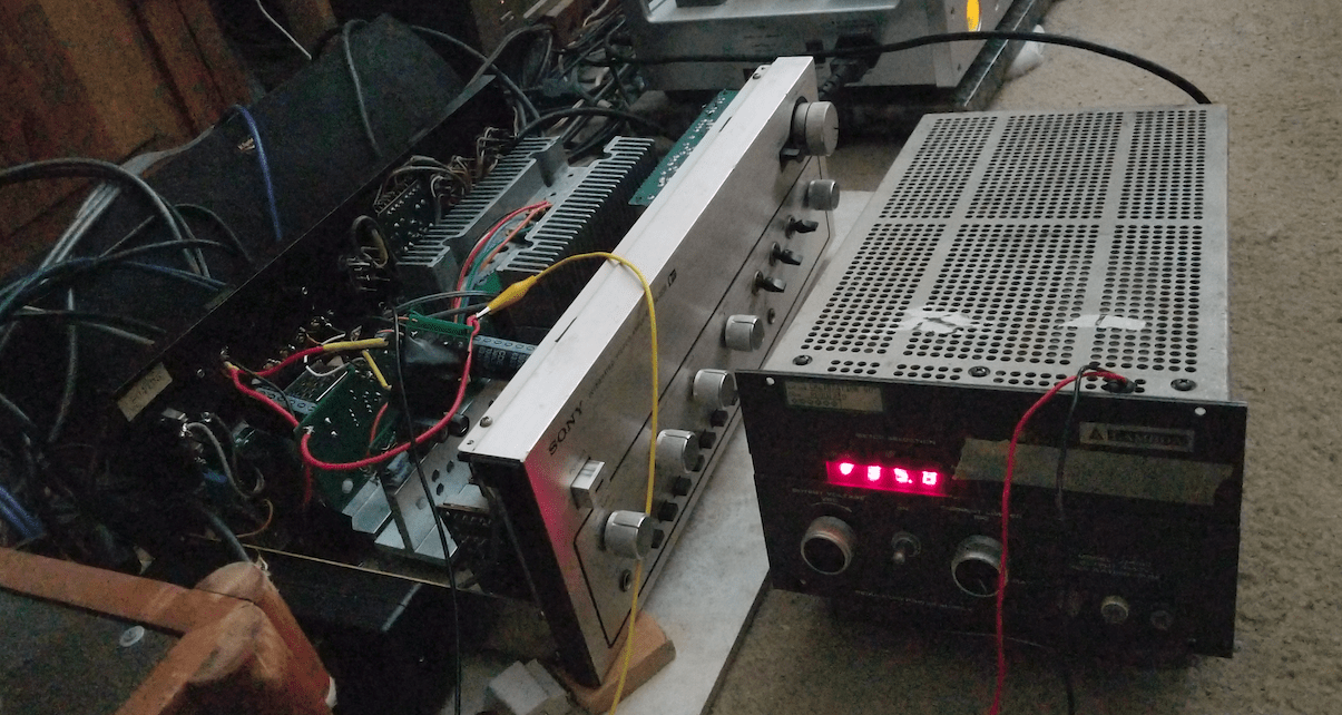

I wound up attaching a 24 pound regulated linear power supply to my little project. Linear power supply wound up being an ancient Lambda LQ 532. I suppose a 3 amp version might have worked just as well.
Amp is already quite wonderful with wall wart. I was a bit skeptical that the linear power supply would improve things, but it did. Some grain lost in upper midrange, better layering, more reveal in the nuances bigger soundstage(it was already quite large and well defined). Surprising things emerge from well trodden musics, even compressed digital. The SK60 is a remarkably liquid and analog performer. I think I might commit heresy and say with the linear power supply, I prefer it to the original SIT 1 and 2 amps I heard, but that's going on memory.
Whouda thought. Sony VFET harvested from blown chassis, put back into an old VFET chassis, with an old linear power supply, and it is my favorite amp now for the midrange ribbon (300Hz to 7Khz). Crazy, since I have a couple of other Pass designs to compete with it.
Since this is my first amplifier build with many strange screw ups along the way, it is an odd journey of beginner's luck. I only burned my fingers about ten times and thought I blew it up about ten times.

LOL! Looks like junk from an old sci fi movie. Sounds sublime. I'll have to get it organized, solder attachments, and get the top back on the TA4650 chassis. I hope it lasts, been going strong for a couple of months now, seems stable to heat and performance.

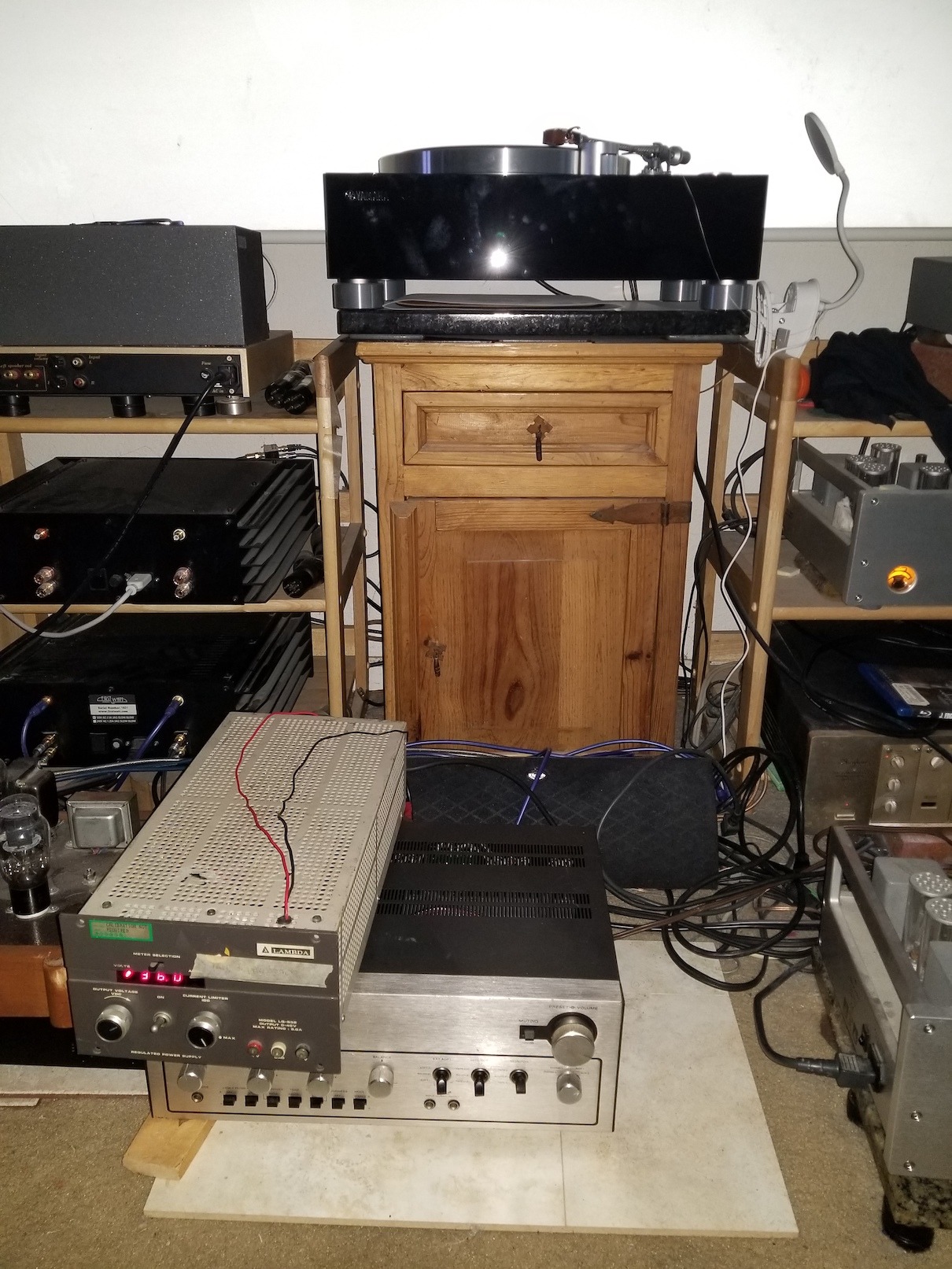

I closed it up as a finished project. Here it is with its antique linear power supply. A bit of an aberrant monster, but it has some appeal as an antiquarian Phoenix.
It has been working flawlessly for a couple of months now and I haven't not been able to break it with my incompetency. I transferred the power supply SMPS noise card to the little SMPS powering the internal TA 4650 preamp, which itself performs competently as a 15 to 20 db booster, though I prefer to operate it as a current amp for external voltage preamps.

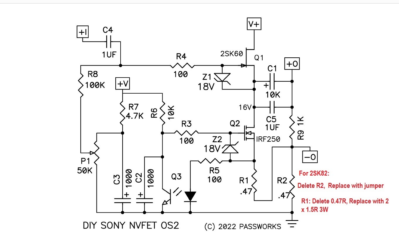

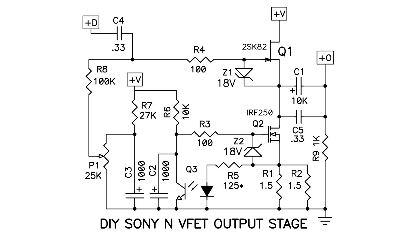

Hey guys, I see where the some are using the dual die and changing P1 R8 back to the ealier VFET build and also changing R1&R2 doubling R1 and shorting R2. All for the P channel. To be clear 2SJ28 and 2SK82 with OS2 boards.
Can I get some confirmation on how to handle this on the N version using dual die? I think I have it, but want to be sure.
Thanks,
JT

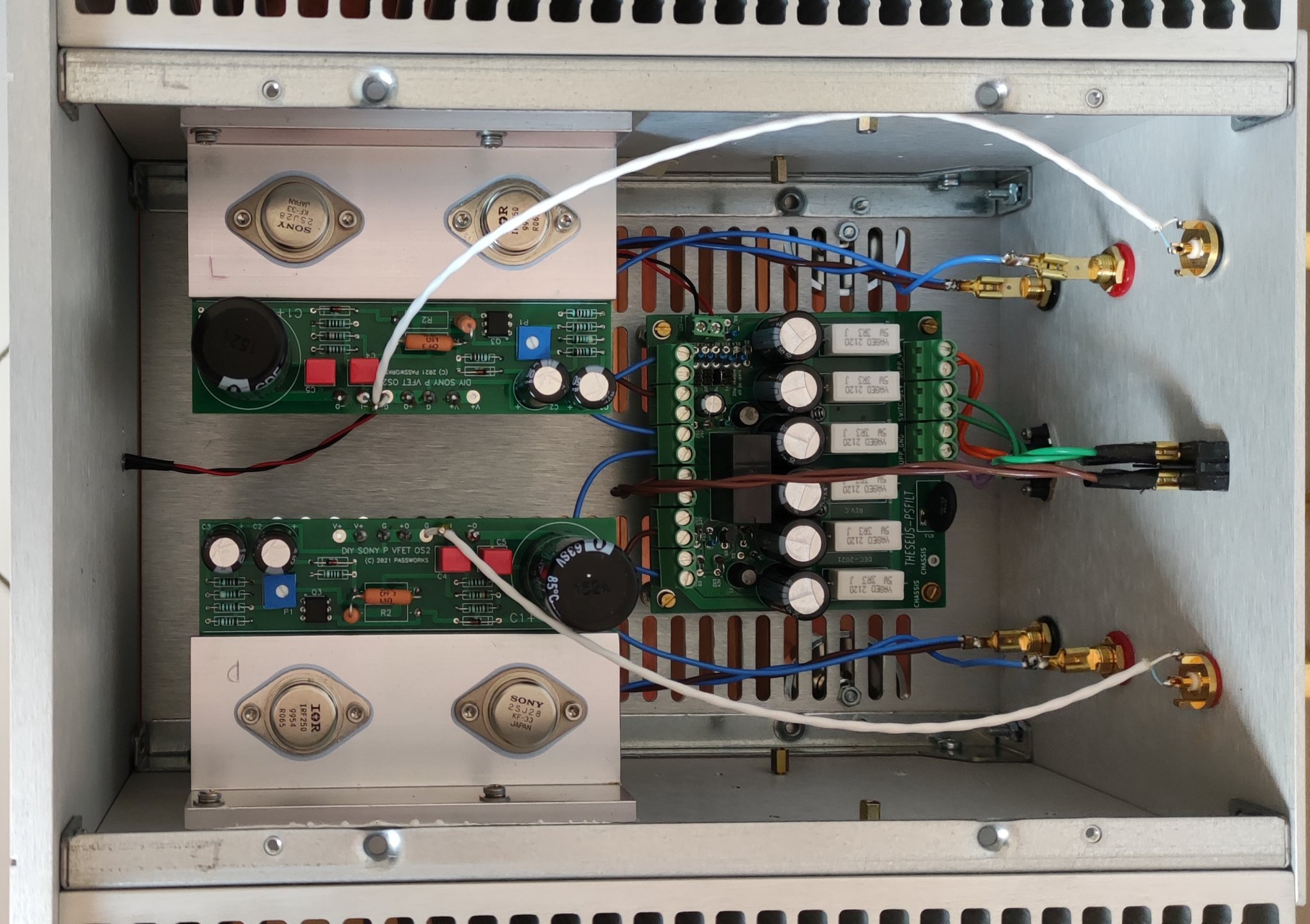

My P VFET OS2 is working and playing great sound. Some connections are bit precarius because the amp is waiting for the FE (Kitty Hawk). The FE is now my Luminaria. The amp's output is inverted the polarity for negative H2. The absolute phase of the signal is ensured by the inverting output of the Luminaria. When the ZTX957s arrive, the VFET will finally be able to take off.
Thanks to Nelson Pass and everyone who collaborated to make this wonderful project possible.
