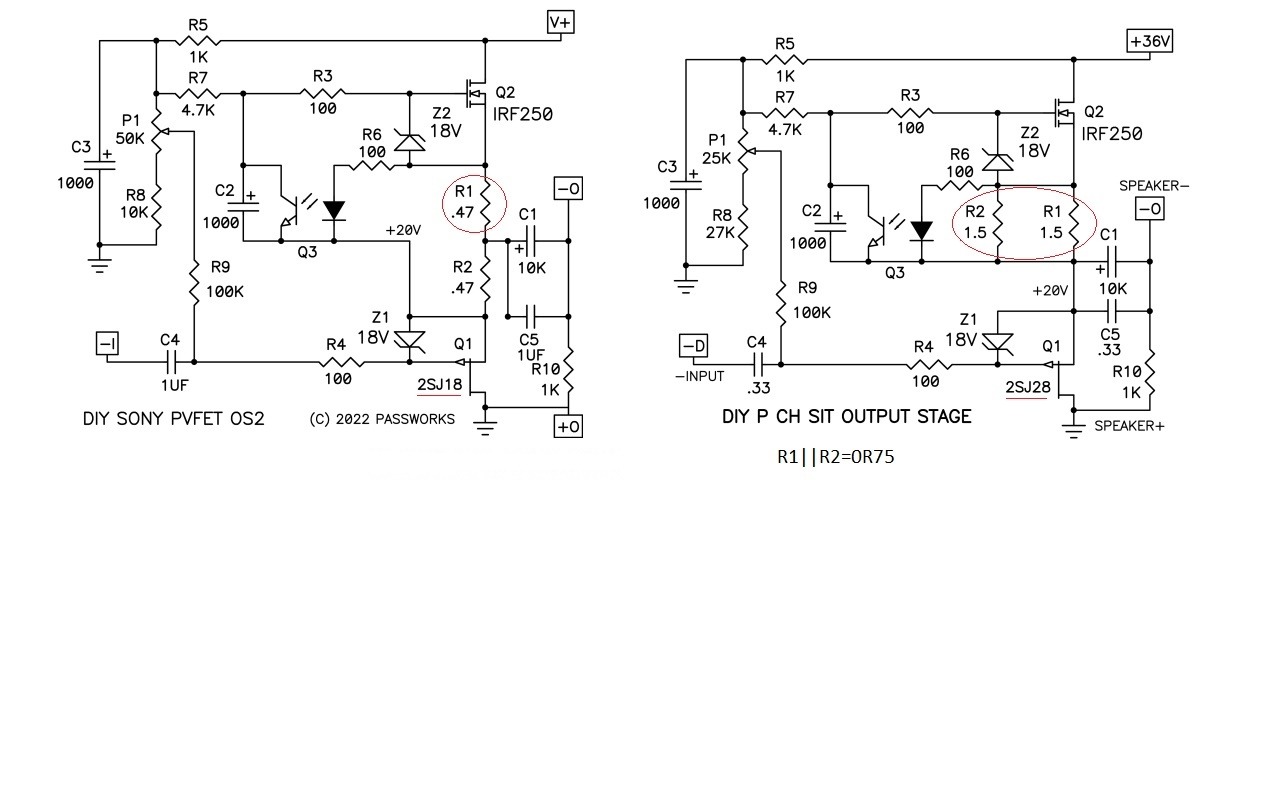

I developed the circuit equations for the DIY Sony NVFET OS2 circuit shown on page 3 of https://www.diyaudio.com/community/attachments/diy-sony-vfet-amplifier-os2-pdf.1035400/ and was able to verify that the circuit is in fact a mu-follower with the same small signal behavior as that of the Sony PVFET shown on page 4. This was not obvious when I first encountered the circuit.

for me it was obvious from first train car, but even I had a question why Pa did it that way, instead of more logical flippin' da polarity
left that question in for later shelf, thinking mostly about turn-on thump reasons, as most likely explanation

From the OS2 PDF, regarding N (2SK82):As Papa said in the PDF file, set R1 at 1 Ohm, and R2 at 0 for 2SJ28 and 2SK82 vfet
"R1 + R2 determine the DC bias current and the ratio of R1 and R2 sets the AC gain. The for R1 = 1 ohm and R2 = 0, the current is constant. "
For the P (2SJ28):
with R1 + R2 setting the DC current and their ratio
setting the AC, again at about 40% contribution from the current source and
fooling the 2SJ18 into thinking that the load impedance is higher. Again setting
R1 at 0 makes the current source constant, as with the 2SJ28 version."
I think he meant to say R1=1 (not 0)? In any case, when comparing the schematics side by side the original had the equivalent of R1=0.75Ω

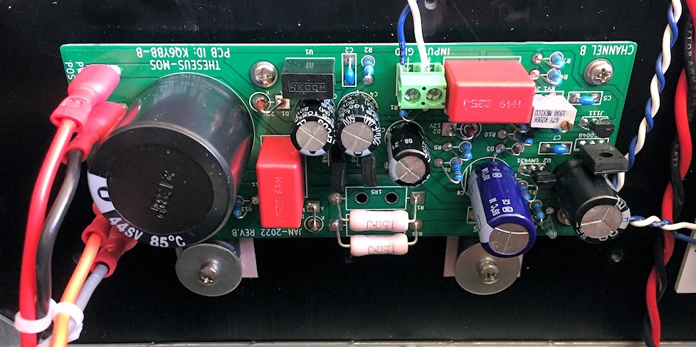

I bet a version that accommodates mounting board parallel to heatsink and GDS pads for flying leads (at least for SIT) would be well received (à la SissySIT).Only issue is different package. I am working up pcb art for plastic power devices that might be more cosmetic.
Alternatively I could revise the existing board for 2sk180, but I think you would have to make a bracket.
The Ship Of Theseus output stage uses two plastic power devices: a Pchannel MOSFET follower, and an Nchannel MOSFET constant current source. You can see them in the attached photo, with big fender washers pressing them onto the heatsink. Circuit is extremely similar to the Pch-VFET output stage sold in the Store by lottery last April. It is compatible and interchangeable with VFET boards, and works with all VFET front ends, VFET PSU filters, and Theseus cards.
