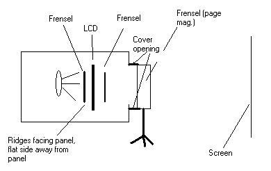

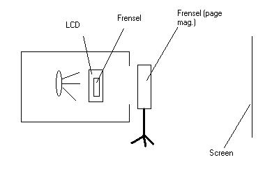

Hello,
My LCD is "commercial" projection panel for ohp use but this should probably do no difference, it's still LCD. It accepts only VGA (computer anyway) signal. When there's no signal it shows logo thing with white background. when power off and no cables attached it shows / projects just white. But this doesn't matter, when boot up the computer, the background in the startup is black and it is yes, grey more than black.
Anyway, I put my non-properly working OHP fresnel lens to pieces. It actually is two lenses with smooth sides outside and inside the opposite for the smooth, what ever the word was/is.
Although they still don't work so good as an page magnifier.
Edmund optics probably says it better in the "Quick Tips for Projector Design": "The classical condenser lens system consists of two plano-convex (PCX) elements mounted convex sides together. The first lens collects the divergent light cone from the illuminator (object or projector); the second lens outputs the light as a convergent cone (image). " You probably read/knew this already though so let's get to the point:
There was a picture where these lenses a part from each other so this is where I got my idea to somehow fix my unworking fresnel, play around with them as two pieces.
I can project an image with "standard projector" setup, although I'm missing some light from the right side of the image and the light could be spreaded more evenly than it is now. But if I could keep the thing on more than one minute at a time and it wouldn't "fall" in to pieces when moving it and it could be mounted to ceiling that would be something wouldn't it?-)
And my final setup will probably be the ohp/furniture one.

IT DOES WORK !!!!!!!!!
Well I fanally got to the prototype stage.
I started building yeterday afternoon (with cardboard)What else. After about 15 minutes I had a 72 inch screen projected on the garage door.
Granted the picture was not as bright as I had hoped but the picture was very clear, but only after I switched from my VCR as a video source to the new APEX DVD player my wife got me for Xmas. A huge improvement in projected video image.
The following is what I did;;;;;
I used my proxima 820c LCD panel (640x480) resolution with my DVD player as a video source. I mounted the LCD Panel in a cardboard box I then placed an old overhead projector fresnel lens (very rough and scratched) against the front side of the Panel. I then mounted the LOA Fluorex lamp directly behind the panel( after removing it from the stand) I then took the 8.5x11 page magnifier and mounted it to the old LOA worklight stand so I could move it easly for focusing. I cut a hole in the fron side of the box roughly the same size as the LCD panel
turned on the Fluorex lamp got the square image from the box positioned on the garagedoor a moved the Page Magnifier until the became focused.
AND THERE IT WAS """"MATRIX"""" ON THE GARAGEDOOR
72" screen for under $ lets see.
LCD Panel $99.00 (ebay)
Page Magnifer $6.00 (office depot)
Old OHP part $0.00 (recycling center)
Total cost $105.00
Granted it could use some improvement in the brightness, but I am now convinced it can be achieved.
I will try to aquire a Better fresnel lens (glass maybe). And also to modify the lighting source (overdrive it).
Well there are alot of tweeks in there that could be put to use such as Better alignment of the optics (center to center on the lenses) as well as squareing the whole thing up. I have learned from years of ameature astronomy and telescope making that the alignment of the optics is very crucial in geting a image to the eyepiece that is in perfect focus. The reason i did it in such a hurry was to see if it was actually doable
AND I NOW KNOW IT IS.
Keep up the good work, together we can do this..
