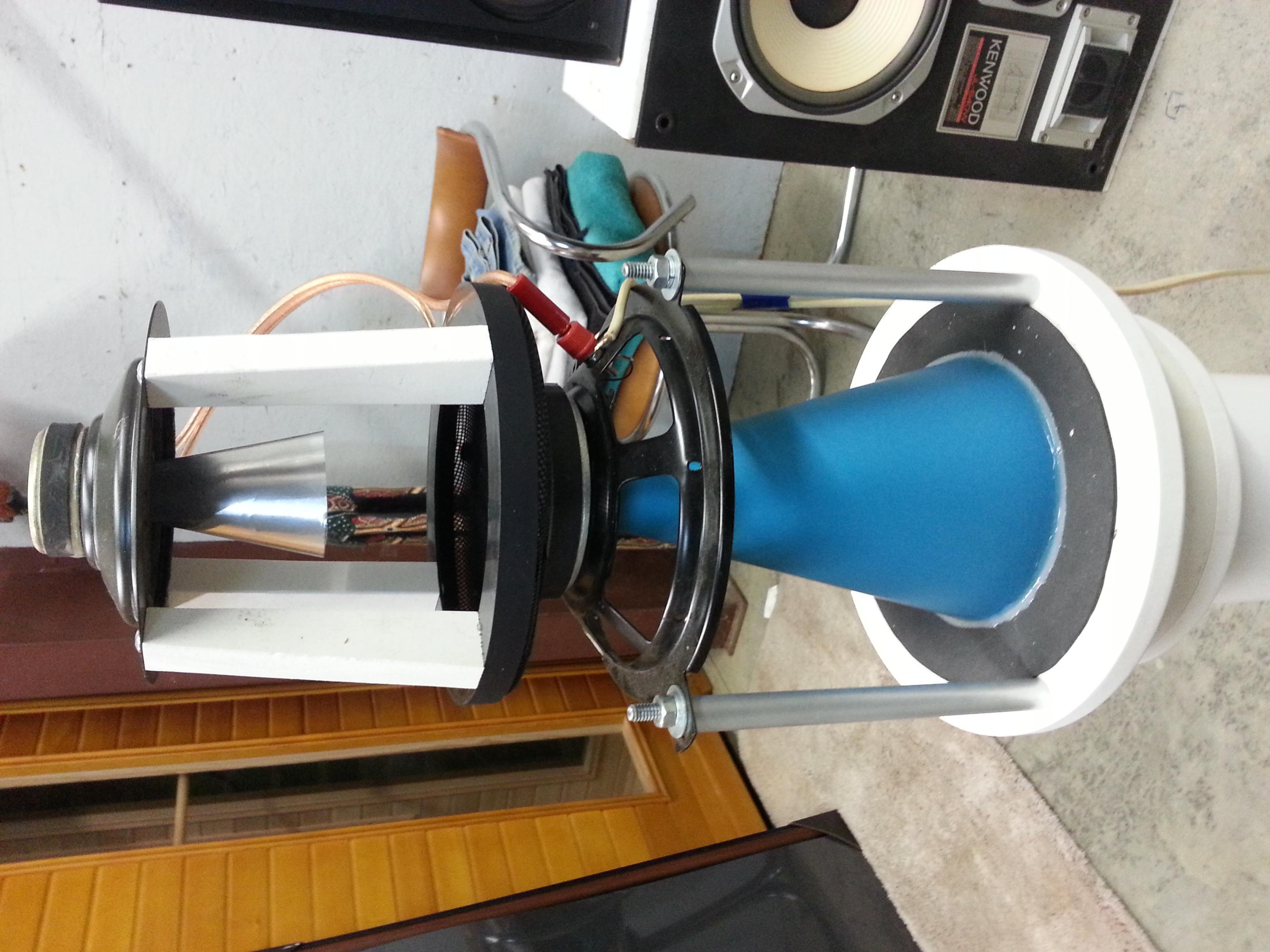

Oh, yeah...close-up of the current state of the V.3 'front' pair, with the 'flipped' tweeter. Sounds so much better having the highs not aimed at my ankles.

Learned something useful tonight. Closed the 'ports' at the bottoms of the front pair, and the bass tightened up nicely. I'd noticed that with the smaller, previous units that when played on a desktop the output was 'sharper' in response.
Does seem to indicate that 'tuning' the PVC support columns in some fashion is in order. Addition of an interior baffle or baffling to break up any standing waves would be a plus as well.
