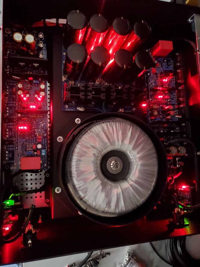

Hi guys,i want to share my experience building this Wolverine,Son of badger.
Although that isn't a simple project don't expect any difficulty due to complete and very analytics build guide.
Everything explained well,step by step.
Finally you will have an amplifier pease of art!
Powerful, very -very low distortion.
THD and IMD is extremely low.
It is stable like a rock,it is silent!
Measurements are excellent!
From a first listening test,it is clear that is a very good sounding amplifier,big soundstage,deep clear and controlled bass.
Yes it is the Next Badger for sure!

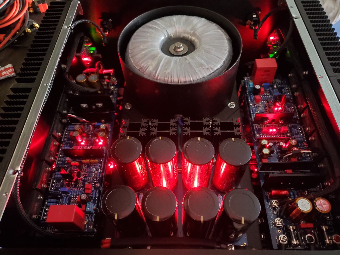

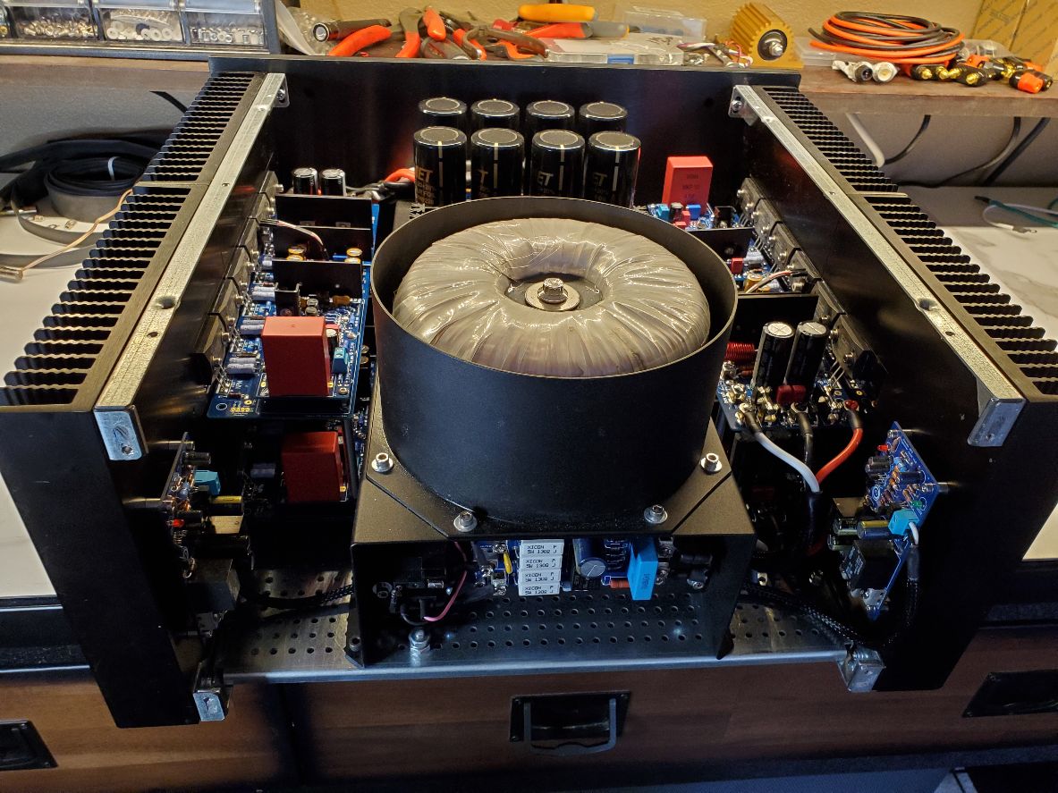

Hey everyone….
I would like to second what Thimios said above… I’ve built several Wolverines now, in order to test multiple output configurations, evaluate stability, measure distortion and to, of course, listen. All of the board versions, for all intents and purposes, performed equally. Adjustments were made accordingly to further enhance layout symmetry and improve component accessibility, in order to provide the best product.
In my own case, I planned from the beginning to build a Quad amp, in order to bi-amp my speakers. The Wolverine EF3-3 configuration suited this build perfectly. I began this project by first building a preamp consisting of Wayne’s Burning Amp line stage and then Pass Lab’s 6-24 active crossover to feed the 4 channels of the Wolverine. I did all of my test listening through this system, although using only 1 board per channel. As I had mentioned in previous posts, the low frequencies are presented with authority and are crisp, but effortless. I really couldn’t differentiate between the different output devices. The same can be said for the mids and highs. My speakers have mid and high planar drivers, so they don’t really miss much…. No tendency to be bright and annoying. It’s extremely pleasant to listen to.
With the box completed, I ran a signal through each board to assess sine and square waves, as was done during development. All checked out perfectly… I then ran a series of tests using a HP 8903B to see how much cramming everything in a box effected the distortion numbers, which was my one real concern. The HP in a loop-back configuration is bottomed out at .0014% THD+N. This is what each board delivered at 130 watts output: .0014% at 1Khz; .0018% at 10Khz; .002% at 20Khz…. The same measurements I was getting with everything spread out on the test bench. Stuffed into a box didn’t make any real difference.
Anyway, I’ll be listening to the quad configuration in the next few days… I can’t wait. Here’s some photos:
